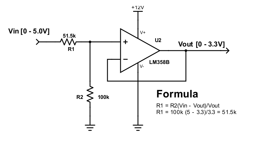

    The issue with using most 12 bit adc microcontrollers is they operate at 3.3v and most hall pots are 5v. While their digital inputs are usually 5v tolerant the adc inputs aren't.

    It can be done with a inverted amplifier: https://forum.arduino.cc/index.php?topic=586505.0

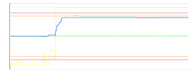

    Another question would be for a 3d printed 2:1 gear. Would the added 200-250 resolution vs the backlash and minor difference in the teeth make up for the loss? What about 4:1 (a lot more tricky to print due to size) and using the whole range seeing as its already maxed out around (see pic blue line) here.

    I'd prefer making them myself and just buying the actual sensor as I have a 3d printer and lots of magnets. So the question is do I need a specific one that only measures 45 degree or a standard one and have the magnets in a special orientation. My current setup like mentioned (picture further up) does about 800-850 steps before the curve falls off and it reverses
