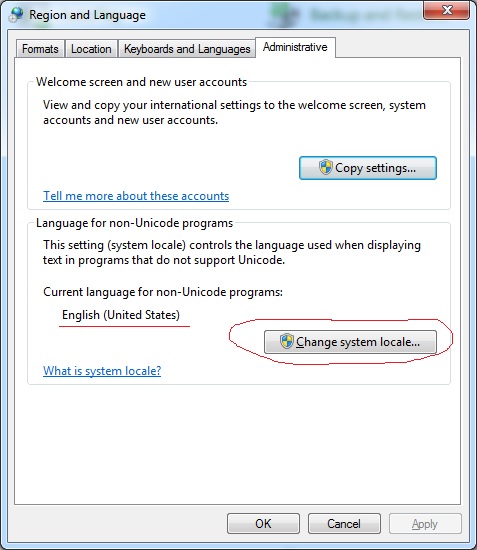

    Can you post screenshots of you Axis Assignments and interface settings?
    Have you tried this?
    I'm sure we can figure out what is happening.

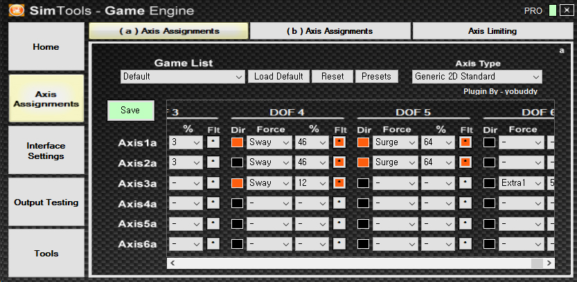

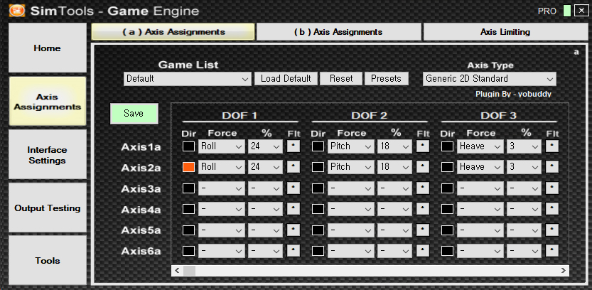

    @yobuddy
    There are places that are resolved in that way, and there are still places that can not be resolved.
    Axis Assignments screen.
    There is no problem in 1.3, but this problem always occurs in 2.x.
    We use 7 SCNs but it seems to have nothing to do with quantity.

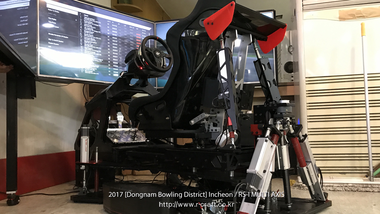

  7. Mu-KwangKim
    Mar 14, 2012
    124
    South, Korea
    - 689Coins
    +33 / 0 / -0
    One simulator has 7 axis
    The same is true when using only 6 axis
    We use both because we split it into 3 axis and 4 axis
    There are 3 axis on top of 4 axis.
  8. Mu-KwangKim
    Mar 14, 2012
    124
    South, Korea
    - 689Coins
    +33 / 0 / -0
    It is a picture for reference.

  13. yobuddy
    5,383
    50,374Coins
    +5,153 / 18 / -0

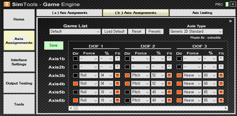

    Hi @Mu-KwangKim ,
    I believe its just your axis assignment settings to be honest.
    Let's take a look at Axis 3b, it seems to be using over 300% for its output.
    If you add up all percentages used, from left to right, it should equal 100% to ~130%.
    Or somewhere in that range anyway.
    Also, you have a lot of filters running and i can't tell exactly what is being used there.
    But i realty think its just a percentage problem with the Axis Assignment settings buddy.
    Take care,
  14. Mu-KwangKim
    Mar 14, 2012
    124
    South, Korea
    - 689Coins
    +33 / 0 / -0
    @yobuddy
    Oh... Yes yes... Right.
    the total axis% sum is set to about 100, so the problem is gone.
    The biggest difference between 1.3 and 2.2.
    It is a bit different from what I thought, but seems to have found a solution.
    *. If the filter does not work, re-install Windows.
    *. Strangely to movement problem. fix to the responded all % sum change.
