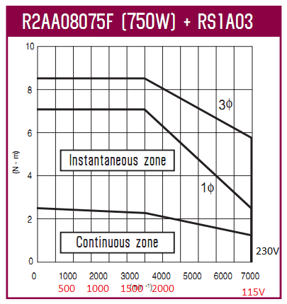

    Here is a speed/torque diagram of a 750W servo motor. It's not the AASD brand but a SanyoDenki motor but that doesn't matter much, they all behave very similarly.
    For a permanent magnet synchronous motor speed is nearly proportional to voltage and toque is proportional to current. So if you run the driver at half the voltage that effectively cuts your max speed in half. (1500 instead of 3000RPM rated speed) But the rated speed and torque are not a hard limit. The motor can run above the rated speed (field weakening operation) but at lower torque. The motor can also run above the rated toque but only for a short time. Otherwise it would overheat.
    Feeding the driver with 3 phases provides more power reserve because the DC bus voltage is more stable especially under heavy load (instaneous zone).
    Running at 115V instead of 230V effectively changes the scale of the X axis. Max torque starts to drop at 1500RPM. You may be able to run it at 2000RPM but at reduced torque capability.

    It's simple physics. It doesn't care if you agree or disagree. A switch mode power supply with a wide range input can deliver it's rated output power from 100 to 240V input because the switch mode voltage converter is designed for it.
    The servo drive doesn't have a transformer so it can only down-convert the voltage. The motor has a rated voltage of 200V which means that the back EMF is slightly below that at the rated speed, let's say roughly 150V at 3000RPM. So the voltage output of the driver has to be higher than the back EMF of the motor which is ~0,05V per RPM or 75V at 1500RPM. Otherwise it can't drive current through the motor. So the limit for 100 to 120V supply is around 2000RPM.
    And no, the drive won't deliver anything near the 750W at 120V supply. Same torque half the speed gives half the power or 375W.
