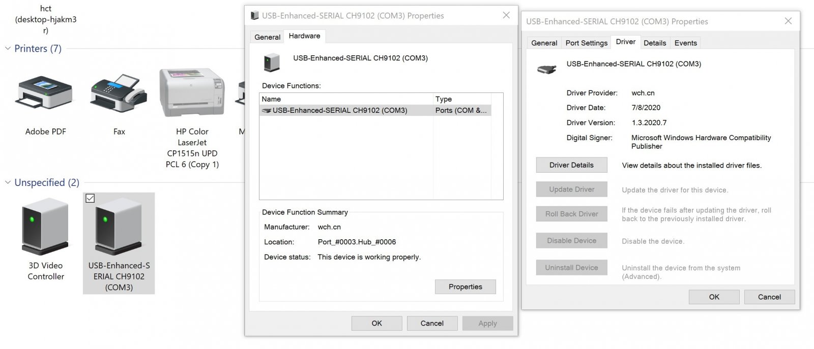

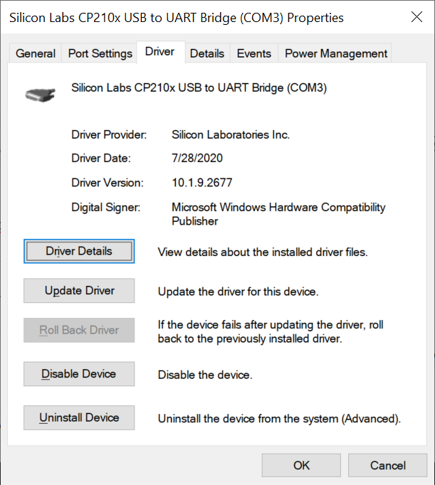

    Because I use CH9102 vesion ESP32, so I install the 9102 driver. SharedScreenshot.jpg

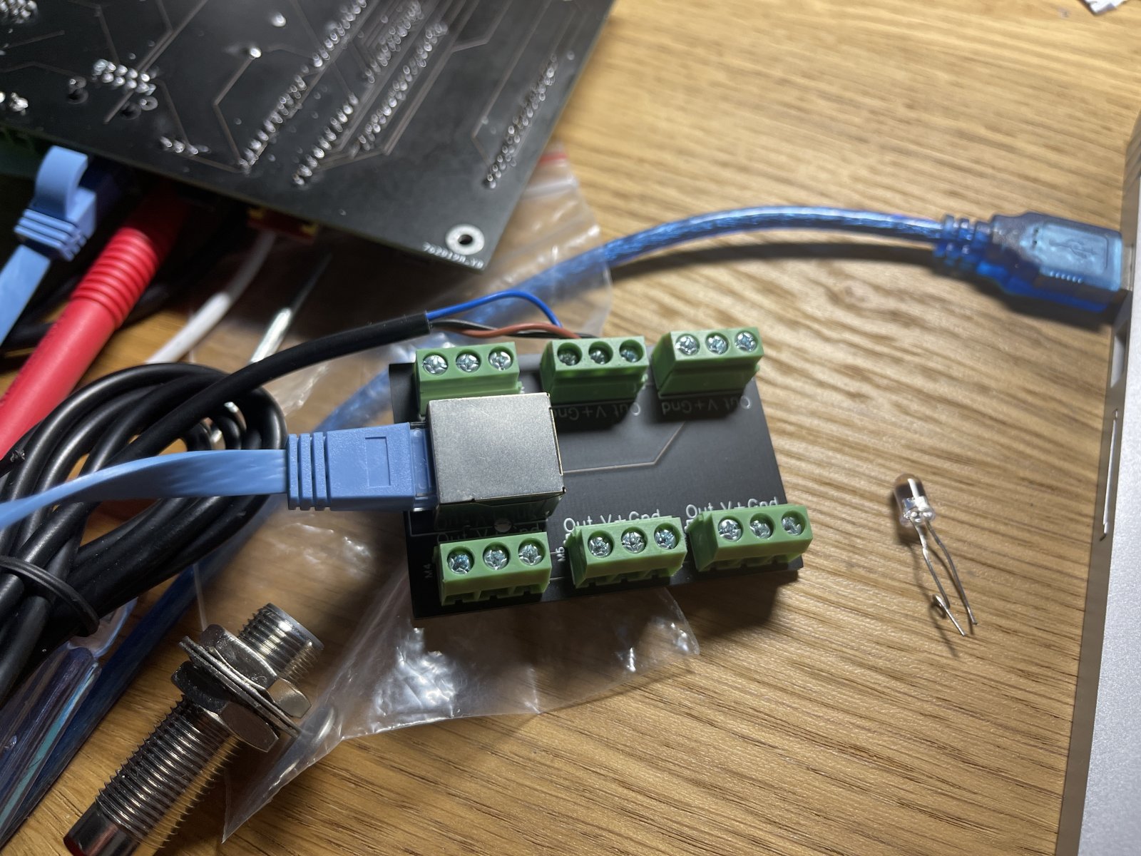

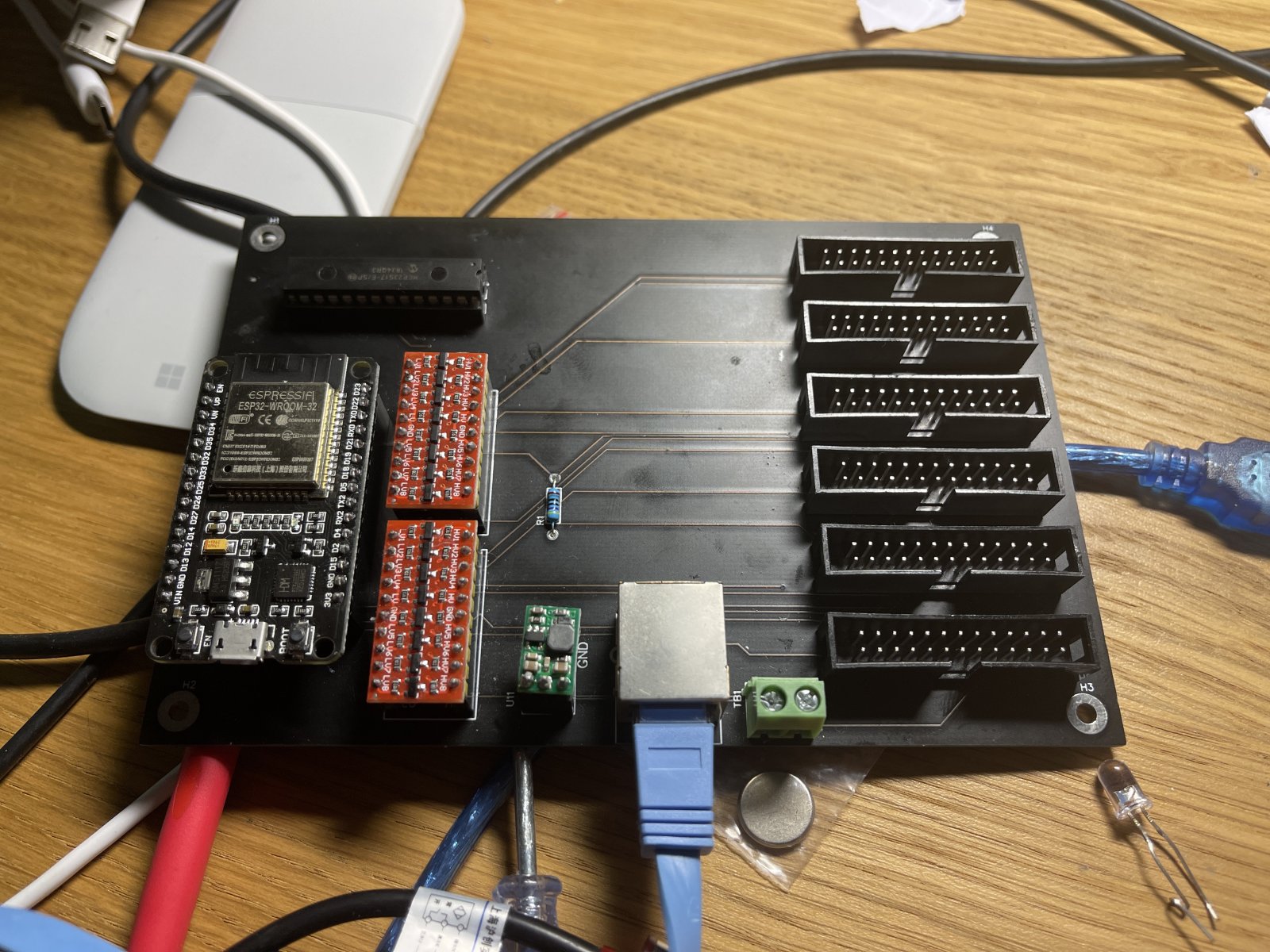

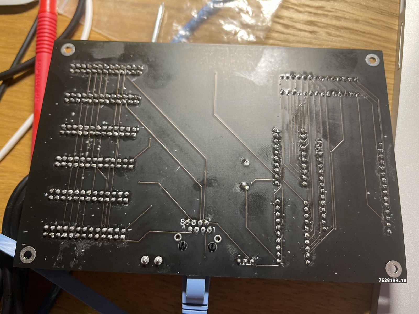

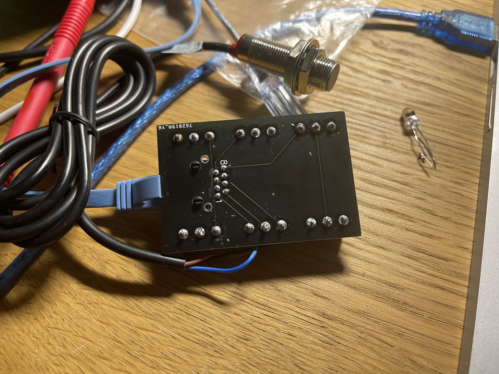

  19. tu xiao mi
    tu xiao mi Member Gold Contributor
    Aug 10, 2021
    71
    486Coins
    Arduino, 6DOF
  20. knaufinator
    knaufinator Active Member
    Nov 16, 2017
    208
    Simulation Engineer
    akron,ohio
    1,841Coins
    +240 / 1 / -0
    AC motor, 6DOF
    Those look good, nothing jumps out at me.
    I remember someone reversing the multiplexer once... I was looking for something like that...
    didn't you say in the youtube thread that the motor does move, when you use the PCB_debugger.ino program?
    that would indicate that the motor is setup correct for "position mode",.. and would move 1 position every 5 seconds or so....
    do you have a powered USB hub you can use?
    My thinking is this,... maybe your PC is not suppling enough power to activate all of the circuits and then activate the 5v at the servos? ... if you use a Powered USB hub, that has its own clean 5v power source.. maybe that will be enough to drive the motors..... or try a different usb port?... or different computer?.. running out of ideas...
    you would need to create a simpler test if you cant get this to work,... a simple circuit to drive the motors manually,.. just to verify pins/ports are working....
