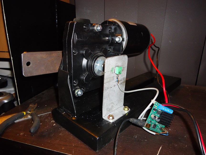

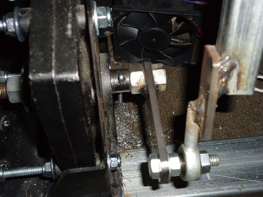

    Yes you can gear the pots but the lovely thing about the jrks is that you do not really need too.
    To get up and running while searching for gear/pullys etc , it is quite simple to use a 12mm bolt of about 100mm long, on the head side mount the lever to connect the sim too, I actually weld the lever in place.
    By locking a nut on the other side we have have lever installed, the hollow shaft of the motor has a 4mm hole through it too here I use a 3.2mm split pin as the drive locking pin so the bolt will always move with the motor shaft.

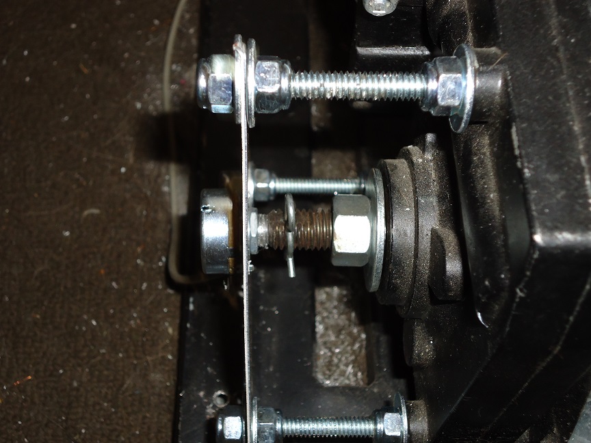

    Now to connect a pot, I simply drill out the other end of the bolt with a 6.5mm drill bit, this allows for the shaft of the pot to fit snuggly into the centre of the bolt, then I drill a 3mm R clip through the end of the bolt and shaft to pin all that in place, and makes it all easy to service later on if changes are needed or something breaks.

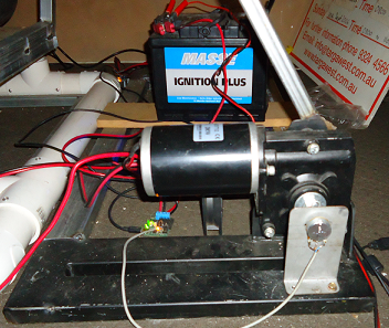

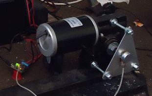

    I just make a simple triangle to mount the pot onto and is bolted back to the same motor bolts so if the motor comes alittle loss for all the wicked motion the pots centre doesn't change and I don't loss the feedback control on the motor.
    DSC00209.JPG Showing lever end with split pin in to lock the bolt to the motor shaft.
    Showing how I mount the pot with the triangle, thread rod and a combination of nuts used to mount the motor and the pot to the motor mounts.

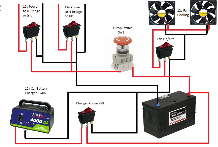

    Thought I might toss this in here too,
    How to wire a Jrk for SimTools use.
    How I wire a dc car battery, beware the rocker switches (red ones) have an internal led in them so the earth (gnd) connect is not needed if using ones that don't have a led in them.
    That should just about get you rolling along.
