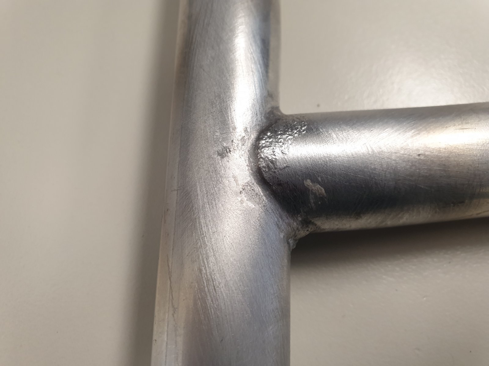

    There is no welding in the picture above!
    Whilst it may look like welding, it is actually aluminium brazing.
    Using a MAPP/propane gass torch (cheap and easy to get) with a medium torch nozzle.

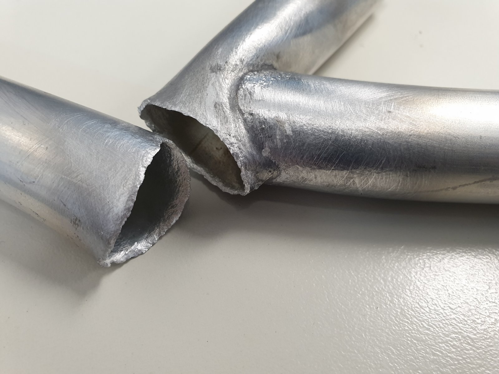

    I was surfing facebook when one of those adds came up showing the process of aluminium brazing and I couldnt really beleive that it was true. Being only $25 I thought I'd give it a try. To my utter surprise this actually works! The solder is even stronger than the alumninum as shown in the picture below. I did a butt joint using 1.6mm aluminuim tube soldered all the way around. I then got a 1 meter long metal tube and placed it on the end of the wleded on piece. I then tried to pry off the welded join. The joint did not fail! What you can see it that the aluminuim has stretched and eventually torn. Now one could argue that the act of heating up the aluminium has weakened it and sure it probably has. I could literally jump on this weld so for making a motion sim frame, it's good enough.
    There is however one downside. Because the solder material has a high zinc content the solder will eventually corrode and so the aluminium joint MUST be painted to stop the corrosion. An unprotected solder will last just over a year in outdoor/wet environments before showing excessive corrosion. (3 year later the frame is still standing) A painted join will last much longer and being that motion sims are usually kept inside it should last for a very long time.

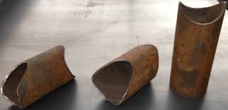

    - cutting the ends in "gueule de loup" is a pain
    This tools can help you to draw
    but cutting is tricky

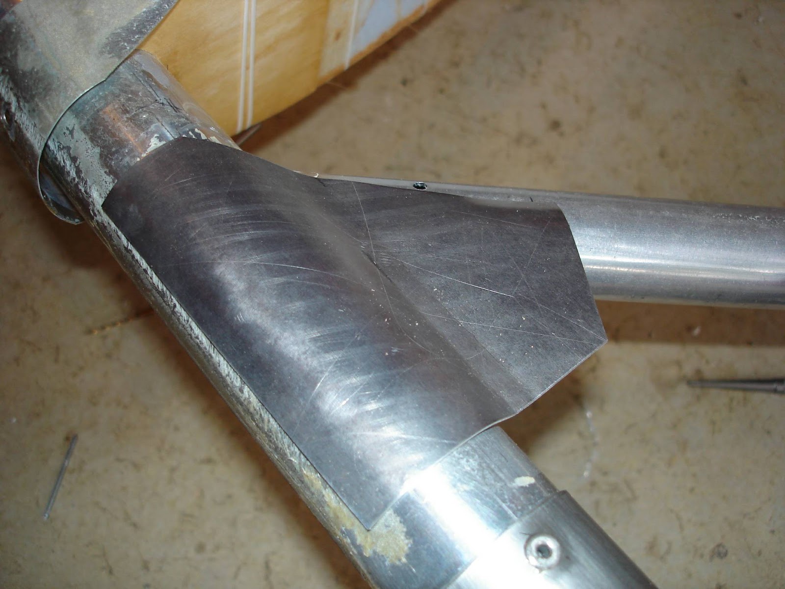

    One ultralight technique with joining aluminum tubes is to use sheet gussets that get worked/hammered to conform to the tubing to be joined and then pop riveted in place with a fair number of rivets. Maybe another solution?
