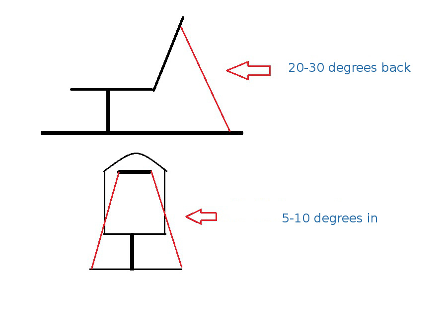

    @noorbeast For now I can consider a shoulder mount sim, just for start, but if I may upgrade my sim, what should I need to change en my sim???? Also, i was making a model for the RC motors, but i was figured out how I can make a pivot for the model, for example, a stick, a spring, etc..... And I'm going to read the links provided, thanks!
    @mcxsim Let's take the consideration that IDK nothing about motors, and here in Chile it's very common that any vendor can tell me one thing but the real product is another thing. Now i've bought the monster moto at DX and now i'll wait, but for now, what kind of motor should i need?? Reading the specs, any 12V motor up to 30A should work??? Any other consideration???
    21,533
    150,818Coins
    +11,022 / 55 / -2
    A shoulder mount seat shaker design would be the best choice for wiper motors.
    If you have a sturdy design and use two good PSUs at the start then in future the main thing to upgrade would be the motors/gearboxes.

    @noorbeast I'll keep in mind that. For now I'm still planning my scale model (cabinet, universal joint, motion structure) and trying to build another things, like a H Shifter and pedals (I have DFGT wheel, for now I can't affort a G27)
