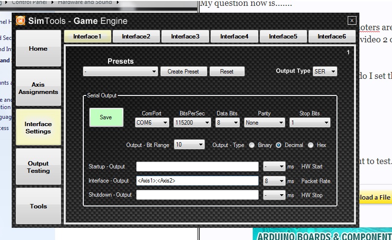

    My question now is.......
    Since I have no true vlue as to what the moters are suppose to do,, which of the contections are correct? video 2 or video 3? I assume 3.
    Now that this might be figured out. How do I set the simtools engine?
    my COM port is
    COM6
    115200 b/sec ,8 , none, 1,
    (flow control l) hardware
    I have been trying to use the virtual output to test. But know results
    Here is a picture of what I have.
    so whats next?
