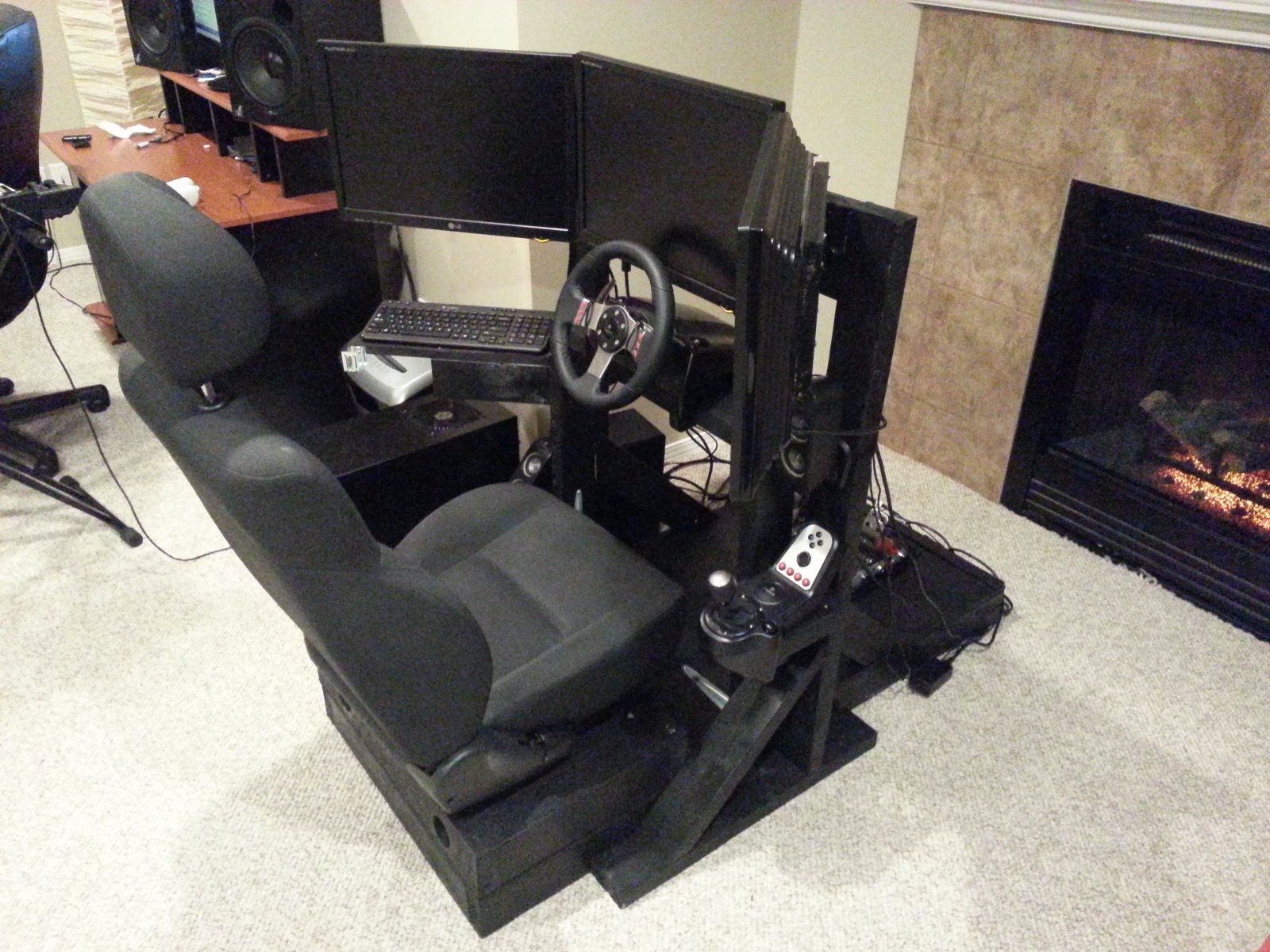

    This is my first post, I'd like to say hello and thank you in advance to all the dedicated members of this community. I've been reading on this forum for a long time and now I think I'm getting close to being ready to start a build of my own. However, of course I have many questions and I figured I would put them out there from now before I get going.
    I understand the basic mechanics behind these motion simulators and I think I understand basically what parts are needed to build one of these. I've done my fair share of welding and working with metal so I'm not worried about that part of this. My questions today are about controllers / power supplies. I think some of the confusion is just terminology, some components sound like greek to me.
    I have already decided that I am going to build a shoulder mount 2dof seat mover. I currently have a static rig with Logitech G27 triple monitors so this seems like the natural progression.

    That's a nice compact static rig u have there :thumbs
