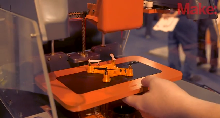

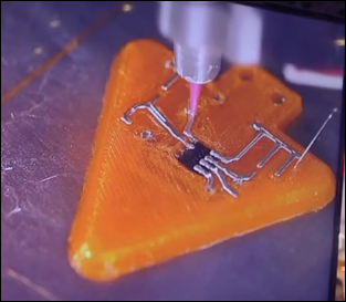

    A very neat idea. You are pretty much locked into the design software arrangement though.

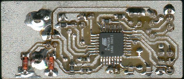

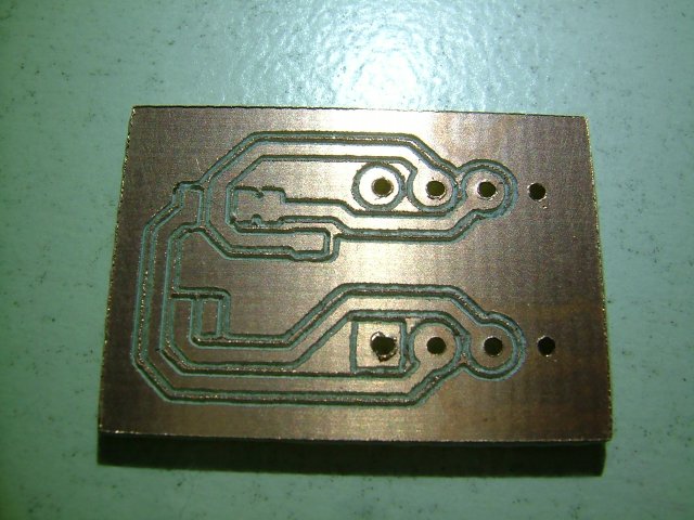

    If the frame is stiff enough, you can also add a mill head to a 3D printer and use it to mill PCBs, that's how I do my circuit boards, it's precise enough to do SMD boards :

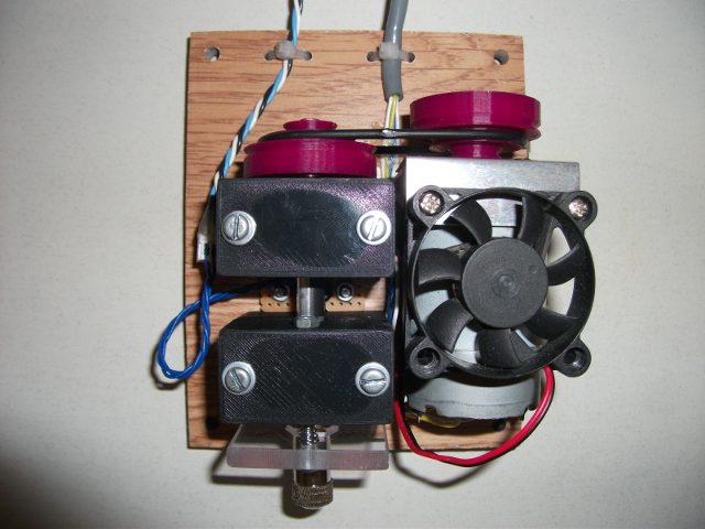

    Actually, I built my 3D printer with PCB engraving in mind from the beginning, so I made it very stiff, I made a wiki on reprap.org about it : http://reprap.org/wiki/Heavy_Mendel
    And this is the spindle :
