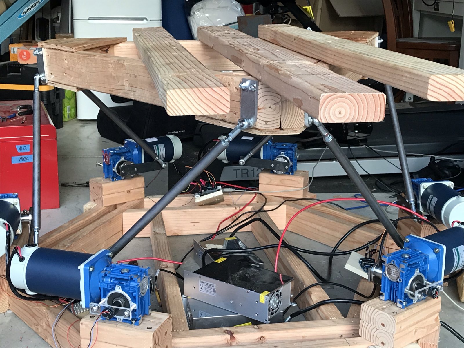

    Nice work matey !
    Think you need to turn your levers 180 degrees they are in the wrong position, too upright

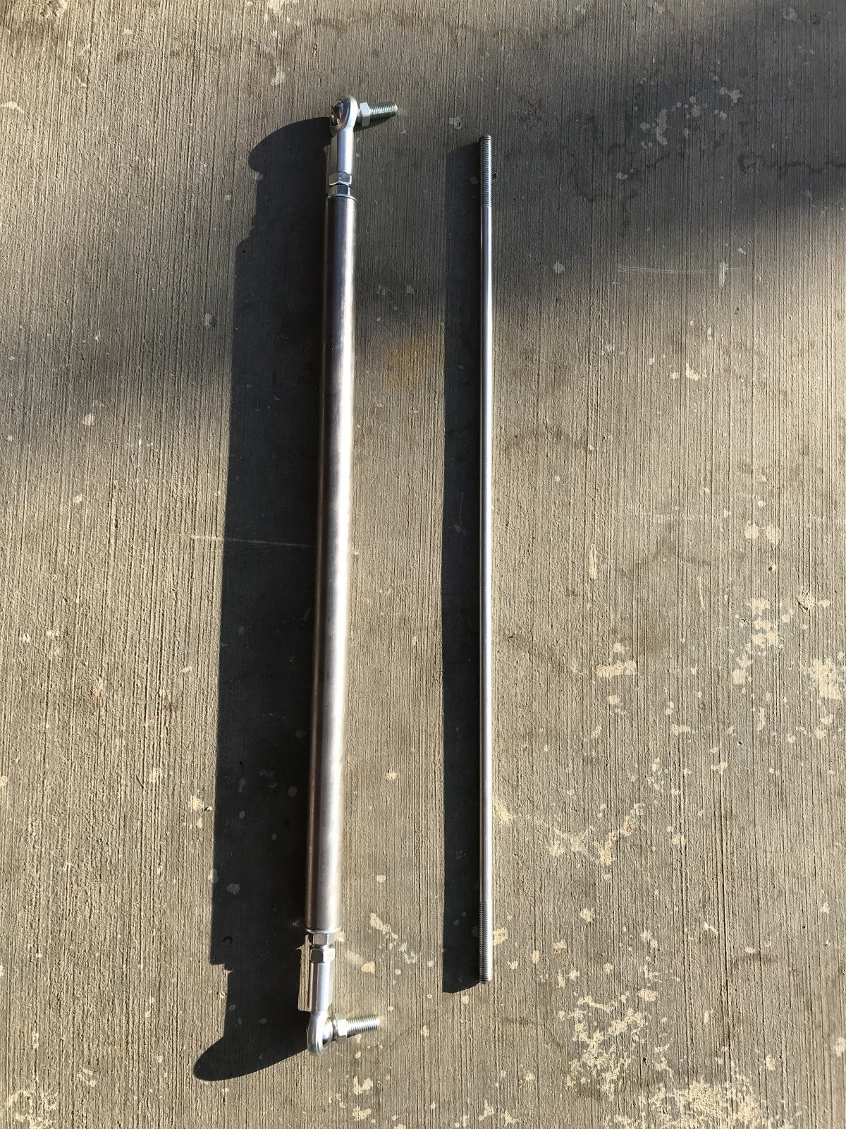

    Also did you use M12 threaded bar for your rods ? They look thin

    Thanks for the suggestion! I turned them around and it is far more rigid than it was before (it was wobbling all over the place before). Here's the corrected setup:
    Yeah, they are pretty thin, and I'm working on fixing this. My plan right now is to slide some steel pipe over the rods to give them some extra material, and hopefully stop them from bending. If you push on them hard enough you can notice some deviation, even without any real load on there right now.

    Yes, I realize this now. Instead of buying thicker rods and having to buy new joints, and re-mill all of the plates the joints connect to, my plan is just to slide a steel pipe with a 3/8" ID and a 3/4" OD over the rods, which should give it plenty of strength.

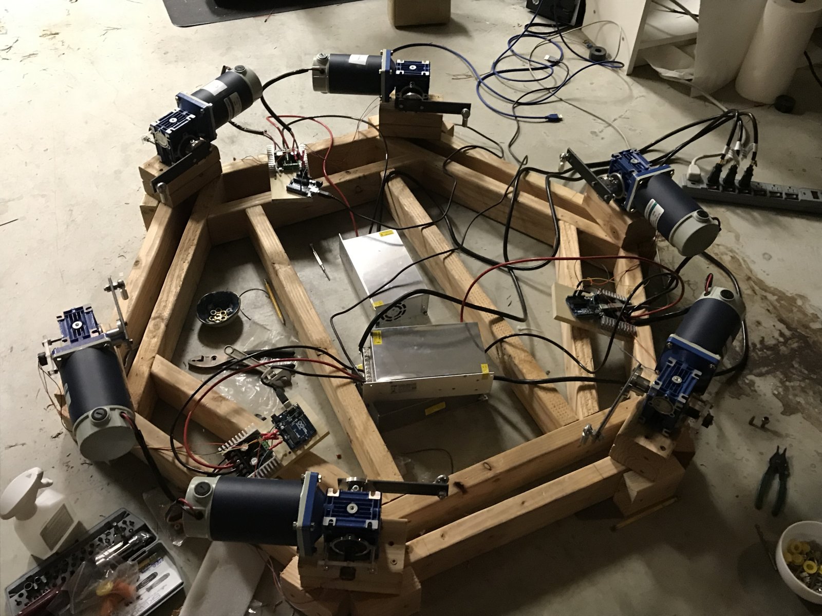

    Looking at the system as a whole, this is the setup:
    Power supply -->
    SimTools --> USB cables --> Arduino running SMC3 --> pin 13 wire --> Sabertooth 2x32 controller --> motors
    From the tests I've conducted so far, I believe I can safely rule out the problem being related to SimTools, the USB cables, the Arduino, and the Arduino wiring.

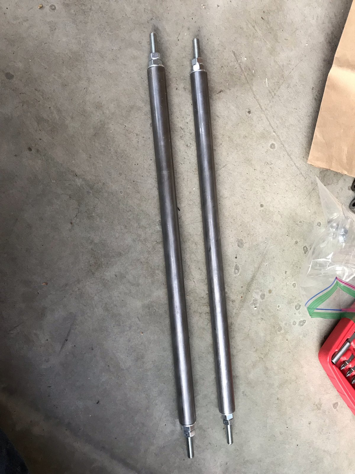

    I've now beefed up the connecting rods a huge amount, and beyond just knowing that they're not going to break, I also think that they look awesome. The original rods turned out to be a little less than 5/16ths, and so I had to add some plastic tubing to stop any potential rattling, so now it fits like a glove. The reinforcing pipe is low carbon steel, and has an ID of 3/8ths, and an OD of 3/4ths, so it is quite strong.
    Here's some pics:

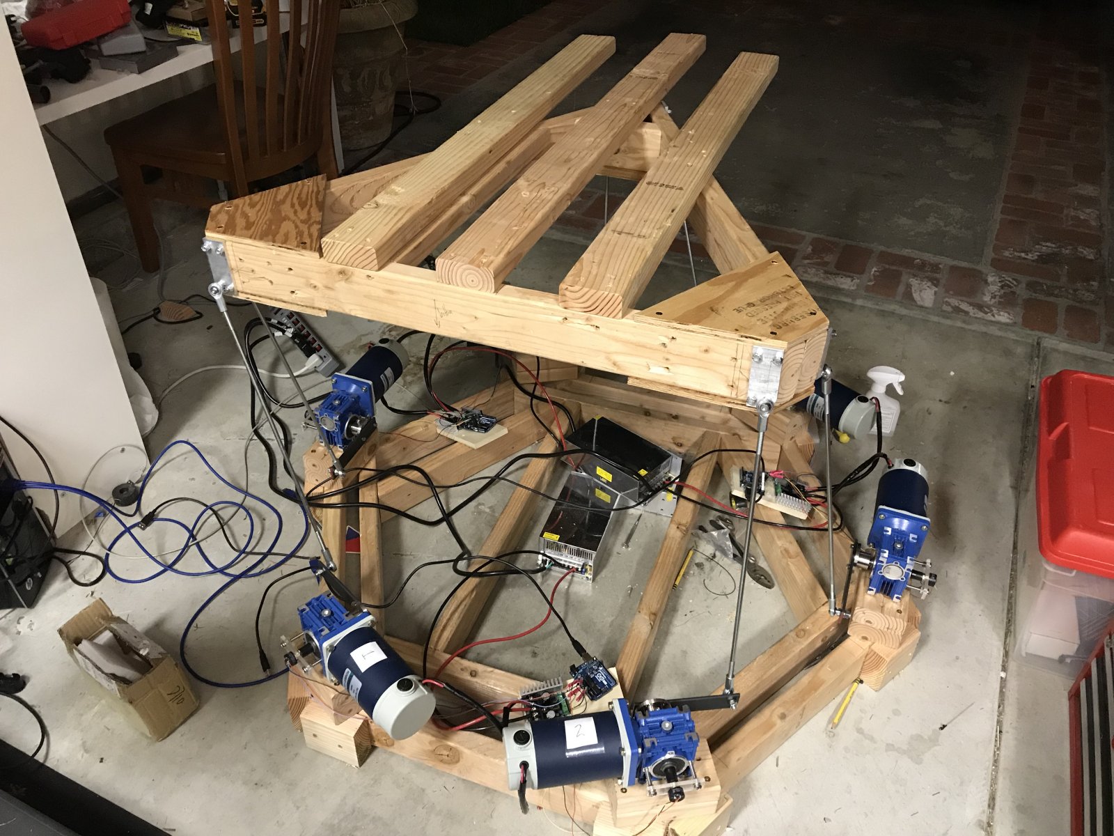

    While I've not yet figured out how to get it to move me, I have configured all of the axes, and it is officially alive! Here's the motion test video:

    I am repeating myself but I do think your lever CTC is too large for the intended mass and likely your levers are also at an inefficient angle.
    Levers provide maximum torque at 90 degrees to the rods, and over 38 odd degrees either side of that are pretty inefficient with respect to torque.

    Apologies for ignoring your last reply. I misintepereted the motors specs as having variable max torque given the max rpm of the motors, but in reality the manufacturer was describing the spec for different gearbox options. This means I have much less torque then I thought, and my motors will be putting out about 25.4 Nm of torque (I'm rounding to 25), or enough to lift only 264.5 pounds total, including the upper portion of the frame, given my CTC length. I redid the math with the correct specs, and leaving ample padding, I think my levers should be about 3.3", or about 3 and 5/16". This is a big step down from my current 5" arms, but I guess I'll have to make due. I'll try and. redrill the lever arms to incorporate a 3 5/16 length between the shaft and joint.
    Also, thank you for the advice about the arm angle. I'll try and figure out how to fix this. Right now the arms cannot fully turn down to a 90 deg. angle, without hitting the frame, and before they even get down close, the rod will hit the lever arm.
