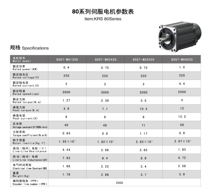

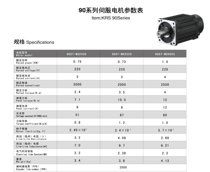

    How does an 80AST-A1C04025 compare to an ST90-M04025?

    hey,This is the difference between the two models, buy more than 90ST

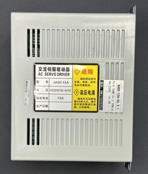

    and with white driver
