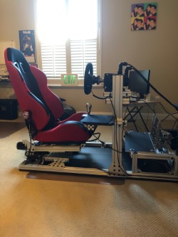

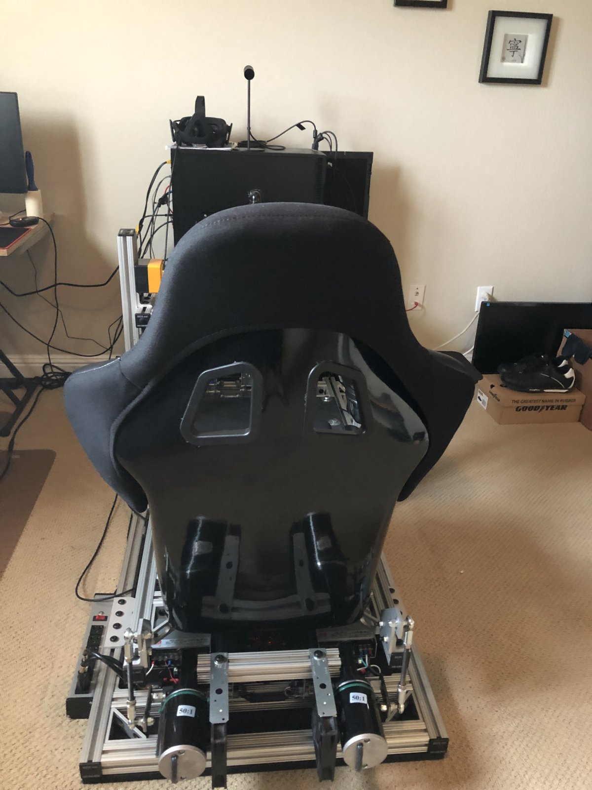

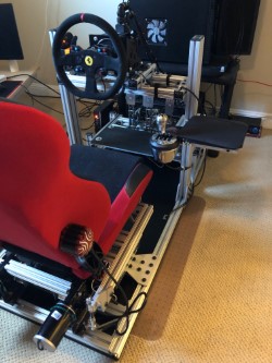

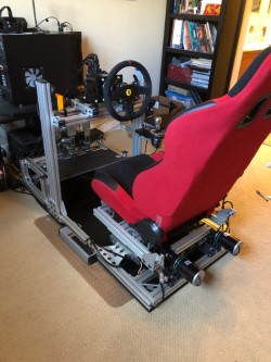

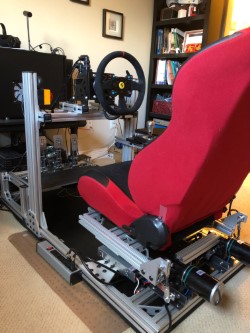

    Finally got the rig put back together. Time to download some plug ins for more testing with different games.

    Lookin' Good!!!!!!!!!!!!
    I don't see a monitor being used (aside from the one behind your PC).
    Are you now 100% VR???

    AC test. Ferarri 458 S3 @Imola
    Turned off motion and went around a few laps and WoW, what a difference! It’s so satisfying to drive now. I haven’t even messed with the tuning yet. Its all just basic right now.

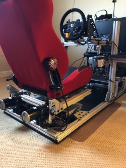

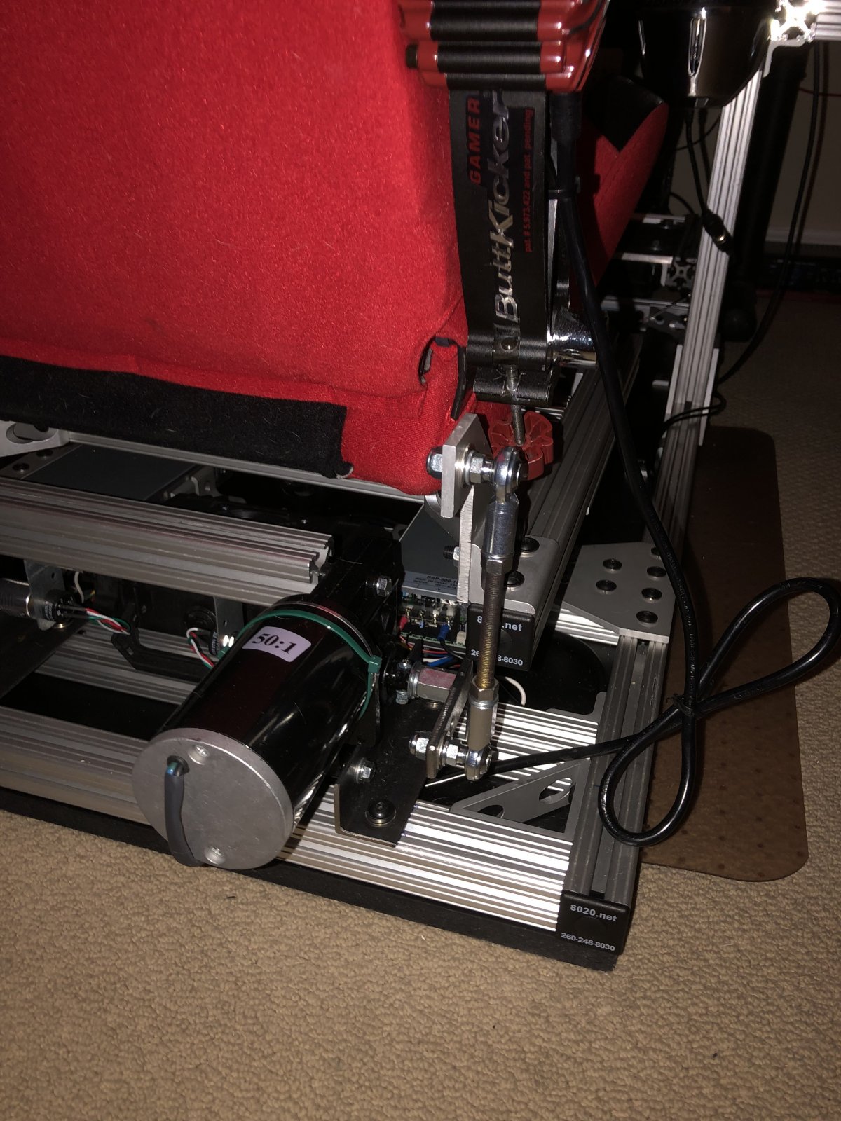

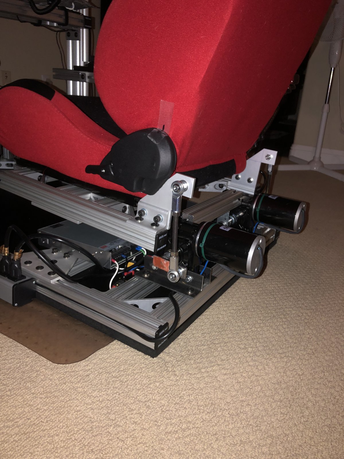

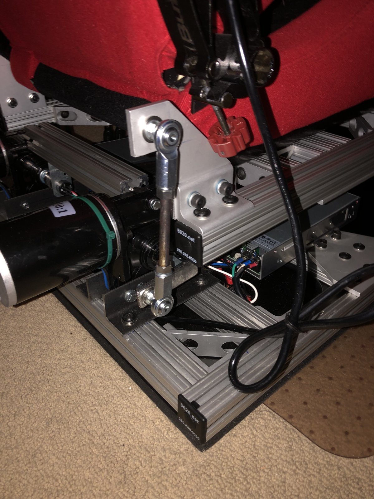

    Playing around with the push rod placement. Lengthen and moved it in and up closer to the hips for better leverage.

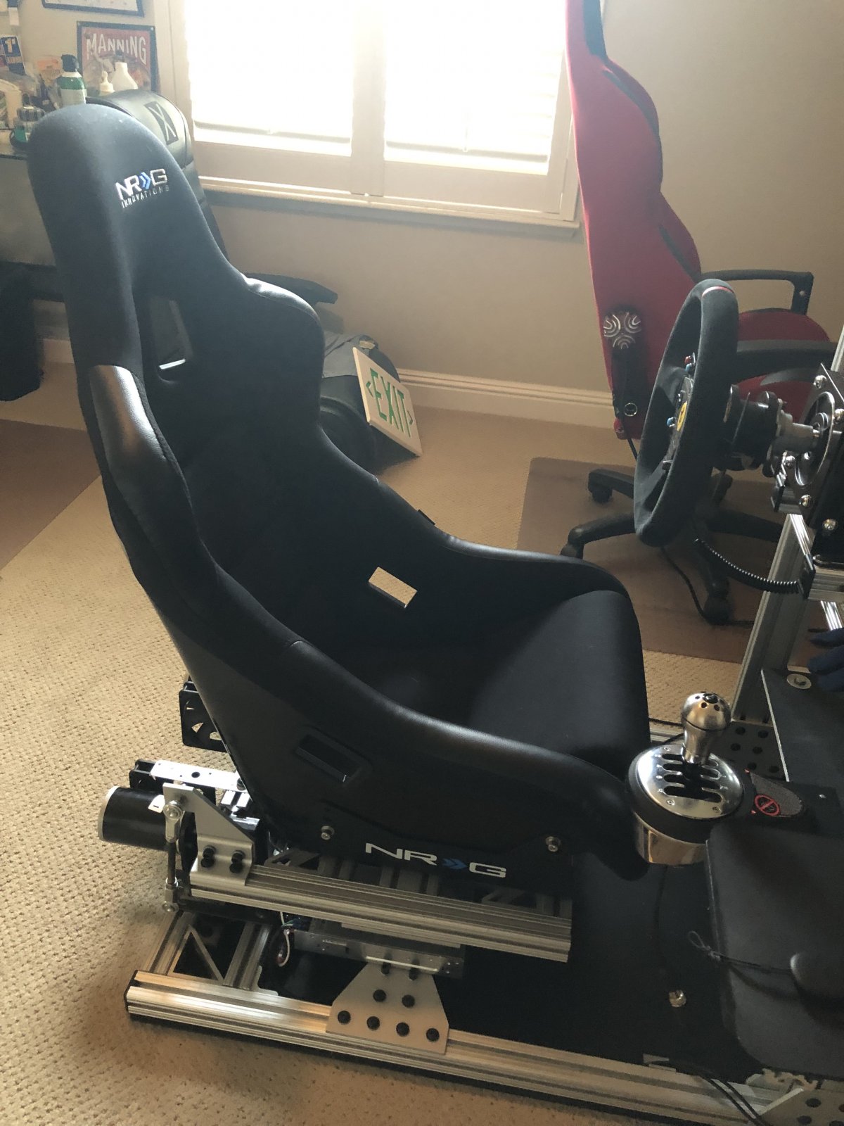

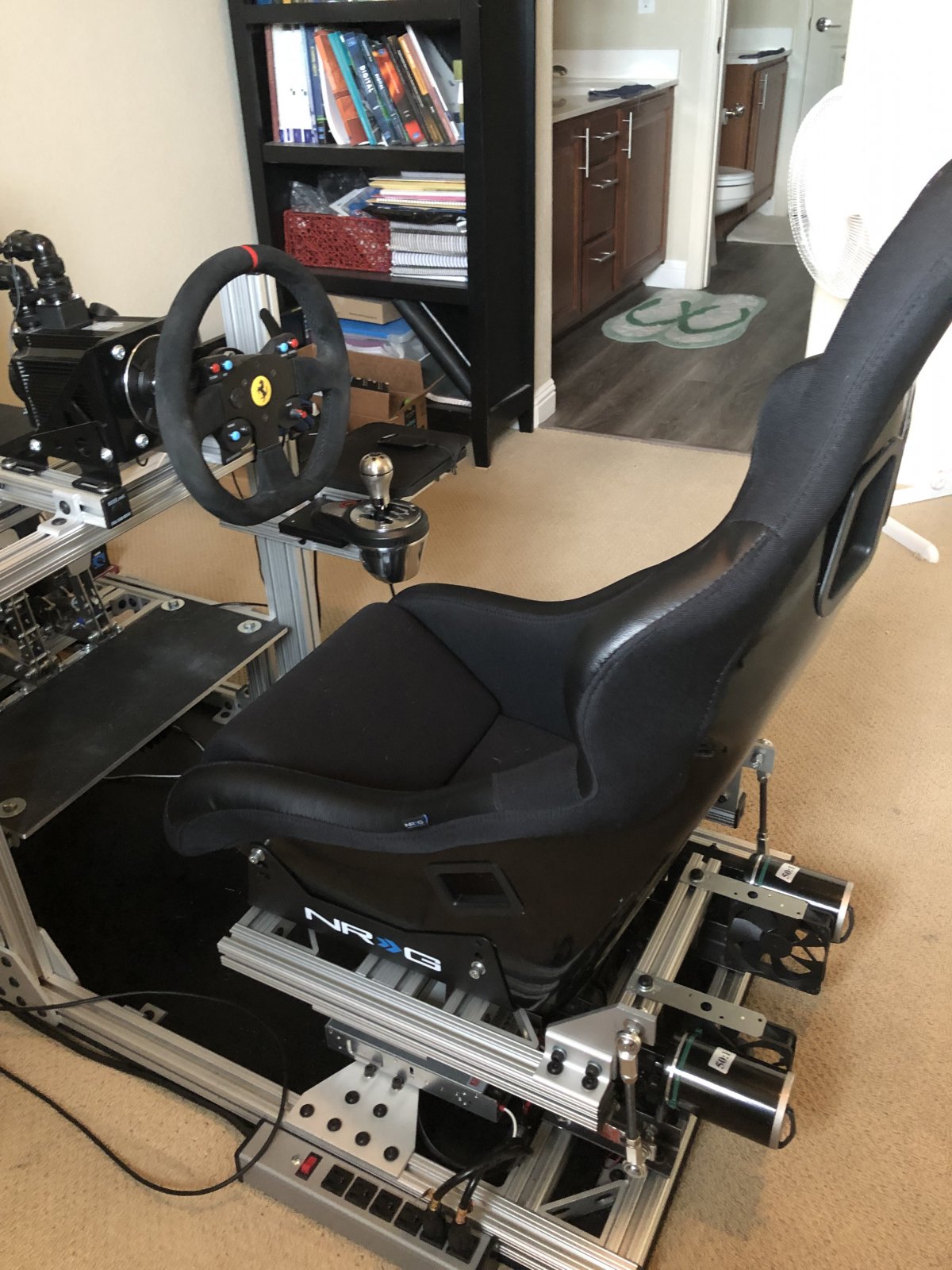

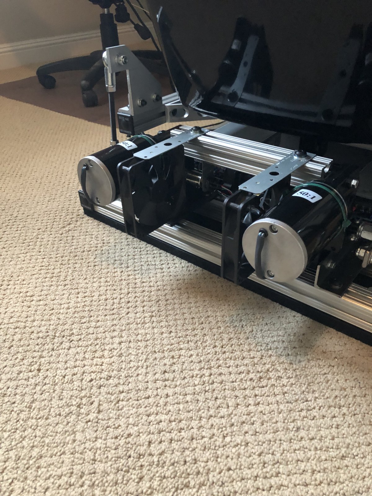

    Upgraded to proper bucket seats and added fans on motor for cooling.

    The ideal is to use the "simcal" tool to calculate the force and angles, the very powerful power supplies, the bad of putting the motors underneath. The closer to the shoulders this support the less effort for your engines.
  18. Watchumacallit
    Watchumacallit BMET- Lead
    Oct 16, 2018
    76
    Biomedical Engineer
    Las Vegas, NV
    66Coins
    +70 / 2 / -0
    2DOF, JRK
    I know that but i wanted a compact design and this works for me. Motors are strong enough. I have to tone it down because it was throwing me around too much.

    Yes they are new from ebay. I got them from PGsaw ebay store. Very powerful motors geared 50:1 for more torque.
