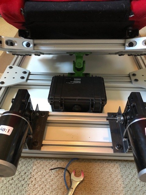

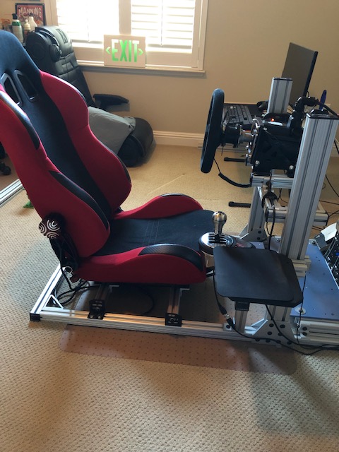

    Starting my first DIY motion sim build. Hope I don't screw anything up too badly. I want to Thank @noorbeast for answering my noob questions and @Kranky Pantz for sharing his parts list and also answering my questions.
    Originally I wanted to build a motion platform like @Erwan960 as I have a similar rig as his but I was afraid my OSW and pedals where going to be too heavy. So decided to go with a seat mover instead.

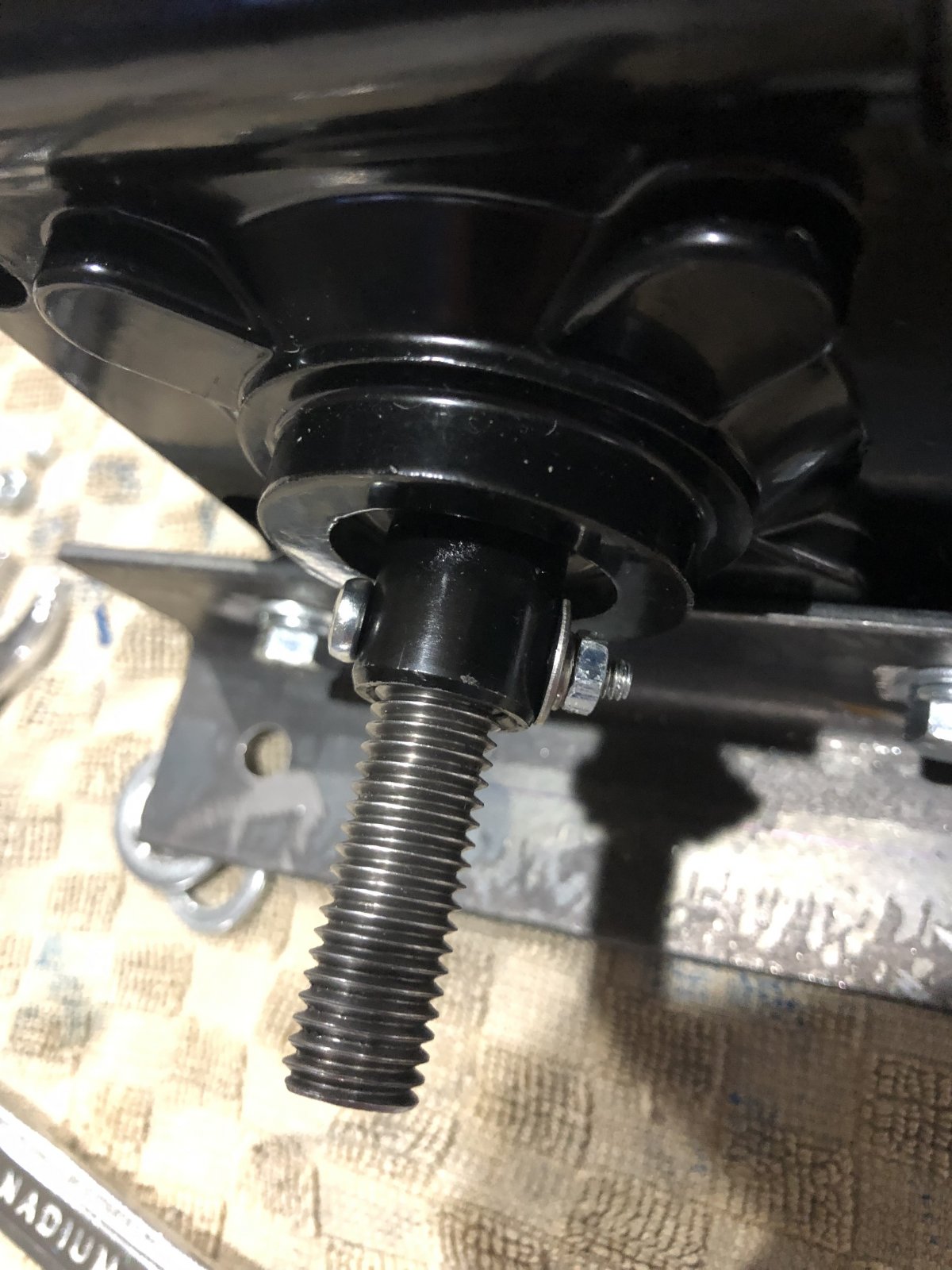

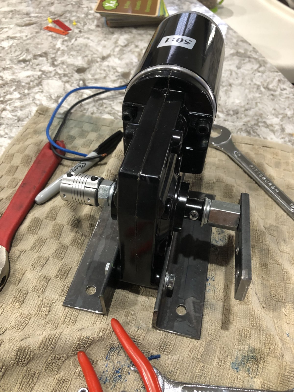

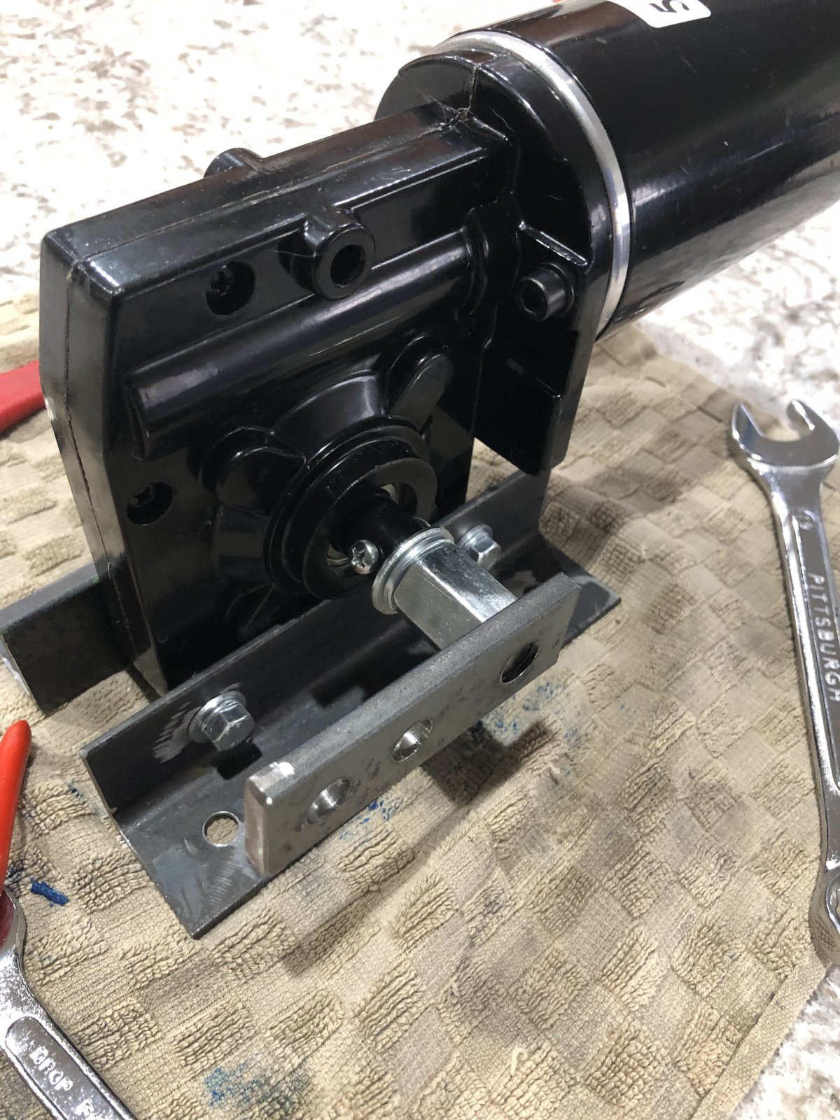

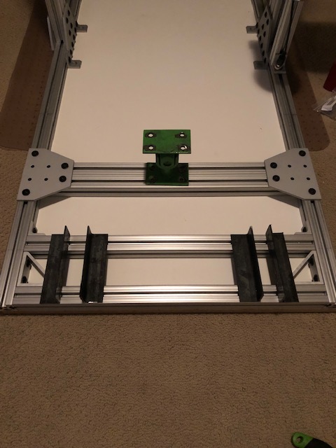

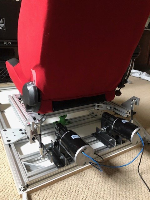

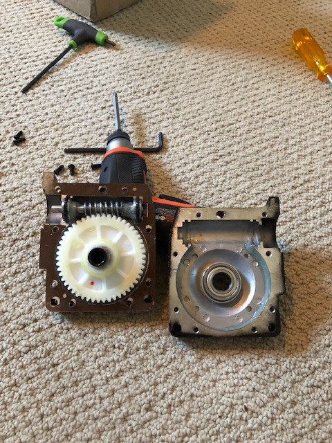

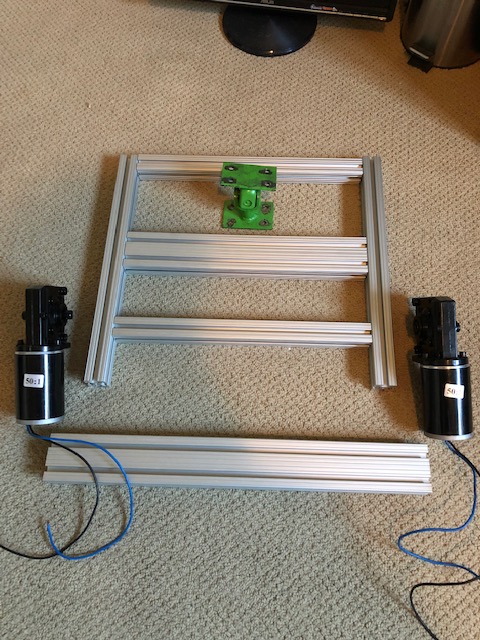

    Ordered my motors and U joint(Yea, it was painted green by seller for some odd reason) from PGSaw ebay store and some more aluminum profiles. Drilled holes on mounting plates to accommodate profiles.
    Had to dis assemble one of the gearbox to turn shaft around.

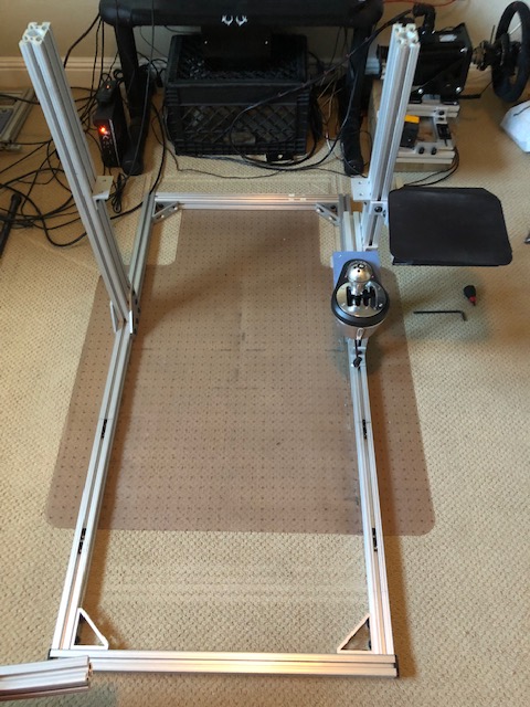

    Dis assembly of the rig and mock up. Got L brackets for motor mounts from local hardware store.
    Will soon drill holes on brackets and attach motors and chair to frame.

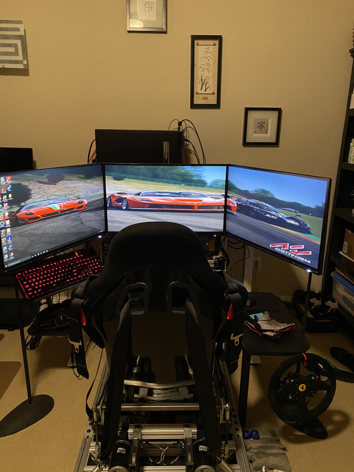

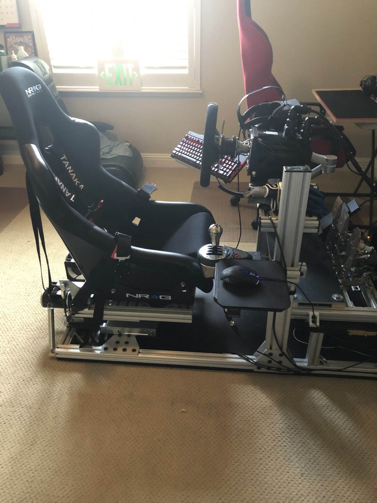

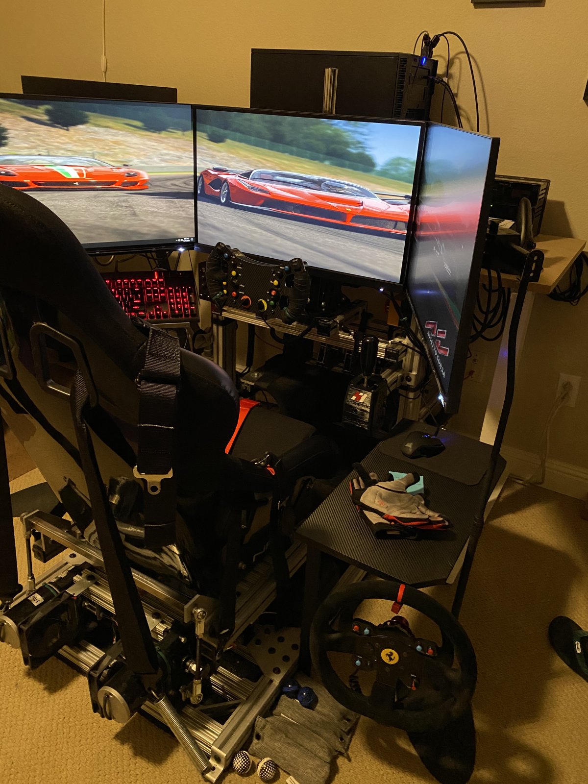

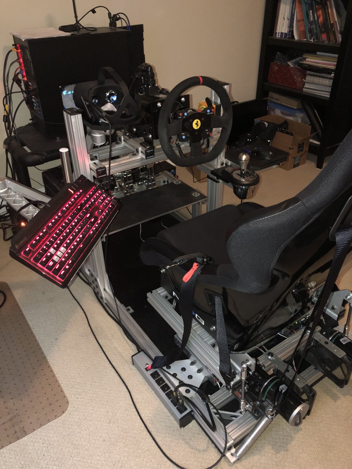

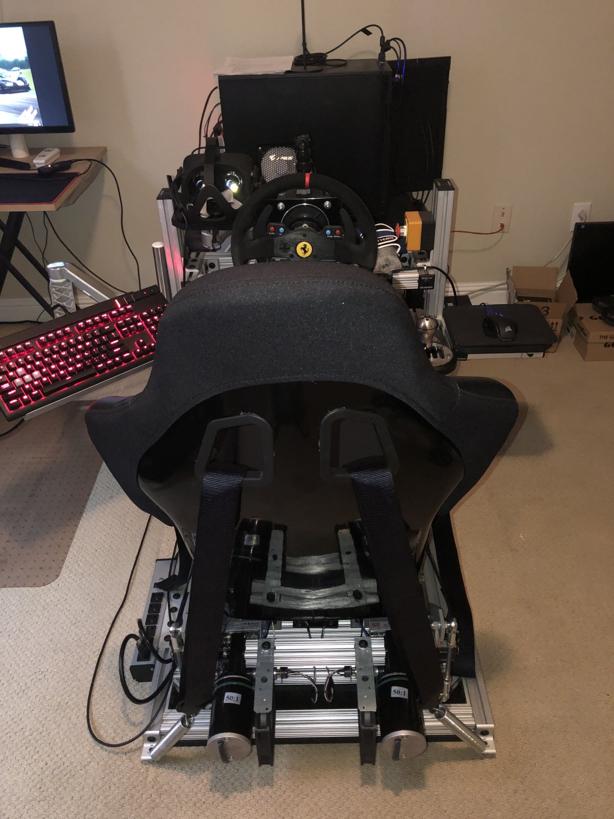

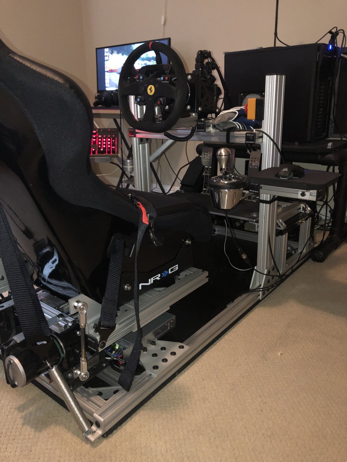

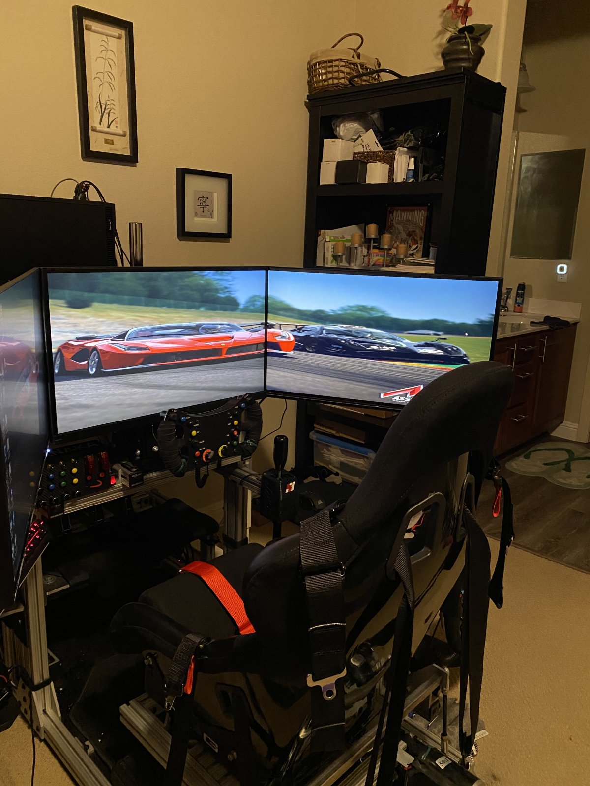

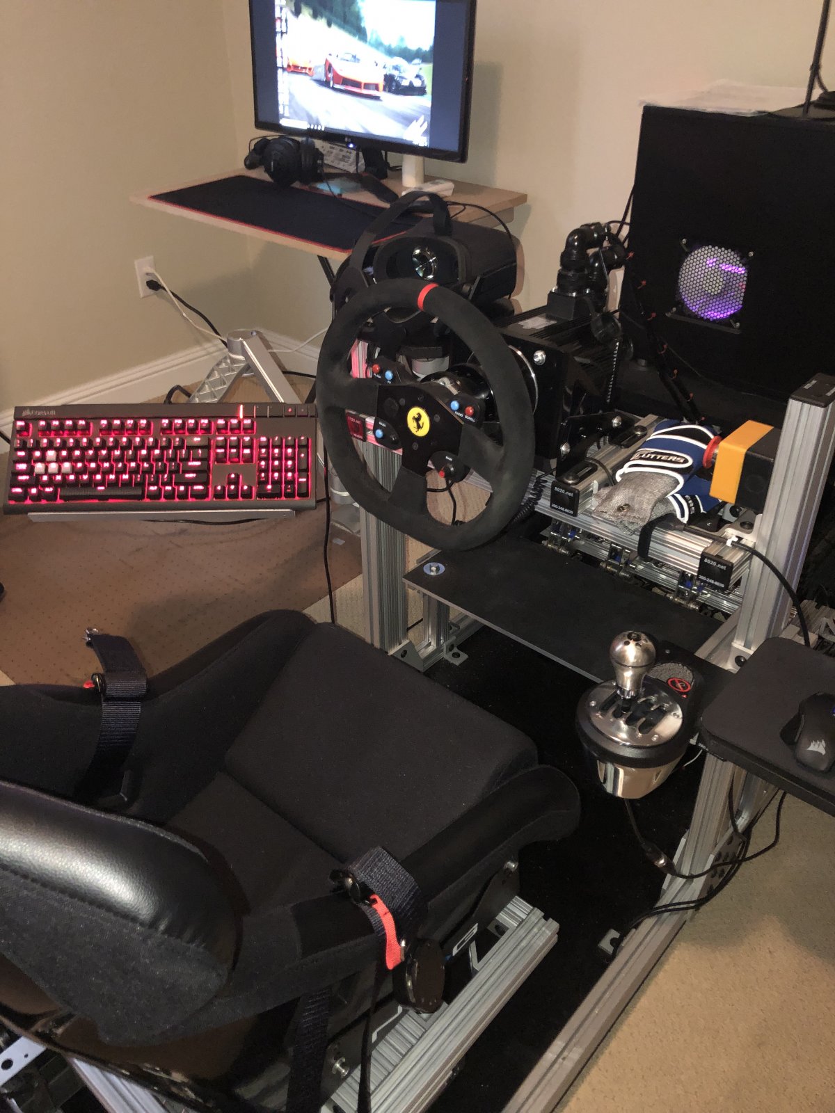

    Completed Build!
    IMG_2372.jpg IMG_2371.jpg IMG_2370.jpg IMG_2369.jpg IMG_2368.jpg IMG_2366.jpg
    F576E0AB-93A6-4CB7-9512-516871B7F4F6.jpeg 24A15C49-1842-4E82-9271-39721B278BBA.jpeg D61DC9F1-7BB4-42F6-A5AC-E1BB9509ABBC.jpeg

    Am I seeing that right, are you using a TM Alcantara 599xx Evo rim on your OSW wheelbase???
    Did you make a custom mounting ring or something, and also...do the buttons work????
    Pretty slick!!!

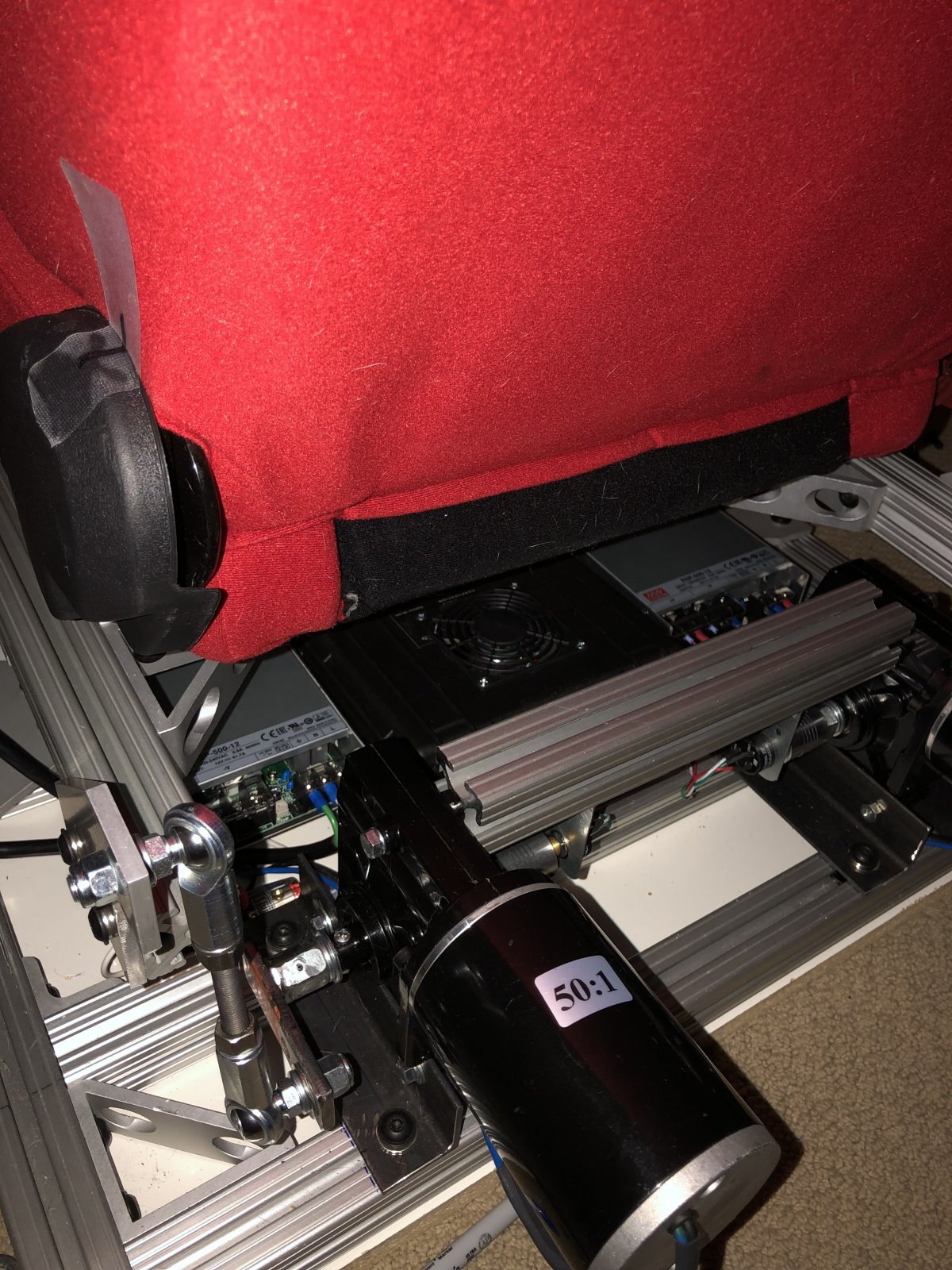

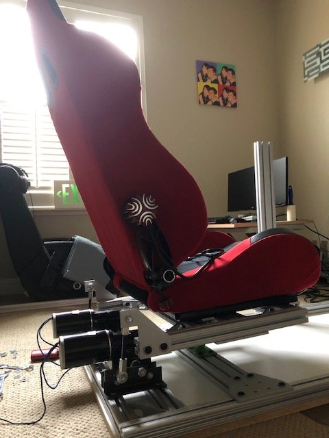

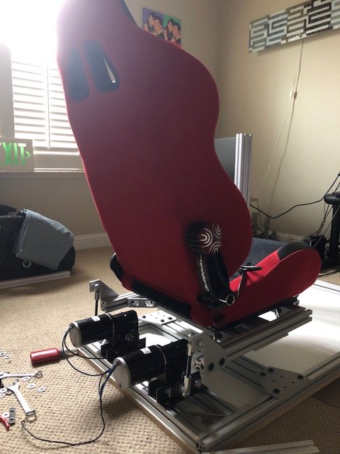

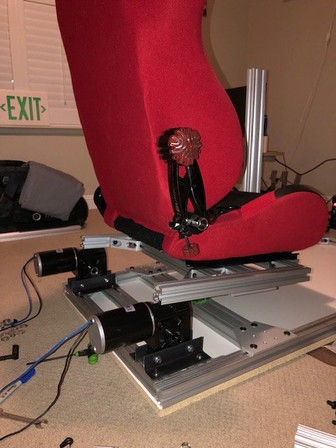

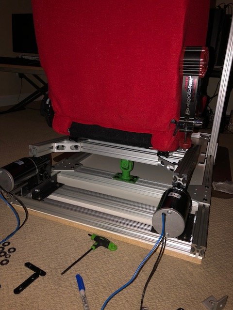

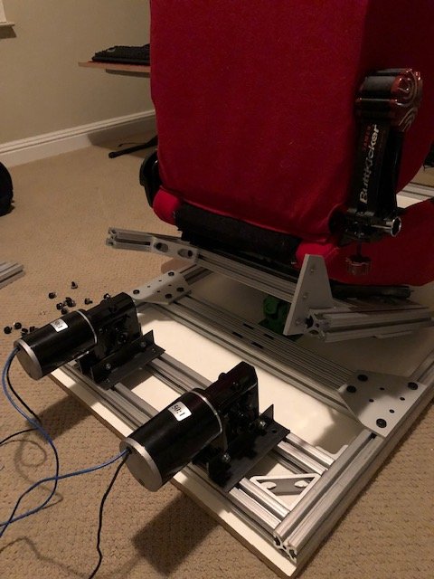

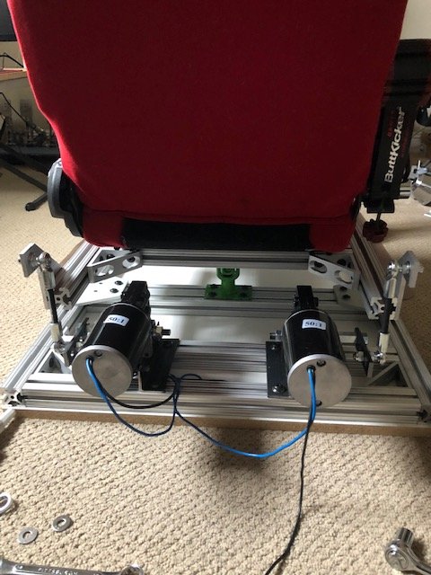

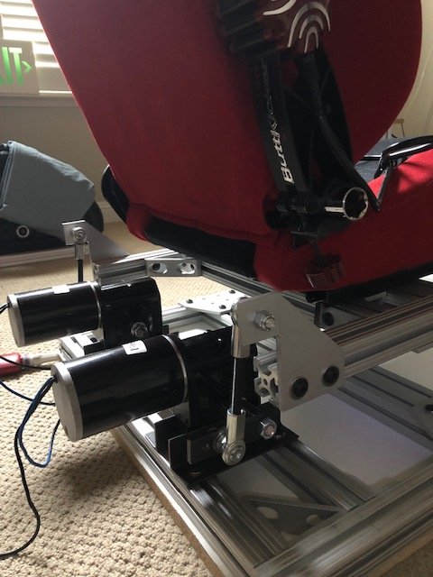

    Seat and motors mounted.
    Was going to put motors under seat but not enough height. Didn't want to go too high as my wheel deck and pedals will end up being too low.
    Turned motor around and will face levers backward toward the motors.

    Lookin' gooood my man!!!!!
    I'm glad that your order from PG Saw made it out prior to the effects of our postal strike here in BC, it's really bad now.
    That's the beauty of having all of the parts on hand, you can make changes to their orientation as you see what works best.
    Do you have your electronics box sorted out, along with the power supply(s)?
    Heeeeyyyyy, those dual motor L-brackets look awfully familiar, LOL!!!
    I can vouch for how solid that system is, and if you can also add a rod between the spare holes on the top of the motor gear casings it'll be even sturdier.
    Mine also doubles as the hanger for the feedback pots, so it serves a dual purpose.

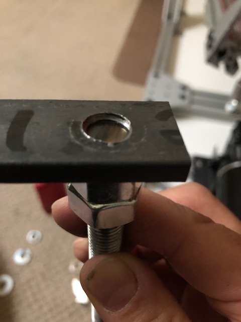

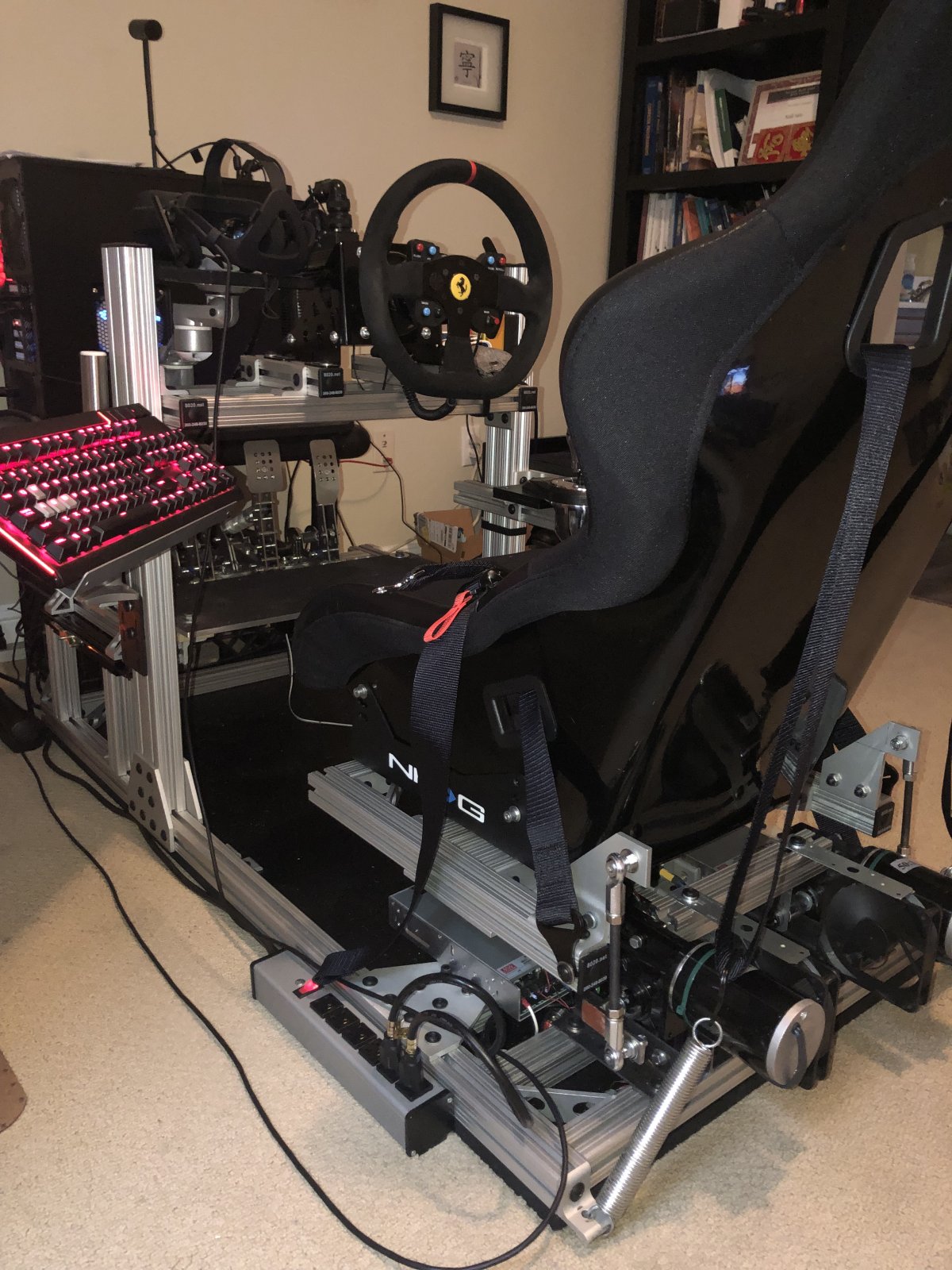

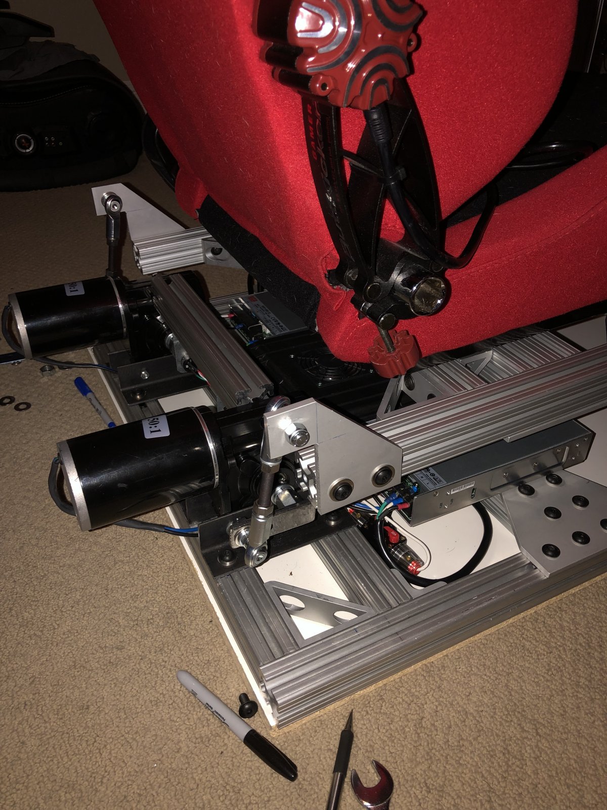

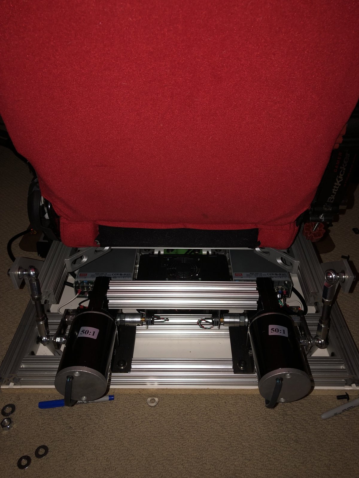

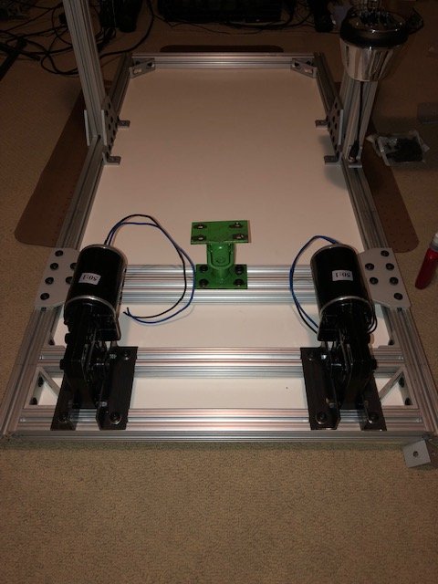

    Today I was able to put levers and push rods together. its looking more like a motion rig now!:grin
    Will weld levers to 12 mm rods when everything starts to move so I can still make adjustment if i need too.

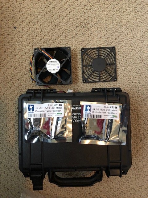

    Next up Control box. Got this pelican case that will fit JRK's and fits perfectly under the seat.

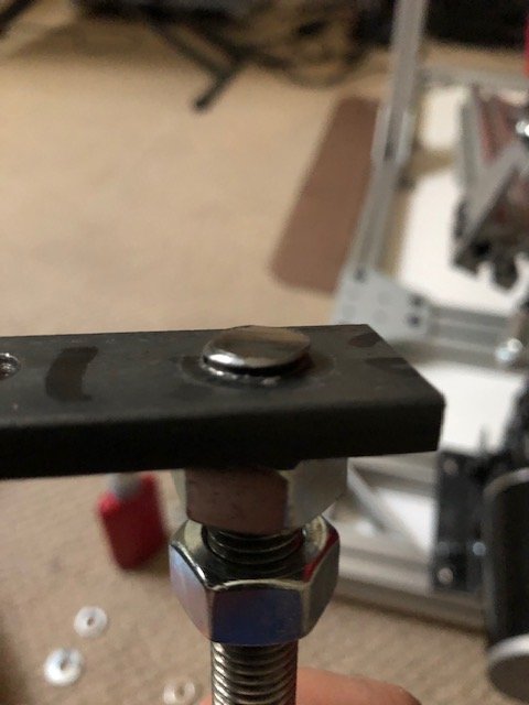

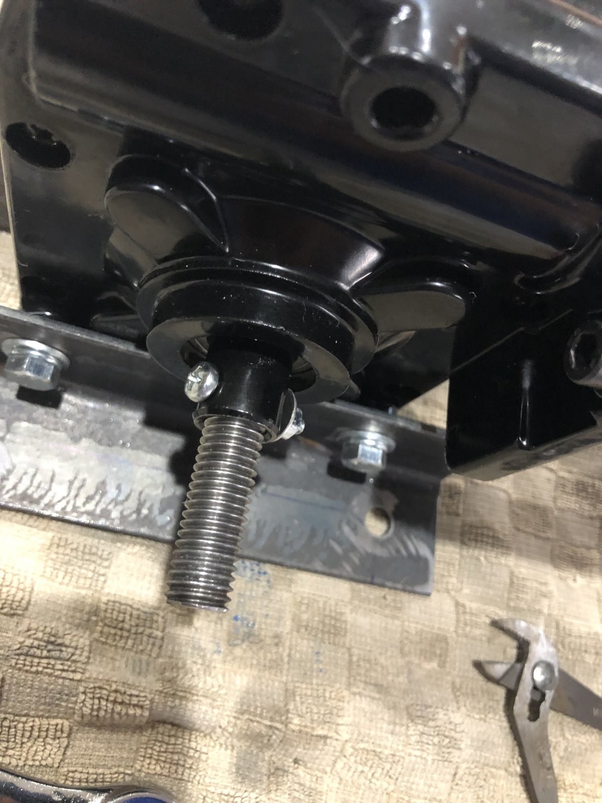

    Bwoah, didn’t get much done this weekend as this thing called “family time” got in the way, smh!;)
    Drilled through rod and tapped with m4 screw to prevent it from spinning independently.
    upload_2018-12-16_15-41-7.jpeg upload_2018-12-16_15-40-26.jpeg upload_2018-12-16_15-39-29.jpeg
    Finalized gearbox and levers.

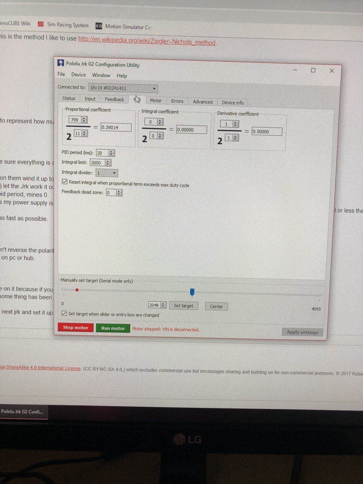

    I am experiencing a little problem though. One of the two PSU keeps cutting off and tripping. Sometimes it’s the left and sometimes it’s the right. I don’t have cheap knock off power supplies either. I have meanwell units so I doubt it’s that. Maybe it’s one of the setting in the JRK utility.
    On the end of this video the left PSU tripped.
    If anybody have any idea why the PSU is tripping, please let me know. Thanks!

    A few suggestions.
    With a lever range anything over 40 degrees up and down is really inefficient in terms of torque utilisation, and yours look like they are well over that.
    How well is the rig balanced,with you in it, as it is a bit hard to judge from the camera angle.
    What is the CTC distance on the levers, because on a compact design torque matters more than lever linear speed.

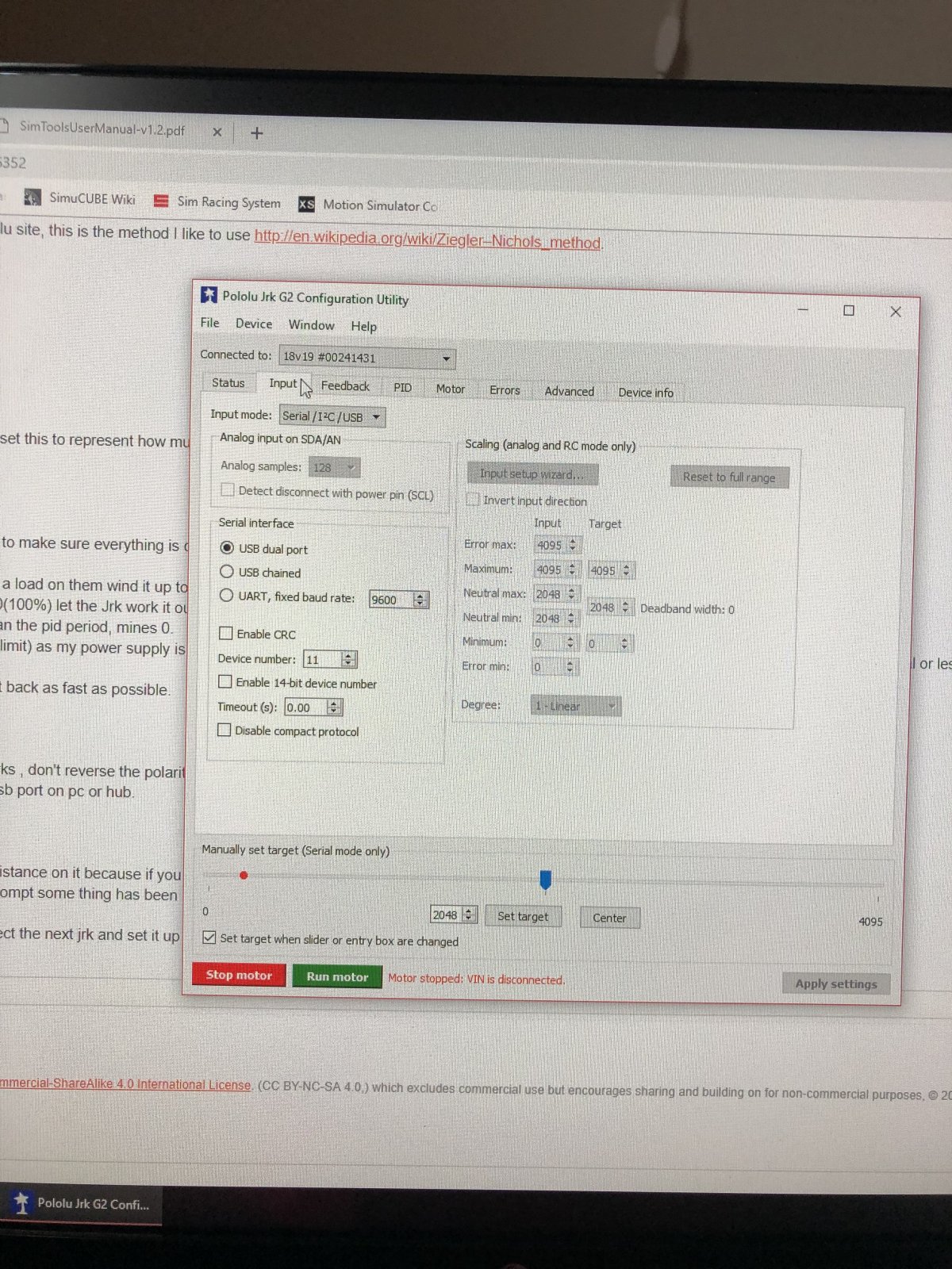

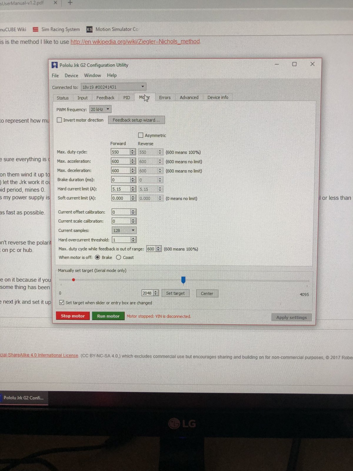

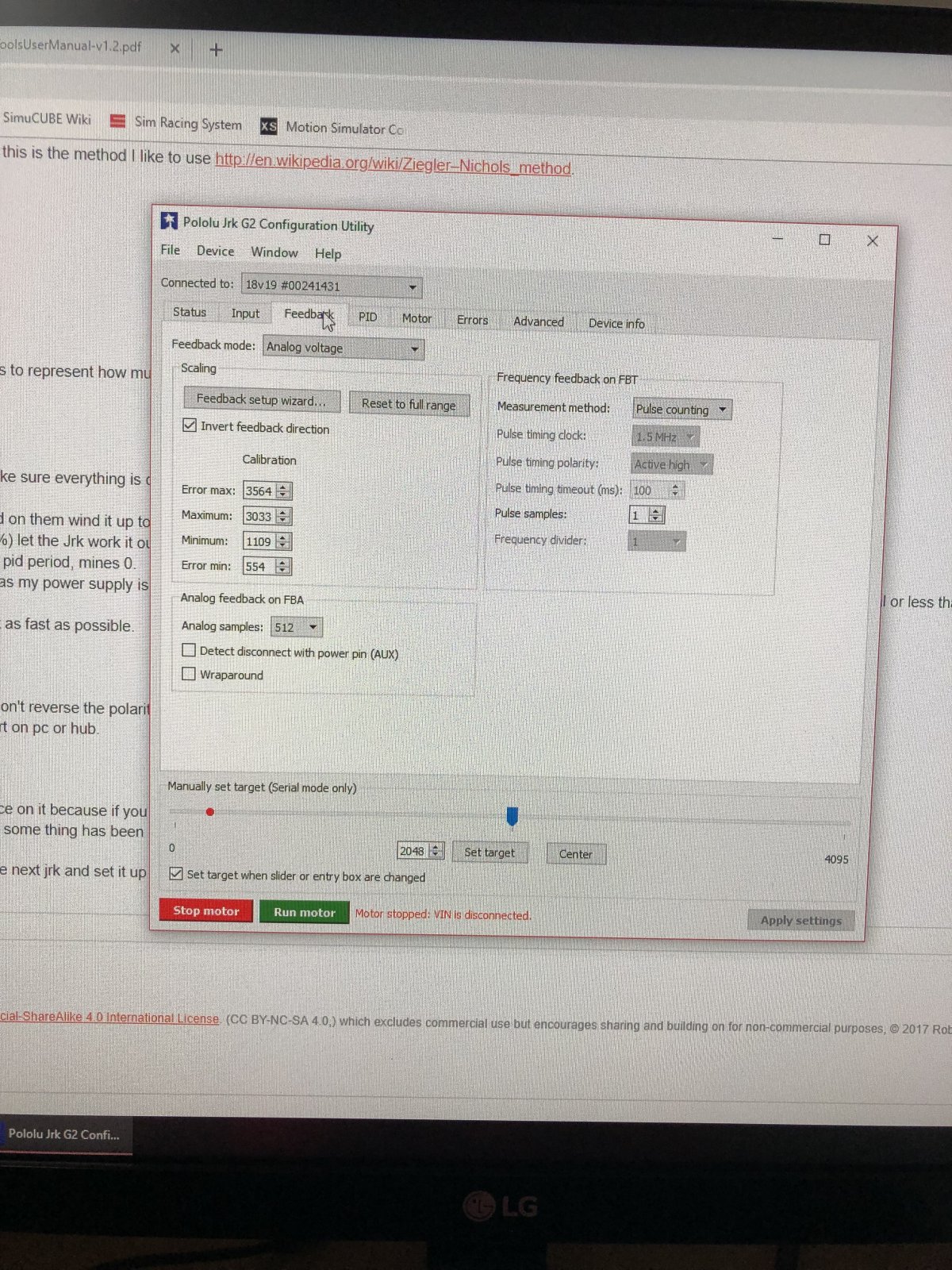

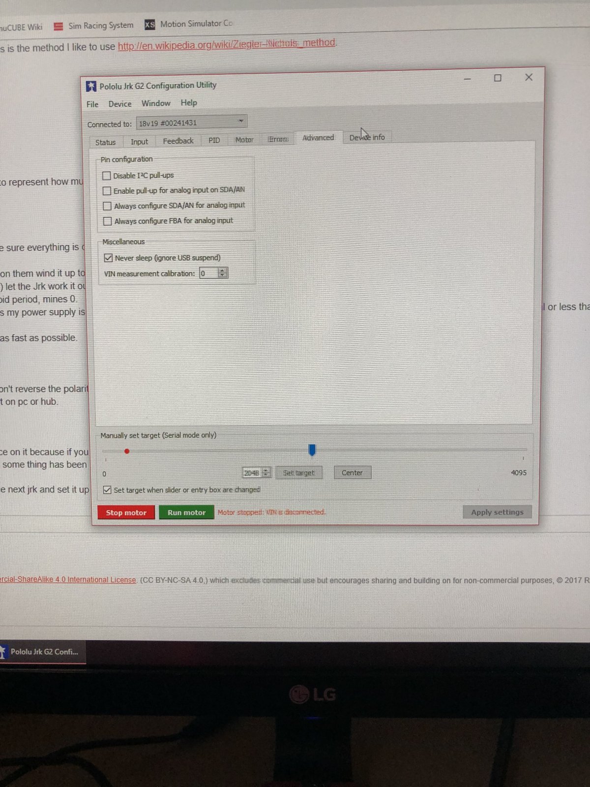

    Are you using clip on ferrite magnets on usb cables, as that and good cable management will help mitigate interference.
    Can you please post pictures of all of your JRK settings.

    Hey Noorbeast,
    Yes, levers does go over 40 degrees up and down. It’s set to 45 degrees right now. I’ll lower that to 40 degrees.
    It’s well balanced as I sat on it before I installed the motors and levers and was able to keep my self up for a while with out tipping over.
    CTC distance is 50mm
    Ferrite magnets check. Have it on all my usb cables as OSW also produces a lot of EMI.
    Here is my JRK G2 utility settings
    Thanks for your help!

    Called Pololu support and suggested to add shunt regulator between PSU and JRK G2’s.
    Installed shunts and no more PSU cut offs.
