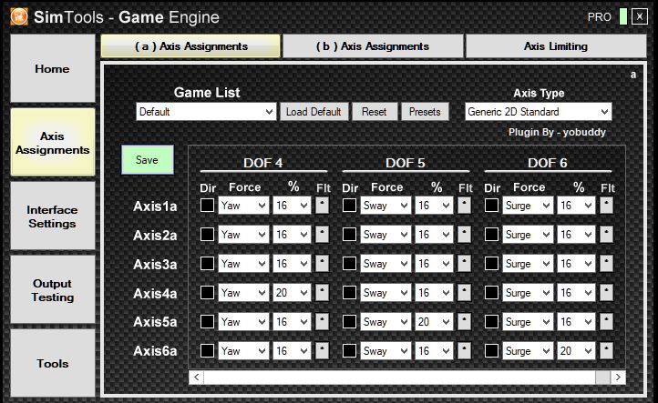

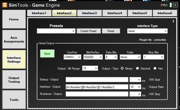

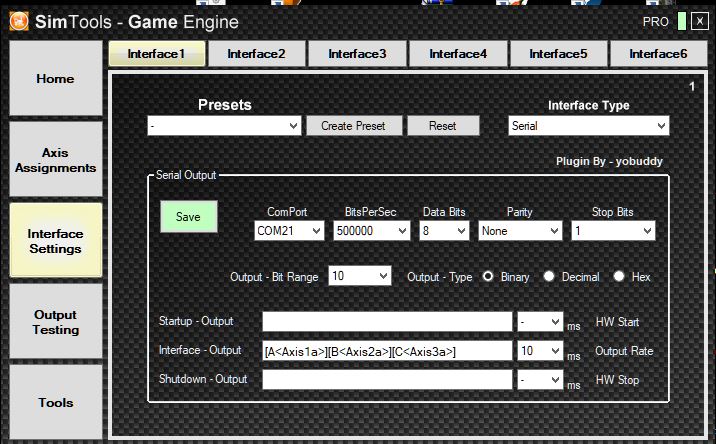

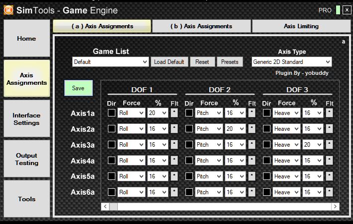

    Hello my fellow XSim Community,
    I joined the Xsim community in mid 2019 and have successfully built two Motion Sims, (1) 2DOF + TC with UNO running SMC3.ino driving Wiper motor via IBT_2 and
    (2) 2DOF +TC with UNO running SMC3.ino driving 200W motors via IBT_2.
    Now I am embarking on building my third Sim; a 6DOF with 2 UNOs, each running SMC3.ino and driving 3 x IBT_2 + 3 x Wiper motors.
    Having read all the available information on the 6DOF in Xsim, I am sure that my proposed set up is quite feasible.
    Before, I start to build anything, I would like to get your feedback on the
    my proposed SimTools Axis assignments & Interface settings.
    Axis Assignments
    Interfaces
    Any feedback and suggestions, especially on ticking the correct DIR boxes for DOFs are welcome.

    Have you actually tested if wiper motors are powerful enough to drive a 6DOF?

    Thanks for your prompt response.
    No I haven't tested whether the Wiper motor are powerful enough. I will first try them with some provision to replace them, if necessary, with the 200W motors that I used for my second 2DOF+TC.
    My concern is whether the SimTools can handle two Ards UNOs connected as Interface 1 & 2 on separate COMs?
    21,603
    151,275Coins
    +11,033 / 56 / -2
    SimTools can handle the Arduinos, but I doubt wiper motors can handle a 6DOF load.
    I suspect even the 200w would need low ratio gearboxes, but someone like @SeatTime could give a more authoritative opinion.
