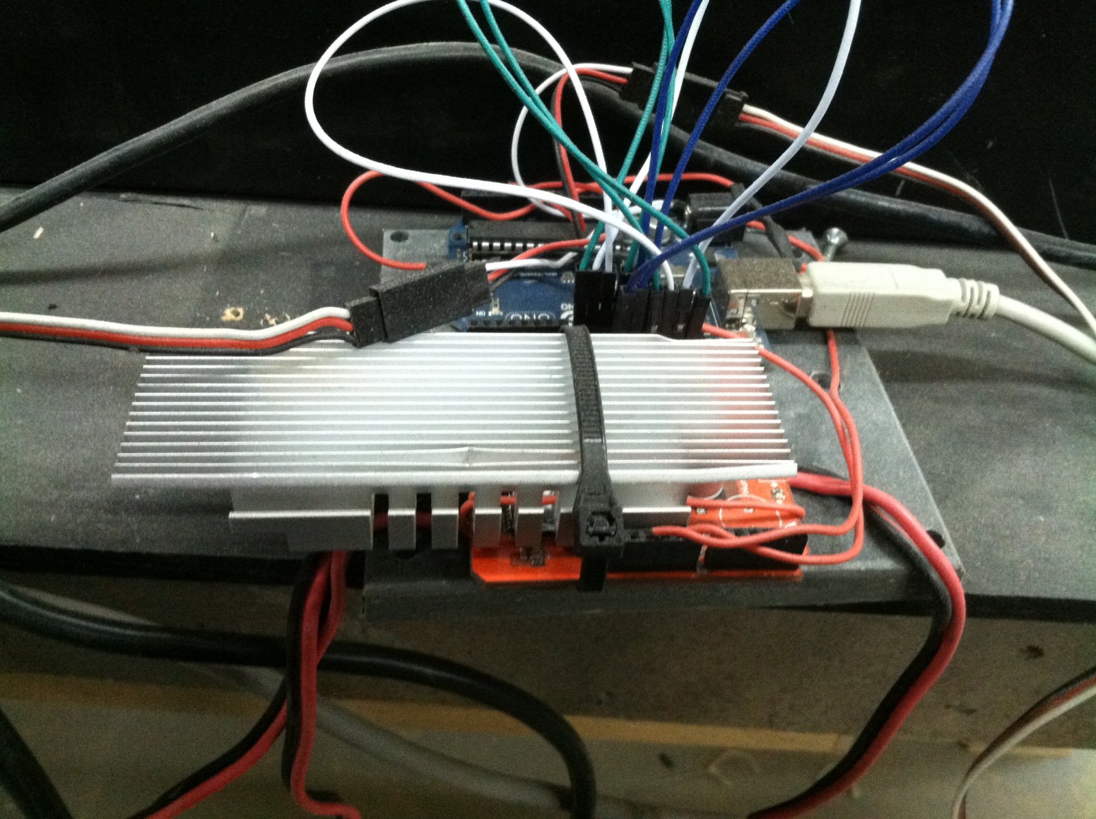

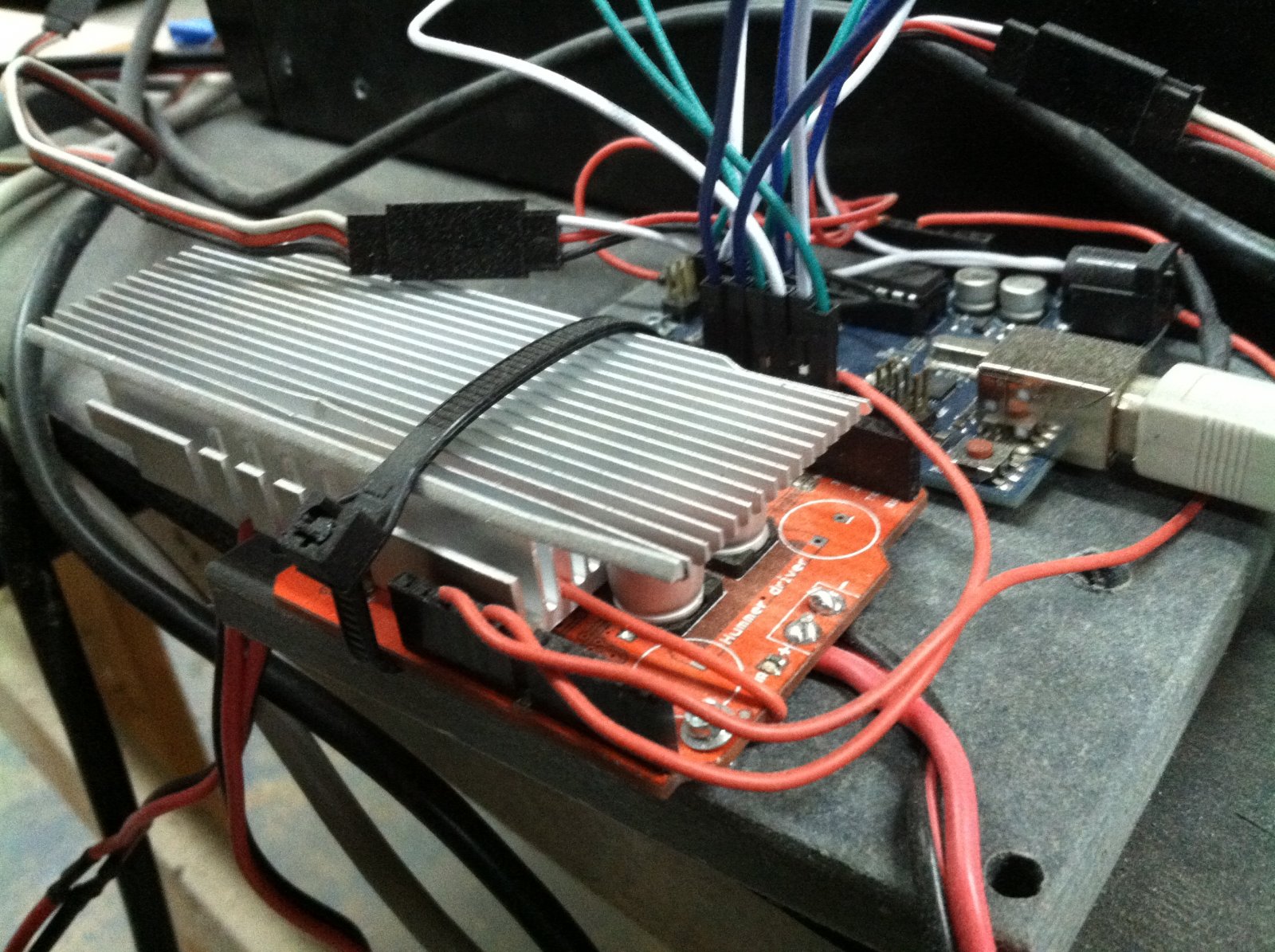

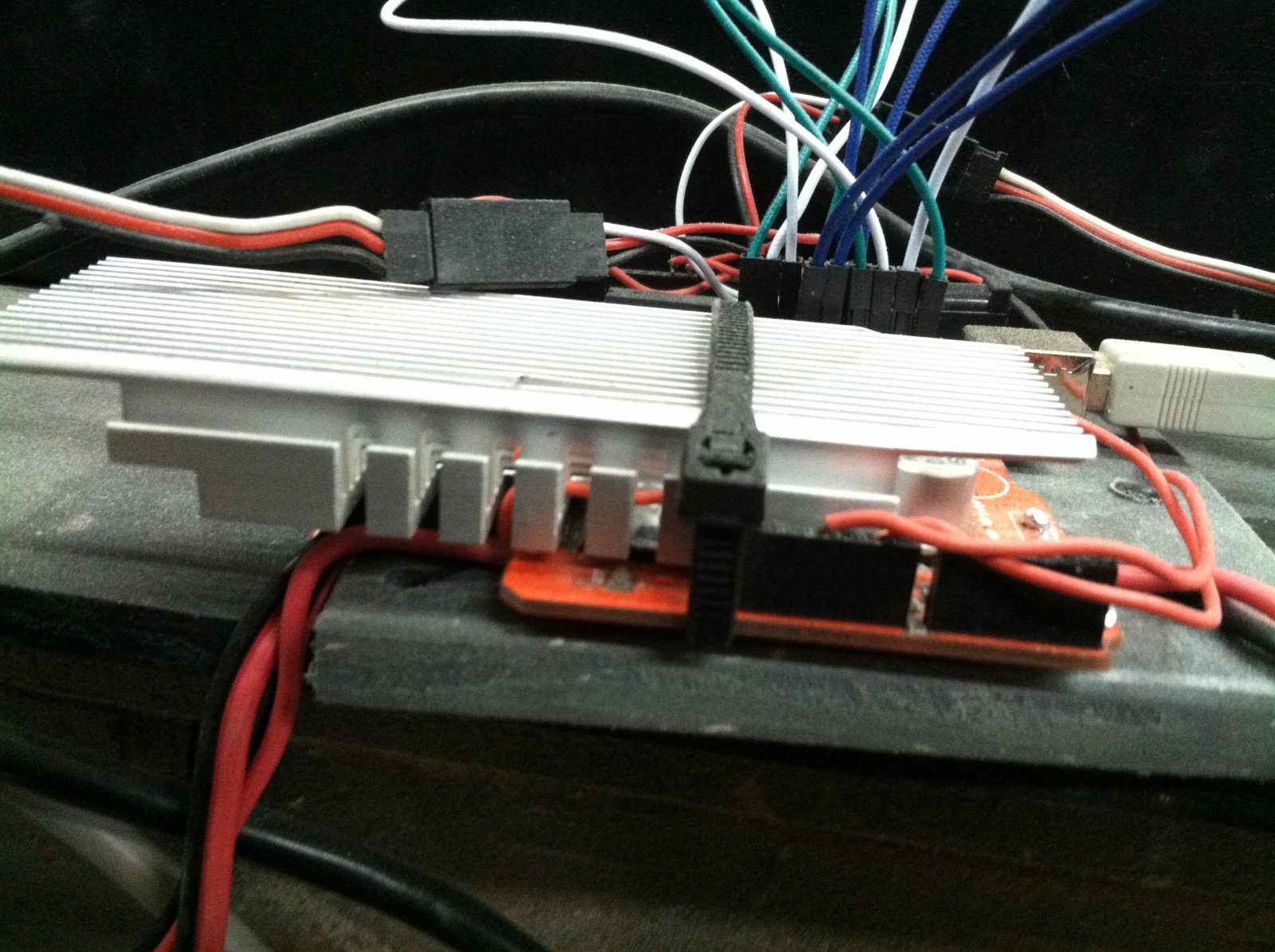

    I also mounted monster heat sinks on the Moster Moto drivers :)
    They get a little warm but not at all hot during constant motion. I am sure that with a load on the platform (I actually have about 75lbs of plywood sitting on it right now) it will get much hotter. I do have fans that I can place over them as well, just have not yet wired them to the 12v input yet. Need to get that done as well.

    I am running two motors with Priliad's code and utility, two with RufusDufus's code and utility and two with RacingMat's code. All seem to be performing well, but I think I will convert them all to either Prilid's or Rufusdufus'. RacingMat's code works great but with the other two I can fine tune the settings using their respective utilities.
    The heat sinks on the Chinese Monster Moto shields, they are massive. I had an old (and dead) GPU in a drawer, after cutting the scavenged heat sink in twain the pieces fit perfectly over the chips on the Chinese Monster Moto shield.

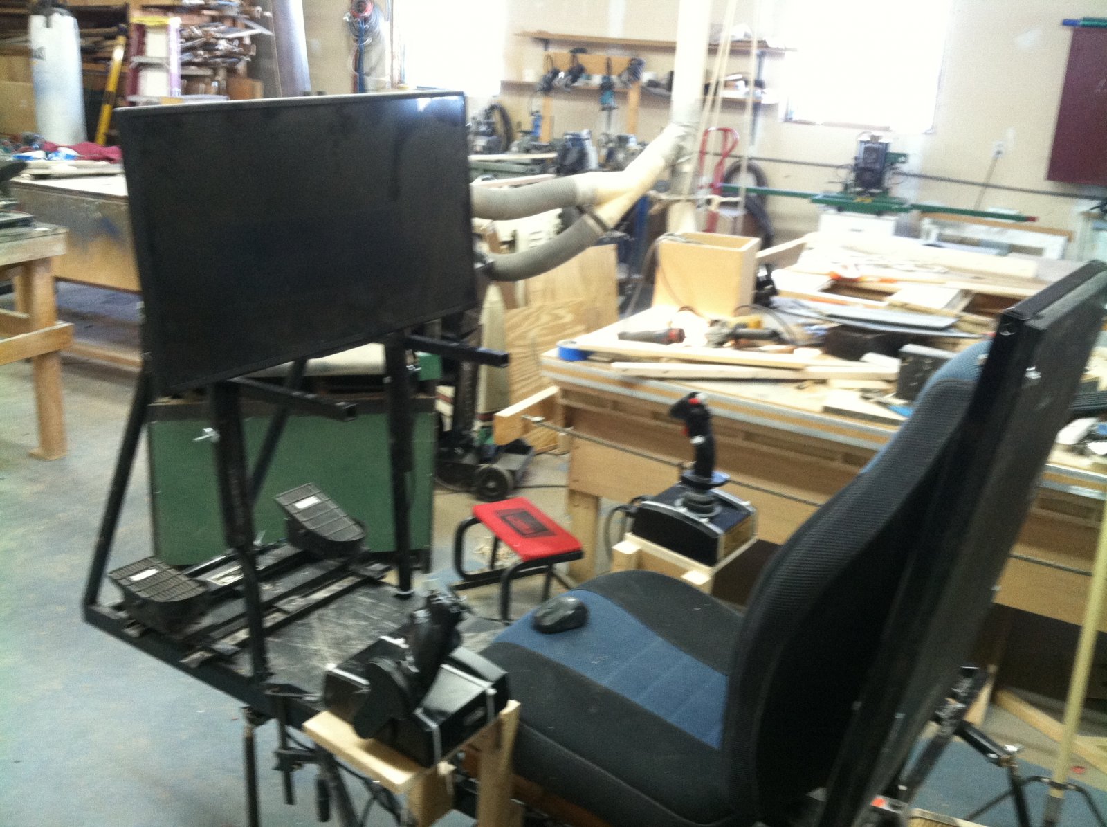

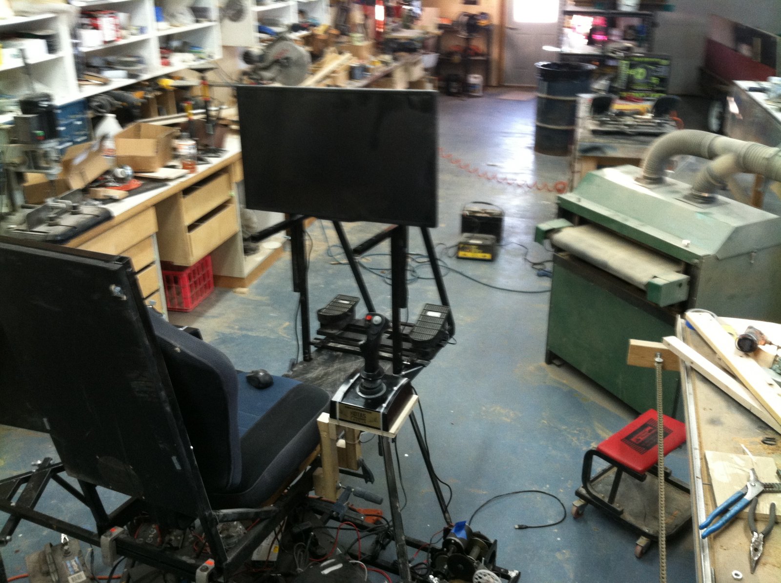

    A few things that I have been looking at today for tweaking; I am not sure the heim joints are going to work, there is not enough range. I might have to mount the bolt holes at an angle to help or just make miniature u-joints for each connecting rod; not looking forward to that.
    Also added a HOTAS (Hands On Throttle And Stick) rig today so I could test flight sims properly. I picked up a used (and broken) Thrustmaster Cougar set last night, repaired it today, and mounted it on the platform. Here are a couple of pictures. I will have more videos up when I figure out the Arduino issue.
