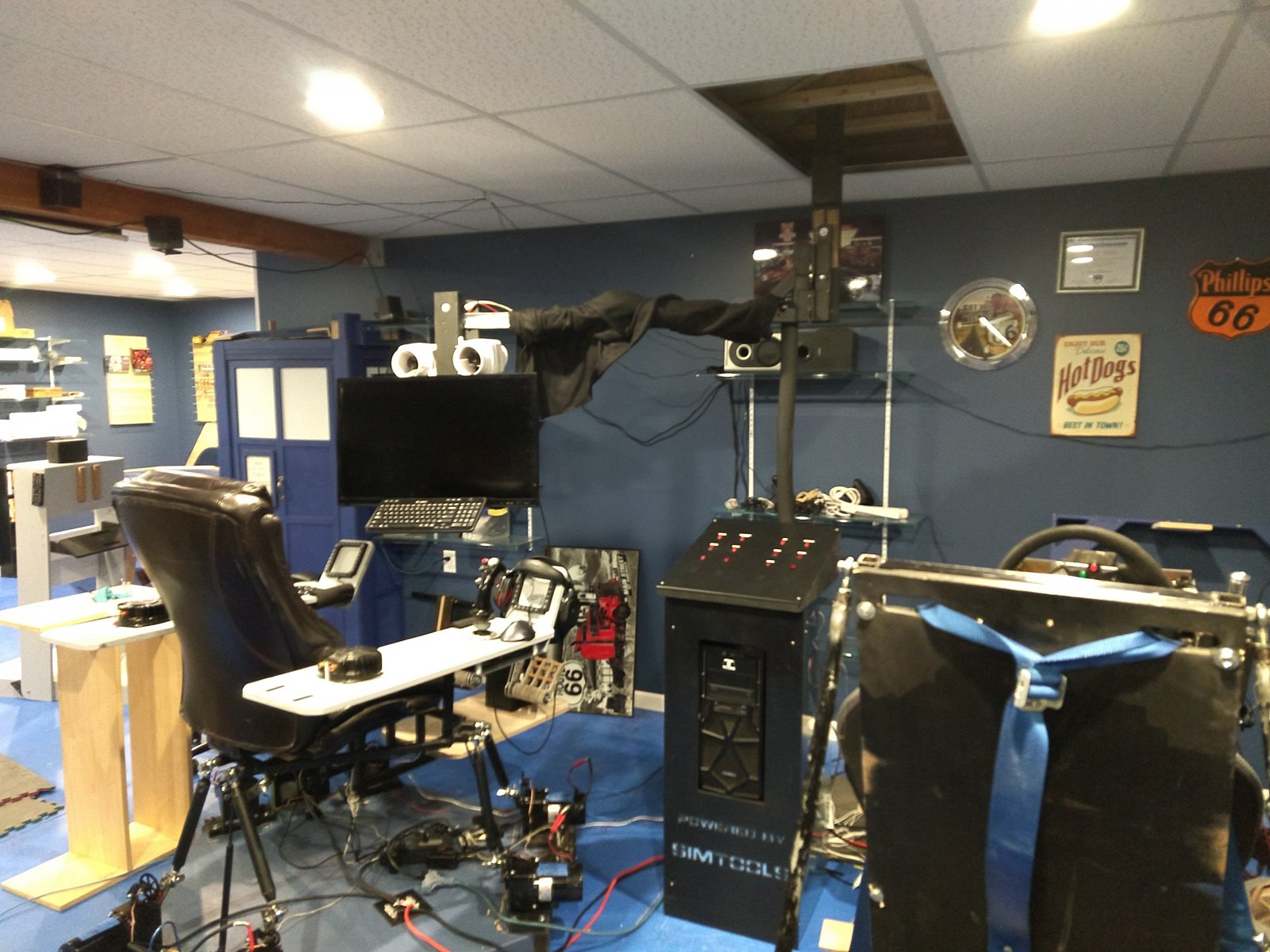

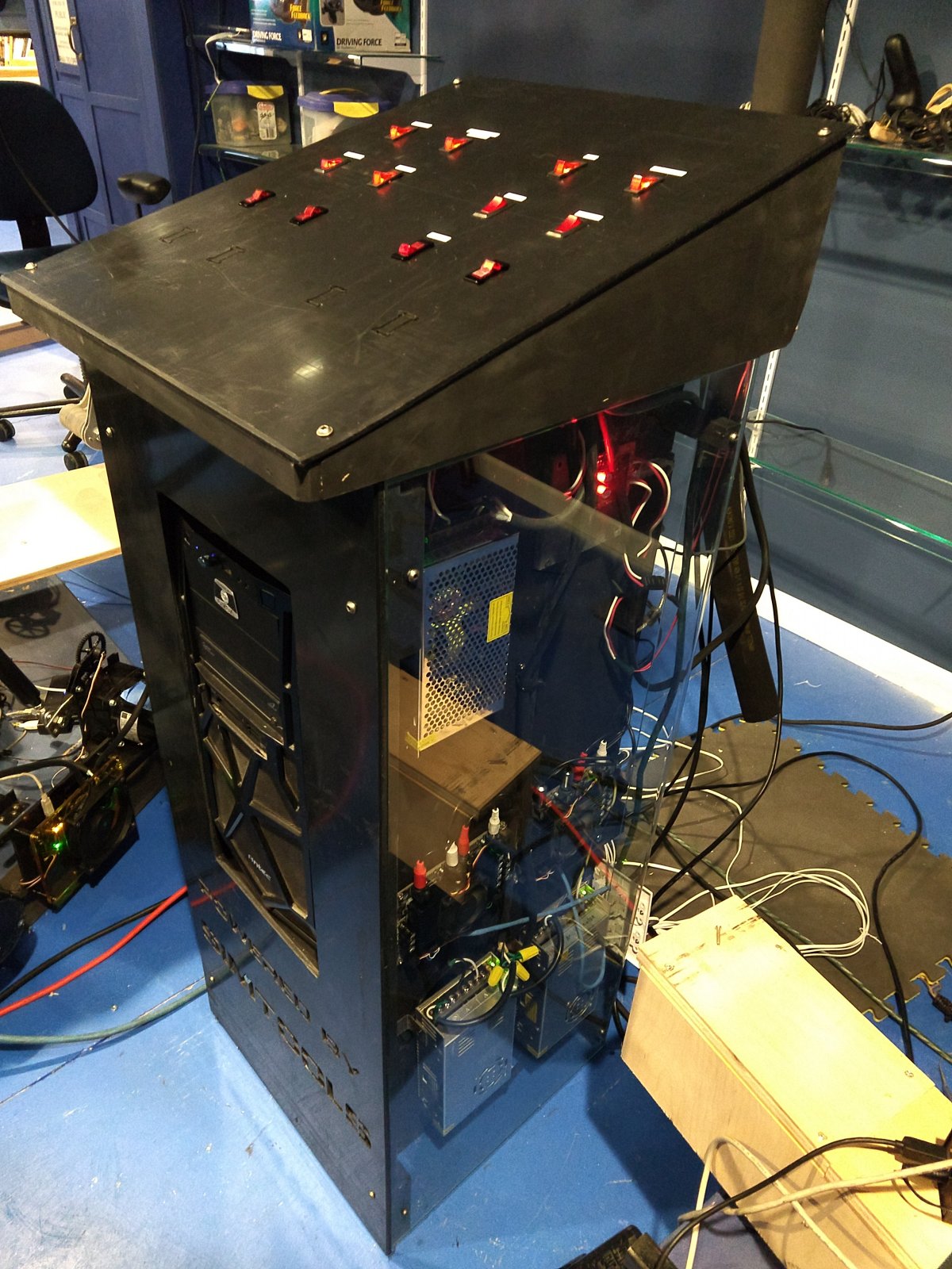

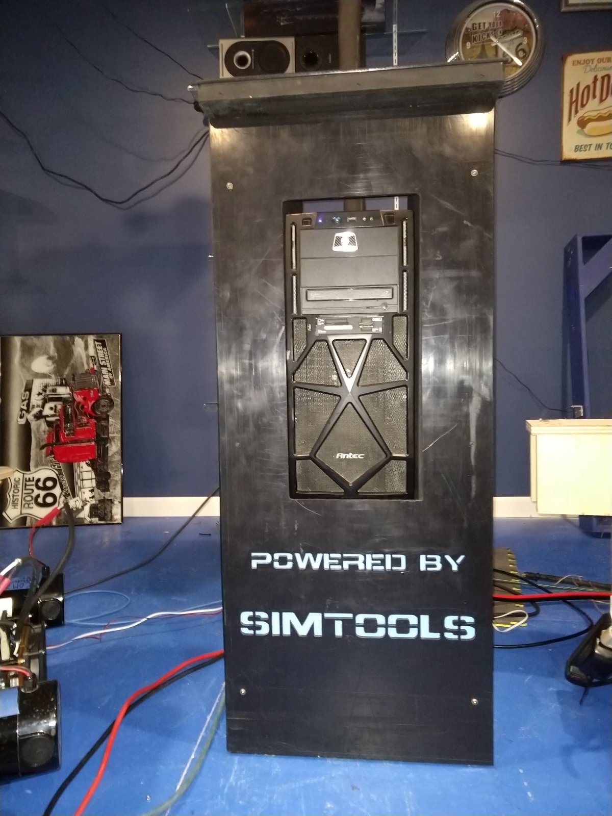

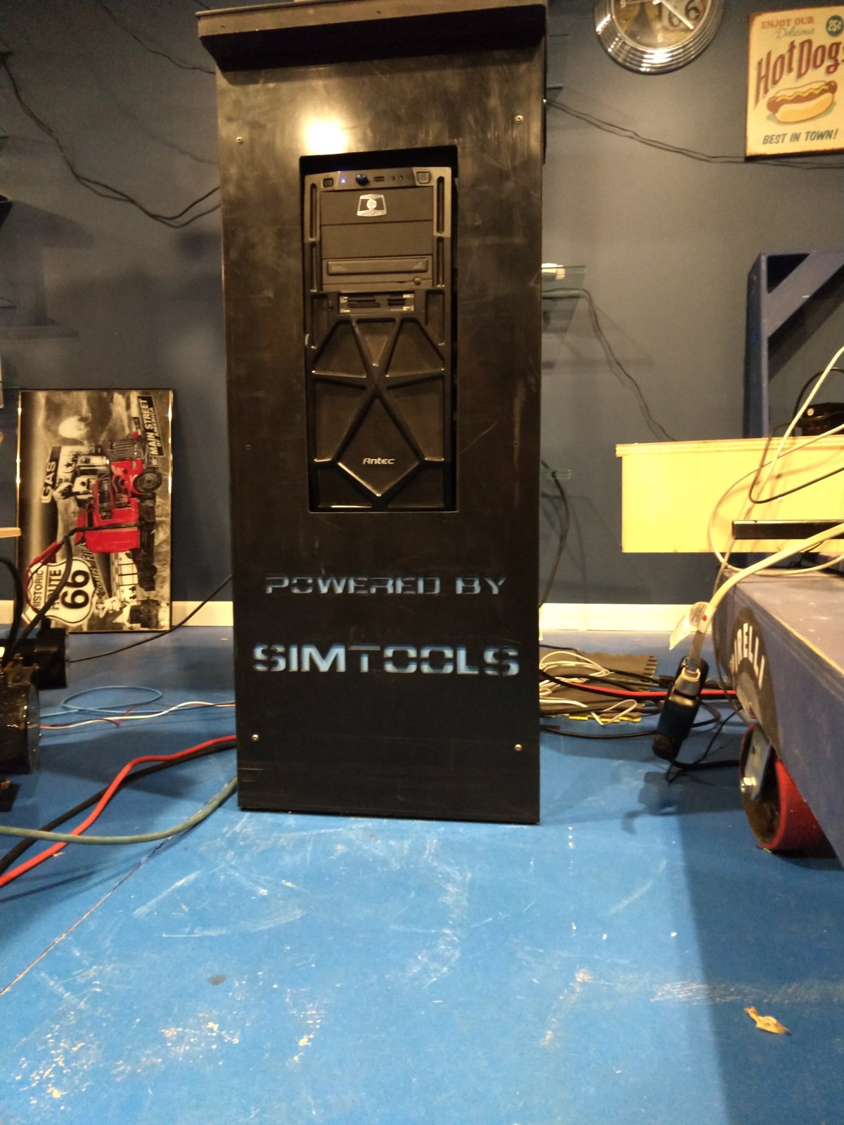

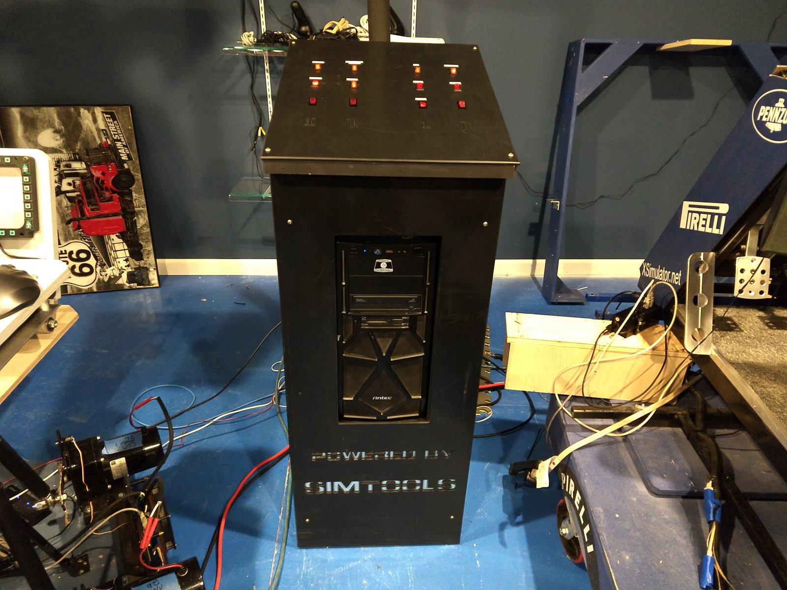

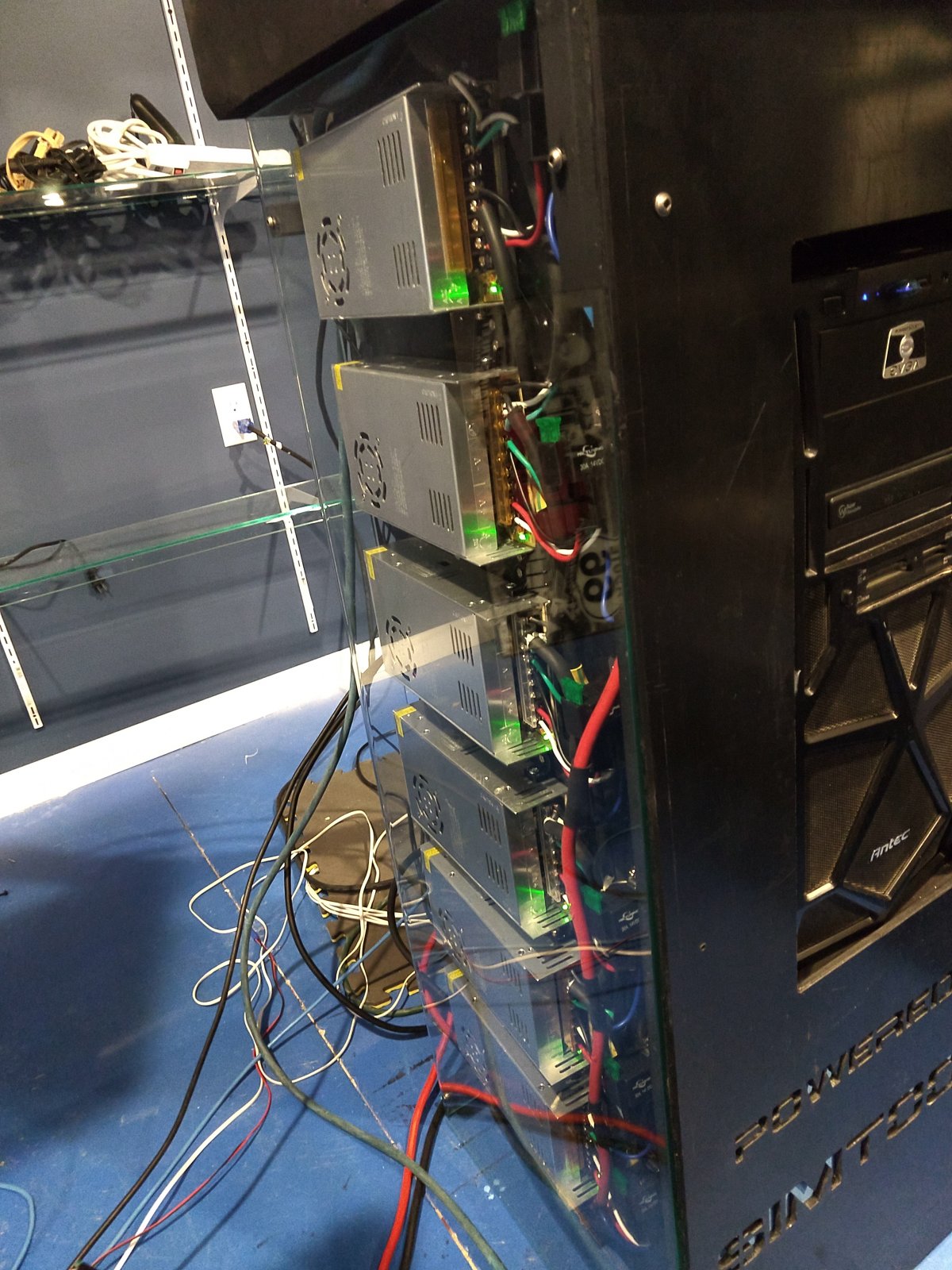

    I wanted a way to control both my driving simpit and my flying simpit on one panel so I created a mission control pedestal :)
    One of these days I will complete the top plate with engraved panels, etc. Still working out how, exactly, I want that to look.

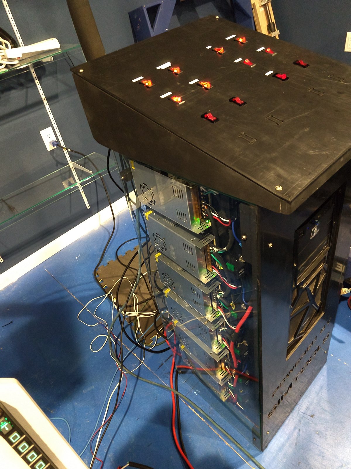

    The power supplies are used by both simpits so I use 200 amp solenoids to switch which pit gets power. I doubt that I will ever have to have both running at the same time. Each simpit is fed DC power via 8 gauge wire.
    I have individual power switches for the USB hubs on each simpit.
    The power supplies and 2 @ 4x100 amplifiers are mounted below the simulated wind power supply and Arduino controller/MM driver.
    Forgot to take a picture of the articulated arm that moves the monitor, fans and VR headset between the two simpits. I will get a picture up later. I created the arm with rectangular steel pipe and super heavy duty hinges from a farm supply store. It is suspended from the ceiling.

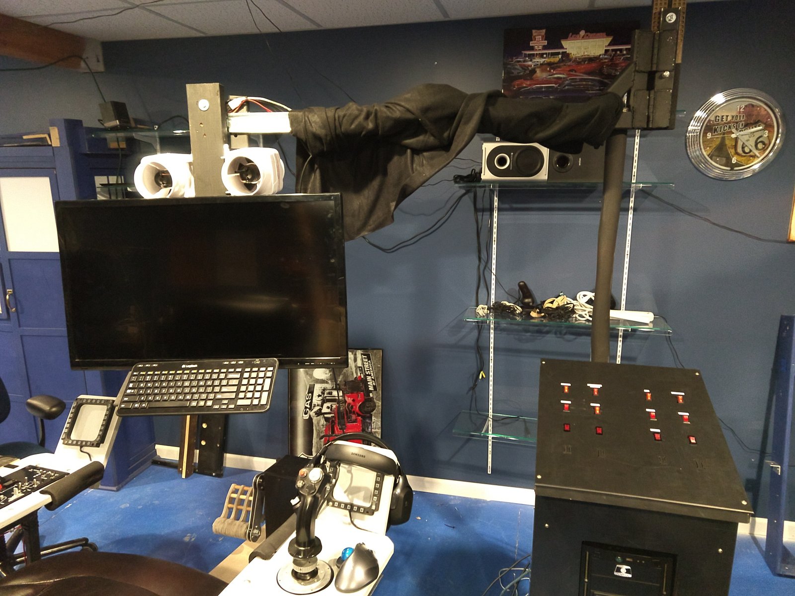

  5. Historiker
    2,161
    9,208Coins
    +2,170 / 19 / -1
    The articulated arm for the monitor and fans. Might paint the fan housings one of these days as the white sticks out but then again I might not. I never know...
    Rethinking the fabric covering the arm as well. No real reason to cover it other than I thought it might look good but unless I fasten it down it will always unravel when I move it back and forth.
    The monitor sits a bit low for the driving simpit right now as I have not yet redone the 3DoF into another 6DoF (on my list of things to do next month).
