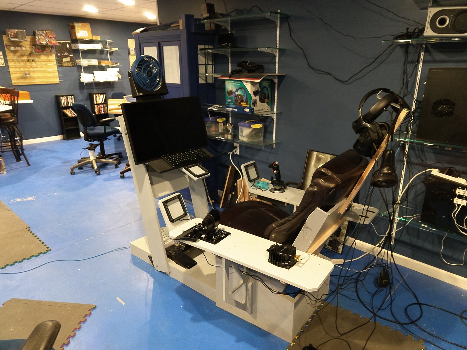

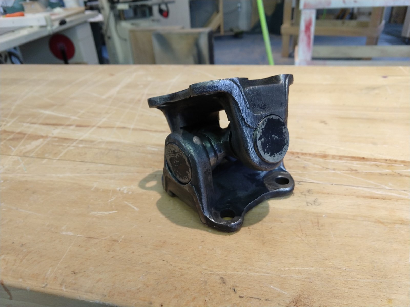

    Ok, forget the universal joint. How about this?

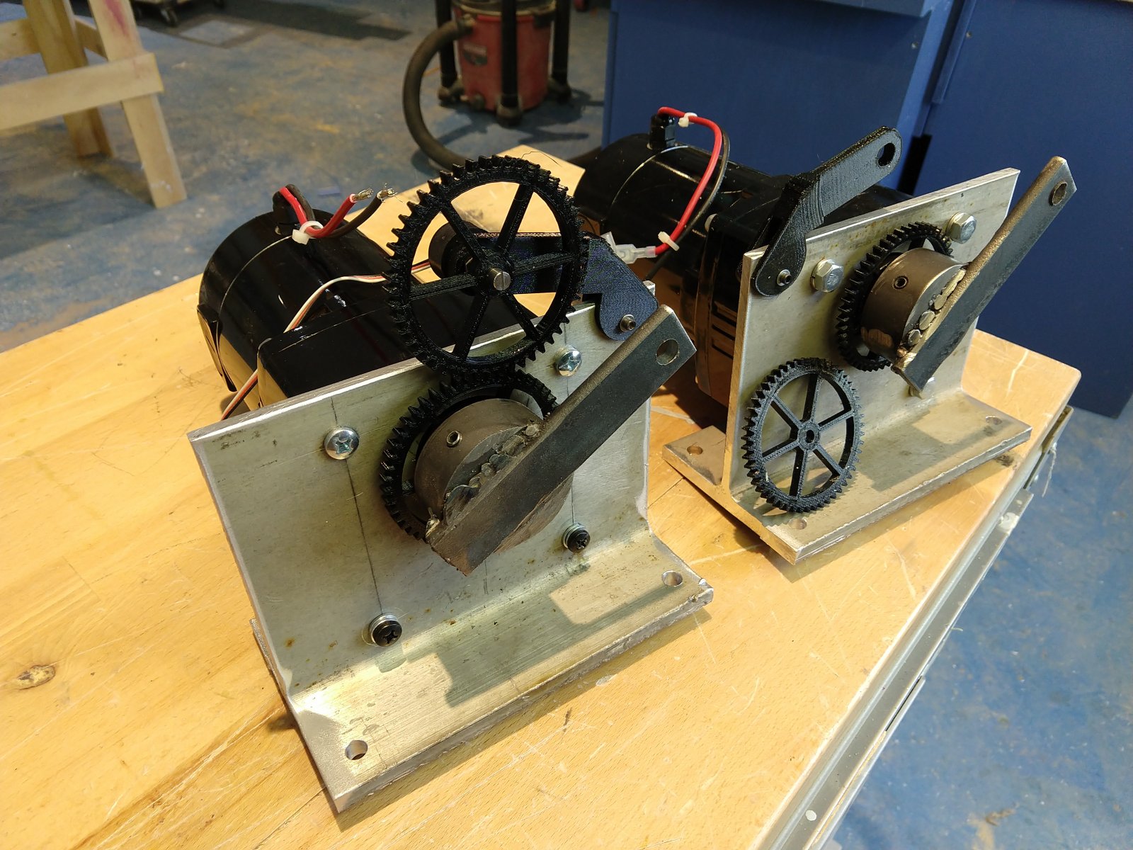

    Thanks to @bruce stephen allowing me to buy his Bodine motors the 6DoF has been officially started.
    Nothing earth shattering here:
    Motors: six @ 12v, 23a, 60:1 gearboxes, 42rpm and 310 in-lbs.

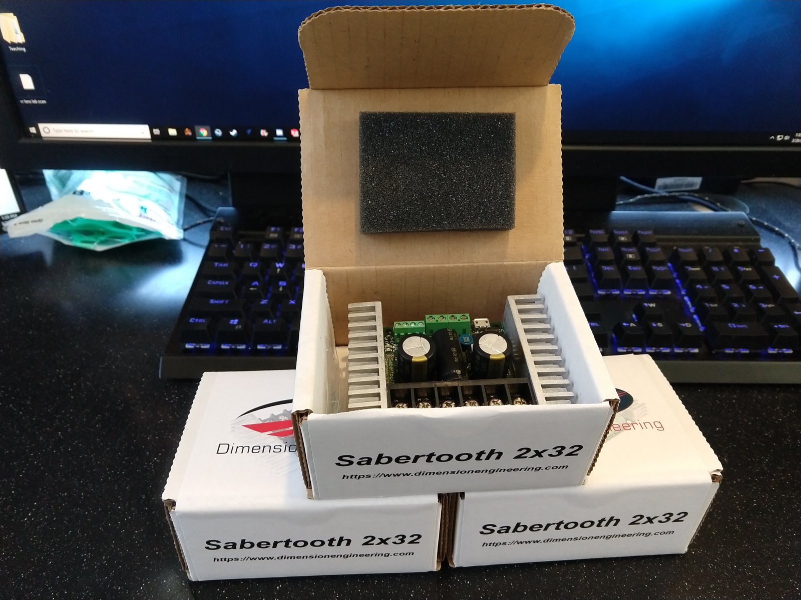

    Drivers 3@ 2x32 Sabertooths (I wanted to be one of the cool kids!) They have shipped so I get to play with them soon.

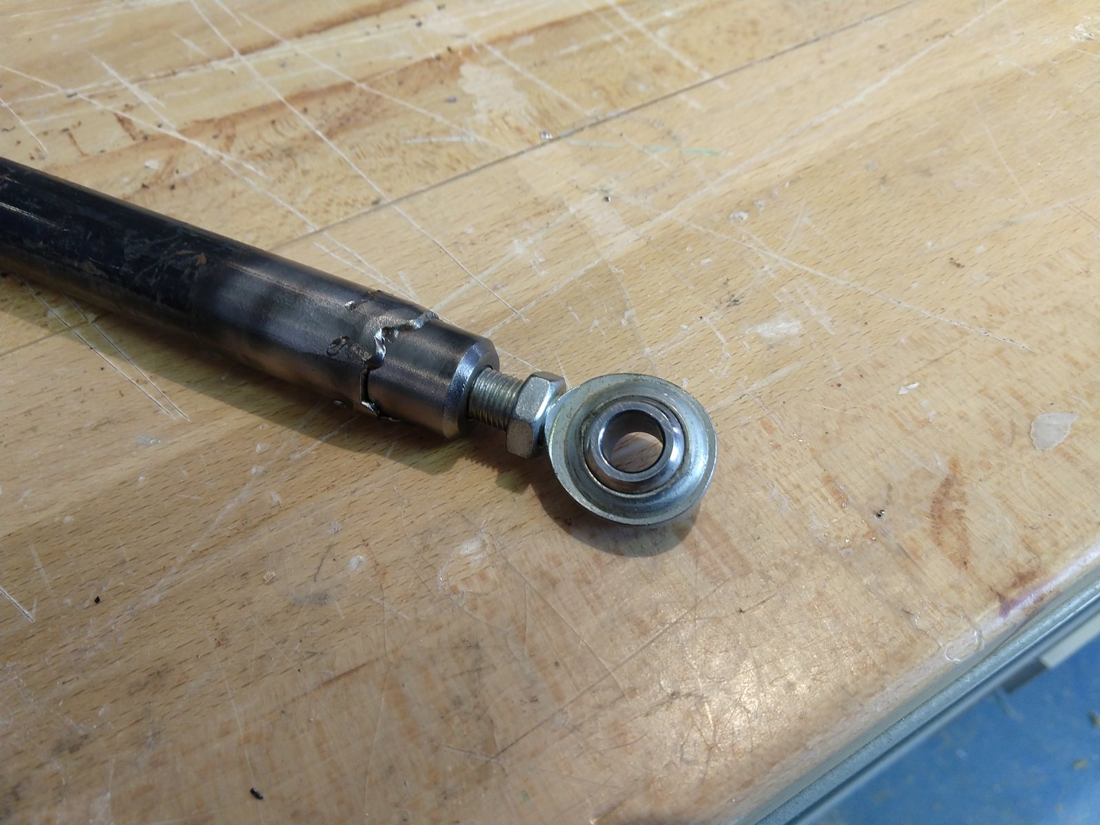

    30amp LED power supplies behind a 12v garden battery (cause I wanted to)
    Three 100lb Suspa gas struts (because...me)
    I have not yet decided if I will buy Kangaroo's but probably. I do have lots of Uno R3s around though.
    Also ordered 1/2" (12.6mm) hiem joints.

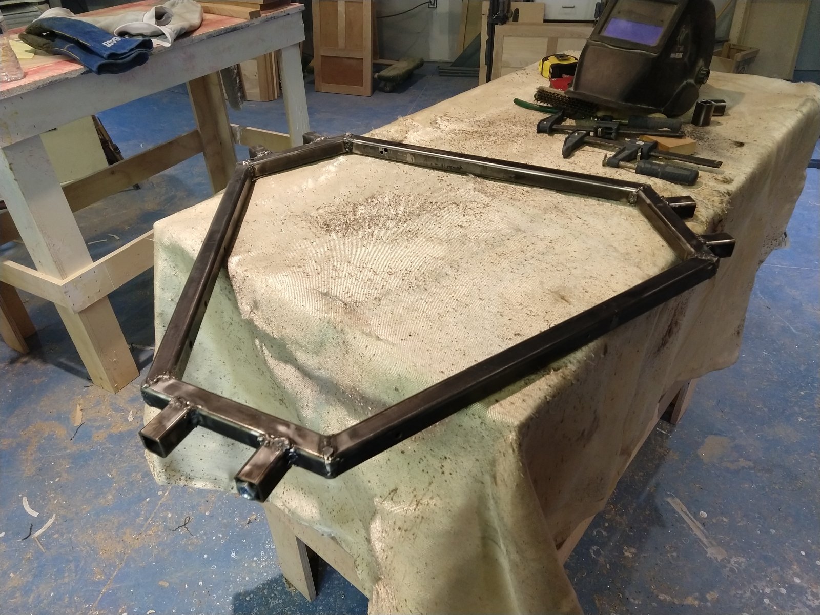

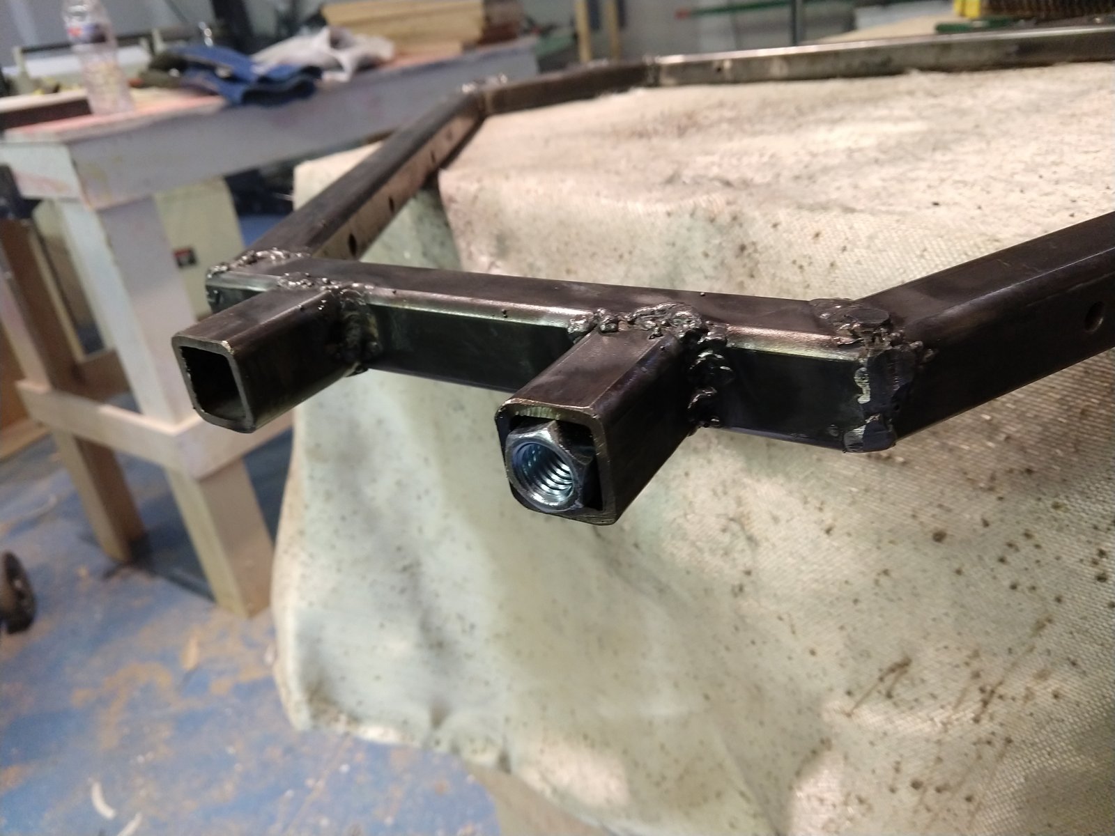

    I cut up my old 6DoF frame from way back when and re-purposed it:

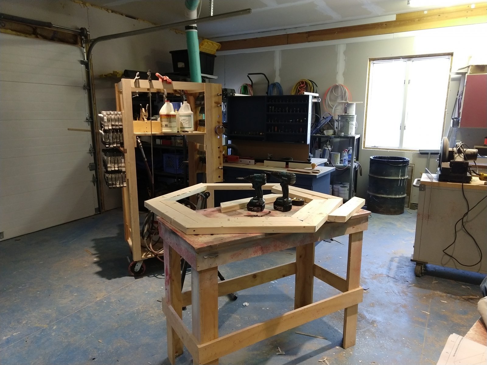

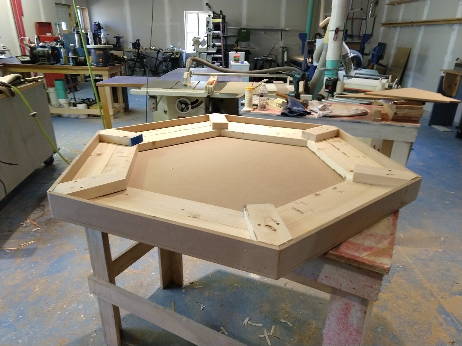

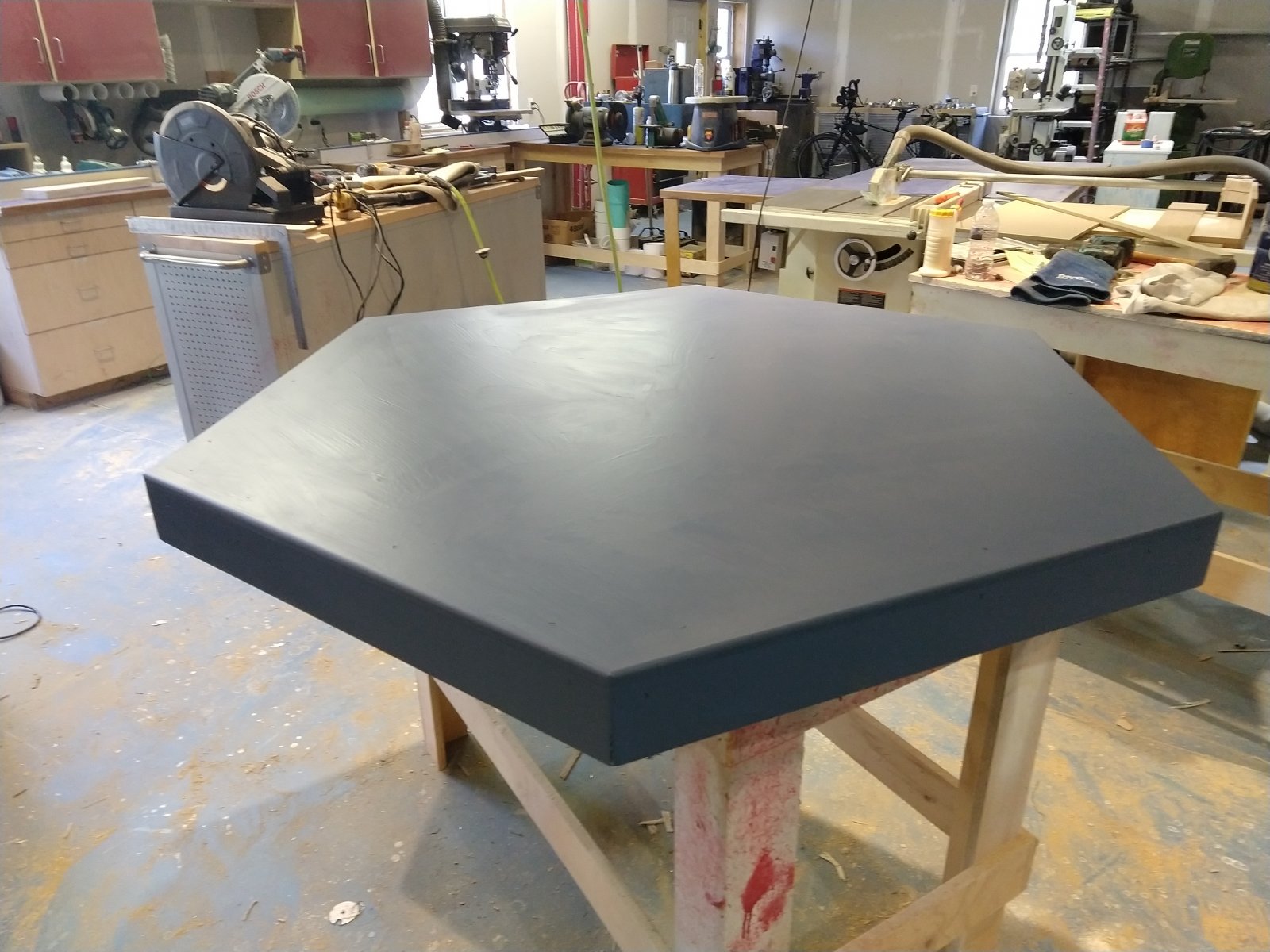

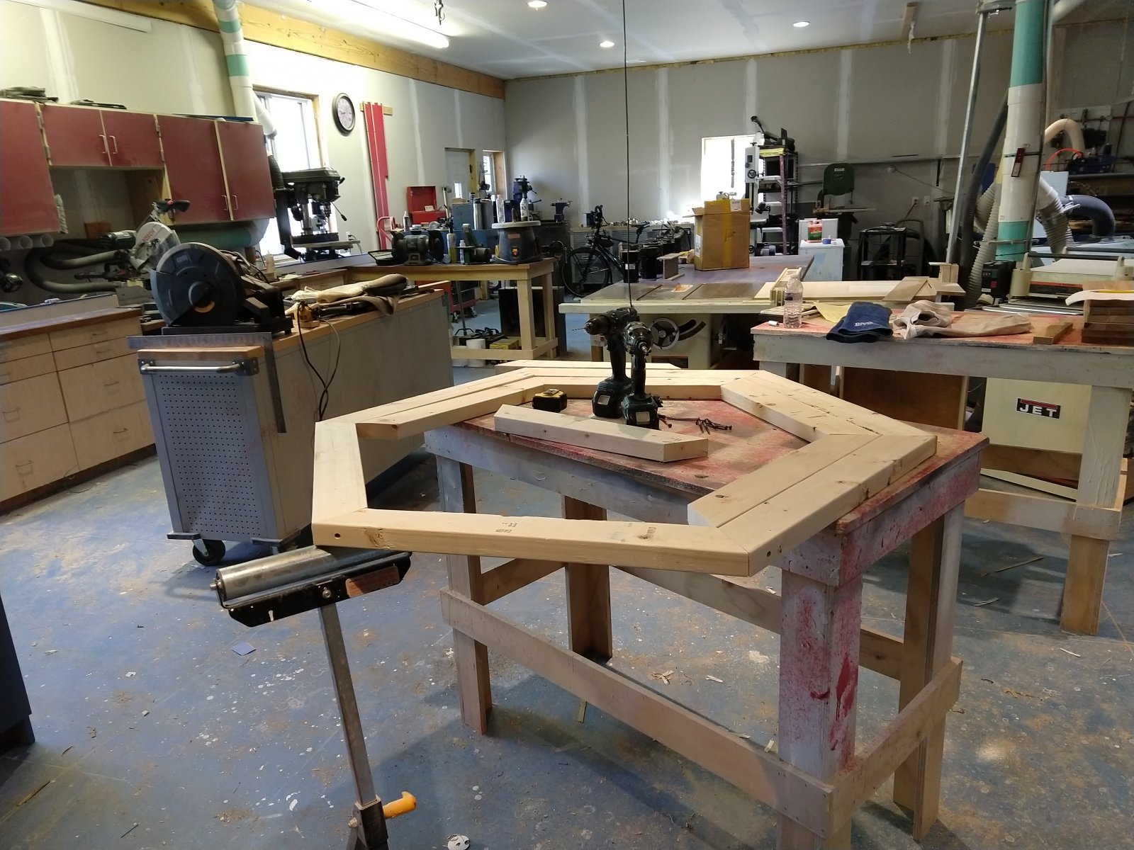

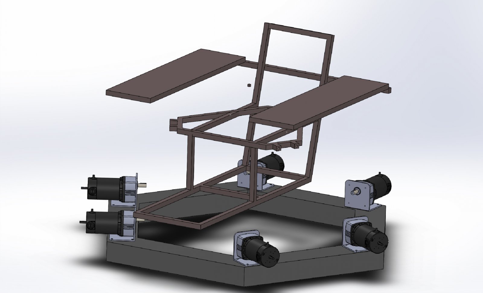

    Needed a base, so here is a base. I might still put a steel frame on top of this to mount the motors but I will probably reinforce the motor mount positions and mount them directly to this base.
    This only shows half of the supports, there are a total of 12.
    And of course; blue :)

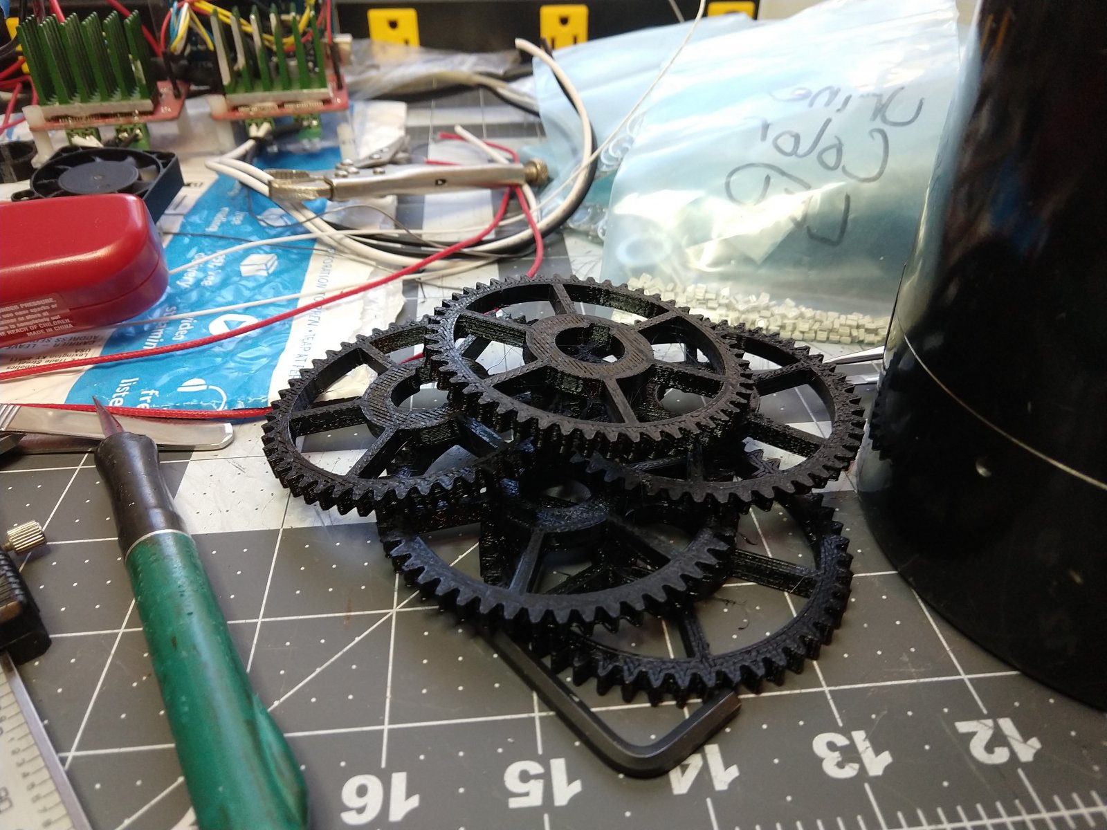

    Oh, and gears. Lots and lots of gears ;)
    As per request, here are the STL files for my 75mm gears that I use for potentiometer mounting, including the arm that holds the potentiometer.

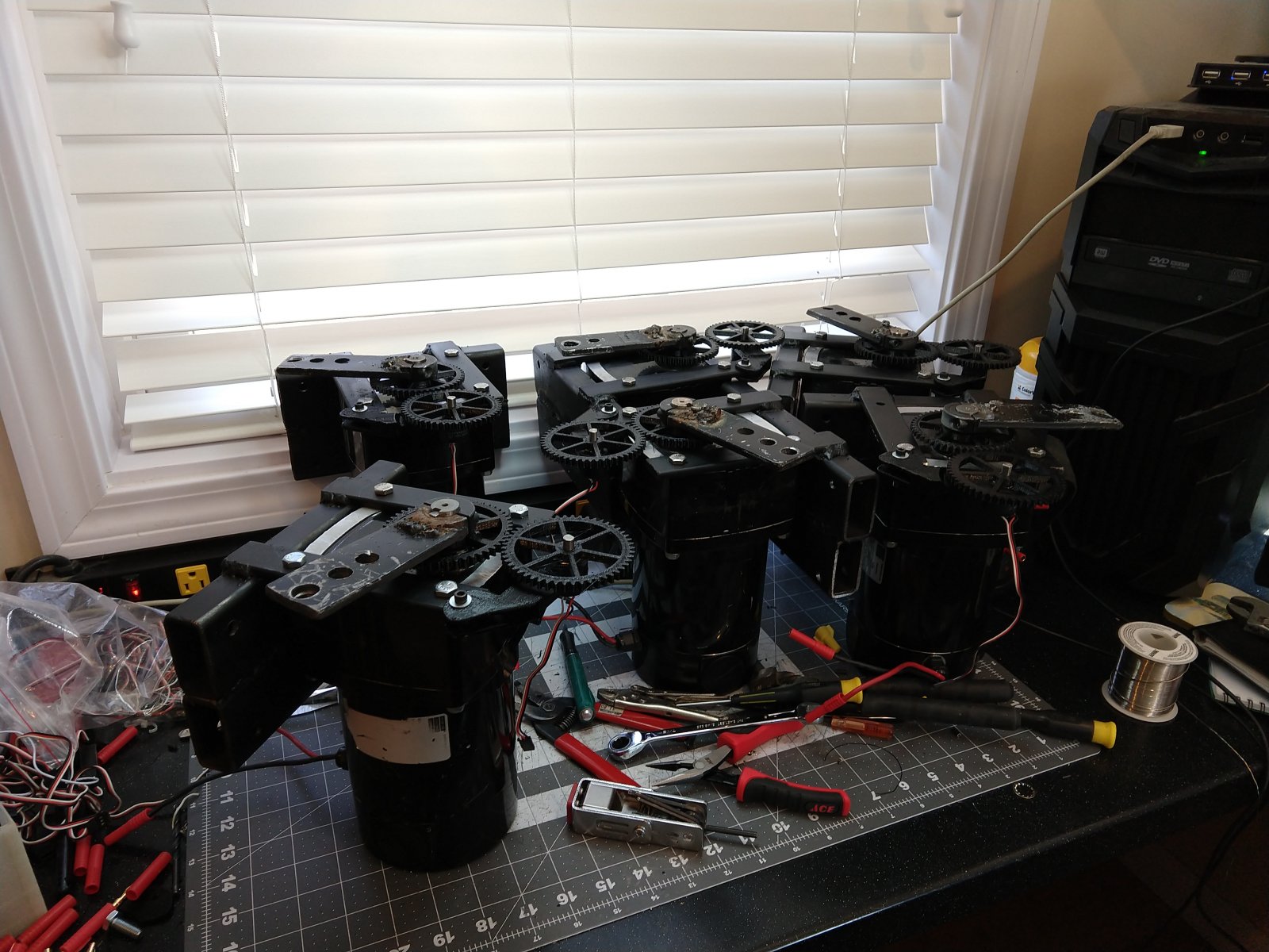

    Hey Craig! I am channeling you here buddy! :D

    BEHOLD!
    I am now replete with cooliousity! :cool:

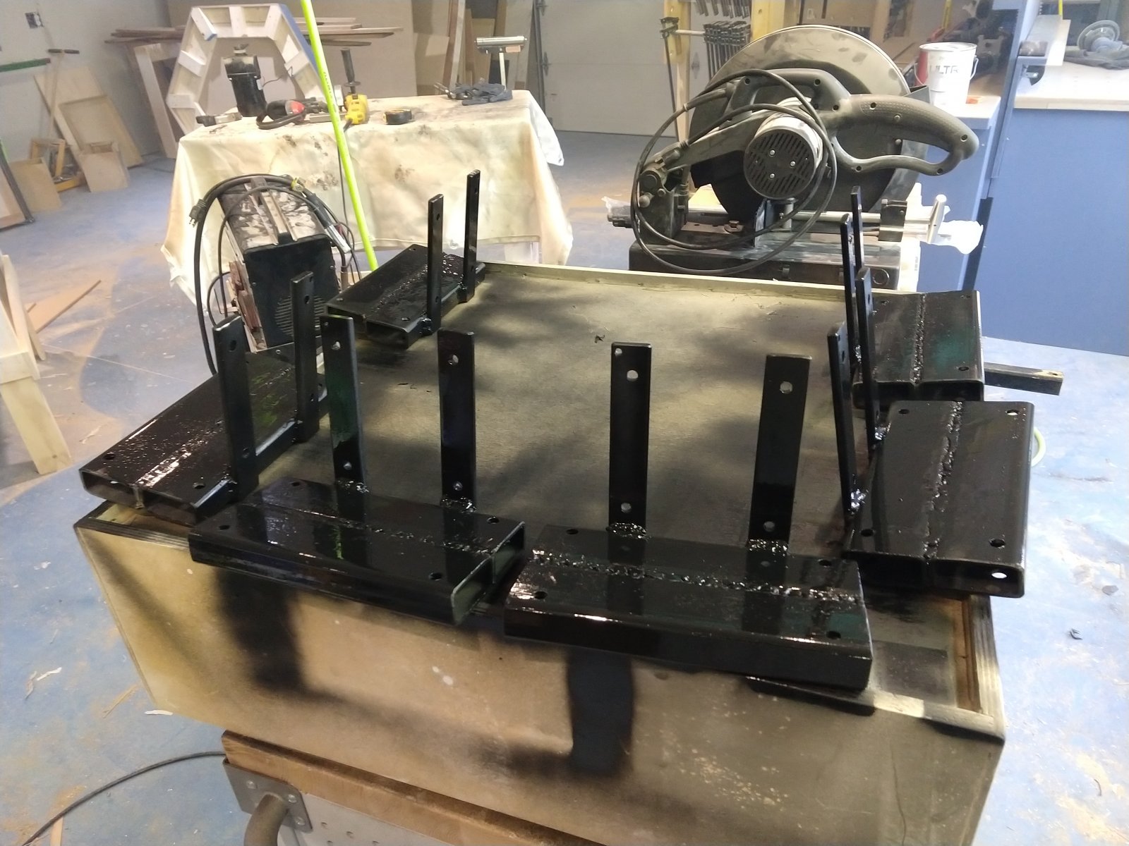

    BUT WAIT! Look what I found under a stump in the back yard (it was an iron wood tree).
    I was sure that I would make these out of aluminum as I have the other five motor mounts but, Steel yourself for it, I had iron laying around. That is what you (would not) call IRONy :D

    Updated the post showing my gears for potentiometer position and mounting with the STL files in case anyone wants to print them.

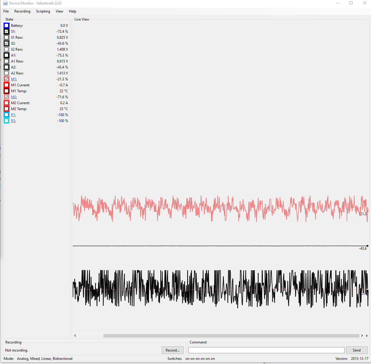

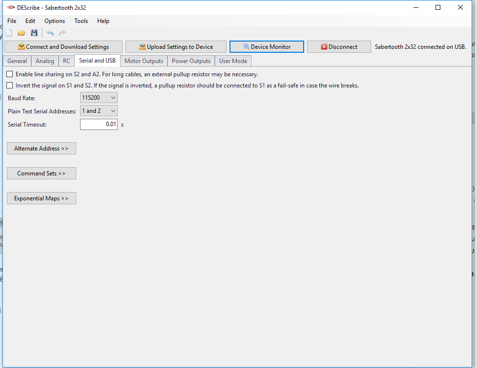

    So, I have been playing around with my Saberteeth 2x32 drivers.
    I uploaded @BlazinH 's (thank you) sketch found here:
    https://www.xsimulator.net/communit...ket-serial-pid-motor-driver-w-softstart.9277/
    and followed the instructions listed there. Sketch uploaded and compiled fine.
    Using Describe software I changed the Baud rate to 115200, also changed this in Windows device manager for both the sabertooth (teeth?) and the Arduinos. Is there another setting in Describe that I am missing?
    SMC3 utility shows the pots functioning perfectly (hall effect) but there is no controlling the voltage. On the Sabertooth the voltage output (M1 and M2) is always around 8v on one side and 12v on the other. Even when all settings in SMC3 are zero the voltage on the Sabertooth is the same. All three sets have similar. Changes in SMC3 make no difference at all, and pot position does nothing either.
    What makes me wonder if I have a Describe setting wrong is that the Diagnostic screen shows that the mode is Analog, I thought it should be Serial?
  17. Historiker
    2,162
    9,208Coins
    +2,168 / 19 / -1
    Hmm...might have figured it out. I had assumed that the V.3 2x32 didnt need dip switches set. There is even a plastic cover over them. But After setting 1 and 2 to off (as instructed in @BlazinH 's thread) I get some control over voltage and device monitor does show the pots adjusting voltage but not gradually, just big jumps.
  18. Historiker
    2,162
    9,208Coins
    +2,168 / 19 / -1
    Further progress, I have control of the motors now but they are extremely jittery. I have to increase deadzone to 4(!) to smooth them out but manual control makes them go nuts, where sine wave they stay smooth. Tried Fpid/1 and 2 and three etc. 2 seems to work best but still not perfect. Tried jumpering a capacitor between A0 and ground to see if I could smooth them that way but there was no difference between A0 and A1 (without cap).
    Its getting there. More head scratching needed.

  20. SilentChill
    2,645
    20,585Coins
    +3,566 / 34 / -0
    I would try FPID 3 or 4 and i would deffo not be using any deadzone. Thats just from my experience. And deffo no PWMmin thats just gonna heat your motors up theres no need for it. KP should probably be around 400 as a minimum .
