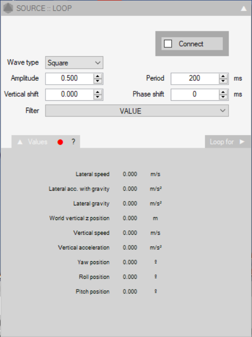

    FlyPT Mover has a source loop function to do this, but onlt 2 actuators works correctly, other 2 have a limited movement and the last two doesn't move at all...is it ok? Is there a way to move all the actuators in the same way? Have a look at the video to see what's happen now.

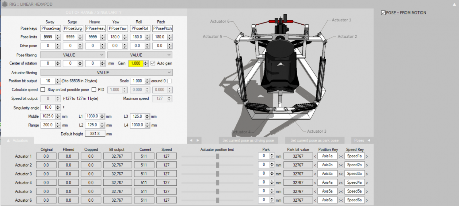

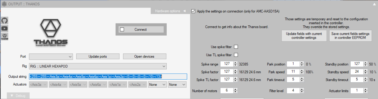

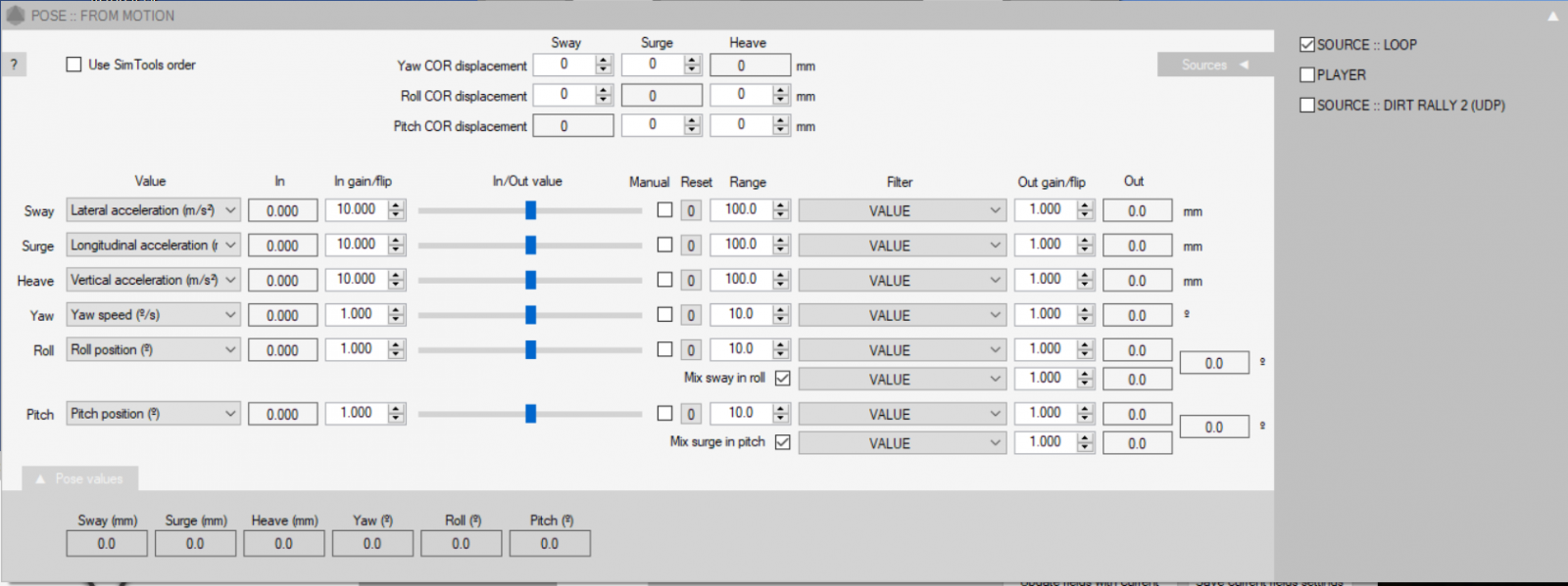

    could you put all pictures of your setting on Source,Pose,Rigs and Output?

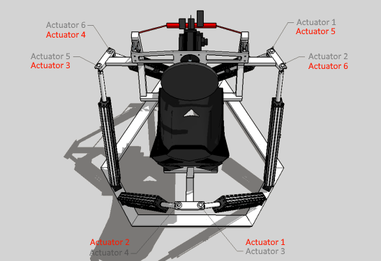

    I didn't touch anything from the original settings, except the actuators order as explained in the FlyPt Mover website

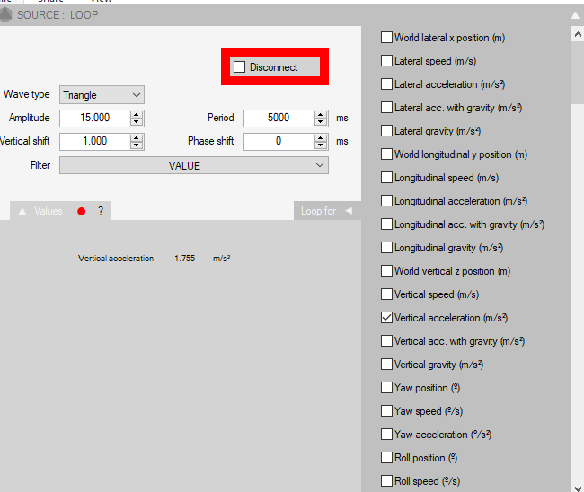

    before please setup your Sourse Loop as this picture and try again,
    as you can see just chose vertical acceleration

    so...it seems to work! and it was so easy...thank you so much, sometime you are so close to the result and you didn't know!
    In the meantime today i also watched a youtube tutorial about how to set up DIRT 2 in order to record some real drive and send it in loop. Tomorrow i'll test everything with the platform and let you know.
