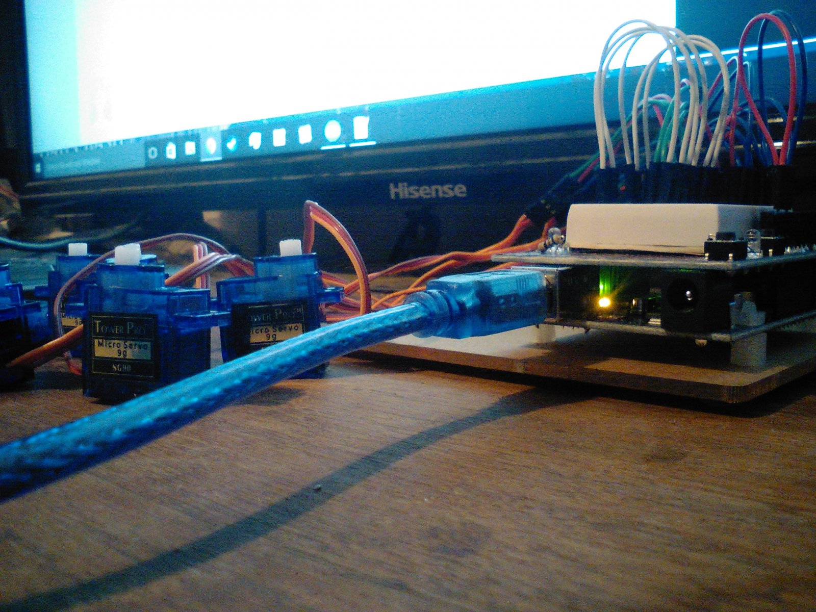

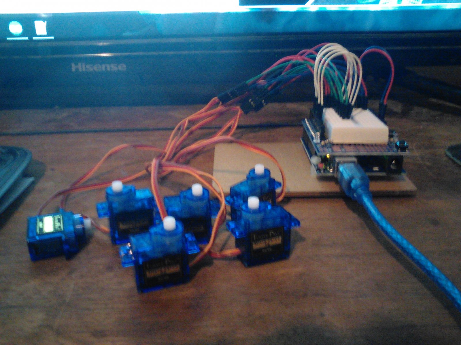

    Shopping list for my scale model: Purchased on Amazon
    • J-Deal® 10x Pcs SG90 Micro Servo Motor TowerPro 9G RC Robot Helicopter Airplane Boat Controls
    • RobotLinking 2015 New Uno R3 Project Ultimate Starter Kit For Arduino UNO R3 Mega2560 Mega328 Nano including Uno R3
    • Great Planes All Thread Rod (Set of 12), 4-40x12"
    • Du-Bro 900 4-40 Heavy Duty Ball Link (12-Pack)

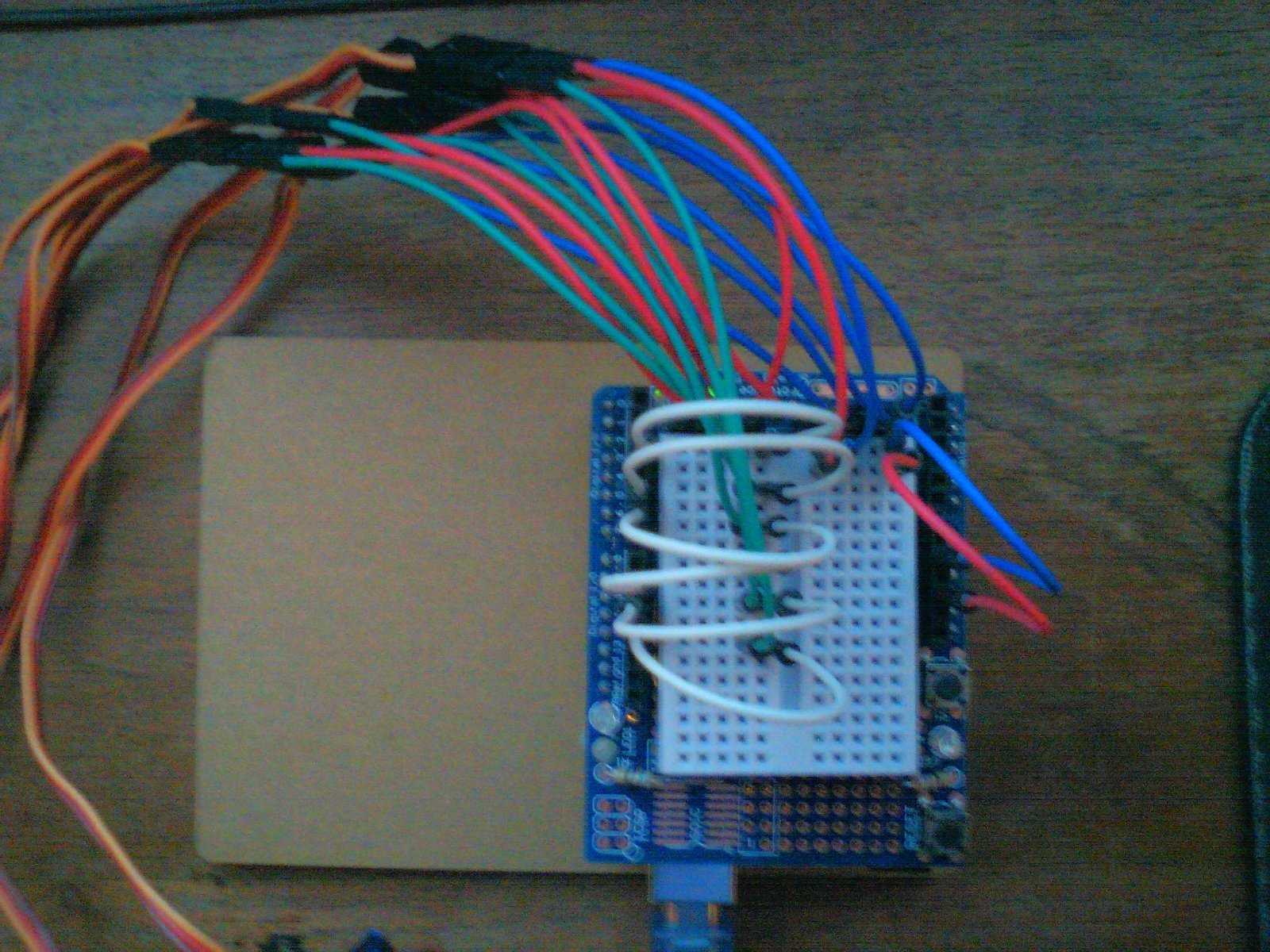

  19. DocLove
    DocLove New Member
    Jan 19, 2016
    22
    Grand Junction, CO, USA
    492Coins
    +22 / 0 / -0
    Electronics came in today, spent a couple hours figuring it out and hooking up wires... Much progress has been made XD
  20. Kirk
    Kirk Member
    May 19, 2014
    91
    Sr Software Engineer
    Texas
    15,087Coins
    +114 / 2 / -0
    2DOF, DC motor
    With that many servos, it's hard not to recommend Adafruit's 16 channel servo shield, or any of the clones.
    http://www.aliexpress.com/item/Free...erface-for-Arduino-Raspberry/32551764422.html
    ($3.28 w/ free shipping on AliExpress)
    https://www.adafruit.com/products/1411
    ($17.50 from Adafruit, shipping is extra, but it's the genuine thing).
    They are easy to connect up and much easier to code for, plus it's easier to configure a secondary power source to avoid brown-out on your Arduino.
    Anyway, when using I2C to control the servos, you basically just set the desired positions, no need to babysit the servos, and no need for jumper wires, the headers are all setup for attaching servos directly.
