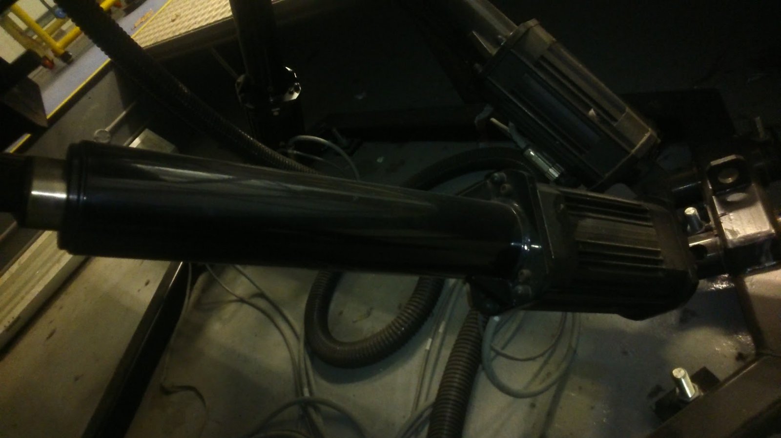

    Hi Guys
    Ive been lucky enough to be given a old 6dof stewart platform and was wondering if it would be possible to get it to work with simtools. I presume it would just need some new firmware. Any ideas where to start?

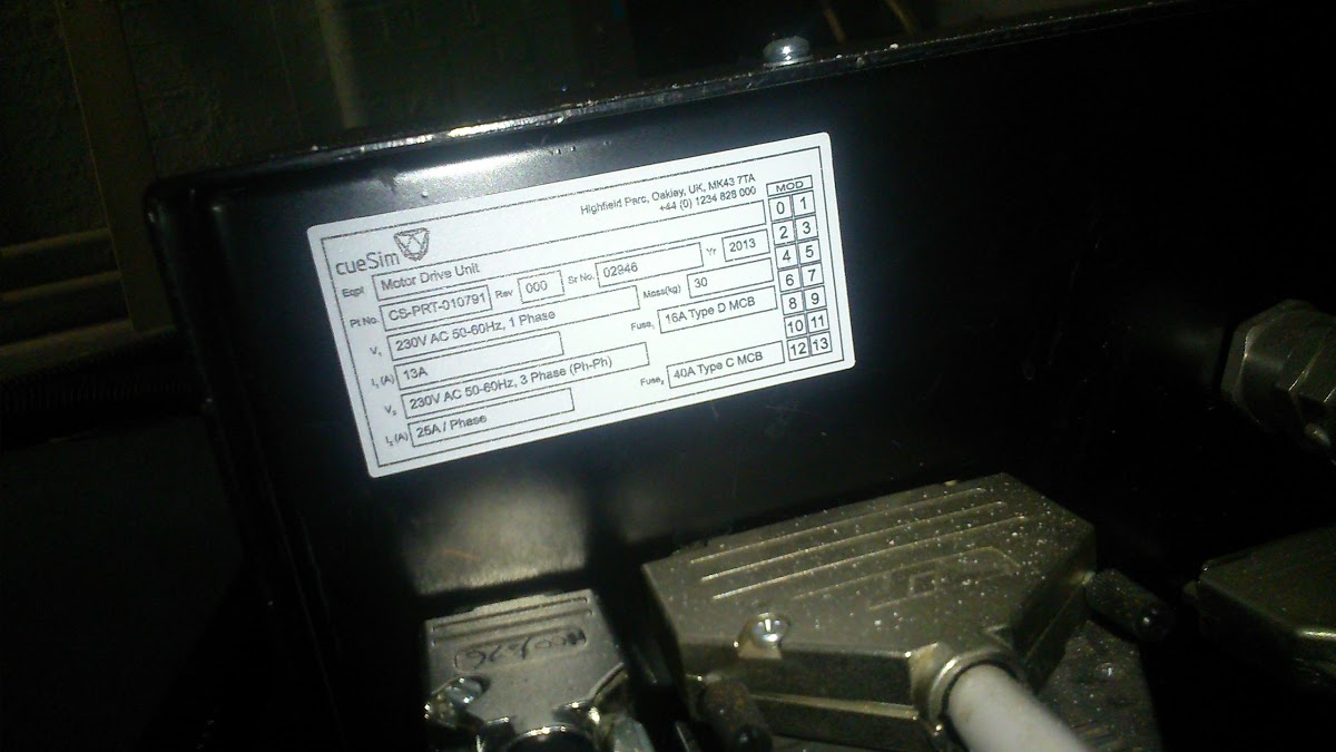

    The only information i have is it was made bycuesim as a flight simulator base. here is a picture of the motion drive plate.

    It is powered by 3 phase and then goes into a transformer .
    The biggest issue at the moment with it being gifted is going to be removing it as it still has the flight cockpit on top. haha

  9. cthiggin
    cthiggin Active Member
    Jul 1, 2012
    672
    Self-Employed
    Montgomery AL USA
    15,209Coins
    +435 / 0 / -0
    The motor id plate shows it is a "single phase motor"........ a VFD converts single phase to a 3 phase motor, which is not needed in your case.
    Inverter "normally" refers to the type of motor - "Inverter Duty" referencing a motor requiring many forwards and reverses.............they are built heavier duty to withstand that use and to help compensate for the build-up of heat.
  10. SeatTime
    2,573
    Motor plate has single and three phase specifications.
  11. RacingMat
    2,237
    21,035Coins
    Do we have to ask you once again a picture (of the inside of the box...)? Mentalism is not easy :D
  12. cthiggin
    Jul 1, 2012
    672
    Self-Employed
    Montgomery AL USA
    15,209Coins
    +435 / 0 / -0
    IF you're going to use the "3-phase" motor hook-up (which you need to for forward/reversing of the motor) - then you would use a VFD (Variable Frequency Diverter) - which takes "single phase" IN and converts it to "3-phase" OUT to drive the motor.

  14. Historiker
    2,162
    9,208Coins
    +2,168 / 19 / -1
    Those are servos I think....still very jealous...
    Nice find!
  15. BlazinH
    BlazinH Well-Known Member
    Oct 19, 2013
    2,145
    Oklahoma City, USA
    16,659Coins
    +1,839 / 32 / -1
    They're brushless DC servos to be exact. And you only need a transformer if you are running off industrial mains that are over 240 volts to bring the voltage down to 240 volts.
