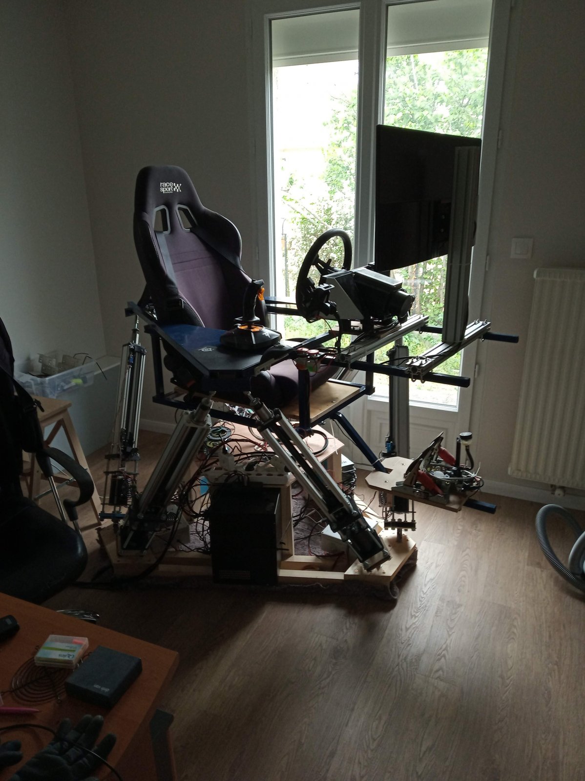

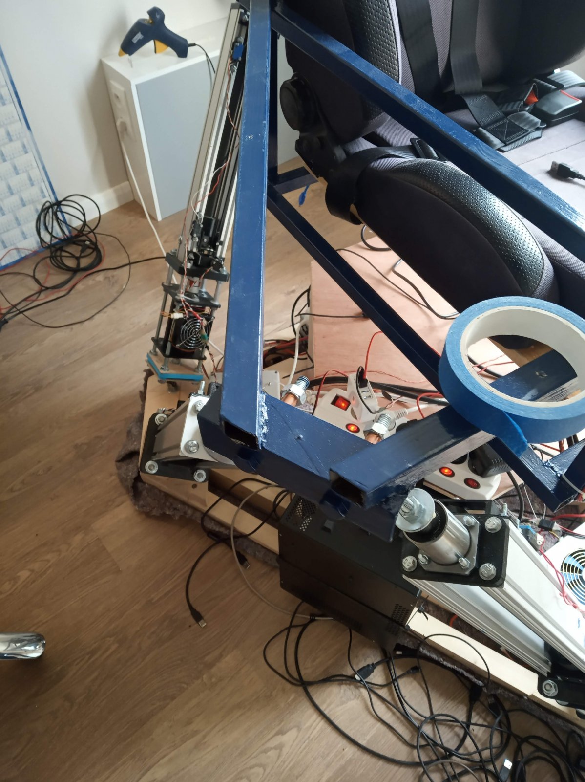

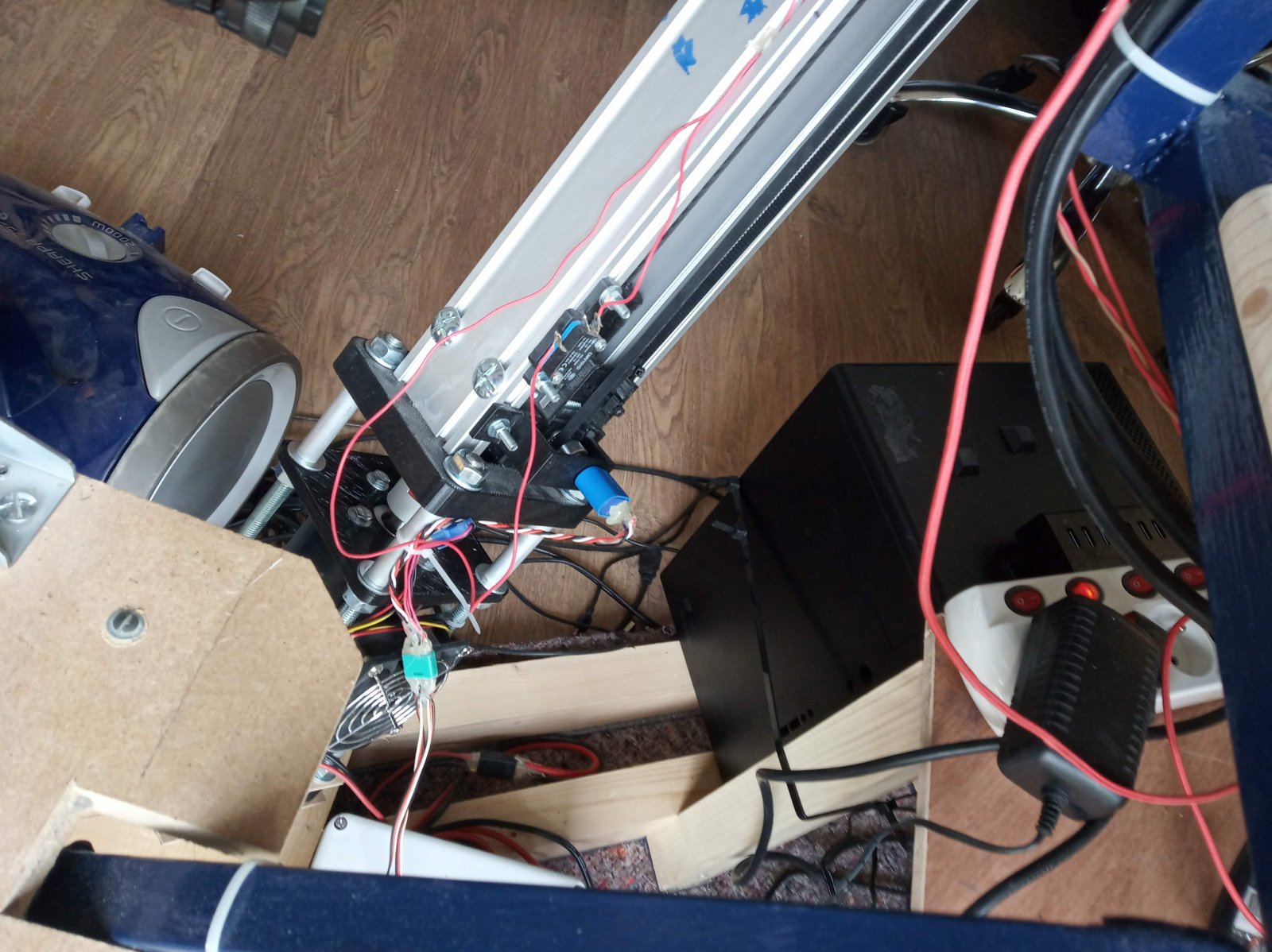

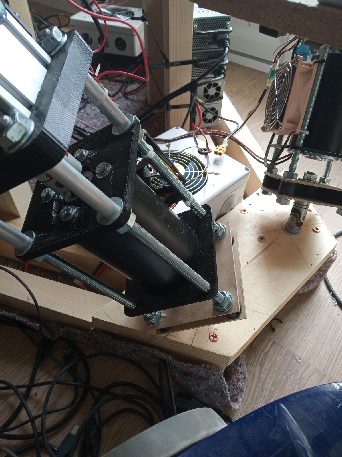

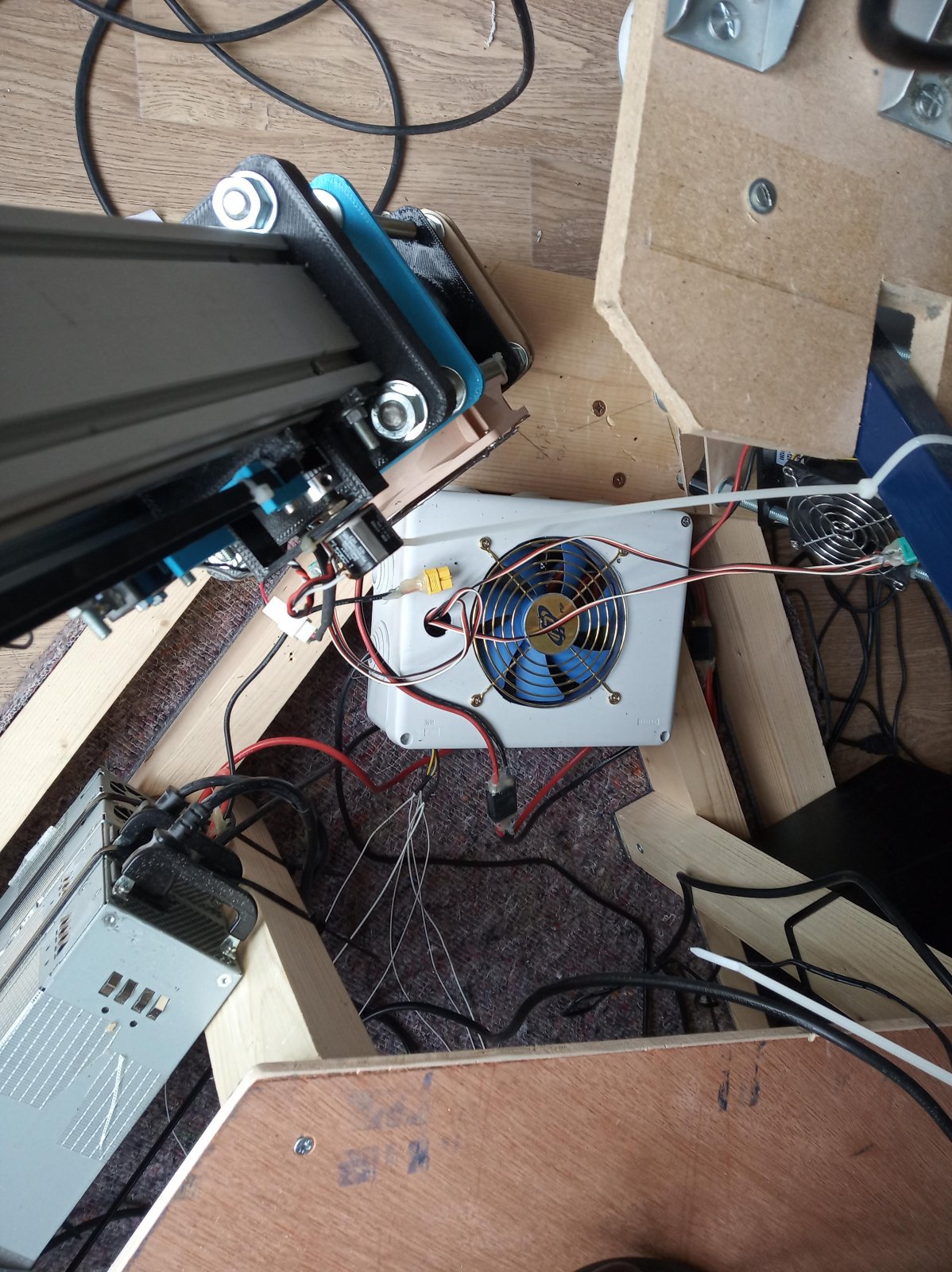

    Some update :
    => I added a plate at the end of the motors to block them to ease the work of the front plate supporting everything.
    I did that because I found 3 motor support broken when doing a complete maintenance of the actuactors ..
    They would move before, now it is a tight fit
    => I added one contactless position 10 turn on one of the six to test
    => I painted the chassit :D
    => I did an enclosure + cooling for the arduino + sabertooth and I redone my wiring of the power supply to look like ... let's say ... not a complete mess.

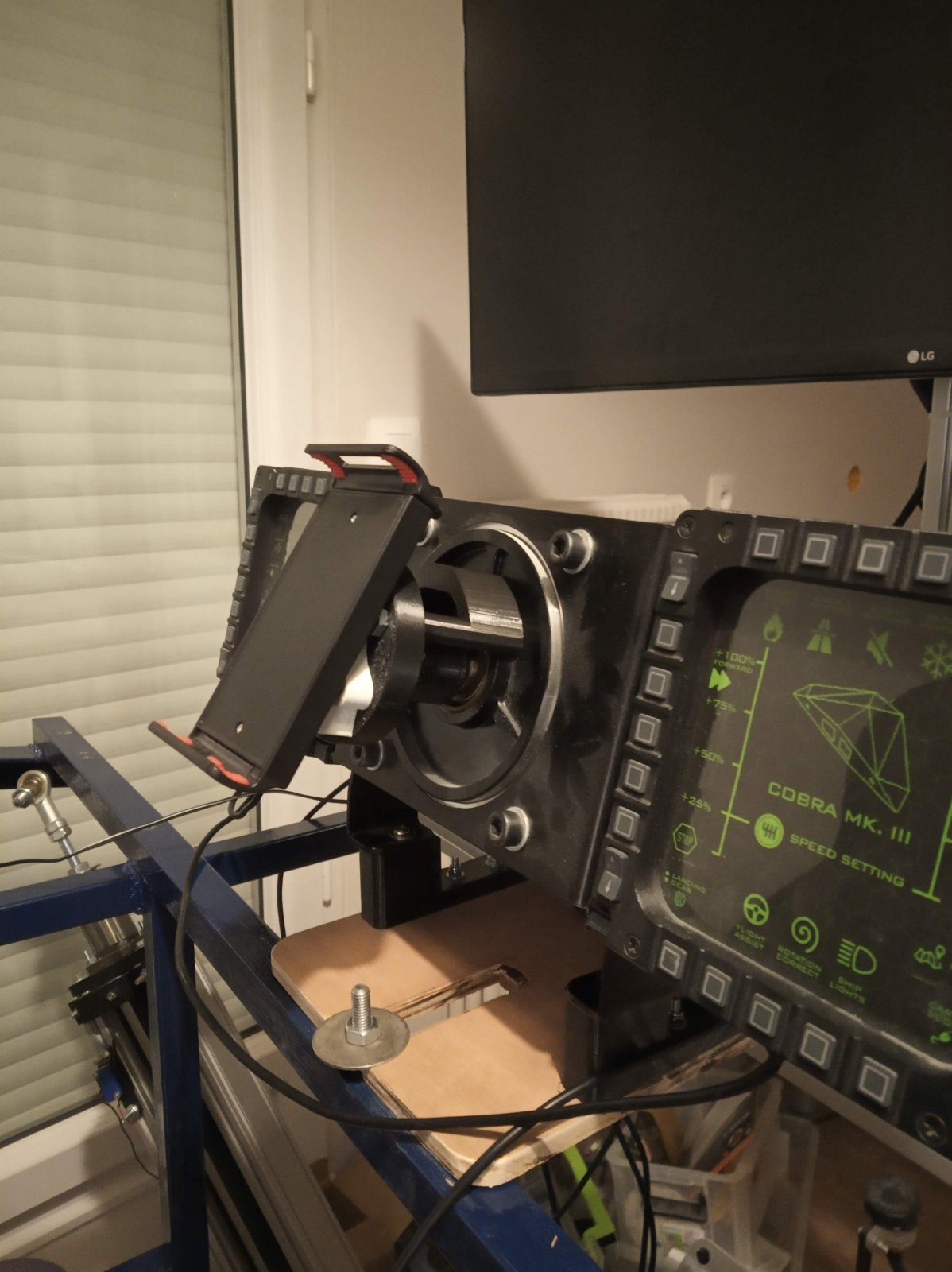

    => modify an old part to fit a tablette mount on the motor shaft when not using the rig in car mode !
    Next is :
    More paint
    Better USB management ...
    Buy more contactless encoders ... (36€ each :/)
    Take a look on G seat (I allready have an arduino for the harness tensionner)
    I should be able to play again soon !

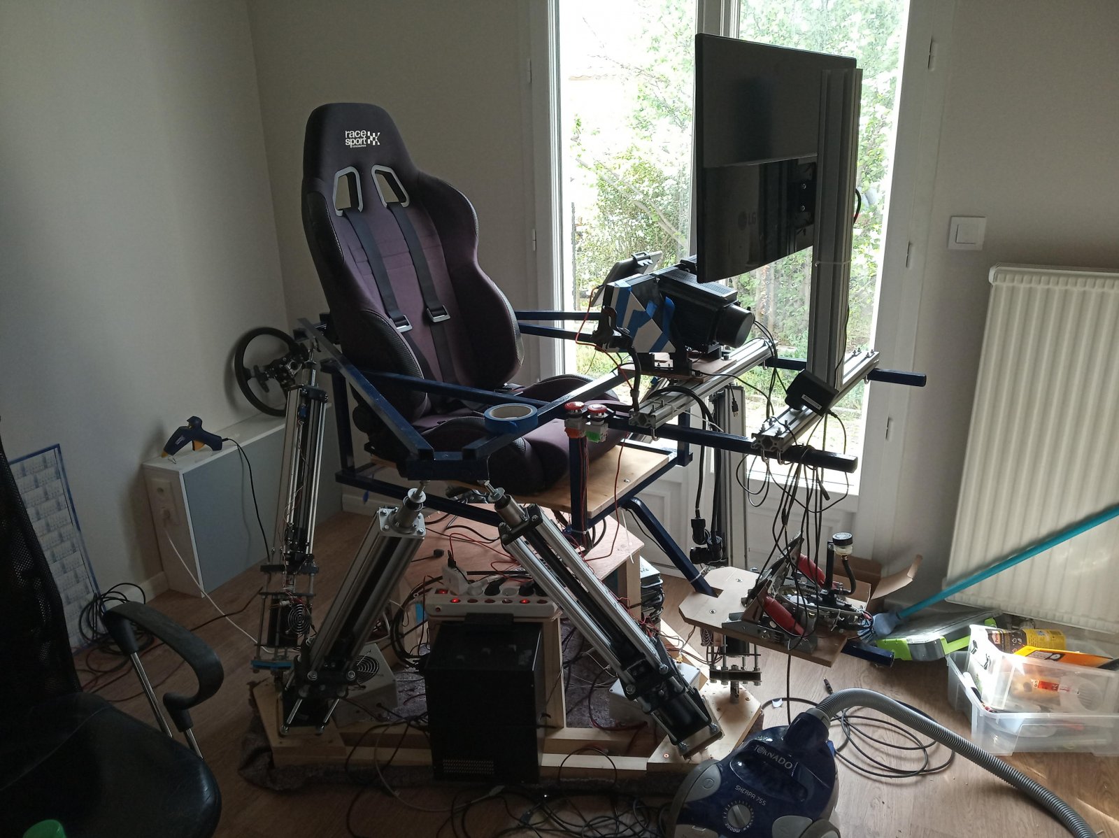

  18. baykah
    baykah Active Member
    Sep 1, 2016
    137
    Toulouse - France
    414Coins
    +133 / 0 / -0

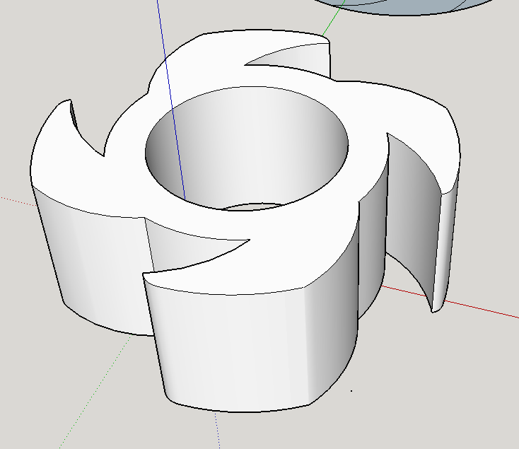

    Rebuild finished for now, I started working on the flypt interface ! Sor far, I like it but I have to redo most of my settings !
    I have 2 actuators that vibrate a lot ... culprit is most likely the low quality ballscrew from china .. I added during the rebuild, the anti woble V2 part, more tight fit inside the carbon tube, but it will not unbend the ballscrews ..
    I also changer the wood part, that was used to simulate the brake disk, and putted a strong flexible polymer in order to have a better felling during braking (a little more displacement)
