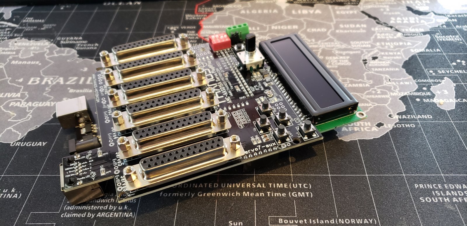

    [QUOTE = "Historiker, post: 214859, member: 4542"] L'autista Thanos AMC è arrivato ieri! Ora devo trovare un po 'di tempo per configurarlo. Ho Surge, Sway e Yaw pronti per l'uso. [/ QUOTE]
    dove hai acquistato il controller thanos?
    Google Translate:
    where did you buy thanos controller?
  2. Historiker
    2,162
    9,214Coins
    +2,170 / 19 / -1
    Hi Luky, please use google translate or other translation program to post in XSimulator.net. This time I will do it for you ;)
    I purchased it from his US website.
    https://www.thanos-motion.com/

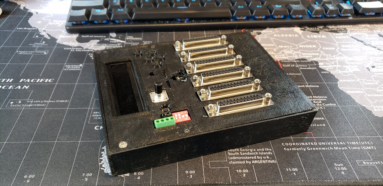

  7. Historiker
    2,162
    9,214Coins
    +2,170 / 19 / -1

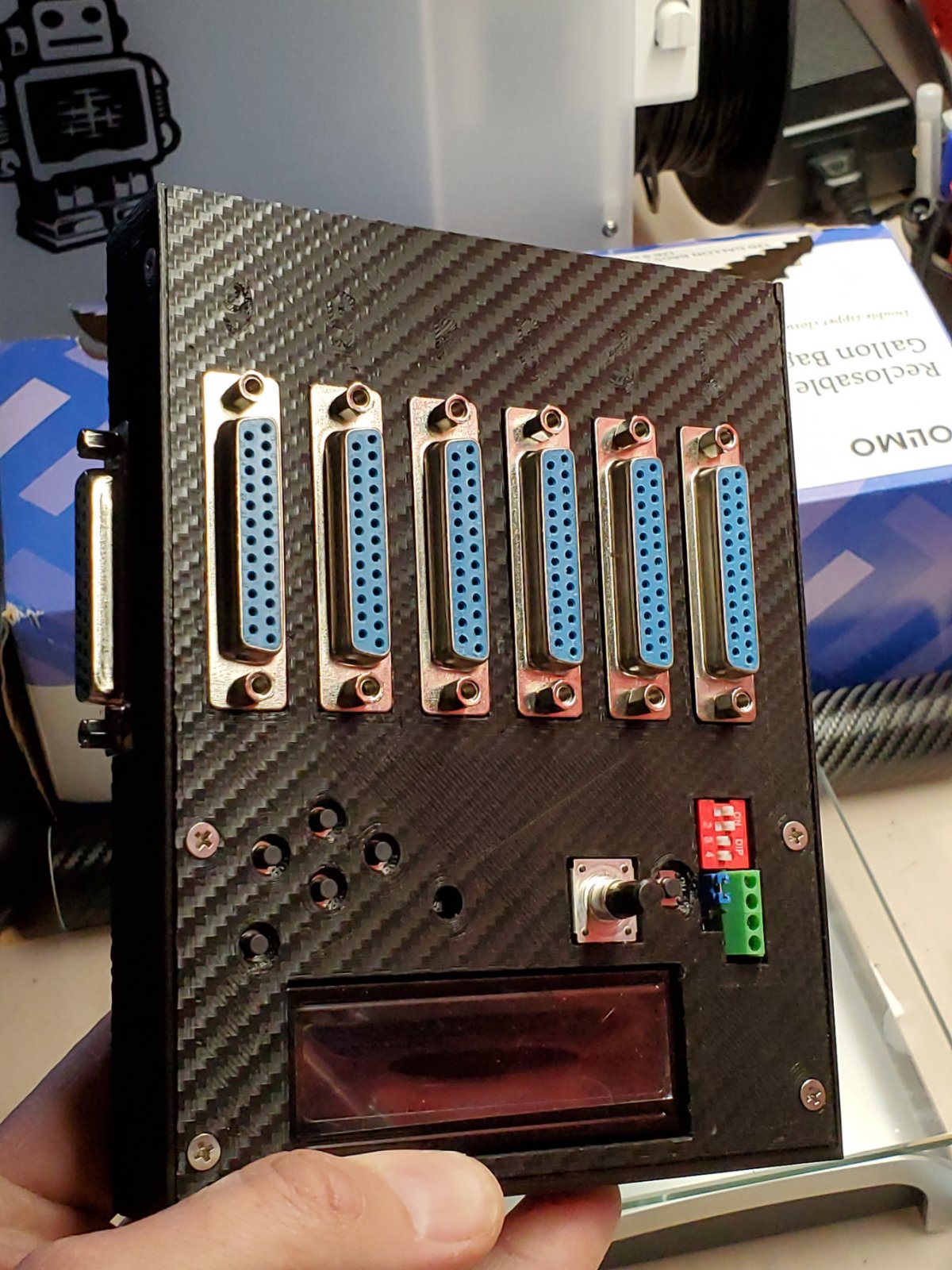

    Not pretty, but it works. .8mm nozzle rough draft quality. Definitely looks better out of the case :grin
  8. Thanos
    Jul 6, 2017
    1,374
    Electronics Engineer
    United States
    2,877Coins
    +1,078 / 10 / -0
    Maybe print on some carbon fiber vinyl...

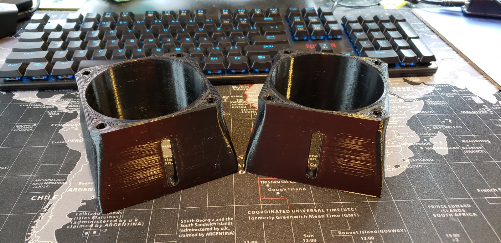

    I have not yet purchased extrusion but I really felt like printing something. They are printed for 100100 aluminum but will work with whatever size I choose. Leaning toward 100100 again.
    7 hours 18 minutes print time. .8mm nozzle rough draft quality.

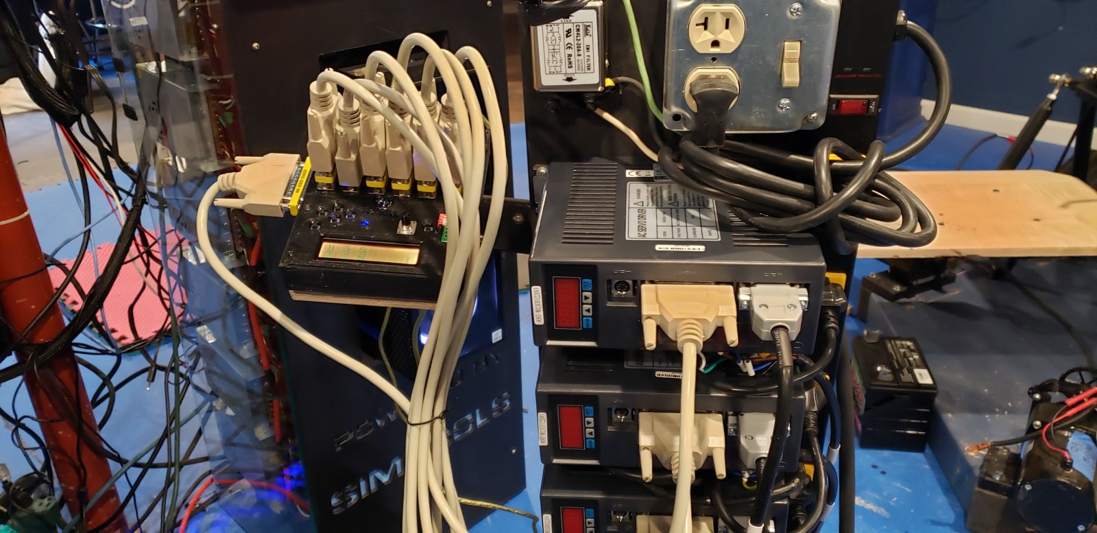

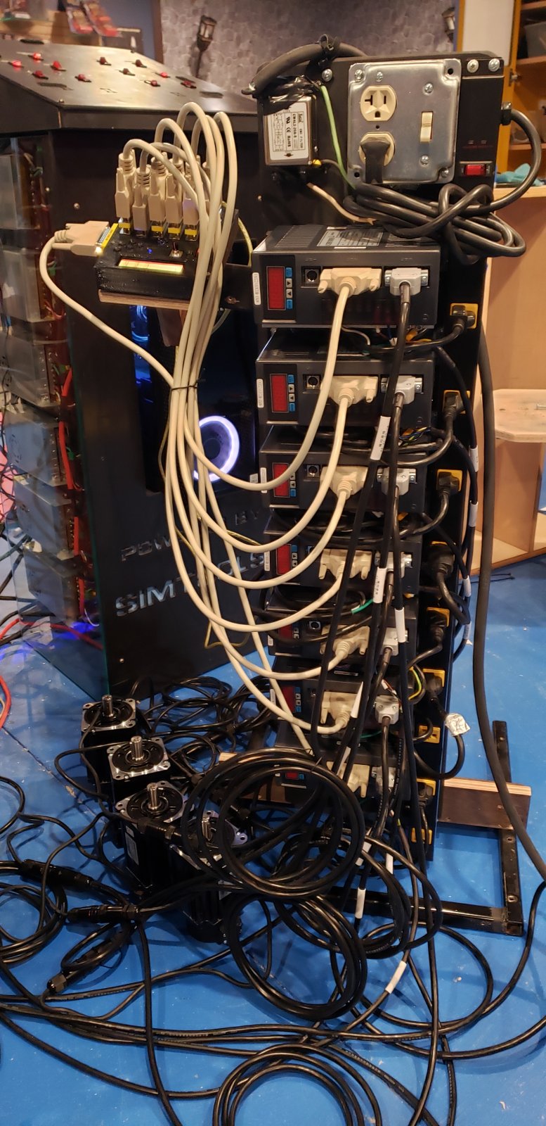

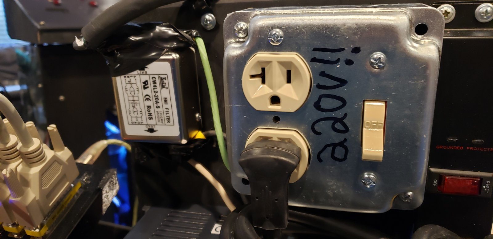

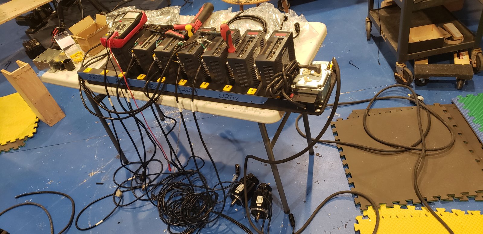

  11. Historiker
    2,162
    9,214Coins
    +2,170 / 19 / -1

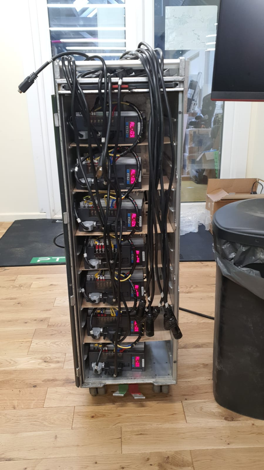

    Messy preperation for motion. Wires wires wires. Still need to buy the parts for the sfx bits. But I do want to get the electric bits sorted for my surge, sway and yaw
  12. Thanos
    Jul 6, 2017
    1,374
    United States
    2,877Coins
    +1,078 / 10 / -0
    Get a server rack to hide them away!

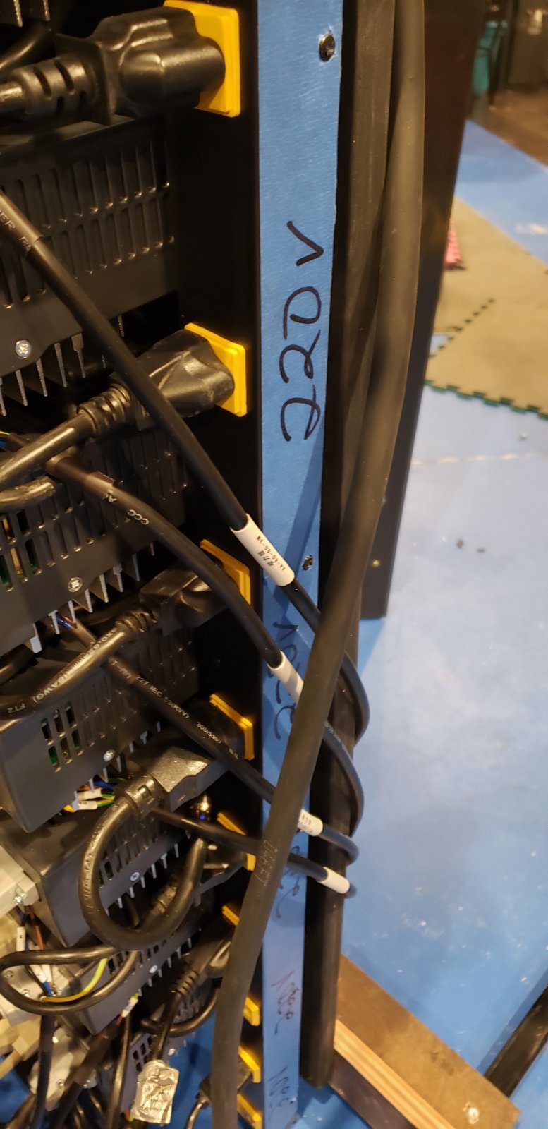

  13. Historiker
    2,162
    9,214Coins
    +2,170 / 19 / -1
  14. Thanos
    Jul 6, 2017
    1,374
    United States
    2,877Coins
    +1,078 / 10 / -0
    A beverage cart maybe? :grin
    • Funny Funny x 2
  15. Historiker
    2,162
    9,214Coins
    +2,170 / 19 / -1
    Hmmm...beverage cart...need to add casters....
    :grin
    And serious cable management....
    Suggestion Thanos, put the control panel on top....

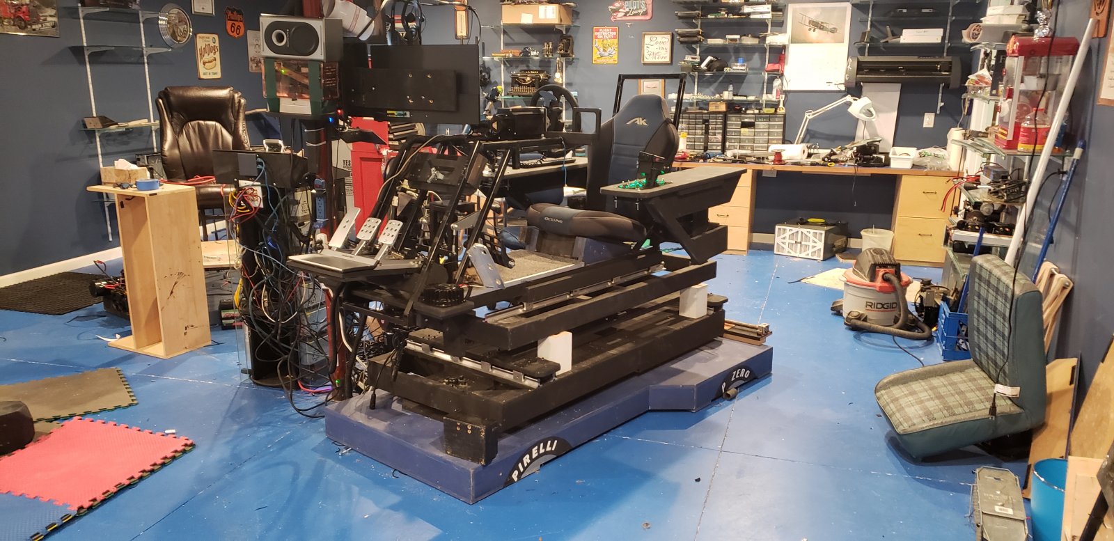

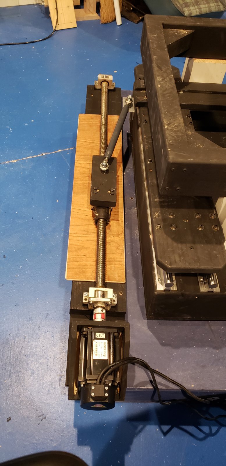

  16. Historiker
    2,162
    9,214Coins
    +2,170 / 19 / -1

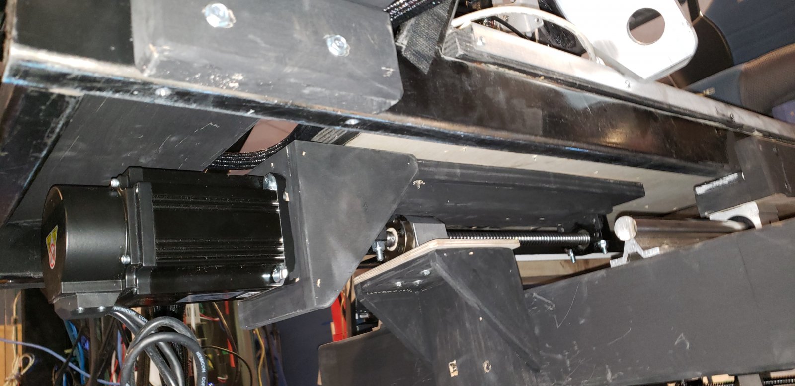

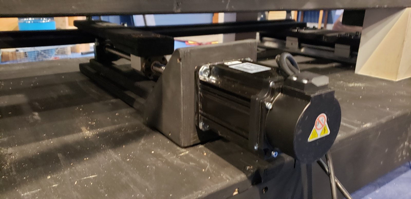

    My traction loss/yaw (ish), surge and sway motors are mounted and ready for use. Just need to decipher the AMC controller settings and I can fire those three up. Still need to order the materials for the four linear actuators, when my budget recovers.
  17. SeatTime
    2,572
    Nice work:thumbs, but would recommend that you support the screw with a linear rail (maybe you are already planning to do this?), as they are not design to take lateral forces by themselves. Over time they will bend/distort causing all sorts of issues.
  18. Historiker
    2,162
    9,214Coins
    +2,170 / 19 / -1
    @SeatTime good point, thanks for the comment. I had not thought about adding rails. The TL screw is a monster 1"x1/4", I used it because it was collecting dust in the shop. The other two are ultra cheap ebay items. Easily replaced if I have to. I am curious how well they will hold up in the current configuration but I had not really thought about the rapid direction changes and the mass involved.

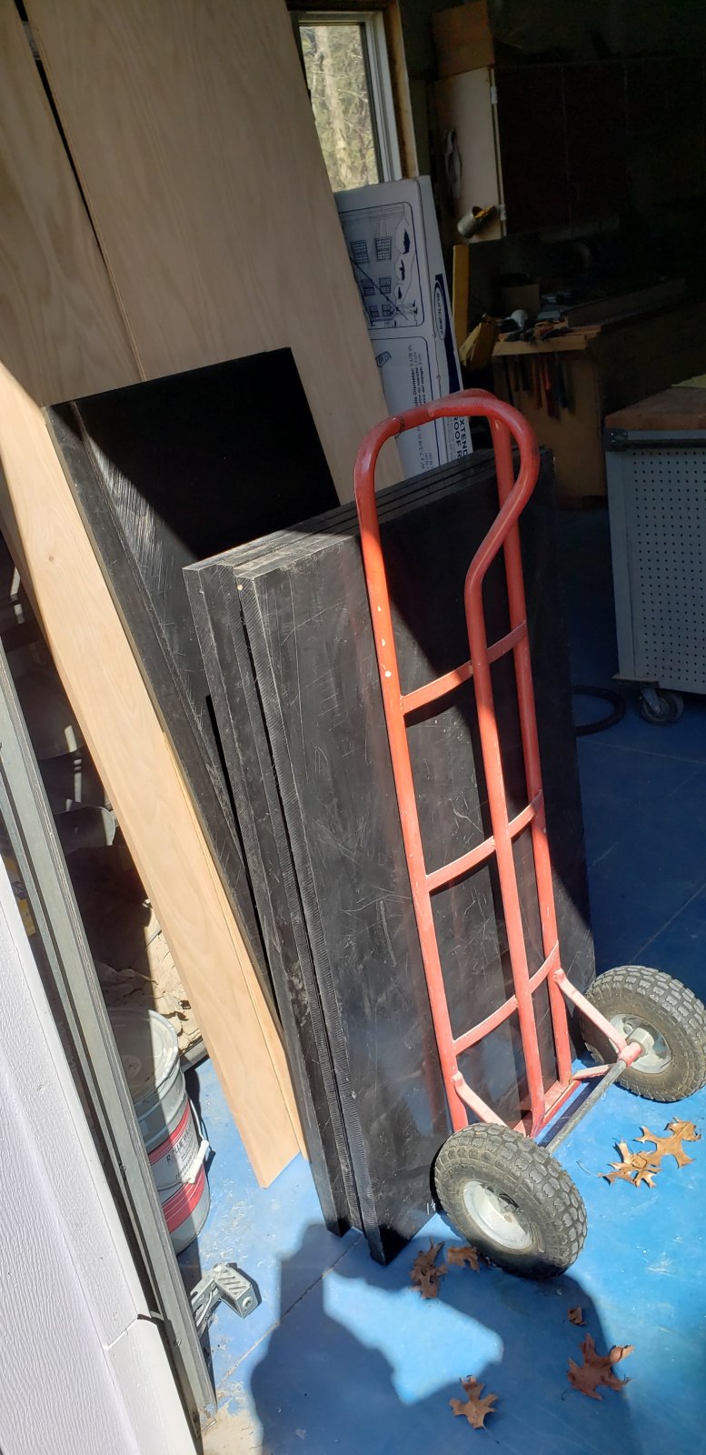

  20. Historiker
    2,162
    9,214Coins
    +2,170 / 19 / -1

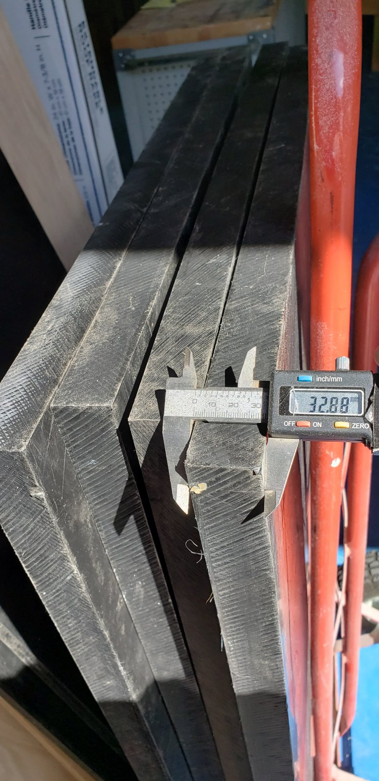

    Ordered 100x100 aluminum profile today (guess I should change the name of the thread again).
    A lucky find on craigslist means that I can CNC my parts rather than print them 1.25" (32mm) HDPE sheets will do very well indeed.
