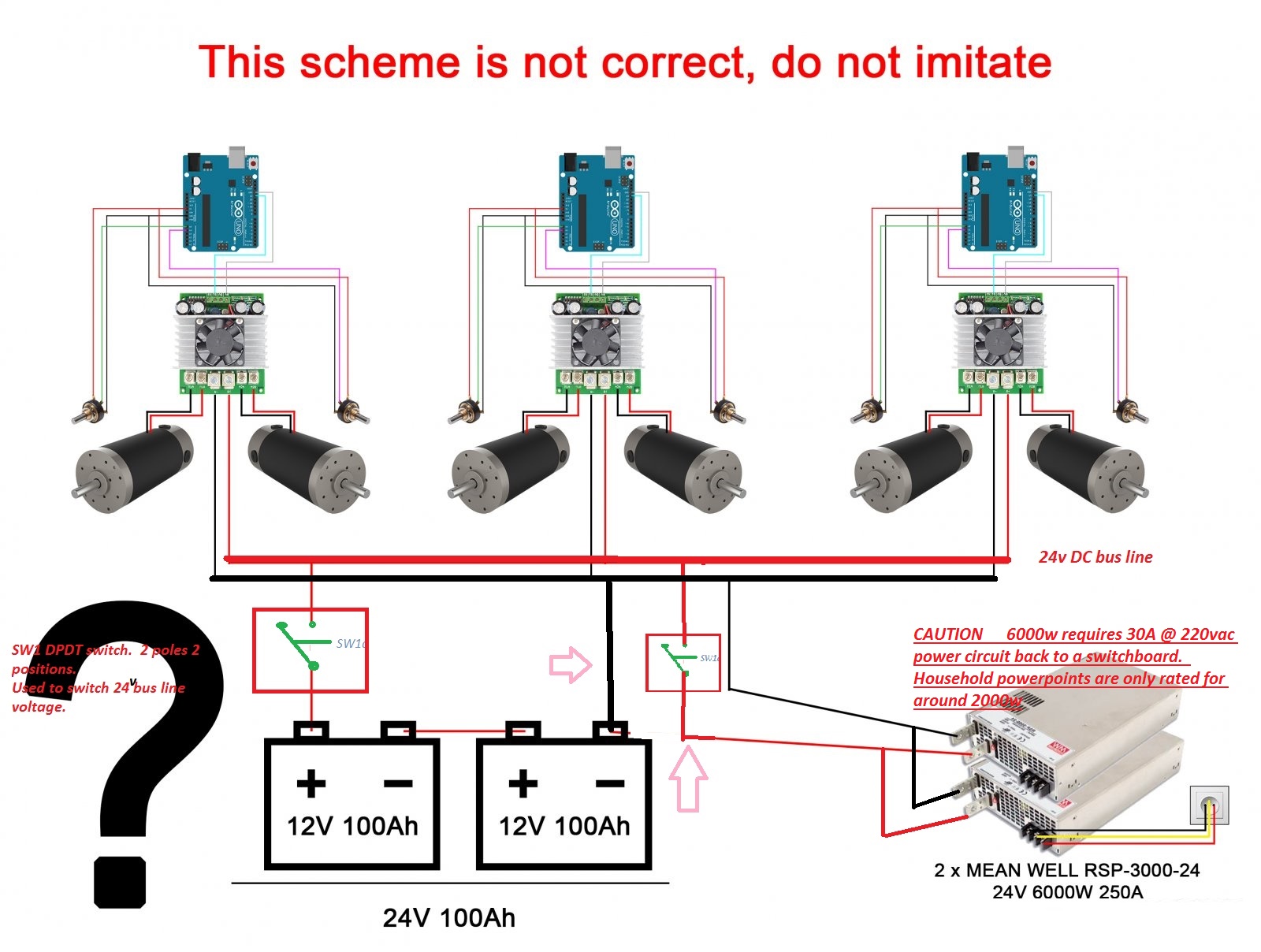

    I also considered the capacitor idea so I emailed Dimension Engineering and this is what they said:
    My email:
    Rather using 2 x 12V @ 30Ah lead acid batteries for each Sabertooth 2x60 driving 2 x 24v 450W DC motors (max current 25A fully loaded), could I use 10 x 2.7V 500 Farad super capacitors connected in series for a total capacity of 50 Farads and a rating of 27V? I have attached an example from eBay. These capacitors can start cars and so are capable of 100A+ but would they be suitable for the motor regenerative current? If they are then I wouldn't have to buy 6 x 12V @ 30Ah lead acid batteries saving weight, cost and safety.
    DE reply:
    You can try it, but I would be surprised if it worked.
    If your max current per motor does not exceed 25A, then you may be able to use a smaller battery than 30Ah. Something like 12Ah might work.

    @OZHEAT , @SixDegreesOfFlight, @SilentChill thanks for the replies in my thread.
    Can you tell me what the power supply to my installation really needs to be?
    2x Mean well rsp-3000-24 - 3000W 24VDC 125A is probably a little too much ?? what do you think ?

    @Grizus
    The 24V 450W motors you will use are similar to my build. So you will need around 30A per motor. If you use server psu they tend to shutdown as they are sensitive to the regenerative current. Hence @SilentChill went for LED power supplies. These are cheap and robust and more tolerant in this application. You have to make a decision about whether you want them all in parallel. Read through @SilentChill thread from the famous page 25 (my favourite :p) where he almost started his build again.

    Hi SIX DOF,
    Concerning your advise on the two MeanWell PSUs in parallel; PSUs of this size often have a load sharing connection which enables up to 5 PSUs in parallel and when the load sharing line is connected will shed the load across the PSUs. If the PSUs have no loadsharing option then the suggested diodes are a good option. To ensure that the diodes are not dissipating too much heat the best types are with a low internal resistance. Most likely Skotty diodes for their low internal resistance which results in a lower heat dissipation. It is still a bit tricky in respect to tolerances of these diodes and the voltage drop across them as if there is a slight difference tolerance then the PSU with the lowest voltage drop will take all the load with all sorts of issues such as current limiter being activated and most likely, due to the strain of maximum performance on this PSU, an early exit to the eternal fields of PSUs. If there is no loadsharing option on the PSUs then the voltage must be adjusted for each PSU. This you can do by connecting the PSU NEGs together and measure between the common NEG and individual POS of each PSU. With the voltage adjust on the PSU you can adjust till the voltages are equal. Another way is to read the manual or contact MeanWell before you parallel them together "cold".

    Hi OZHEAT, for a rig I am presently designing I was thinking of electrolytic capacitors too but we must be cautious about the charge of these cap's and what could happen during maintenance on the electrical side and the discharge of these large charges. I was looking at car audio cap's with voltage indication so it would be easy to recognize if there was any charge left. Although these low voltages will not kill you the surge of the current will cause serious burns and could cause fires too.
