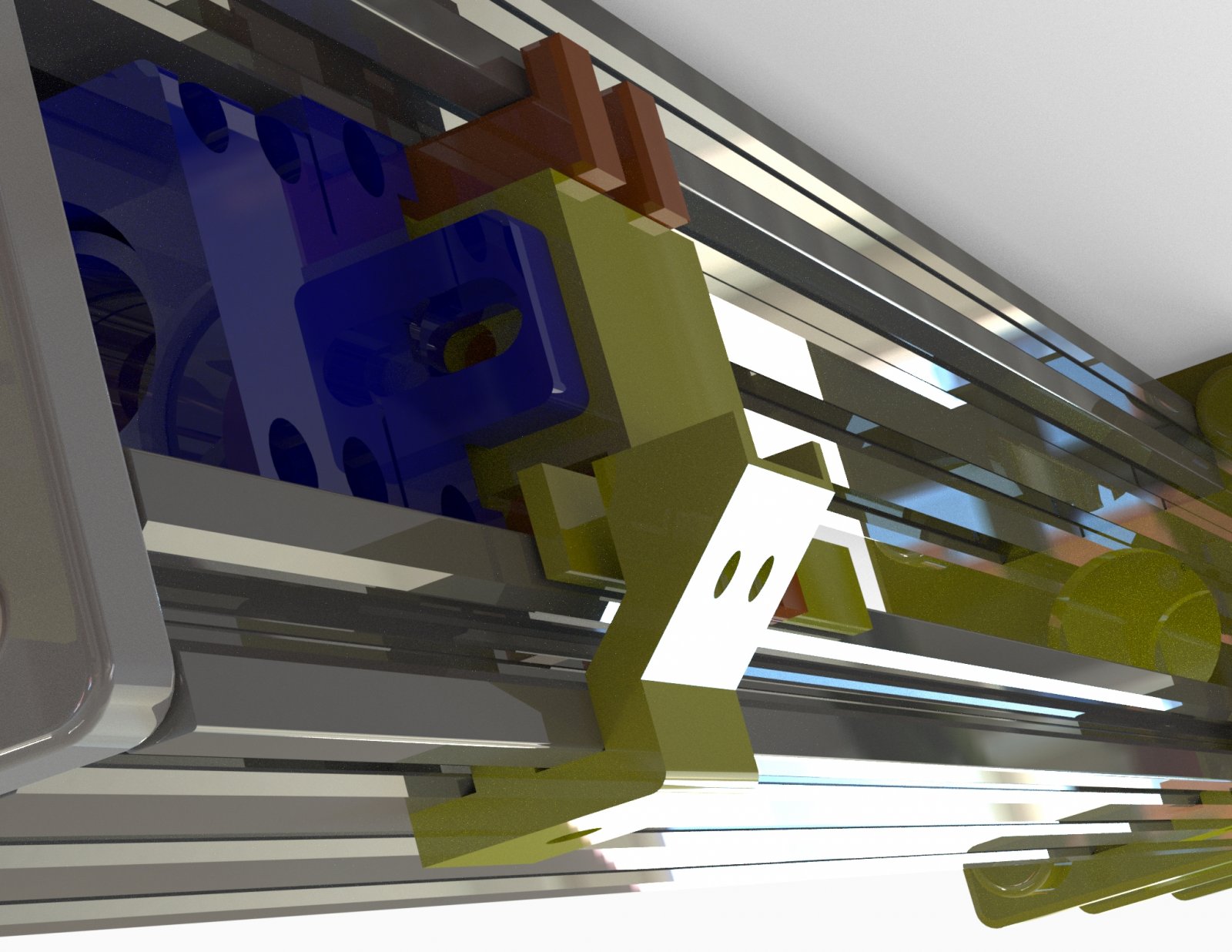

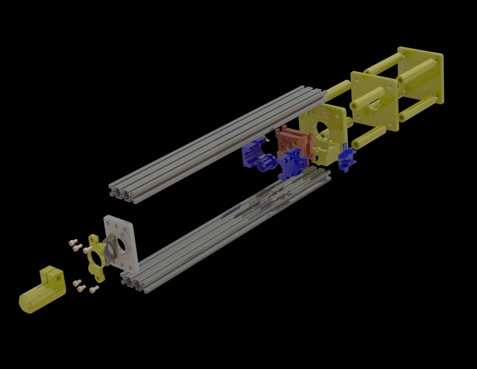

    Wow you guys really do push the benchmarks up a notch, dam just when I think 3D printing is only for light load bearing stuff bang you guys show otherwise ... that's really nice workmanship @bruce stephen another project that shows a great option for securing ballnut to the carbon or metal tube .... have to add that's an impressive exploded assembly as well ...Thanks for Posting ...keep em coming were loving this :) .... I always chime in with this my pet advice topic, and that is, Don't underestimate the forces these babies will produce in a runaway situation ( these generally happen during initial testing LOL ...ask me how I know Doh ) so make sure you have adjustable limit switches fitted ( which can be repositioned i.e shorter distance for testing and longer once you aim for max actuator travel) and be aware that these actuators carry a lot of momentum even after tripping each limit switch ... I will be adding some rubber bump stops inside the actuators to at least take out the worst of the over run travel ( if it occurs ) and to prevent metal to metal or metal to plastic clashes ...these bumpers should not reduce the overall travel by any great amount and may save damage to the ballnut .. Just a thought guys

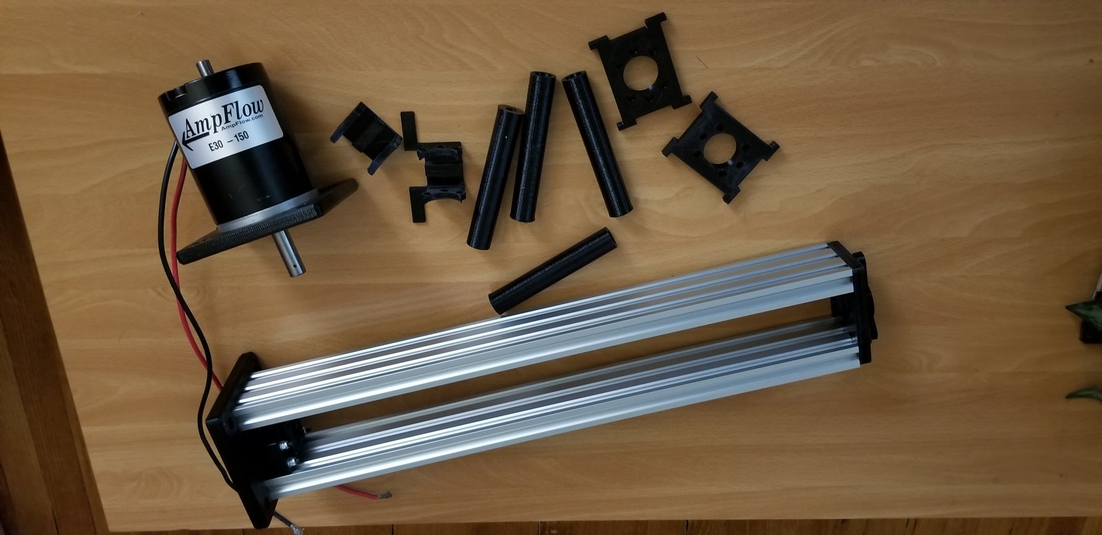

    @Fluke The major components are 1605 or 1610. Ballscrew with bk12 bearing block. Gfl 25 bearing from IGUS. 25od x 22id x 500mm carbon tubing. 10x13 plumb coupler. 2 20 x 60 x 500 vslot rails. An e 30 150 motor from ebay. This list will grow there are a few things not added yet. Also pm me before you print because im updating these files almost daily. So make sure you have the most current iterations. Ill update thingi periodically.

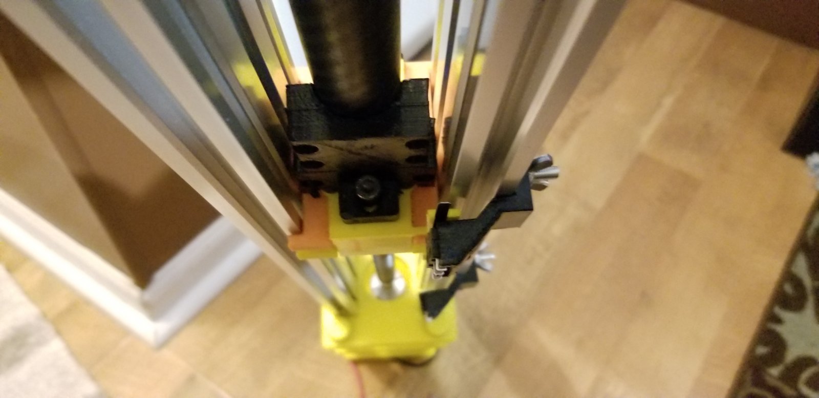

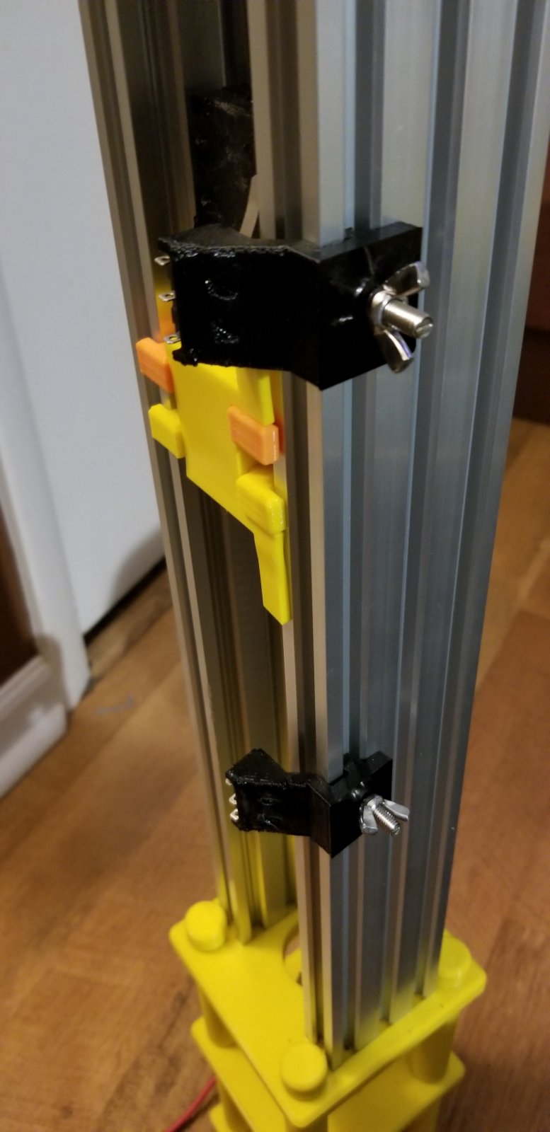

    got limit switch brackets drawn, printed and installed.
    I need to clean up the parts a little. i was printing them too fast/hot.

    @bruce stephen
    Good to see someone with a limit switches where you actually hit limits, it has time to do something like stop rather than having a limit at the very end where it it already has hit a hard stop.

    others have warned against over run and backdriving so hopefully this will help by letting me tune the position. I am thinking i may lengthen and thicken the wings that hit the limit switch.

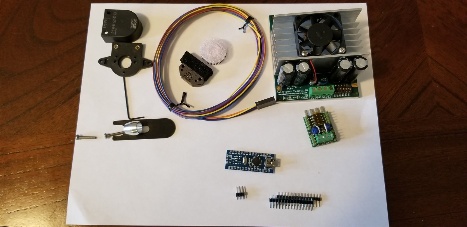

    I started printing the parts in PETG. It has about 10 times the strength of PLA so I am confident this will hold up to the stress. I ordered an encoder, sabertooth and kangaroo X2 they should be here this week. I should be testing soon.

    More goodies showed up. Just need a few more components to begin testing.
