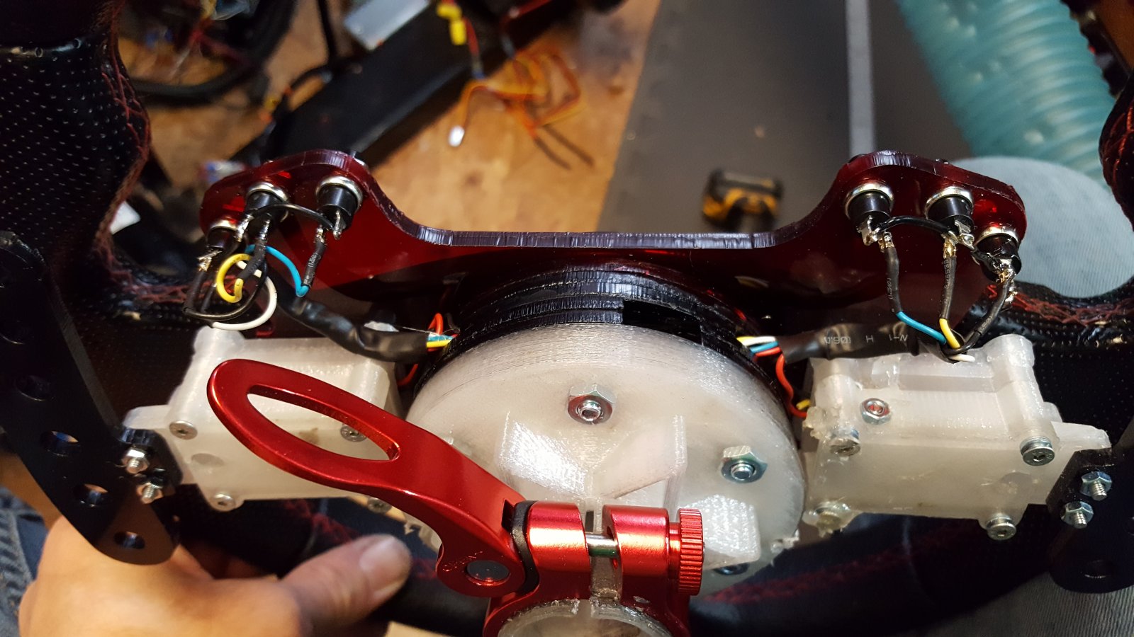

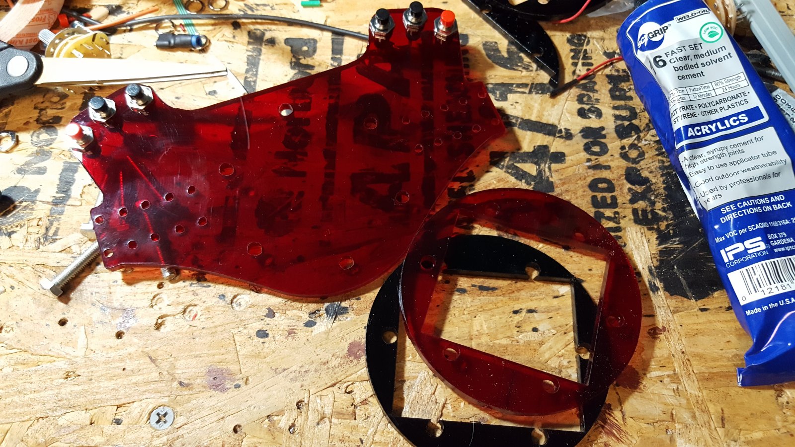

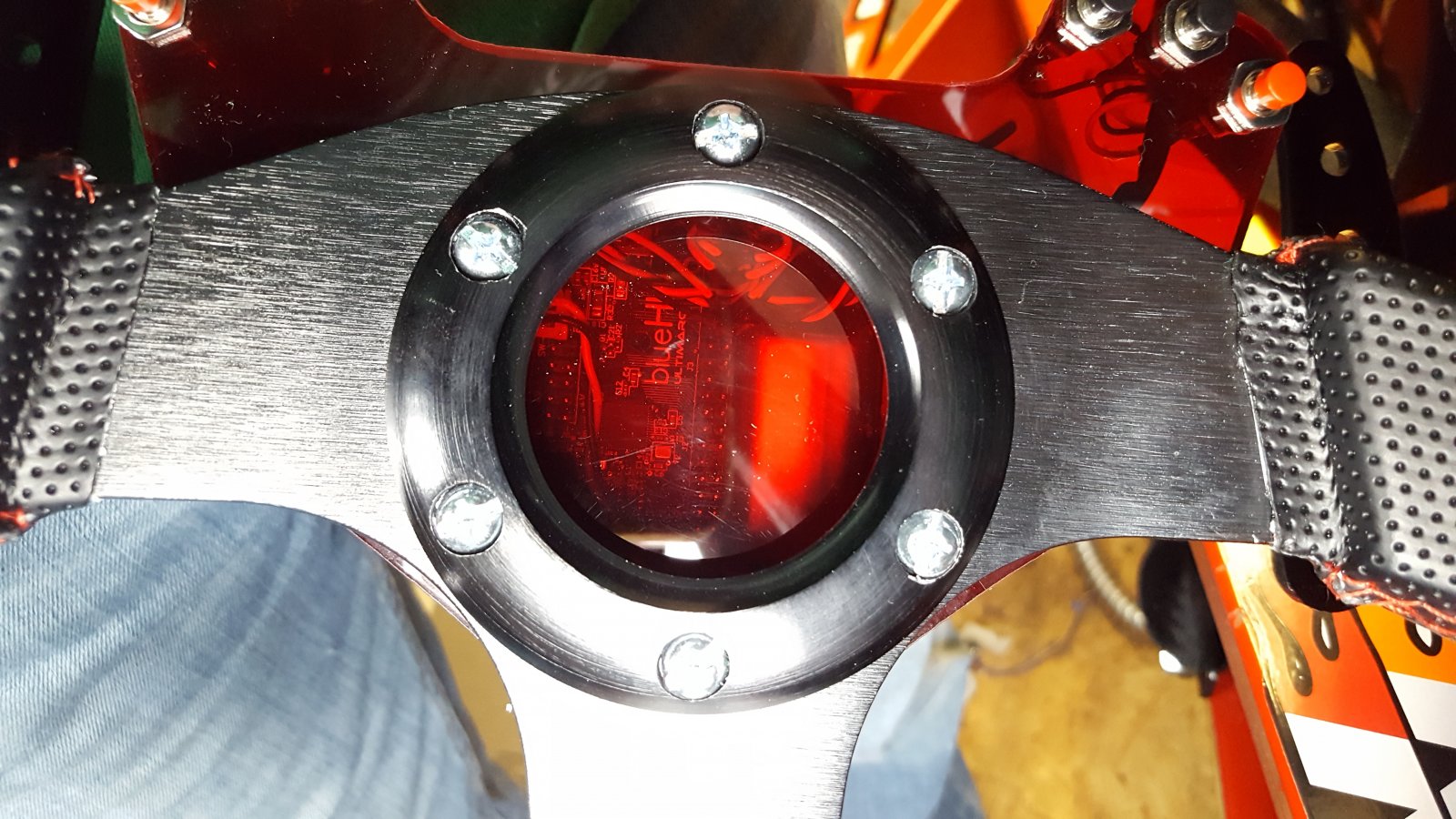

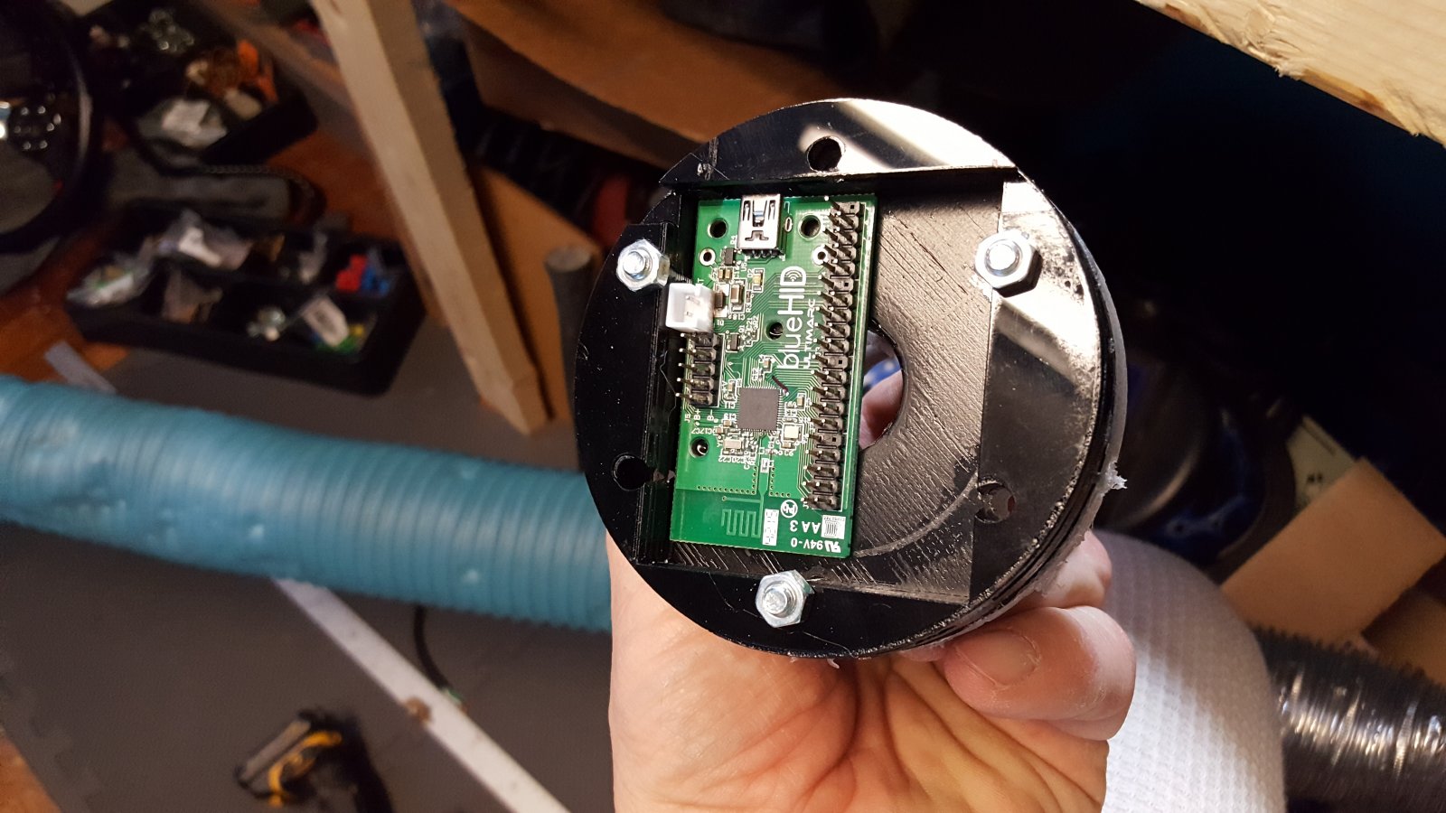

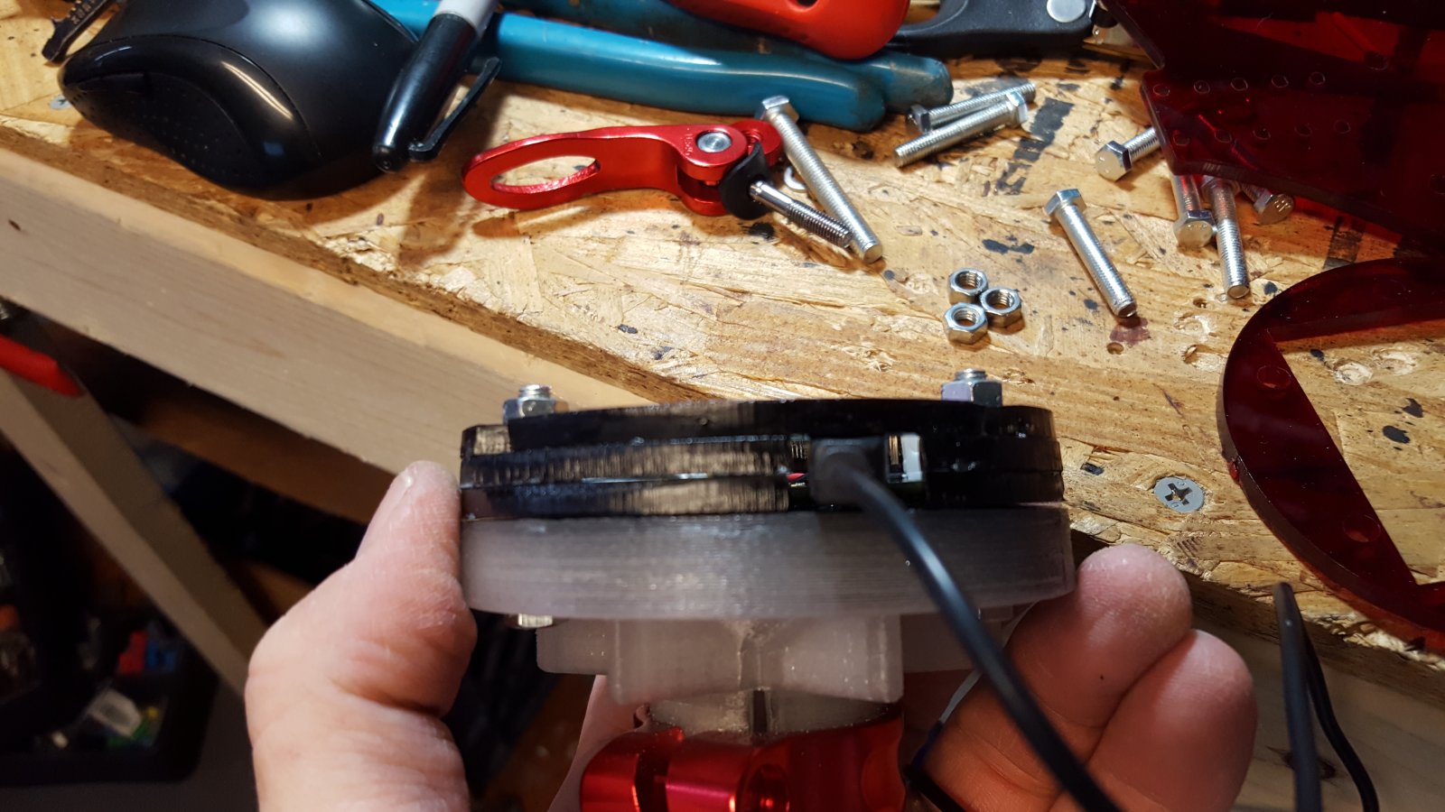

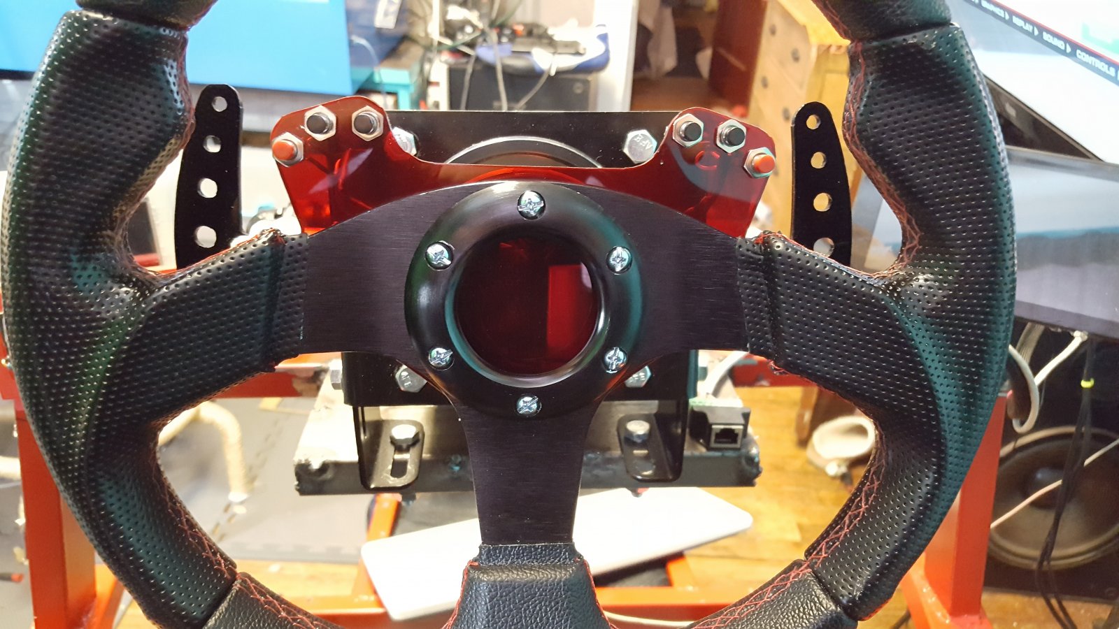

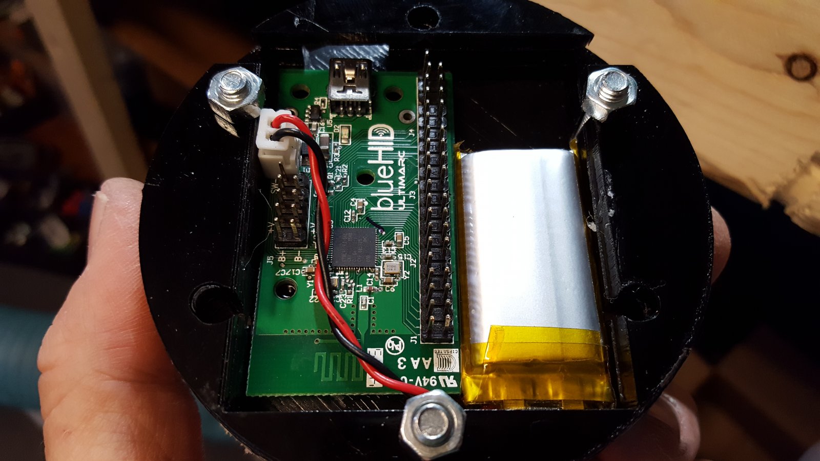

    Rebuilt my gt wheel. Got rid of lower buttons added a button on each side up top. Added bluetooth 4.0 with bluehid board and battery in center of rim.
  2. Nick Moxley
    17,057Coins
    +2,506 / 30 / -2
    I look forward to hearing how you get on with the Bluetooth, What board exactly is that ?

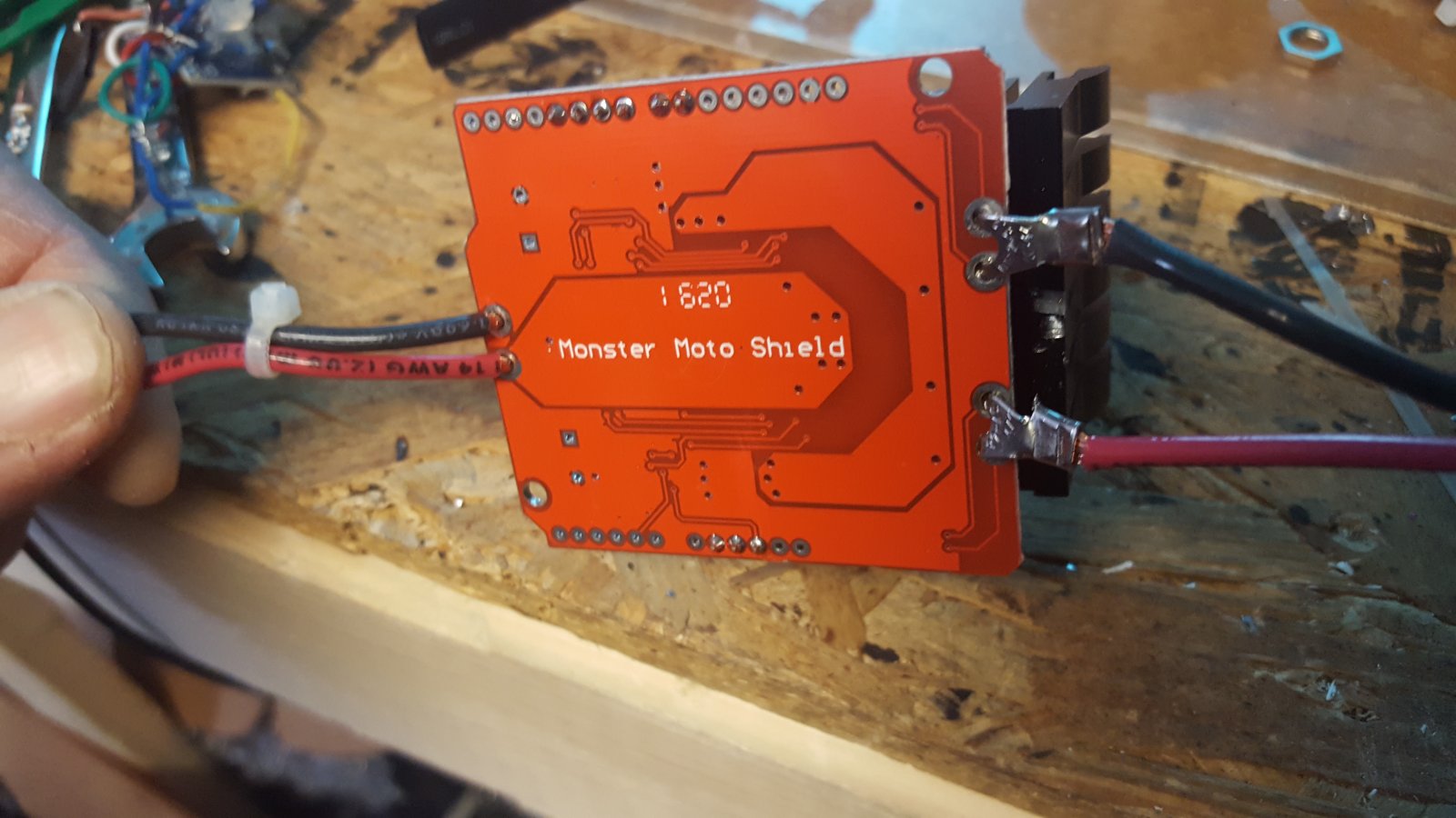

    Hey Bruce nice rig and osw wheel is a great addition I'm running one of the older argon units
    But anyways I have a question do you have a link were too find the wire connections too solder to monster moto board for - +
    Would be a big help I'm currently solder wire straight too board takes a lot of time

    20170107_144225.jpg @Justin Dail i just solder 14awg stranded to the supply side then I solder a flange spade wire connector to the output.
    @Nick Moxley three weeks on the Bluetooth it's awesome I haven't had to charge yet, no missed shifts. Worth the price to eliminate cords.

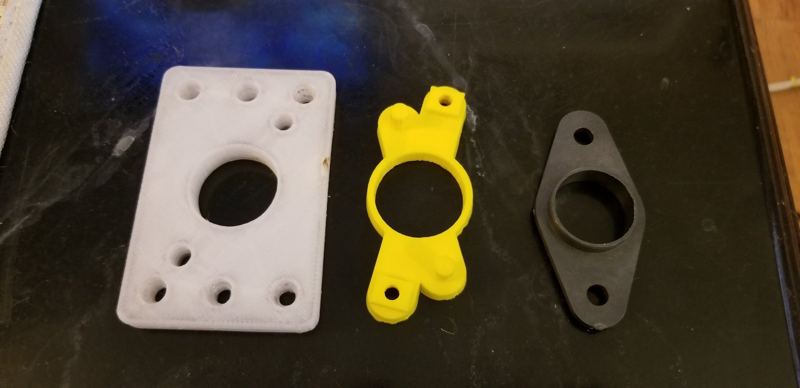

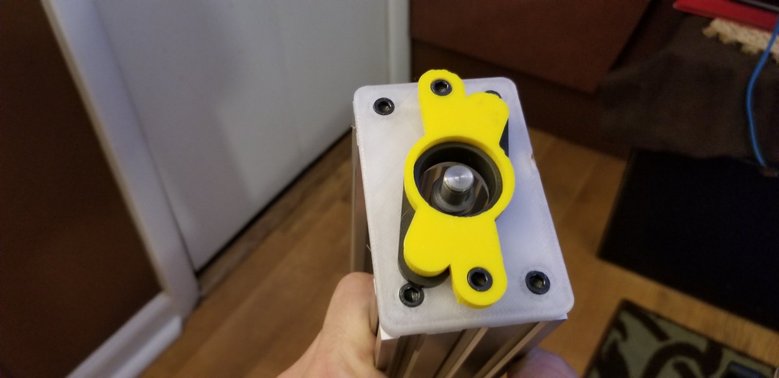

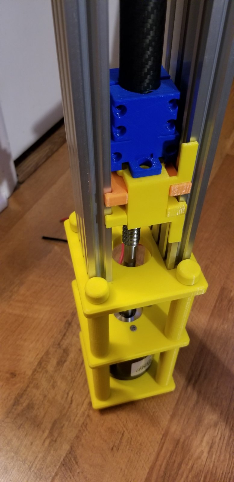

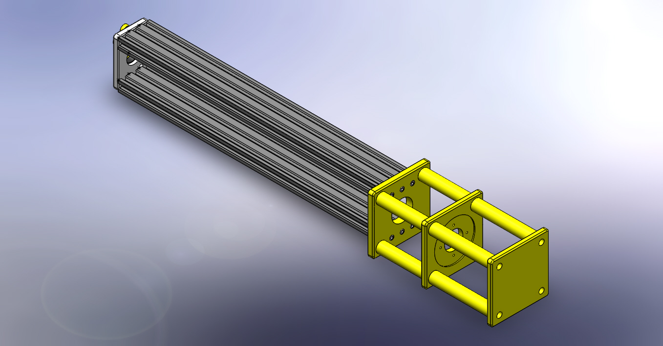

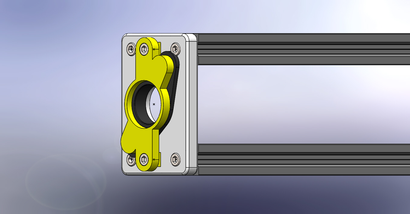

    Its been awhile since Ive updated this thread. Its time to upgrade to @SeatTime style actuators.
    I started by just copying the specs from @wannabeaflyer2 his pdf is very detailed. But as my motors and other parts were different I started just drawing my own. I have finished the main structure including plates,spacers, bearing retainer. I will start adding the position sensor assembly and limit switch brackets next.

  13. llluis
    Mar 30, 2017
    164
    Quebec
    1,632Coins
    +103 / 1 / -0
    What are you print settings (material and infill)?
  14. bruce stephen
    Jun 7, 2015
    1,286
    general contractor
    michigan
    9,115Coins
    +1,243 / 9 / -0
    I am using pla. At 100percent infill. I started with petg g but i think pla will be plenty strong. I have a bunch of pla sitting here so thats what im using. If it doesnt hold up its back to pet or abs.
  15. wannabeaflyer2
    Jun 12, 2015
    724
    london uk
    8,354Coins
    +958 / 7 / -0
    Thing of Beauty @bruce stephen glad the drgs were of some help . can I ask what the yellow printed part does or holds ?? me being nosey LOL ..aha got it liner bush of some sort :)
  16. bruce stephen
    Jun 7, 2015
    1,286
    general contractor
    michigan
    9,115Coins
    +1,243 / 9 / -0
    it is holding the Igus bearing in place. I chose a bearing that had a flange. I'm trying to reduce amount of parts bought example: with the spacers (they capture the nuts at the bottom) it reduces the nuts and washers from 24 each down to 16 each. If you see early pitfalls please let me know as this is all "suck it and see". :D

    Slow progress

    @bruce stephen
    Are you going to put a lower bearing on the ballscrew?
    Motor's bearings do not like thrust loads on them and the wave washer used behind the motor bearing for thrust forces will quickly be useless.
    Also if you use an "oldham" type of coupling watch out for hitting lower hard limit as it will probably lift the ballscrew up and you may lose the balls from the screw assembly.
  20. bruce stephen
    Jun 7, 2015
    1,286
    general contractor
    michigan
    9,115Coins
    +1,243 / 9 / -0
    bk12 bearing but it hasnt arrived yet.
