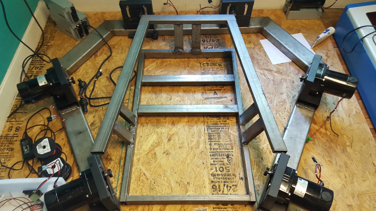

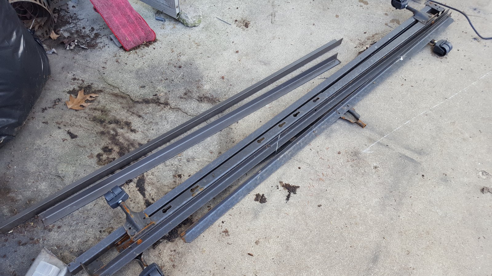

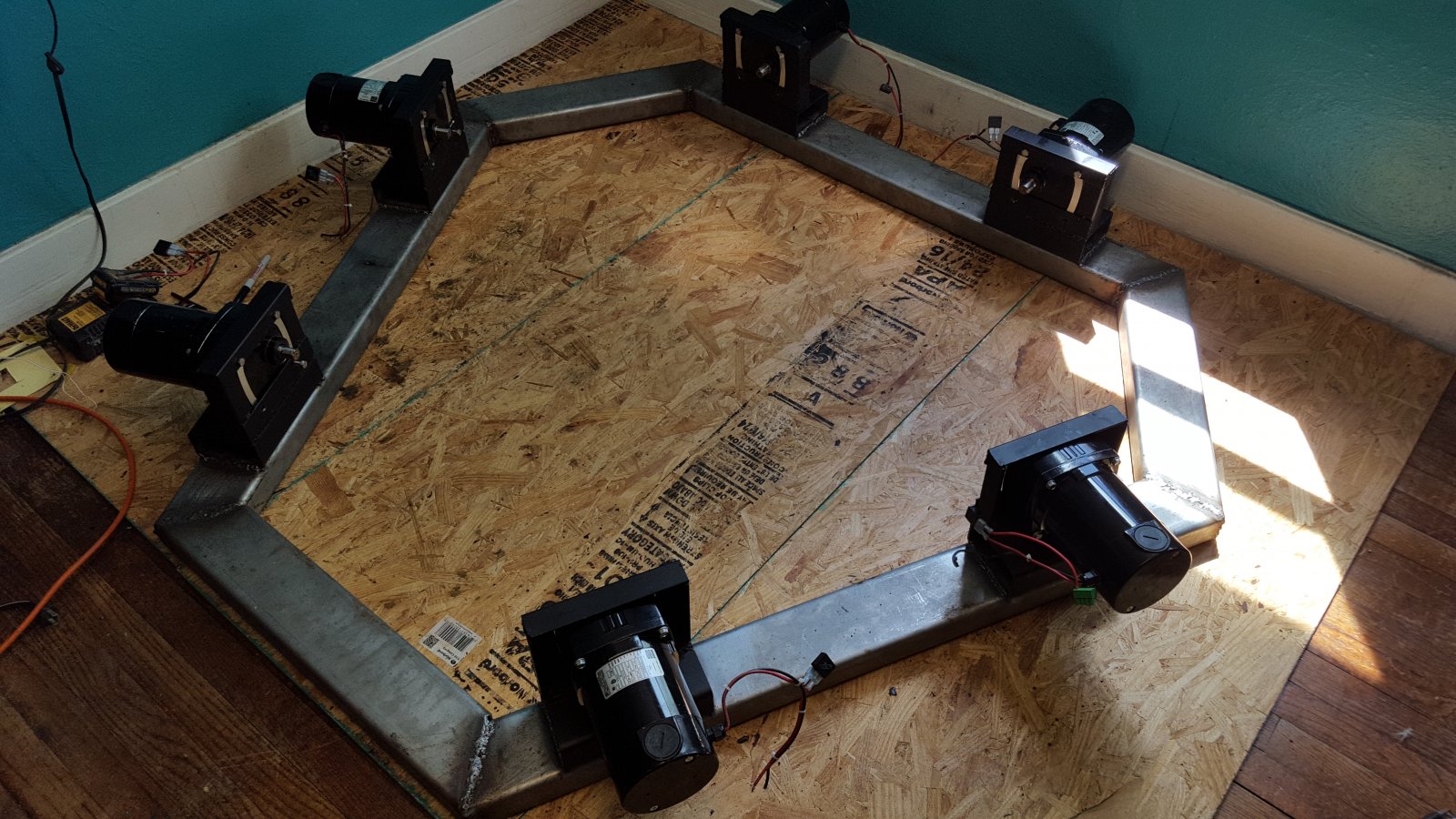

    I took the scrap pieces from the base along with some re-purposed bed frame rails to create my motor brackets. I'll drill them tomorrow before I mount them to the base.
  2. bruce stephen
    Jun 7, 2015
    1,286
    general contractor
    michigan
    9,115Coins
    +1,243 / 9 / -0
    Got the old sim out, the new frame in place. I mounted the brackets and motors. I'll start on the cockpit next.

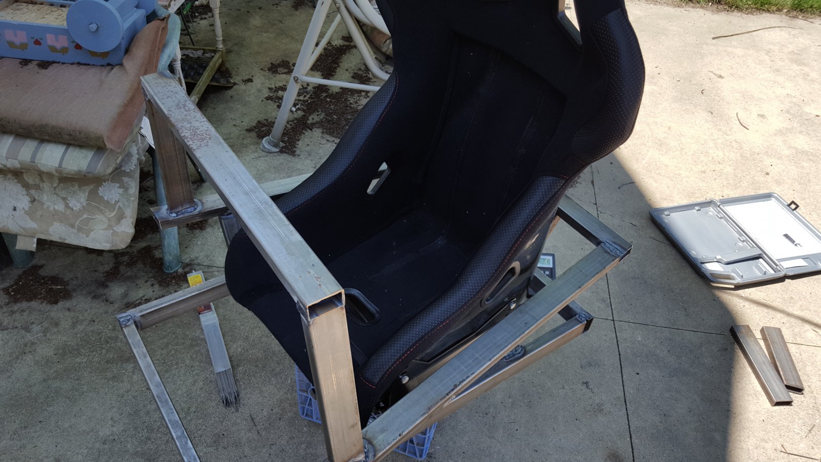

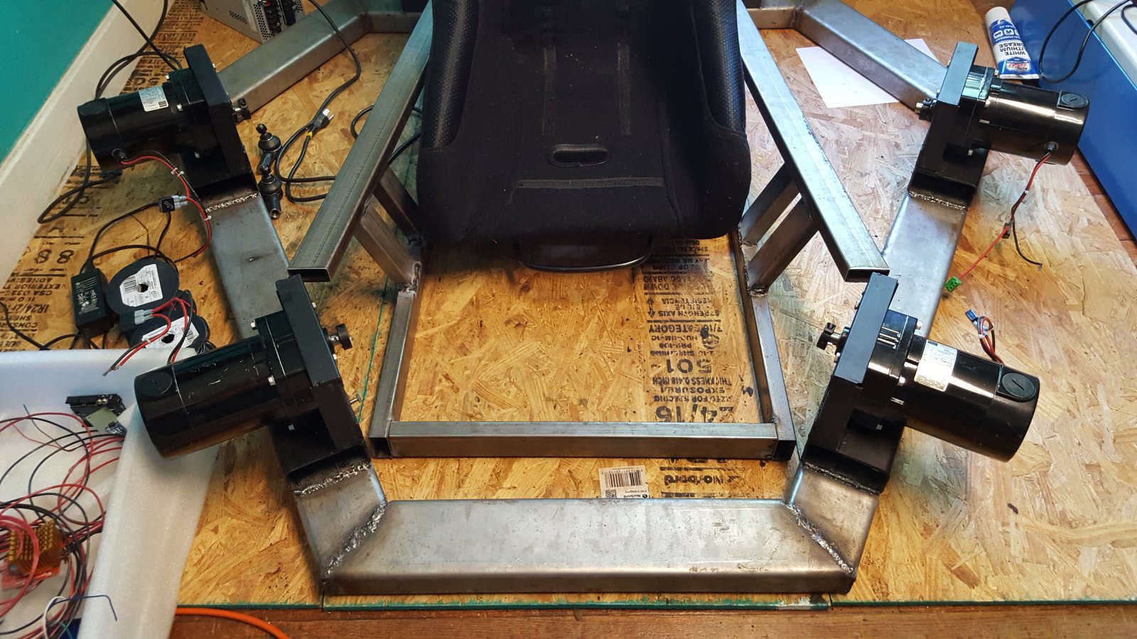

    Wife is gonna complain about the bare osb. I can already hear it. "Are you just gonna leave it like that". It will have to be covered. Maybe I'll do some indoor/outdoor after I'm done welding. Yeah we won't share that I was welding in the house she won't like that either. Maybe she's right in calling me a 45 year old teenager. Oh well.

  9. Nick Moxley
    17,057Coins
    +2,506 / 30 / -2
    Whats the Weight limit your going for Bruce ? Cant exactly say that frame looks very light per say....And i would assume Every lb counts at this stage.
  10. RacingMat
    2,233
    21,082Coins
    it looks very promising!
    keep practicing the welding: maybe increase the intensity or slow down your speed in order to melt more the metal.

    Yes I'm more of a grinder than a welder lol. I'll touch them up and grind. A better welder with bigger rods would help. These little rods wanna burn thru easy.

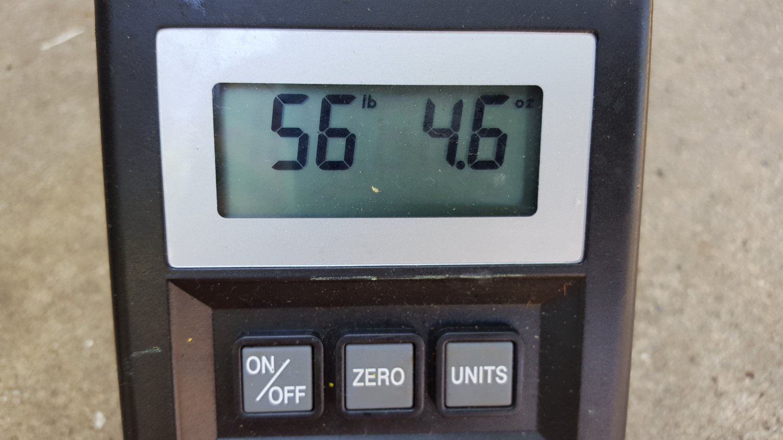

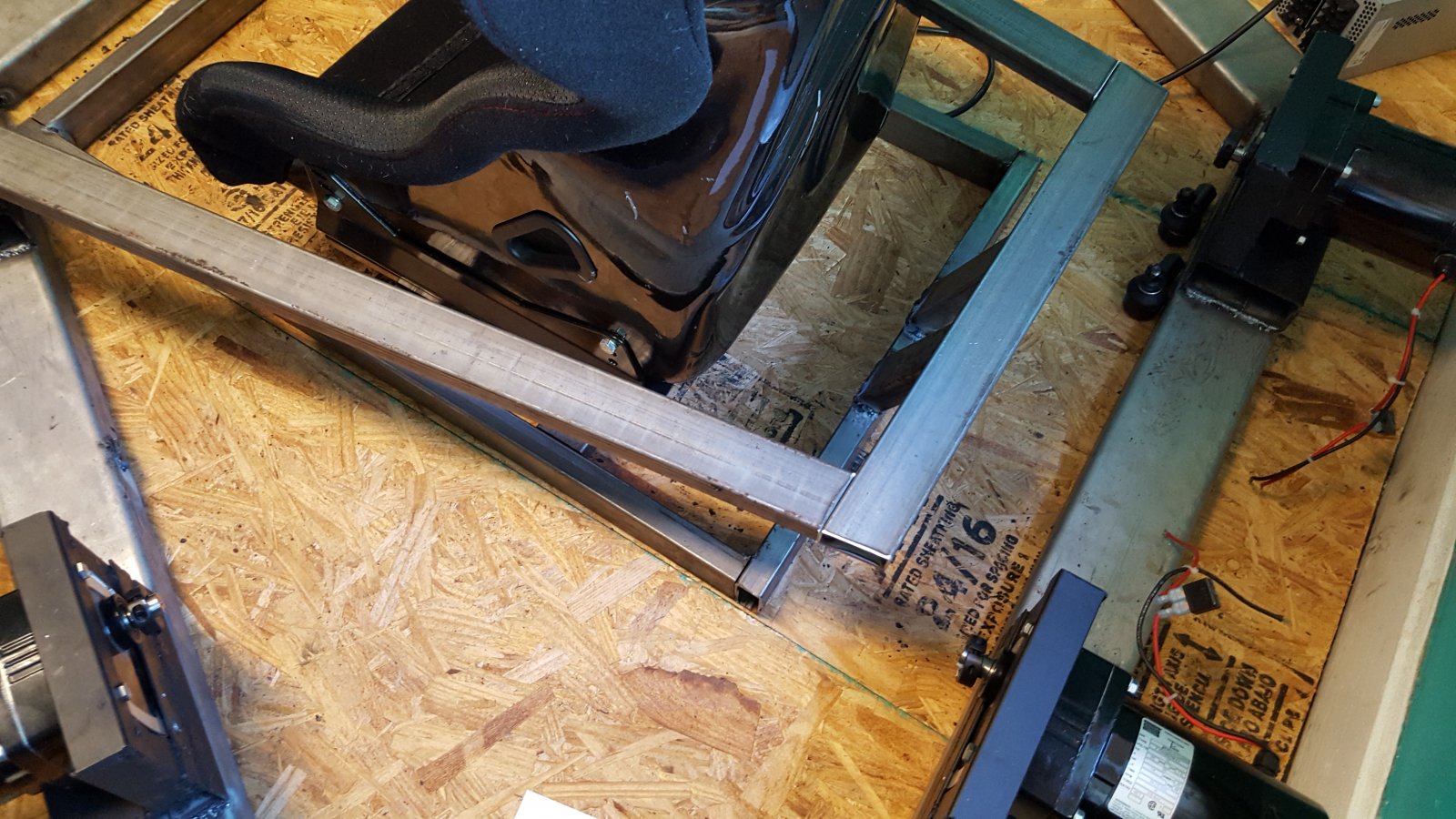

    20160523_130433.jpg @Nick Moxley, I still have to add the pedal area. I should be able to keep itunder 100lbs with hardware. We'll see if I'm forced to do some hole saw weight loss. I weigh about 150, so if total weight is less than 250lbs it should be ok.

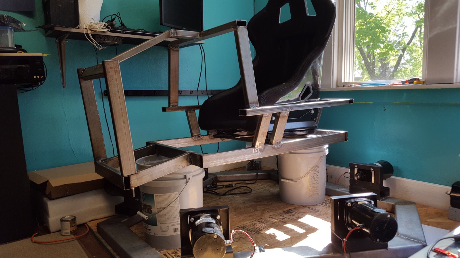

    Soon it won't be bucket powered.

    Work keeps getting in the way of my sim building. It's still bucket powered. I'll try to get the rods made later after work. Then I can start on the control electronics.

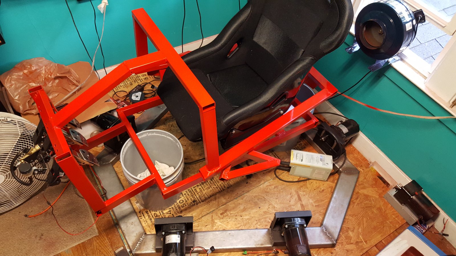

    Seat is still not attached as I'm still lacking a motor suitable for the surge application. The bodines come in at 13lbs each without any hardware. That's just too much weight. I really haven't looked as I've been building and working. Also on the to do is levers and rods, electronics, feedback system, extending the wheel upright closer to the driver, paint base, end caps for the 1x2 steel, diamond plate for foot area, monitor mounts............
    In short there's still and bunch of crap to do. I'm trying to be as close as possible for MIS week on IRacing. That's the second week of June so maybe I need to give up on sleep. An hour or two Of building each day is not enough.
