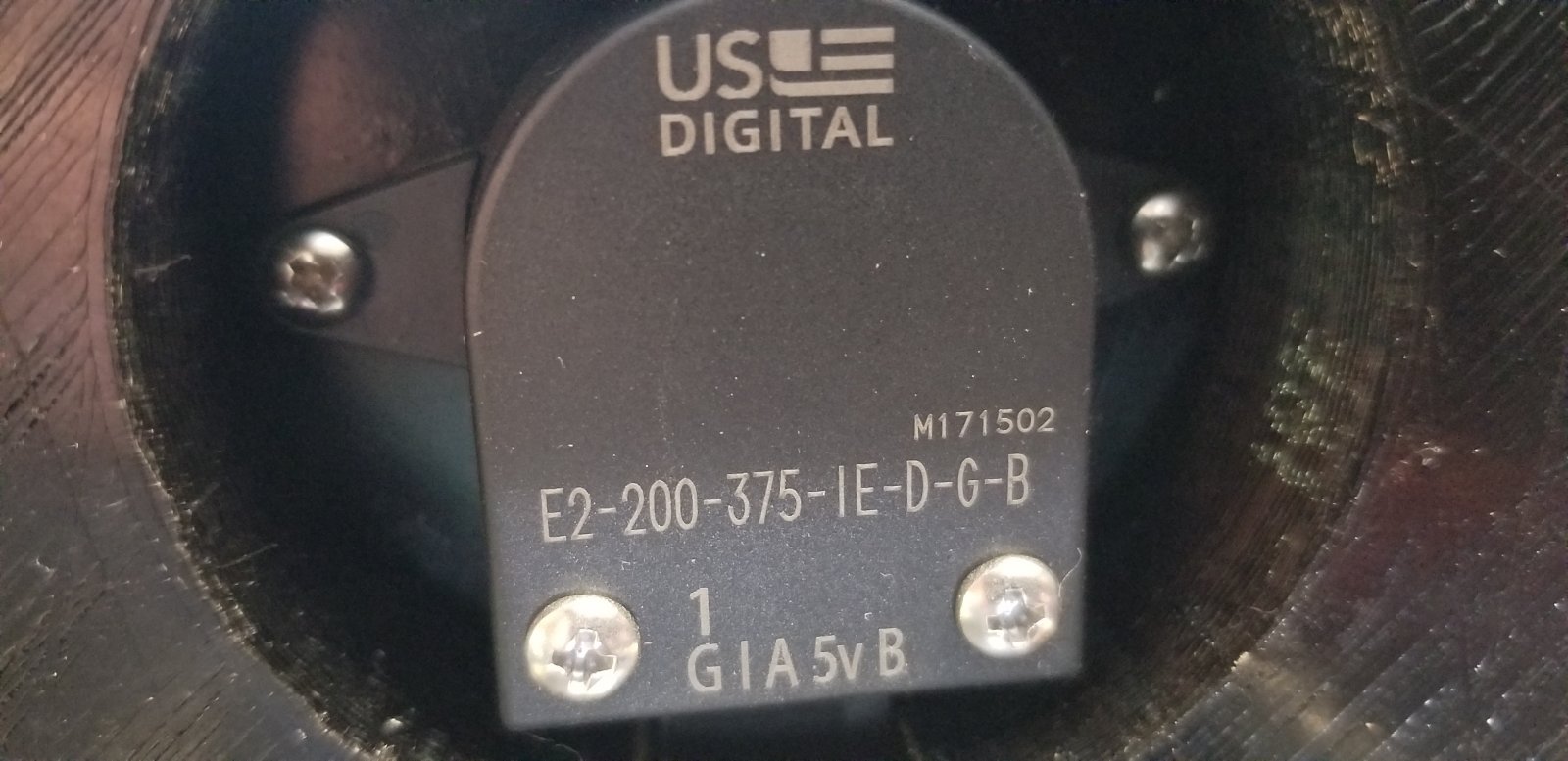

    hello, I wanted to know if the encoders work well, and if you use the controller Arduino uno? Because the encoders that I have worked well but the values are not stable!
    thanks

    Recently I have experimented with STM32F1 (blue pill the same that Thanos is using on his Encoder2Position module) on my 3000 RPM servo with 2500 PPR encoder (which gives 10000 positions per revolution) and I recommend it. It works flawlessly! Not even a single miss. It is relatively easy to program - you can use arduino IDE. And it is really dirt cheap :)

    I am using a rs232 connected to a kangaroo and sabertooth 2x60. The encoders work flawlessly

    was this using the 50 ppr encoders ?
    be interesting to see the difference with more resolution

    The older one is still using the 50ppr and the newest design used a 200 ppr. Although there were many more references points I could not see a noticable difference in movement.

    Hey , my mine have 1250 ppr and each time is not stable with arduno uno ( skipe some number ) may be is my code who is not correct … which is yourss ?thanks
  19. Gadget999
    1,992
    12,156Coins
    +492 / 11 / -0
    Try less pulses 360 is plenty enough

    Hello! I'am using different micro controller (STM32F1) which has hardware timer with encoder interface. On Arduino you could try to use interrupts to read encoder pulses but still it might loose some pulses with 1250 PPR at high speeds.
