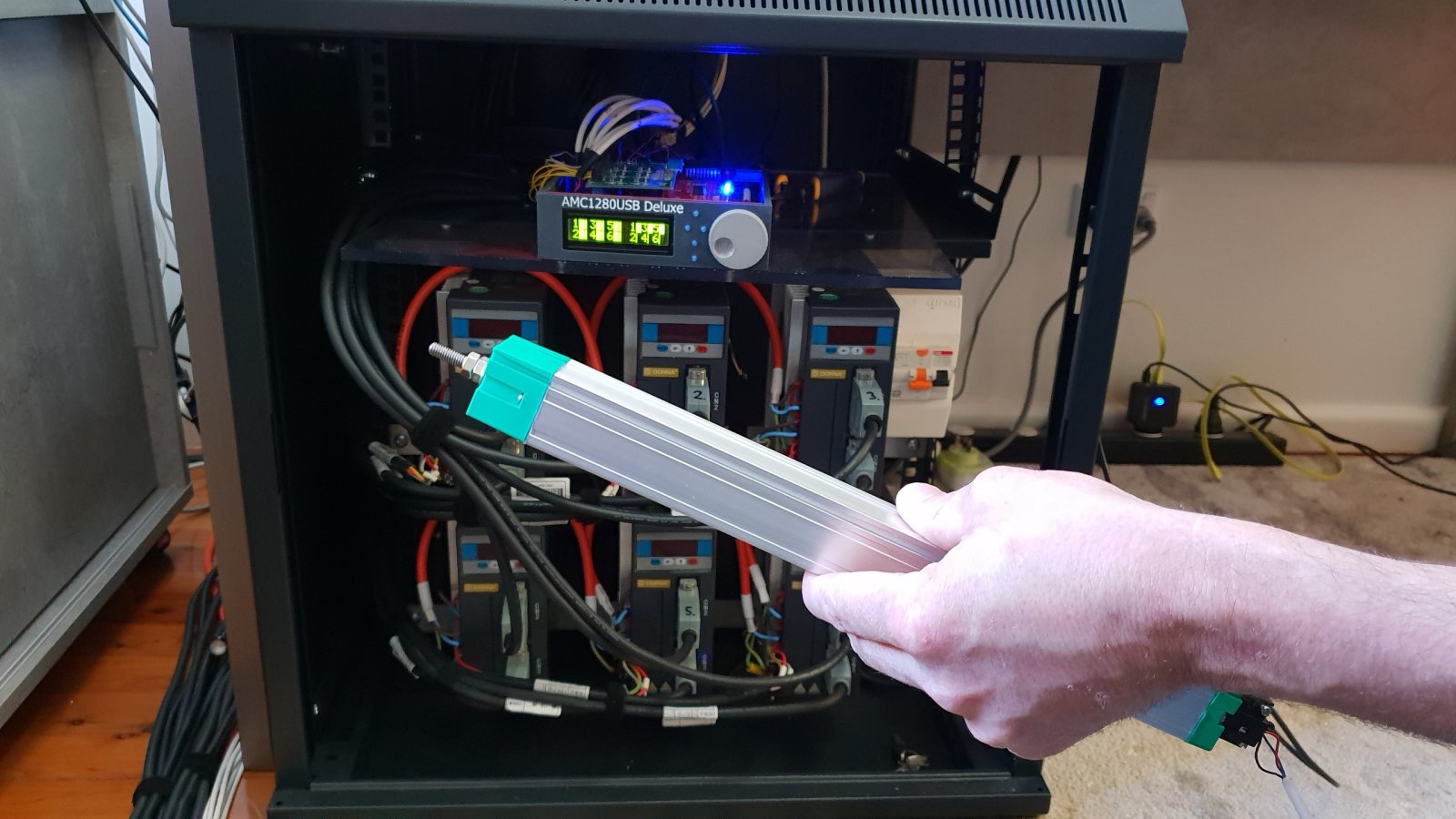

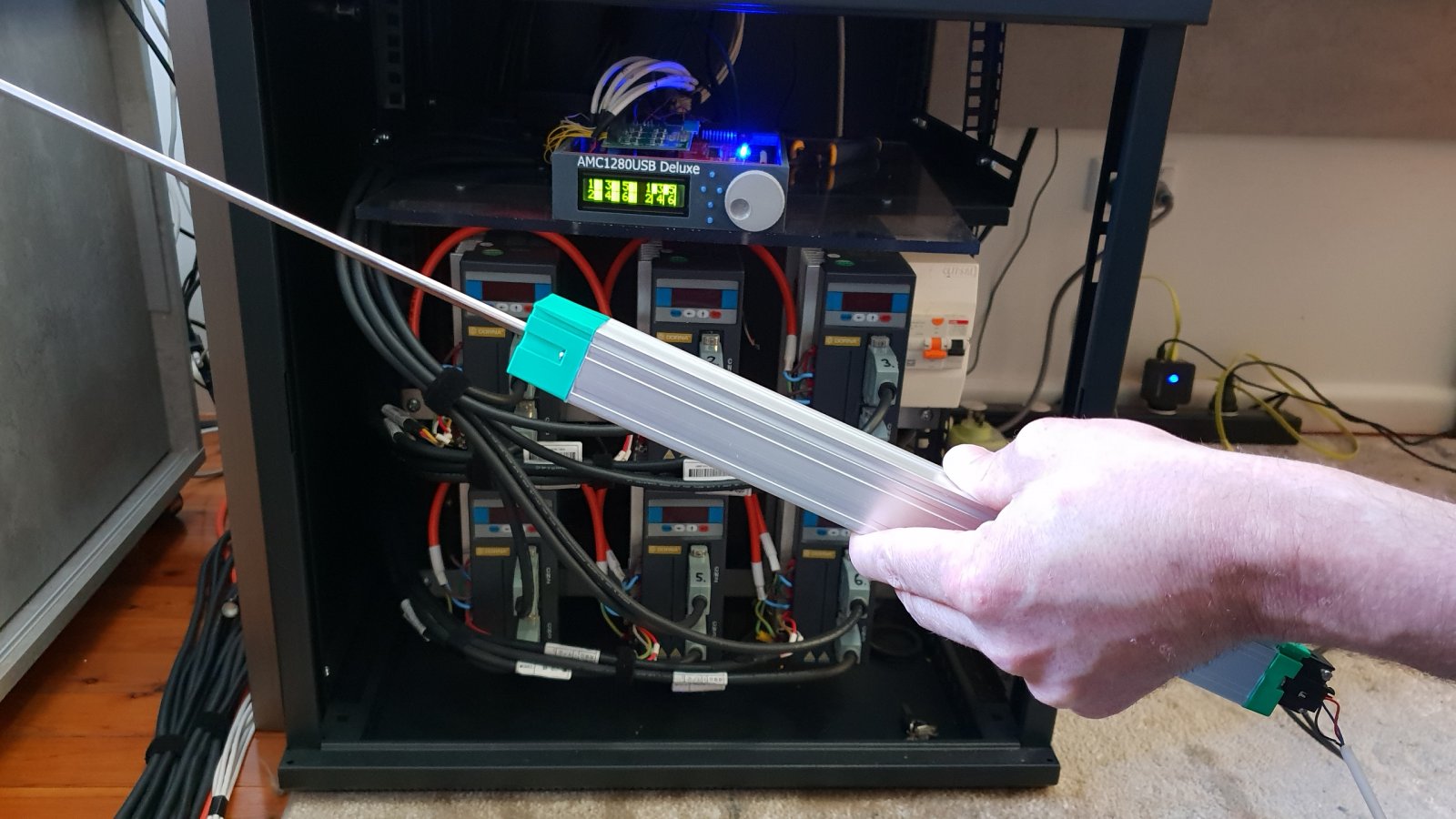

    You can reverse pins 1 and 3 on the potentiometer. This will make it read opposite direction so it will follow the bars on the screen.
    You can display numbers (percentage) on the lcd screen by pressing the encoder in, on the screen that displays bars!

    Ok Great that worked.. also if I slide the potentiometer in and out with the motor running it spins the motor in both directions at variable speeds!
    Awesome stuff Thanks Thanos.

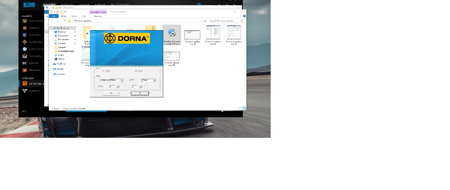

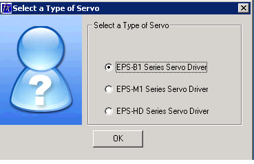

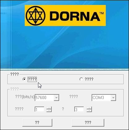

    I cant seem to pick the drives in the dorwin software .. it only gives me options for EPS-B1 EPS-M1 and EPS-HD but i dont have any of those , i only have EPS-EB.
    The software also has alot of question marks so i can not read what anything says as well as the buttons to choose

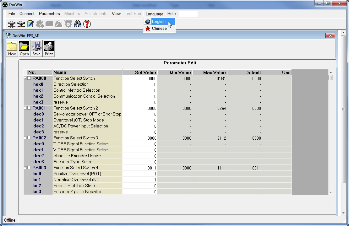

    You can switch the software to english language if you proceed with:
    And in the program click on the language menu:
    But, you are right, it seems Dorwin doesn't have profile for the parameters of EPS-EB...
    So, if you are going to replace the two damaged servo drives you would have to get the same EPS-EB models so there is not difference is speeds etc.

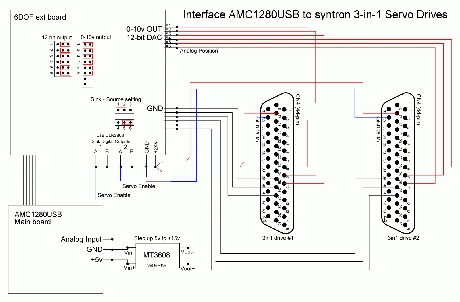

    I believe he will switch you to absolute positioning servo drives from syntron. In that case you won't need limit switches or linear potentiometers or even servo signal driving circuit. It hooks up to AMC1280USB with just 6 twisted shielded cable pairs over to its 12bit DAC interface:

    I understand all of this diagram but what kind of cable should i use? is it a Cat6 twisted pair .. sorry im a bit confused on this
    And also the Sink Digital Inputs part.. On the bottom right of the extension board i see [+ com - - +].
    Would i also be able to get the 3D printer file for the top cover of the AMC1280USB so i could stop any dust getting in ?
    Thanks Thanos

    You can use a stripped CAT6 cable for shielded pairs between the 6DOF ext and the connector of the servo drive.
    See this updated schematic:
