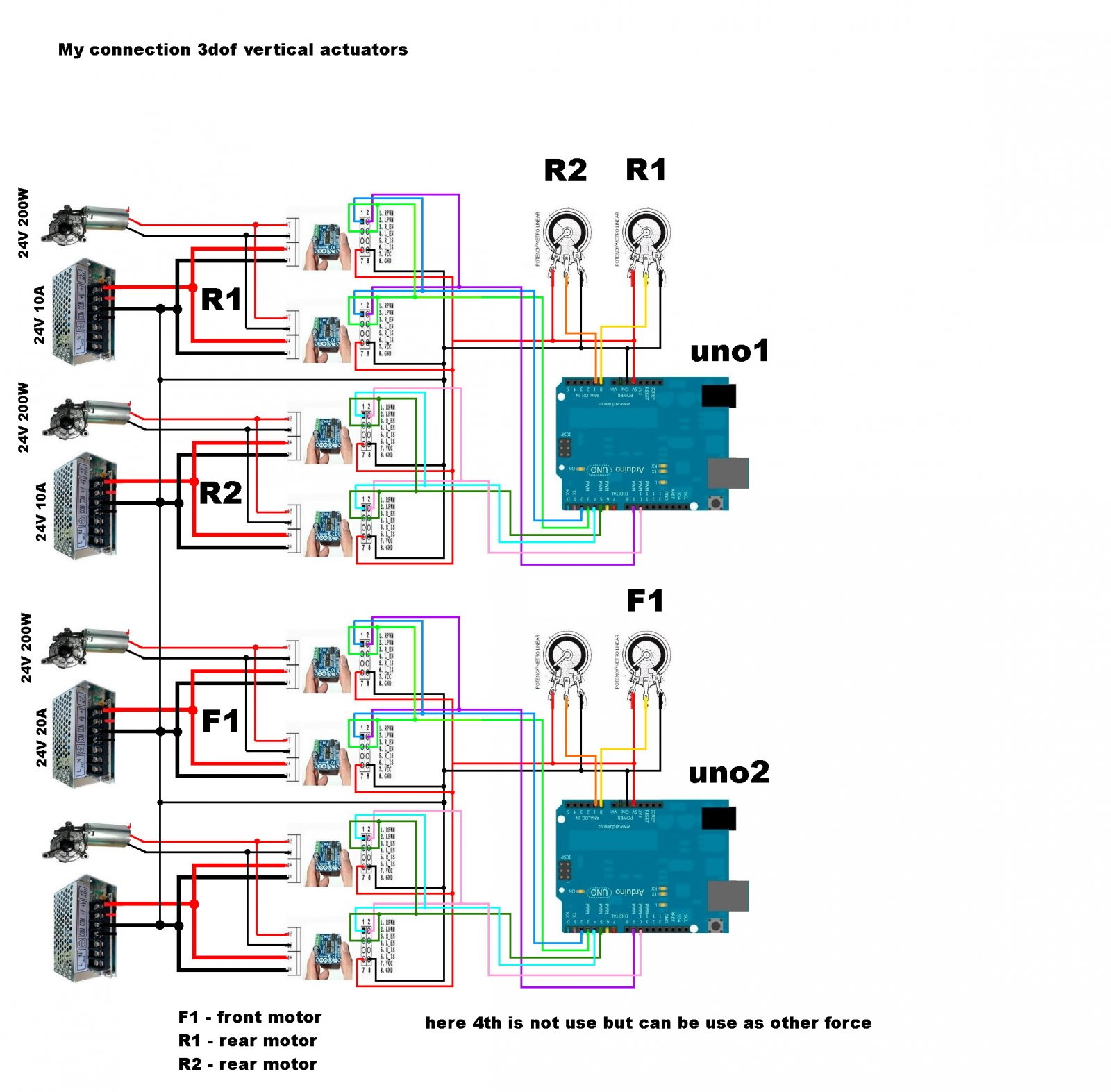

    Thanks seuszok. The power supplies are connected to ground but not the arduinos ... I don't use cards with ch340 but atmega328P

    I also have to connect the negative pole of the arduino to ground ... ??

    Yes but atmega have data transfer on other chip
    I was change arduinos from ch340 to 16u2
    Also I connect ground line from power suplies (3 x 24v )and arduinos grounds like on picture
    Its take me a litle bit time but should be clear

    Yes, I have the 3 arduinos with 16u2 chips ...
    Now I go to the laboratory and connect the negatives of the drivers with the arduinos ...
    Then I write the results in the meantime, thanks you are very kind.

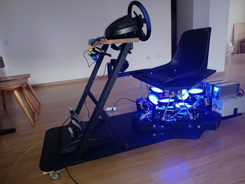

    Problem solved, as you made me do, putting the negatives of the bridges and the arduinos worked perfectly, now it does not disconnect anymore !!! Thanks for the time and patience you have dedicated to me (noorbeast and seuszok) to support me, you are great !!

    Here is a video with the rig finally working at 100%.
    Thanks again to the friends who supported and endured me ... :grin:cheers

    Fans mounted to cool the engines and create some atmosphere...:grin

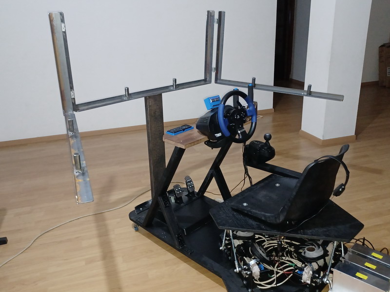

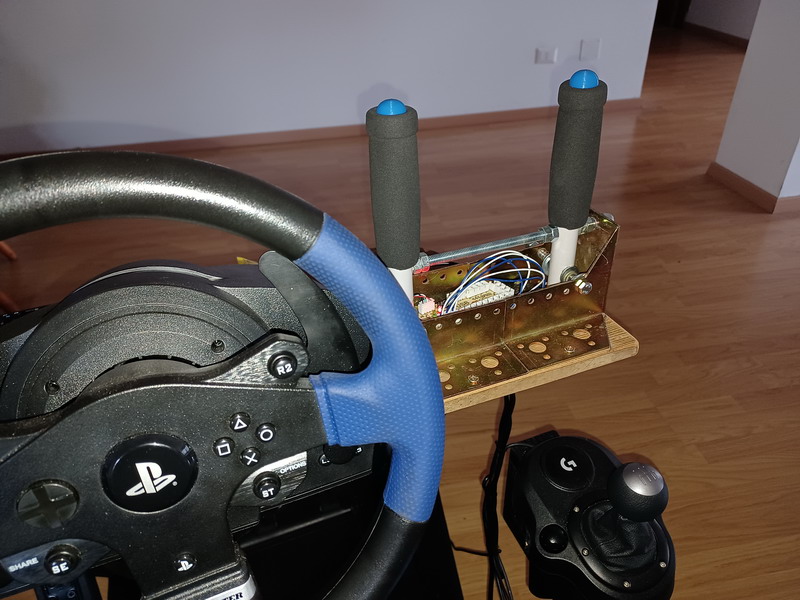

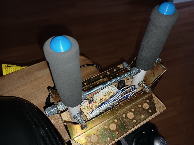

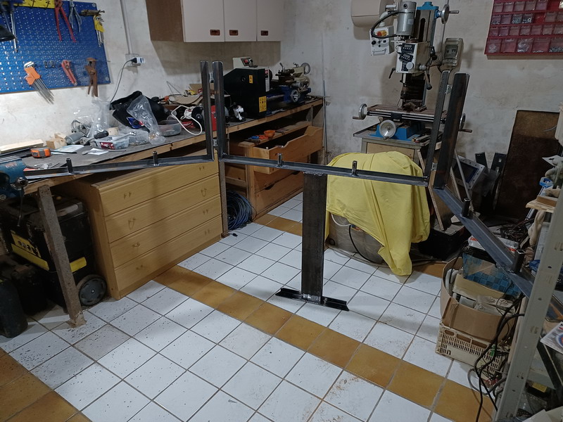

    Dirt Rally 2 is too good and so, always with the aim of keeping costs as low as possible, I inserted sequential shift and handbrake to the rig. Rustic but functional ....

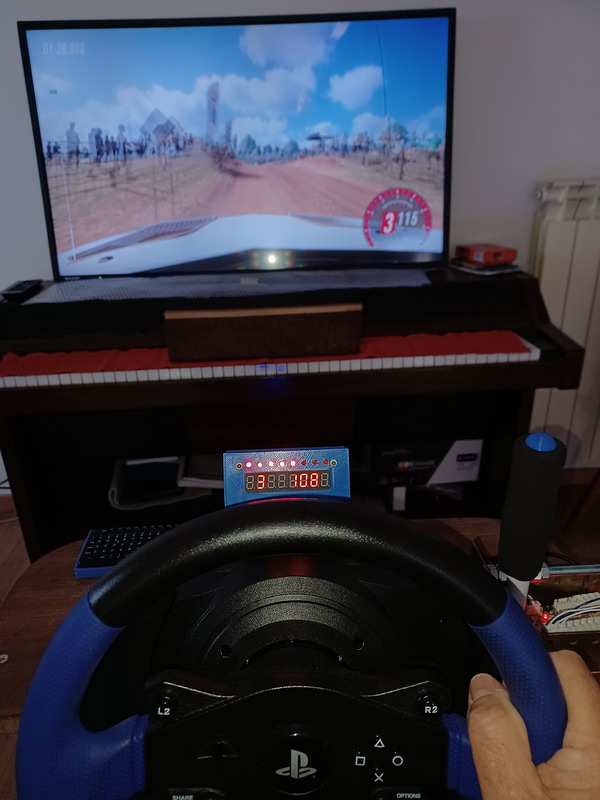

    And in order not to miss anything, I finished the tool with TM1638 and Game Dash

    +149 / 0 / -0
    Yesterday my cousin brought me the other two 43" monitors, which together with the first 47" I intend to mount with an iron structure on the rig
  14. SteULM
    SteULM Active Member
    Nov 13, 2021
    226
    Alla ricerca di cose nuove da imparare.
    600Coins
    +149 / 0 / -0

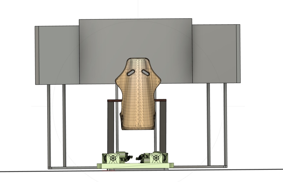

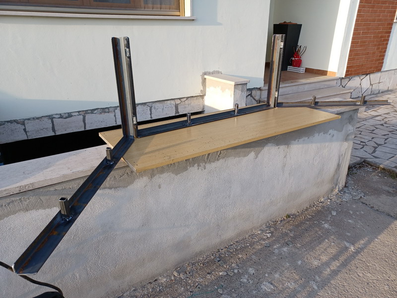

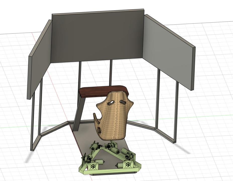

    I was thinking of a structure like this, considering that the 47 "monitor weighs 12kg and the two 43" 9kg. Will a 40x30mm 3mm thick L-shaped iron section be able to withstand these weights?

    I changed my mind compared to the structure I had designed, making it lighter to the eye ...

    Here is the complete structure to be painted, tomorrow I try to mount it with the monitors and if everything goes, I paint it.

    I didn't want to wait for tomorrow to see it assembled .... :grin
    I have to make a couple of changes but everything looks ok

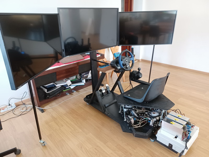

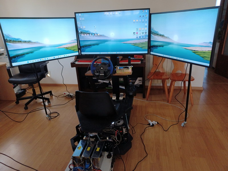

    Ok painting finished and structure assembled ....
    Huge

    Everything connected to the pc, now nvidia setup

    First test with triple monitors, a show ....
