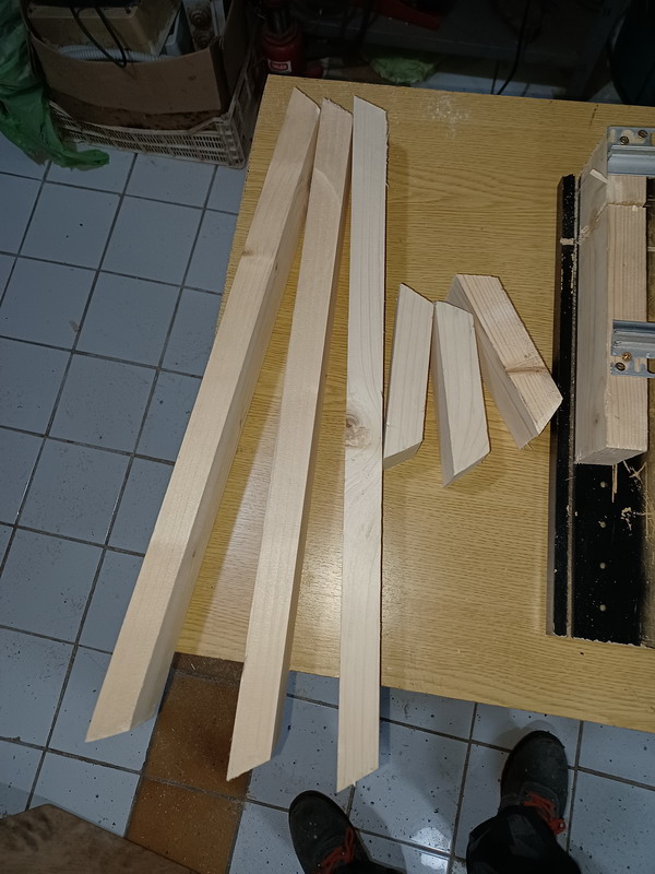

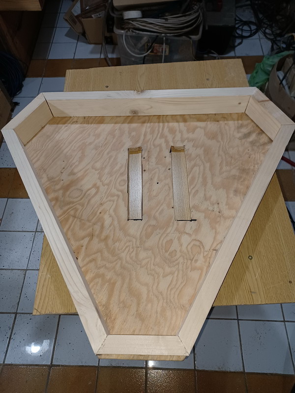

    And while very artisanal and a bit ugly, it served its purpose ....

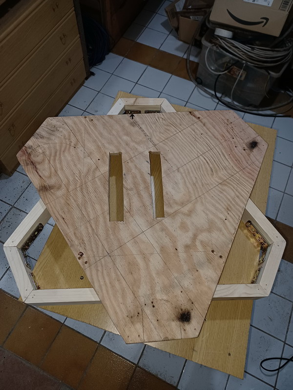

    After the various cuts of the boards I presented all the components to see the result (I should learn to make drawings first ... :grin)

    Now I am waiting for the paint to dry completely and then I start the assembly ....

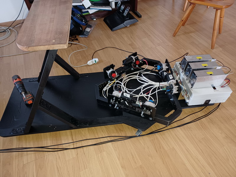

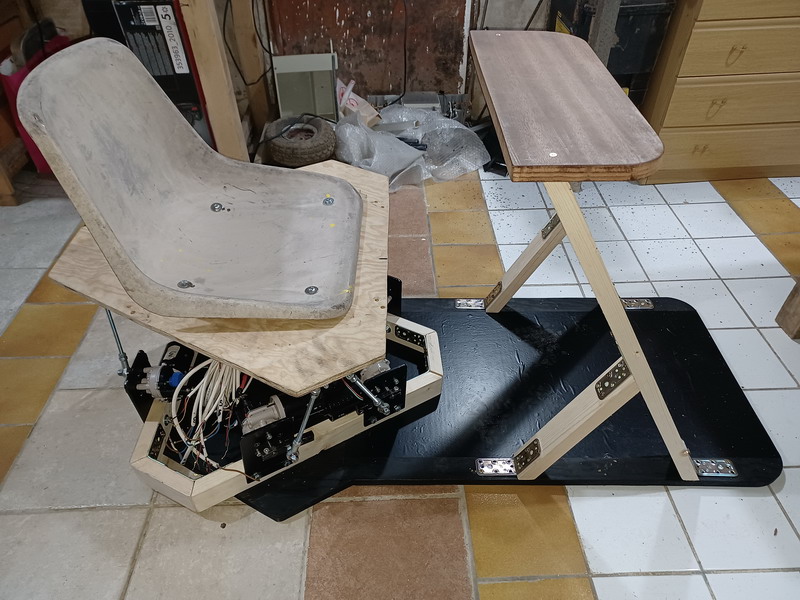

    Motor assembly and electronic test ...

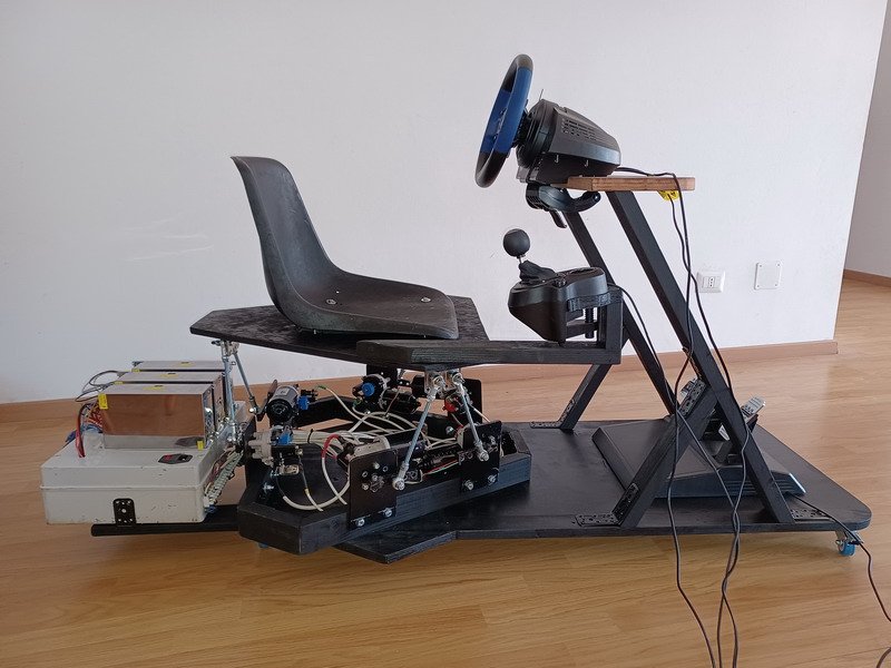

    Assembly completed, now I fix the cables a little bit and connect to Simtools so I have a run ...

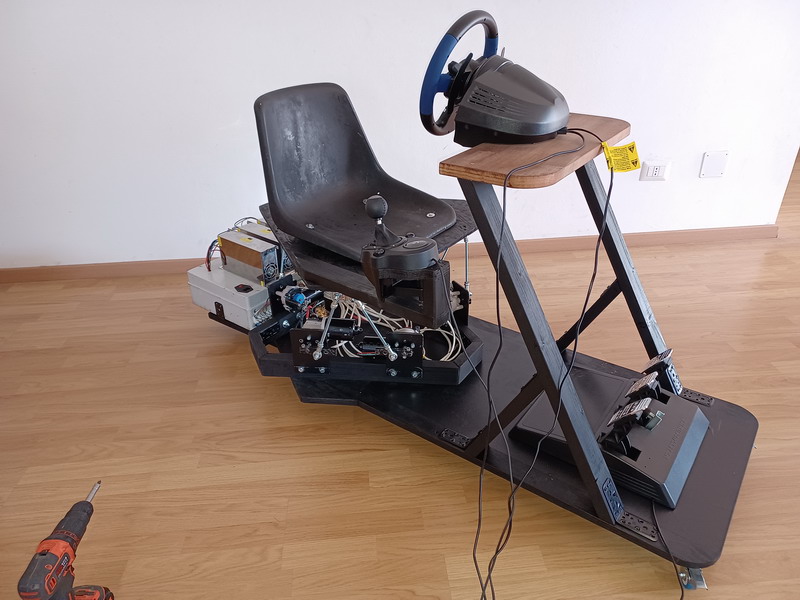

    Finally solved the engine overheating problem !!!! After about two hours of testing on the track, the engines are cold !!
    With this configuration you are finally having fun. hug::cheers

    Of course, I call my trusted tester and I do ....

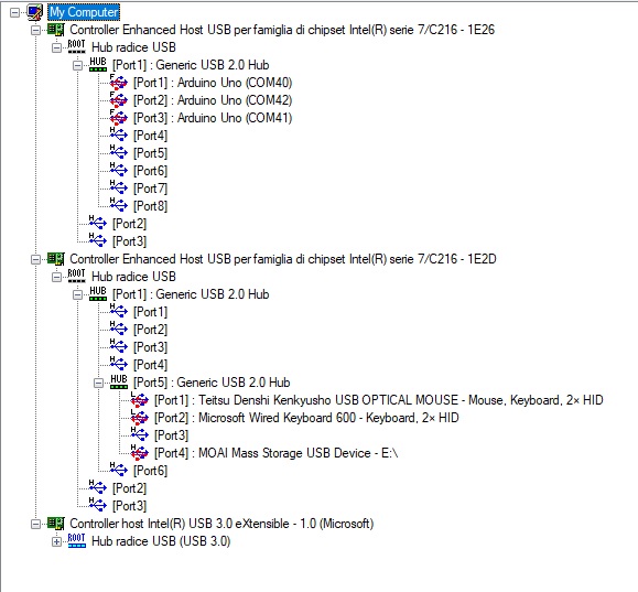

    However, I have a problem that I cannot understand, one of the 3 Arduino boards is constantly disconnected, always the same, it loses the USB data for an instant but it is enough to stop the two connected axes. Has this happened to someone before ... ??

    Thanks noorbeast, the arduinos 3 are on a controller that only houses them so I think it's optimal.

    Here is a picture of the USB controllers
  16. noorbeast
    21,641
    151,504Coins
    +11,041 / 56 / -2
    That looks pretty good and USB2 is actually more robust than USB3. Are you using quality USB cables and Ferrite Magnets to limit interference?
    While lowering the Intensity Level a bit, like 3-5 degrees, should make a difference, down to 80% is a lot and adds a lot of global smoothing, so I would suggest further investigation and experimentation.

    The cables I think are good, they are Amazon Basics protected against interference, the ferrite cores I have ordered and tomorrow they will arrive and now I have disabled the "Selective Suspend" of Windows and I try if it has improved the thing.

    I confirm that the problem is exclusively of USB (thanks again noorbeast that you directed me) in fact by connecting the card that always disconnected in a HUB controller different from the other two the problem no longer occurs, however different USB disconnections continue to be discovered. Let's see tomorrow when the ferrite clips arrive how it goes.

    Did You conect all power suplys and arduinos grouds?
    I supose You use 16u2 arduino drivers board if they are ch340 pls change it.
