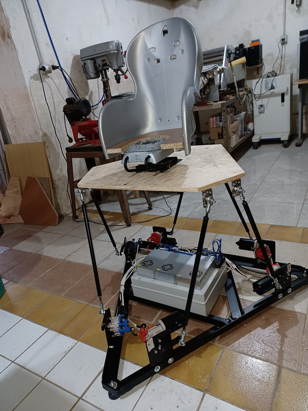

    If you look at the prototype of the previous photos I had the rods of 300mm but the base was small, now each side measures 1000mm and making the rods too short with the movements I risk banging ...
  2. SteULM
    SteULM Active Member
    Nov 13, 2021
    226
    Alla ricerca di cose nuove da imparare.
    600Coins
    +149 / 0 / -0
    Finished assembling everything with the 400mm cut and welded tie rods
  3. SteULM
    Nov 13, 2021
    226
    600Coins
    +149 / 0 / -0
    Now I try it like this, in case I can shorten the tie rods again.
  4. SteULM
    Nov 13, 2021
    226
    600Coins
    +149 / 0 / -0
    I did some tests with SMC3 and with 12V power supply the motors where the heaviest weight falls, the middle, so trying one at a time, they find it too difficult to move my weight (85 kg) while connecting the 24V power supply they have no problem to raise me so I would say that we are on the right track. Now I order three 24V 30A power supplies and I should be able to complete this ambitious project.

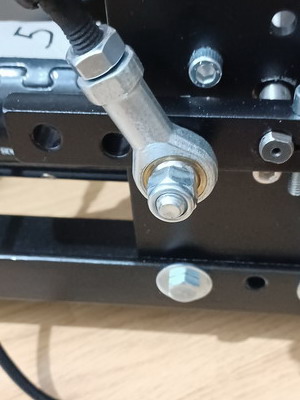

    Which holes were you using on the levers? I'm sure the inside holes would be alot easier on those motors

    Surely with the central holes the situation improves but at 24V it is another thing, more reactive and faster motors that manage to lift me quietly!

    Thanks to your advice Keith I moved the tie rods to the shorter hole and the situation has improved a lot, now even at 12V the motors are able to shift my weight.

    On the strength of this, I added a hole on the keys of the motors at 30mm and with 12V it manages to move me wonderfully
