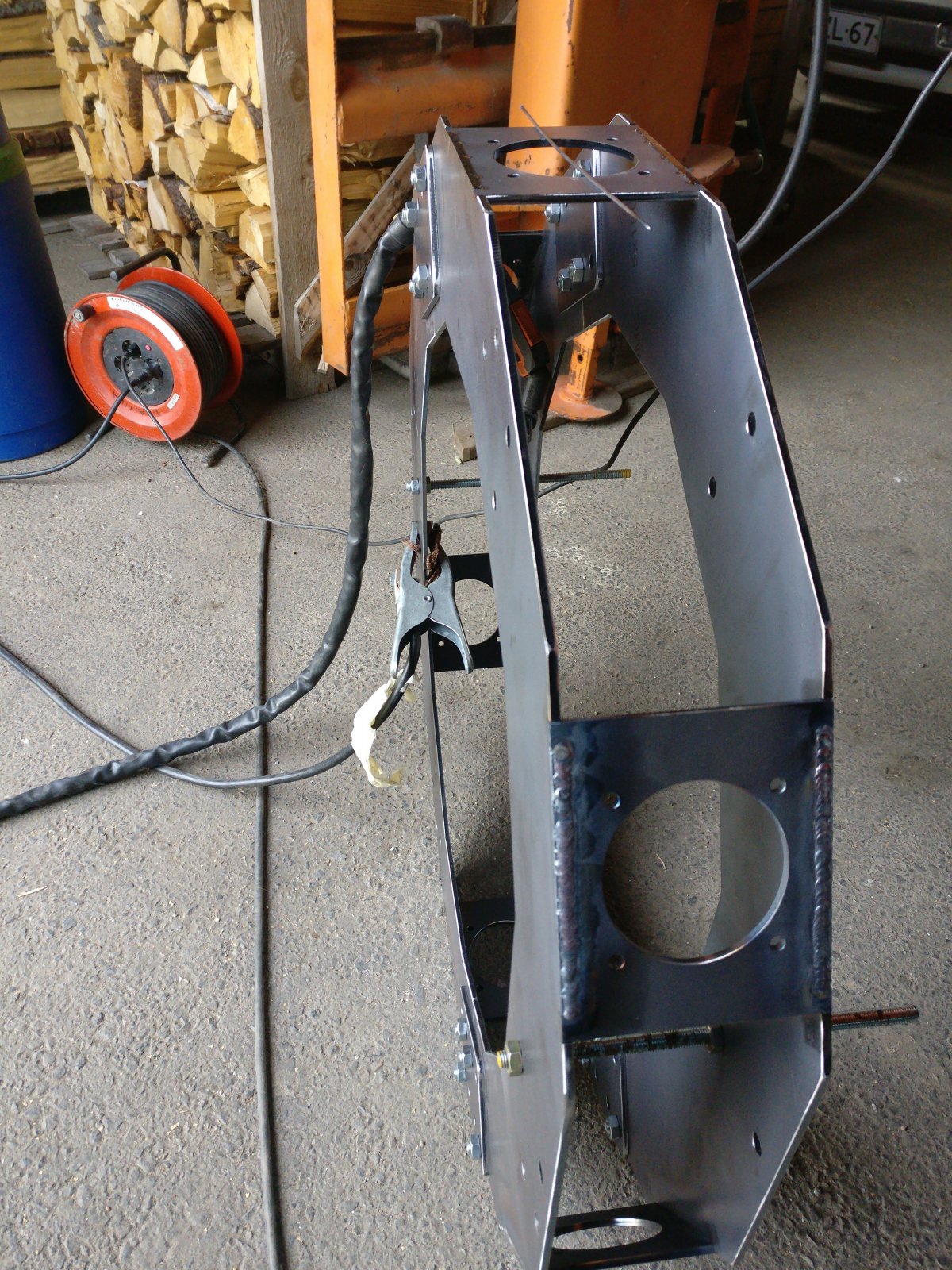

    I have been watching this forum for years, and waiting to find suitable cheap motor and frequency converters for my sim.
    First design was greatly influenced by this thread:
    https://motionsim.freeforums.net/thread/176/dof-step-diy-project-blueprints
    This was supposed to be really low budget project. It started at late 2017 when I found used AC motors and 750W frequency converters for really low price. I also ordered AMC1280USB from Thanos kickstarter campaign.
    Soon I realized my cheap motors had wrong gear ratio. So I had to make design with new type motors.

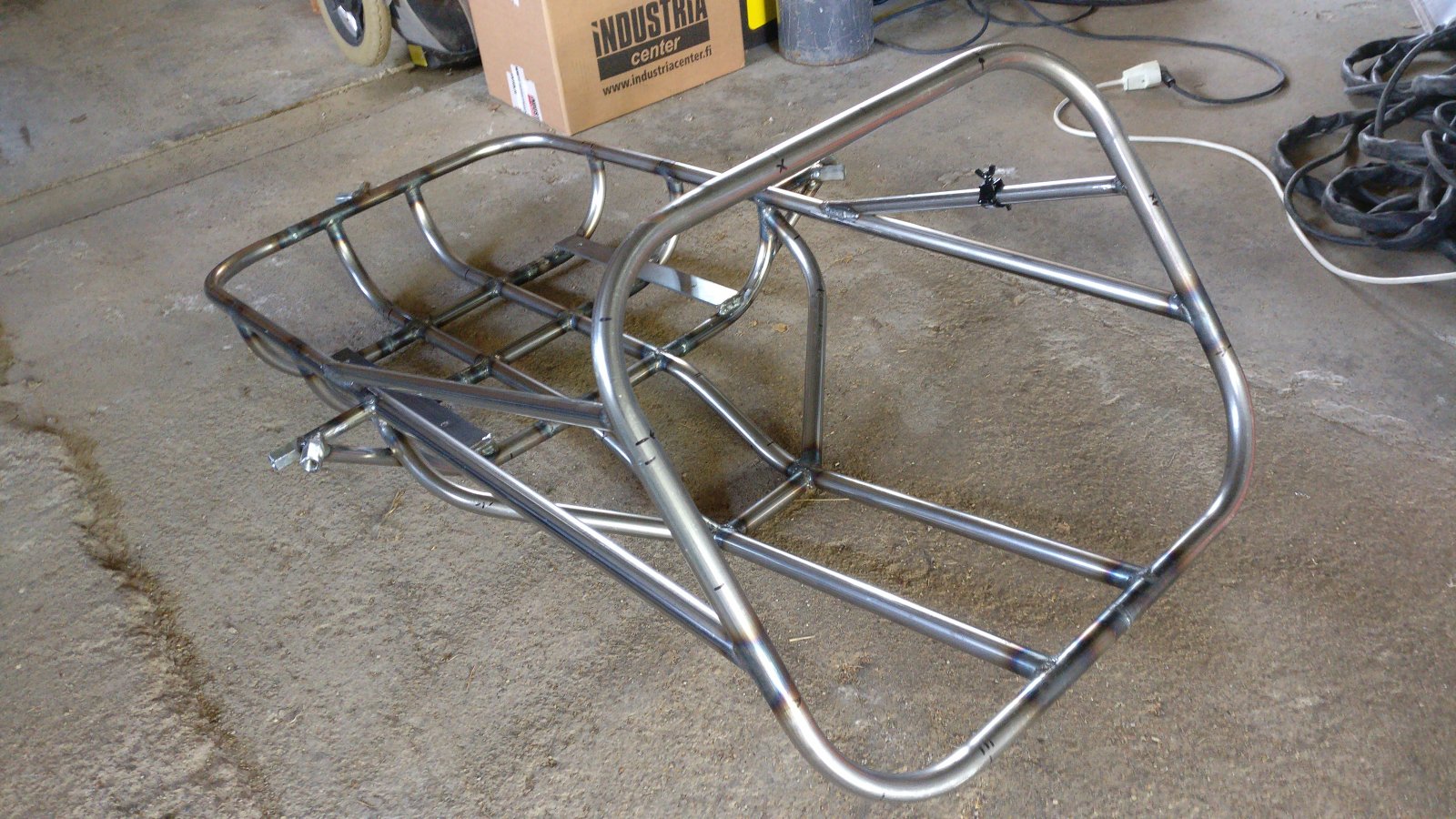

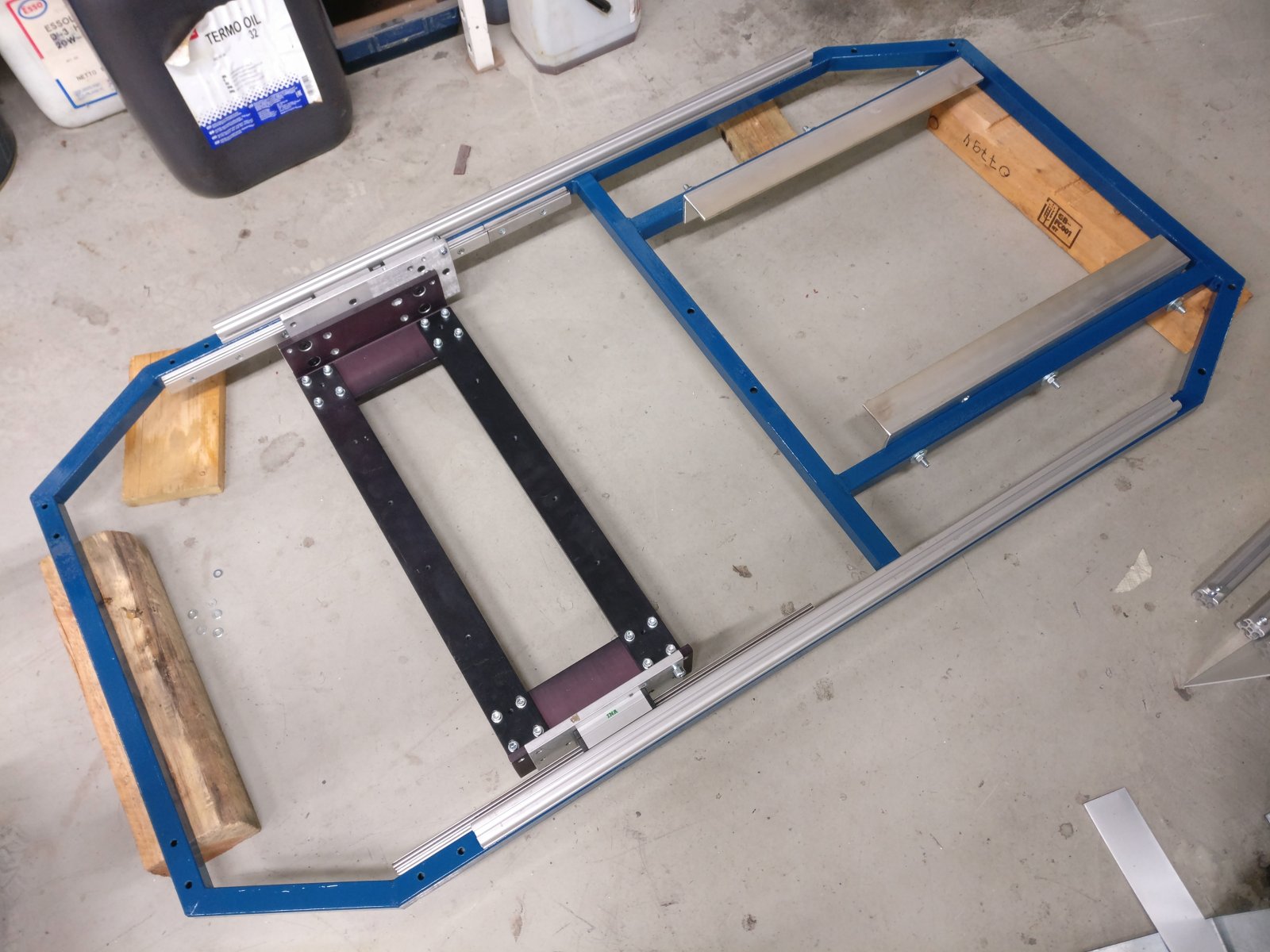

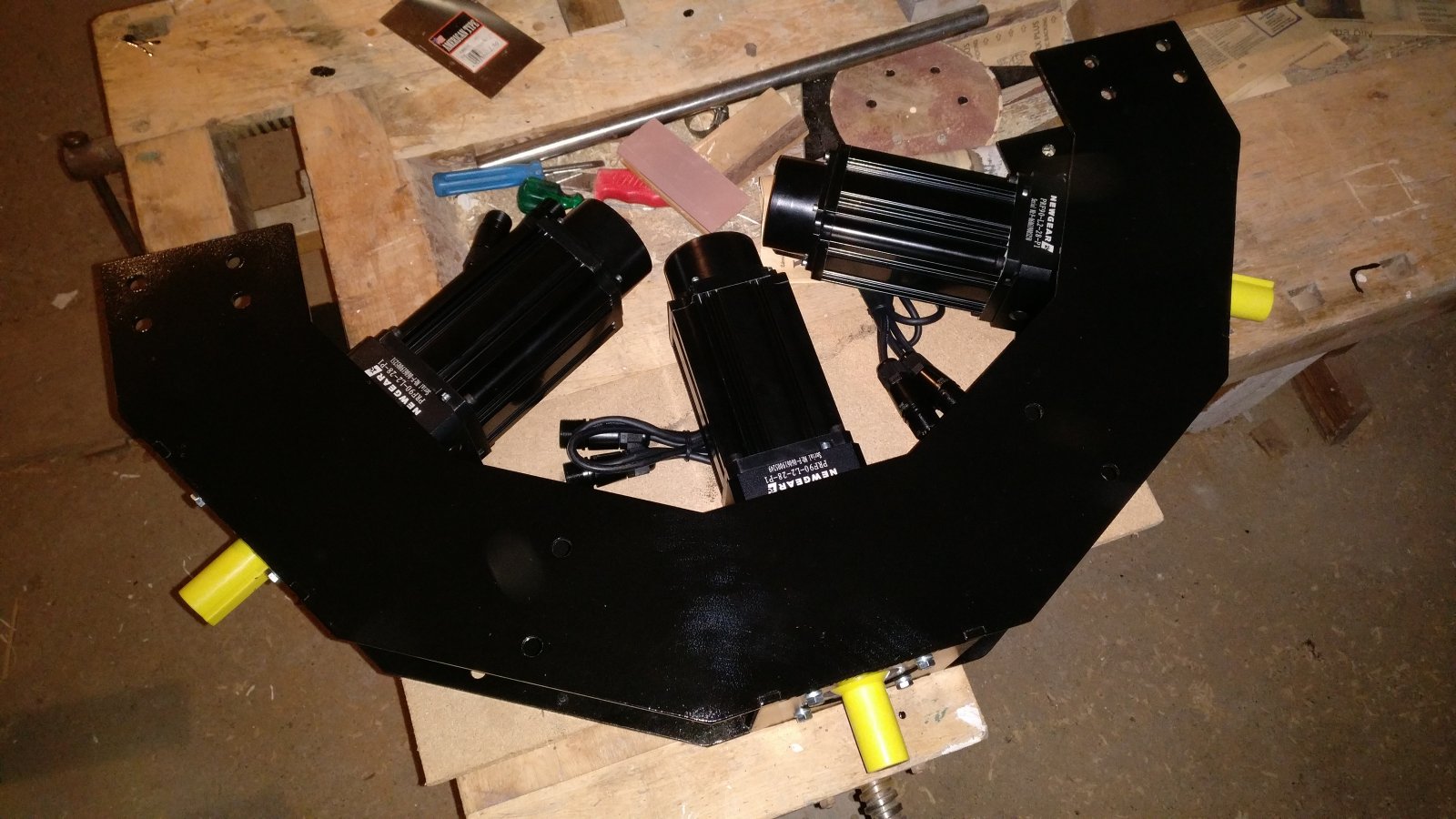

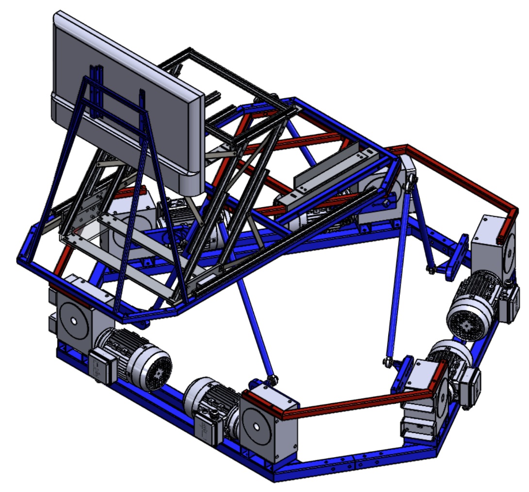

    Here’s my design and some pictures from first version.

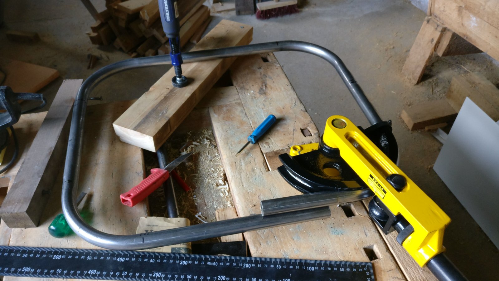

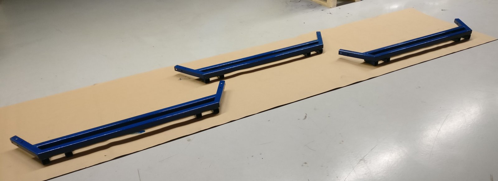

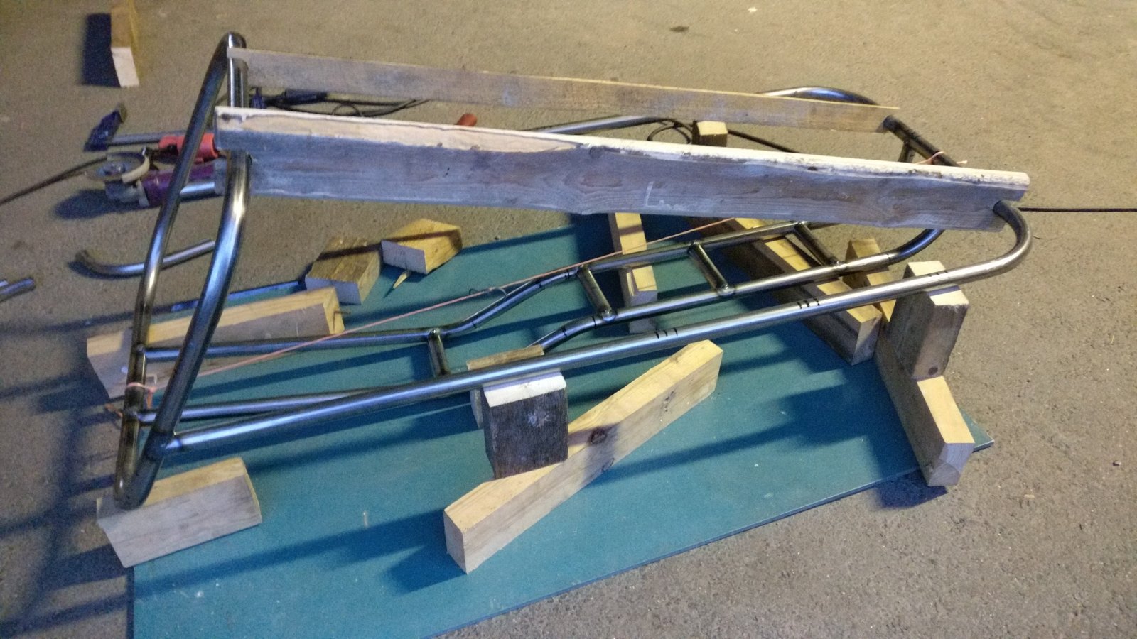

    Lower frame
    Frame parts
    Upper frame

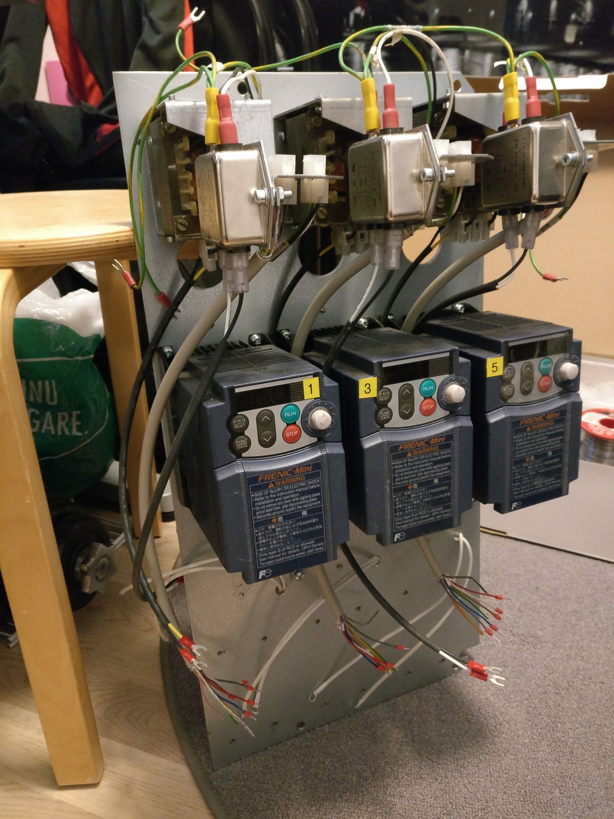

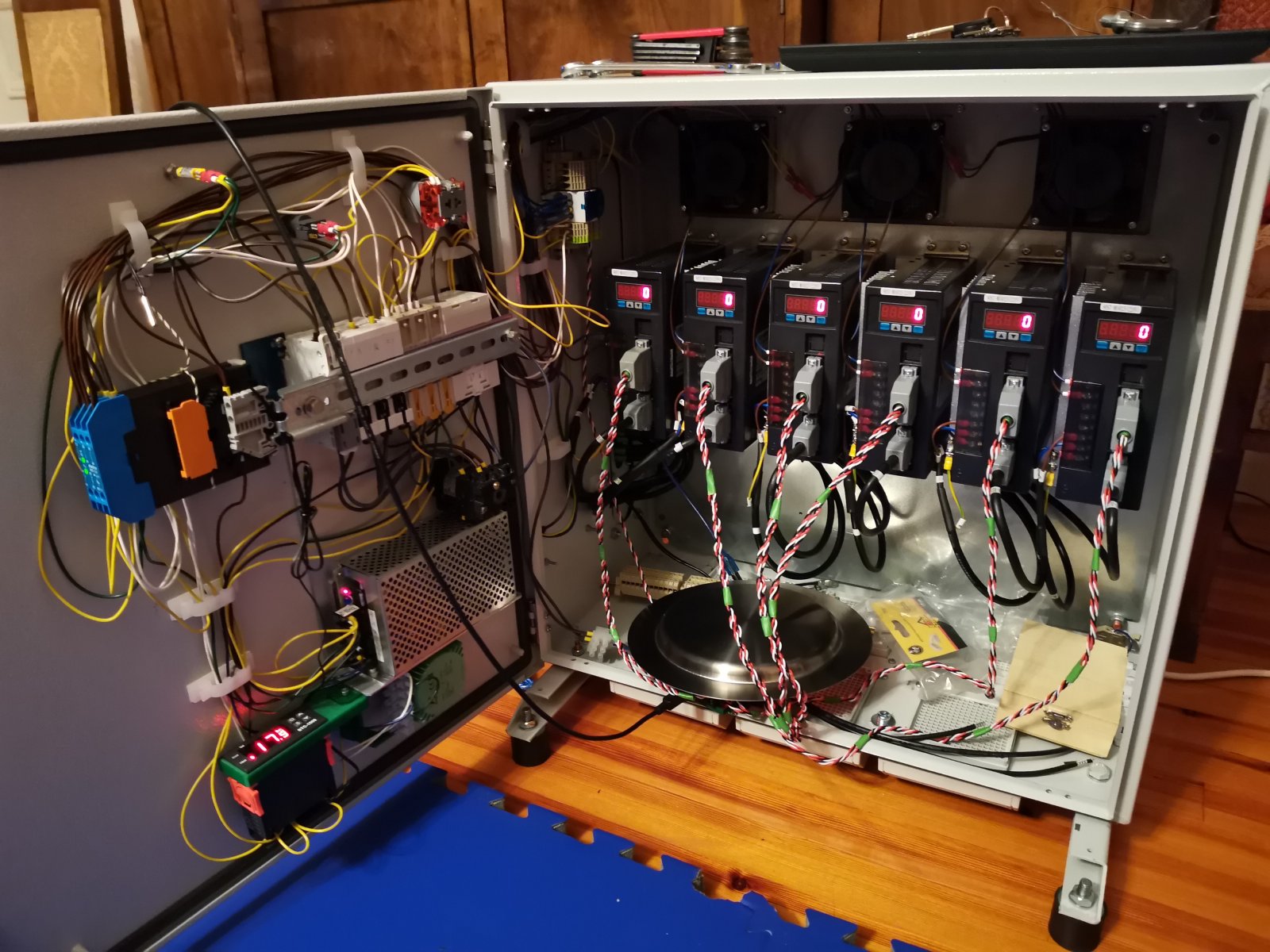

    3x frequency converter.
    So all the parts were finished and ready for assembly, just waiting me to order new worm gear motors…
    At this time I was very busy and still tried to find new used AC motors.
    I stopped my project after I started studying more about servo motors, I became more unsure about AC motors ability to provide enough speed for my sim.
    Everything changed for good when I found @Grigory build that he documented on https://www.xsimulator.net/communit...ct-and-no-linear-actuators-220v-servos.11839/
    So I had to redesign my sim totally.

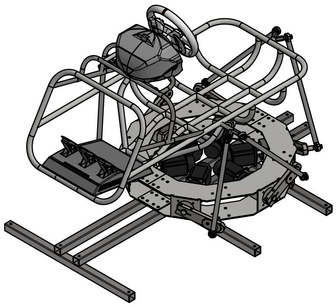

    Here’s my design for second version.

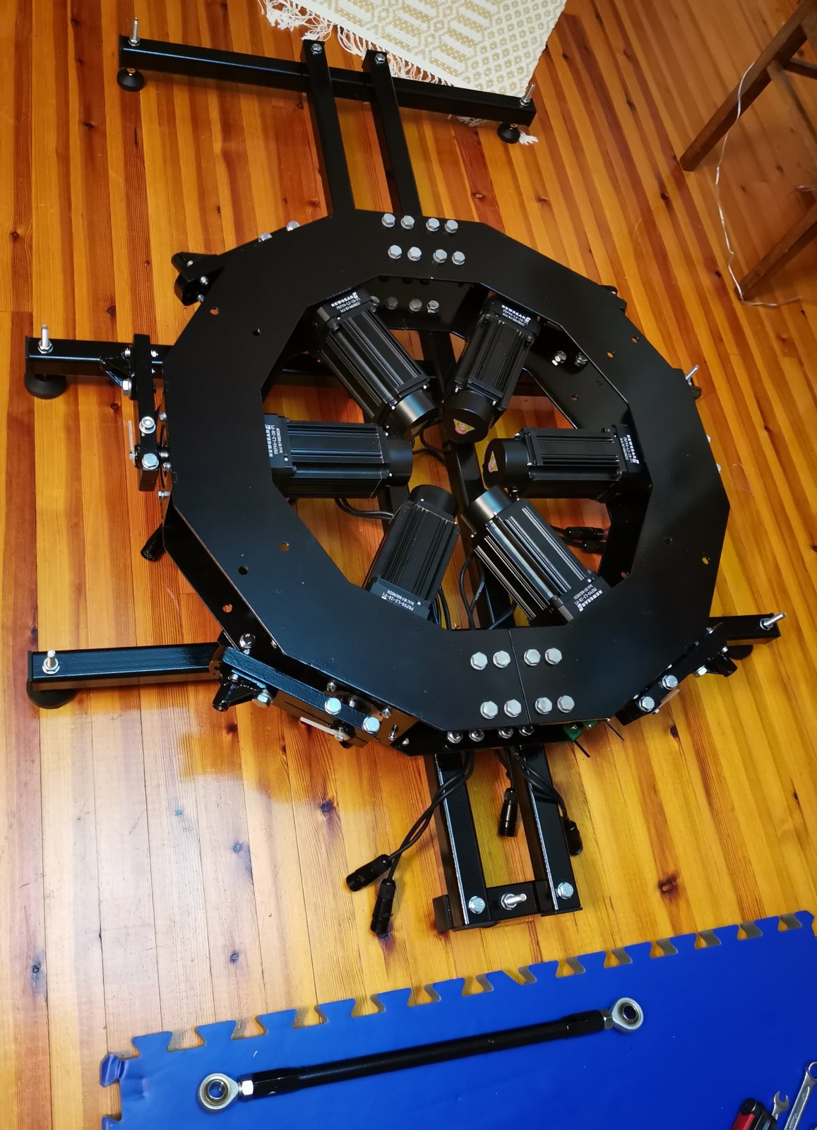

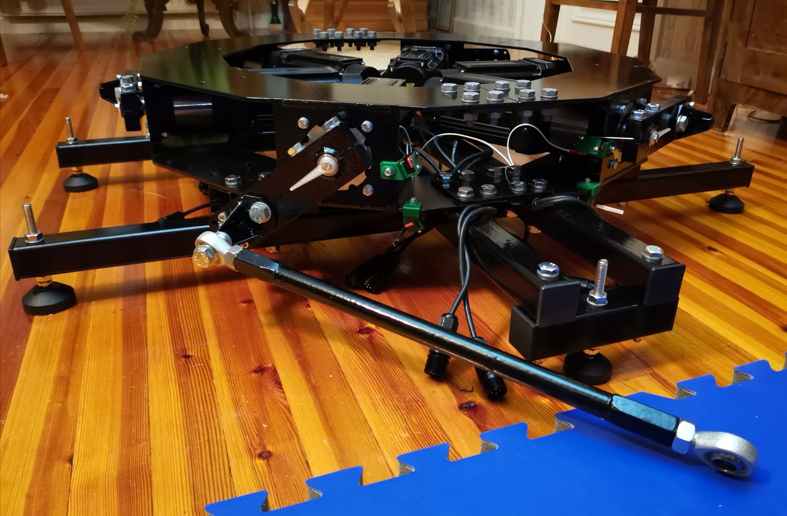

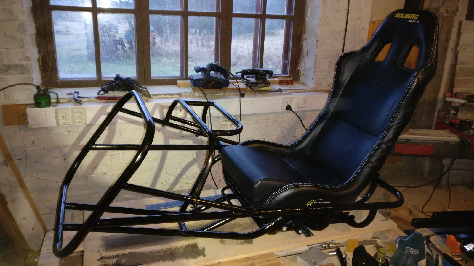

    New frame. Idea was to make footprint as compact as possible.
    Testing servos.

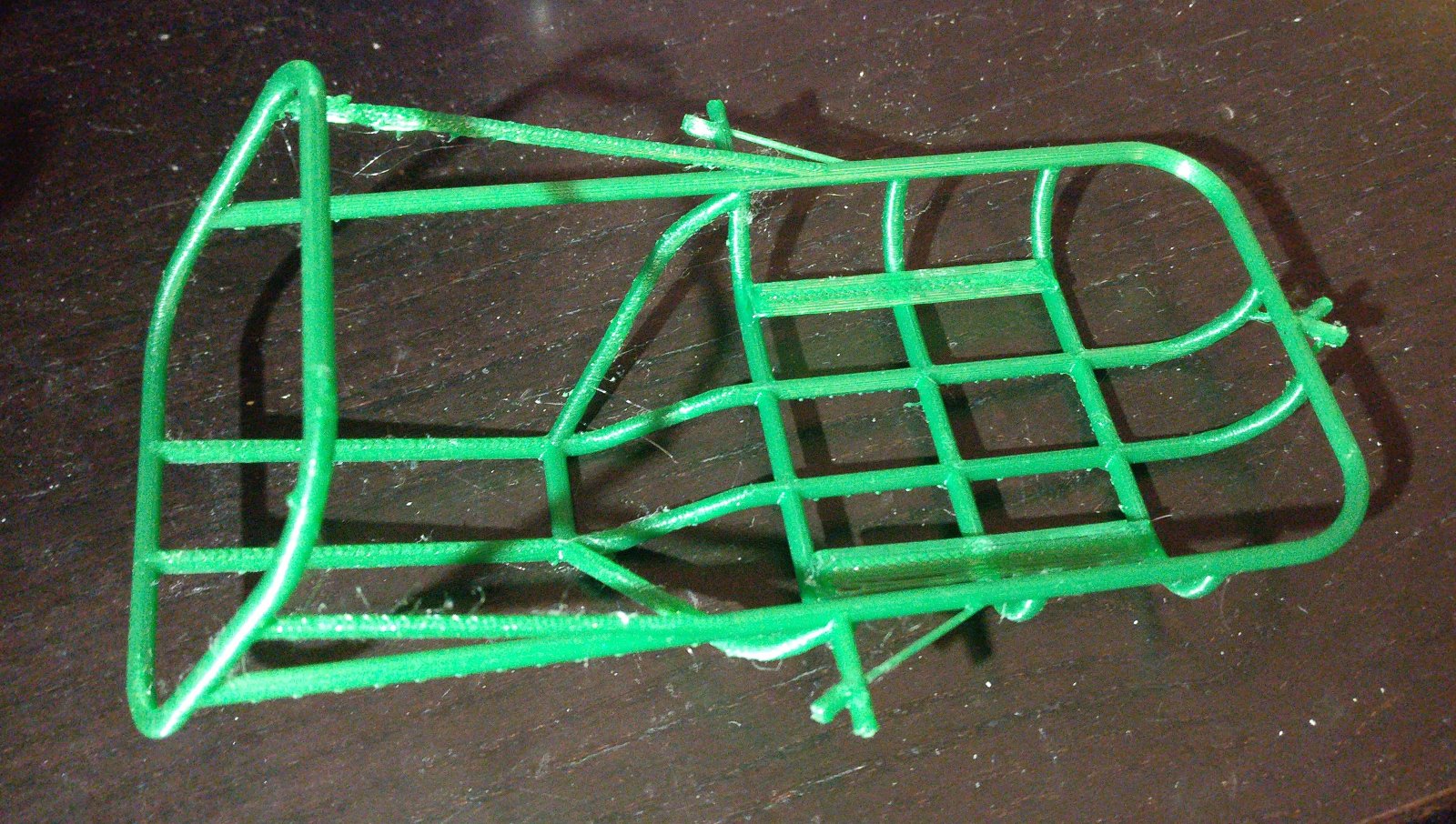

    3d printed 1:10 scale frame model
    Asymmetric cockpit makes it easyer to go in and out.
    3d printed supports for safety switches.
    Monitors are temporary, plan is to get VR.

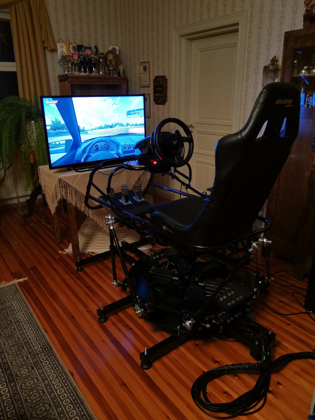

    First test run.
    Still lot to do. Now struggling with emc problem. I guess arduino is located too close to drivers. Next planning to make metal shield for arduino.

    Kaitila, fantastic build. I am also building a version of Grigory's base platform. I like your solution to the the feet supporting your base. Would you be willing to share the schematics for your base? Thanks.

    I have changed my job, and now I don't have any design program available.
    That's why I have very limited amount of drawings.
    Here's files that I found. Apparently couple holes for fixing feets are missing at plate01.
    I can try to find updated drawing.
