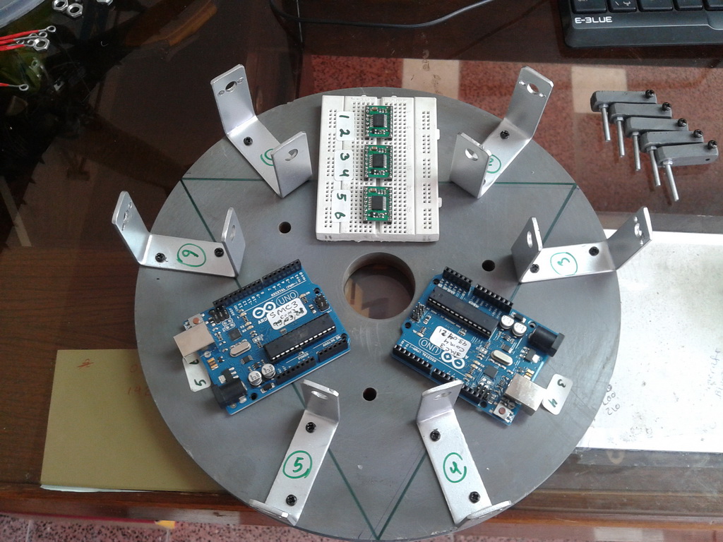

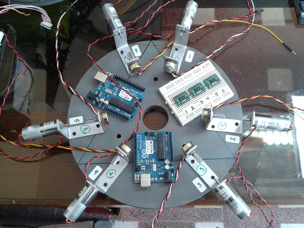

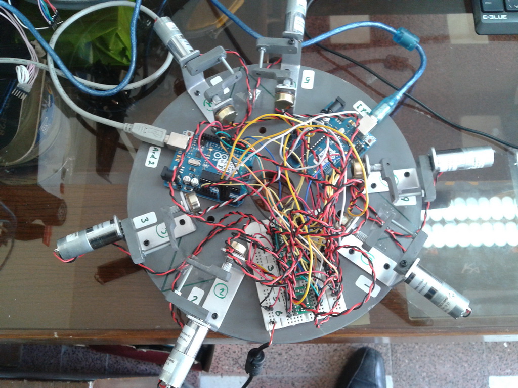

    here is my 6 dof project ,I have finished finally this week.first im going to
    thanks @Historiker ,@eaorobbie ,@RufusDufus ,@RaceRay and many others
    in the community.
    the electronics ive used are 2 Arduino uno with SMC3 and 3 TB6612FNG dual
    driver from Pololu and six chip single turn pots and 6 motors are small dc 12 v and 10 RPM
    and dimentions: 300 mm * 300 mm * 190 mm

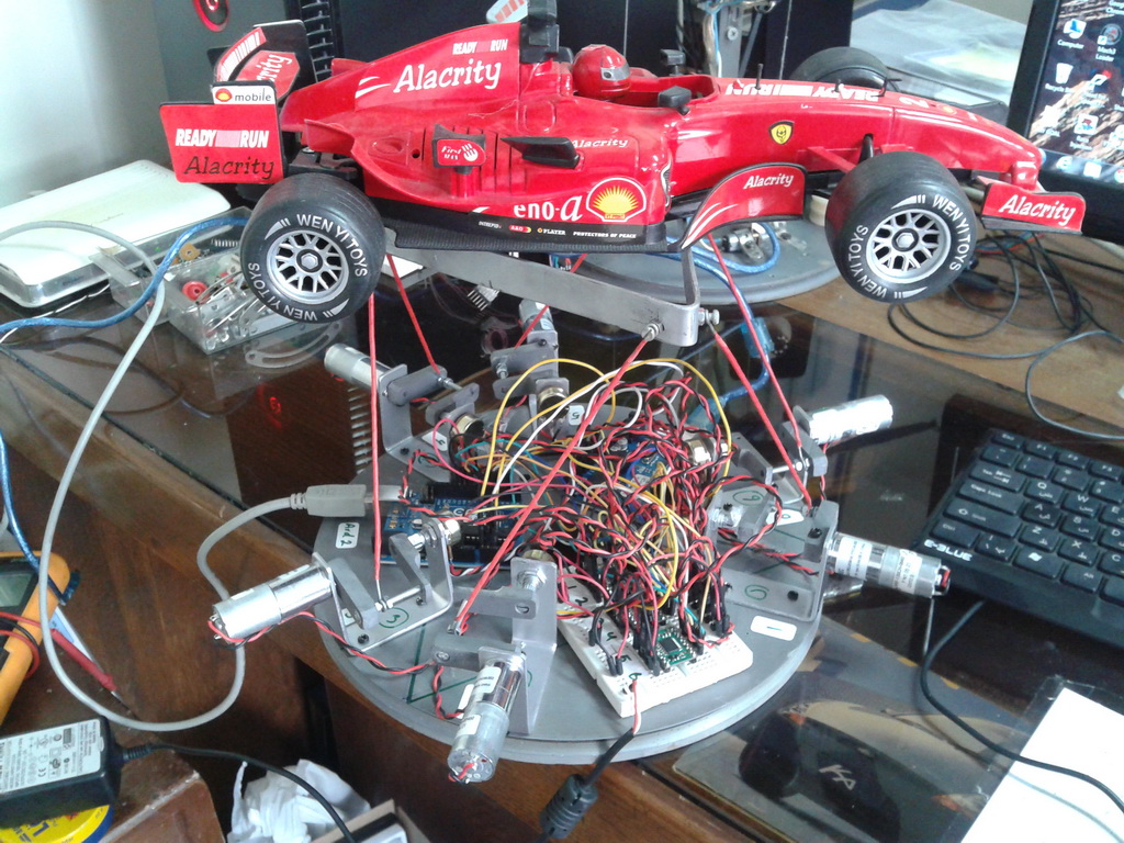

    motors lever arms are 25 mm and the rods are 150 mm
    so base on the platform design It moves,
    Roll = ±20
    Pitch= ±20
    Yaw= ±35
    Heave= 45 mm
    Sway= 60 mm
    Surge= 60 mm
    and a short video here:
    very welcome to any questions and ideas
    regards
    Hooshang

  4. tronicgr
    tronicgr
    Where is the COG (Center Of Gravity) point located? Can you adjust it to certain X,Y,Z position?
    From the video it looks like its located right on the surface of the top platform. Shouldn't it be higher? Near the "driver's" chest perhaps?
    Great work btw...

    yes, the COG should be higher of course but could you give advice
    how to adjust it
    thank you friend
    Hooshang
  8. tronicgr
    tronicgr
    I'm not sure how you can adjust it with your setup. Does it even support this?
    Anyway, you can see here what happens to the motion for Pitch/Roll when you adjust the COG:
    PS... why the "dislike? here??? LOL
