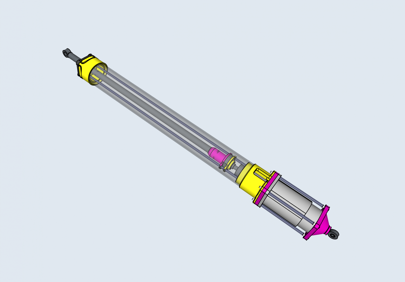

    I have been a bit of a lurker for a while now carefully watching everyones builds and following @Peacemaker105 build decided I would try and tackle a 6DoF build myself using AASD 80ST servo motors. Progress so far has been slow and I currently have a single actuator built using a 600mm 1605 ball screw and custom 3d printed parts. I also have @Thanos servo controller and am slowly stockpiling more parts as and when funds allow....
    So after many iterations this was the design...
    And once mostly assembled...
    I am hoping someone may be able to assist with the design of the hexapod as its not something that I'm too sure on. I did have a look at the SimCalc software but it doesn't seem to support 6DOF so I'm not sure how everyone calculates this part of the build or whether its more trial and error? Anyway any help would be much appreciated!

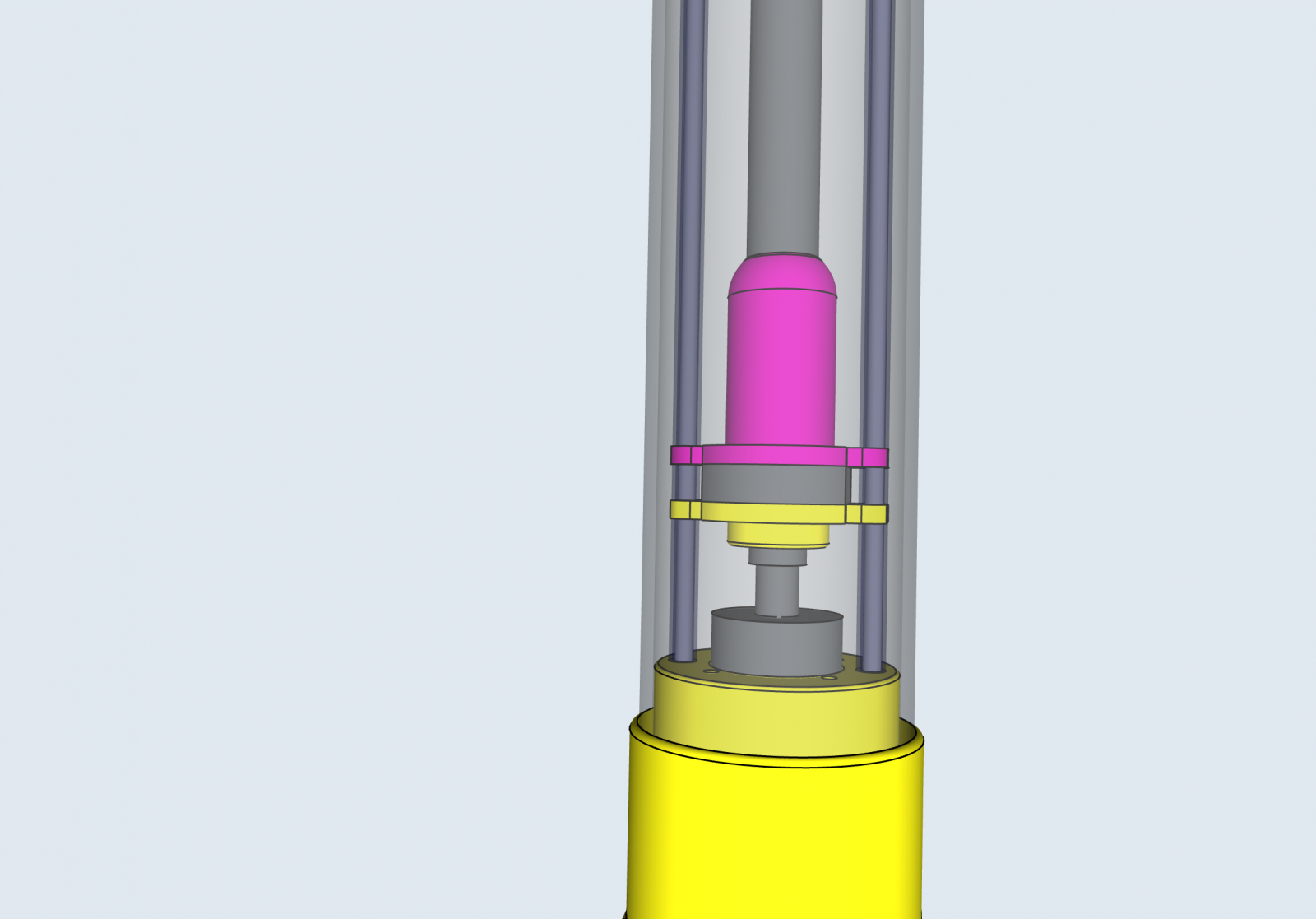

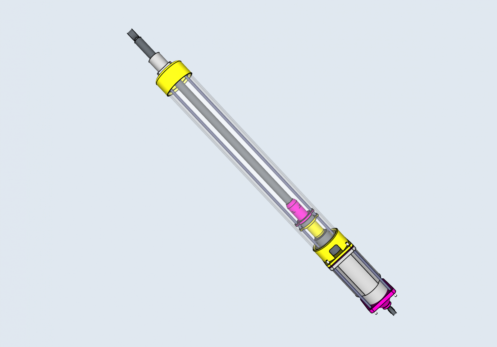

    My initial post was a bit lacking in detail so I thought I'd provide a bit more of a walkthrough of my actuator design from top to bottom... If anyone has any questions ask away and I am happy to provide all of the stl files although I suspect this won't be the final design.

    My design differs to Peacemakers in a few ways but the main differences are highlighted below:

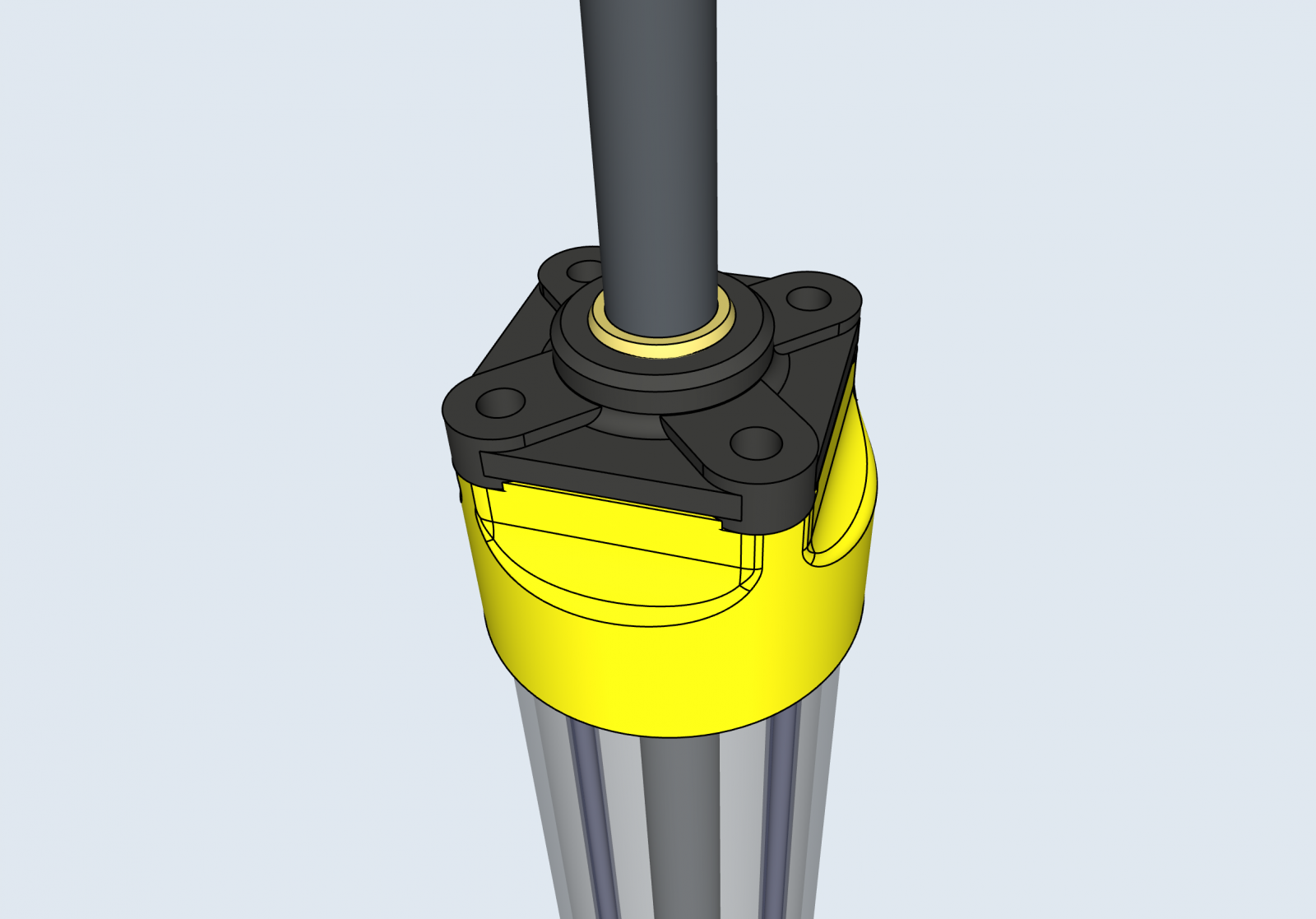

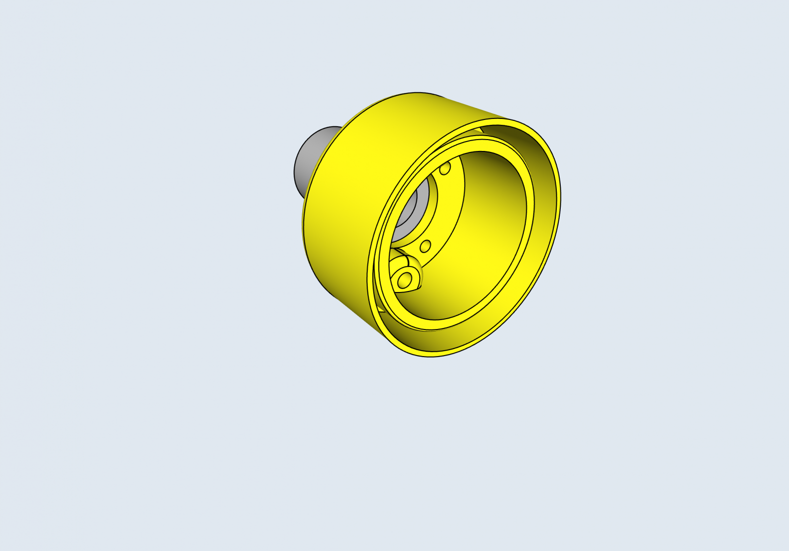

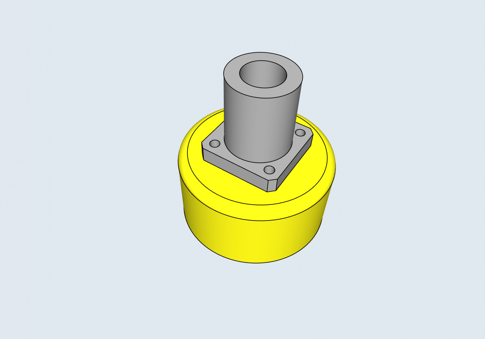

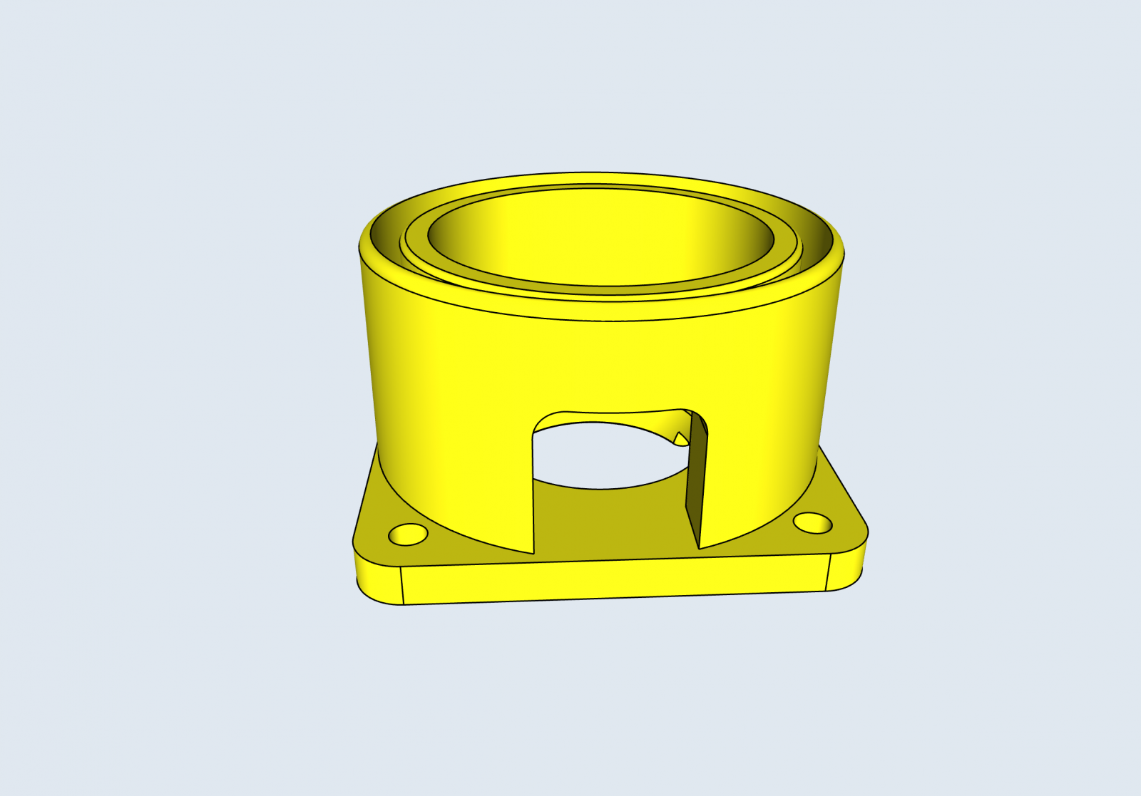

    Top Hat - (with linear bearing)
    From the underside the 2 raised areas are sockets for the embedded nuts which the m5 threaded bar/ guide rail locate into. The PVC pipe is installed between the 2 walls and is tensioned when the guide rails are tightened.

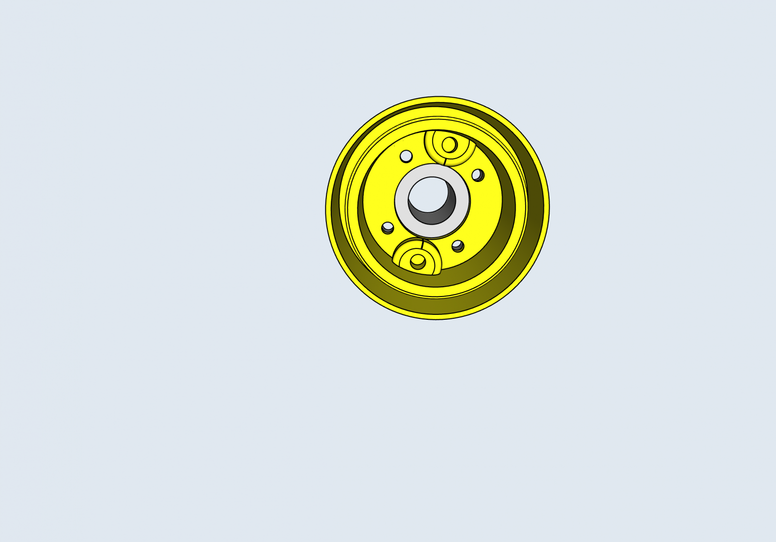

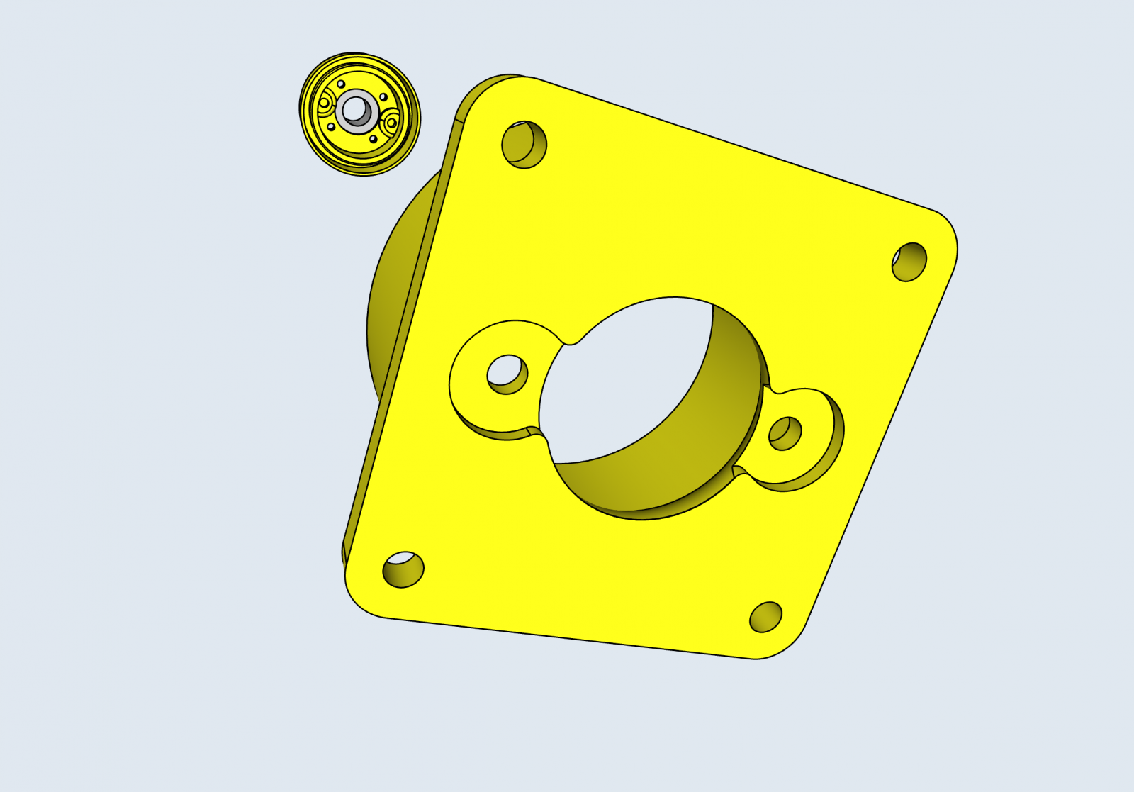

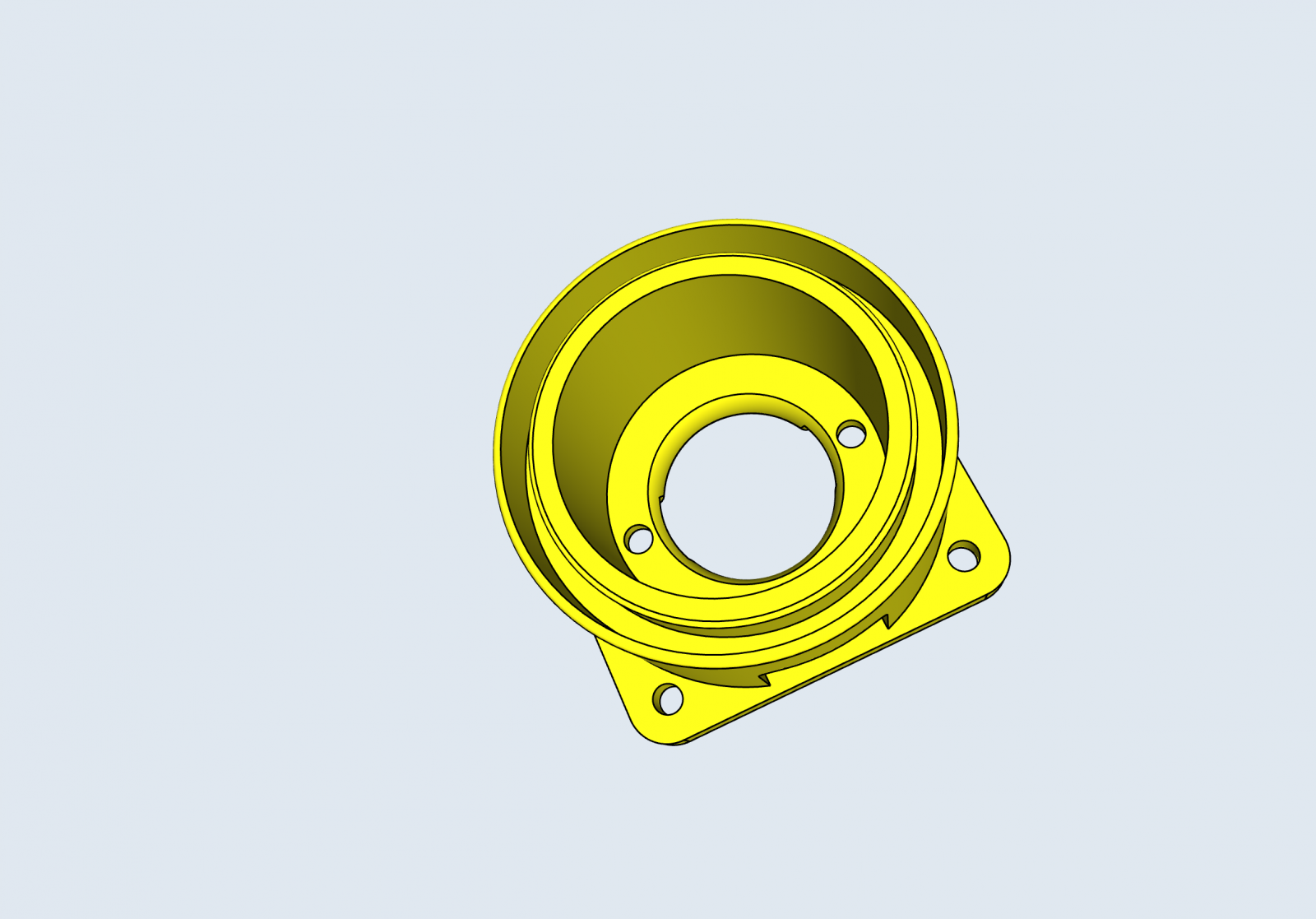

    Reception Plate -
    On the reception plate end the threaded bar passes through the two indented holes (underside) which allow for them to be tightened using nuts and tensions the guide rails and main tube.

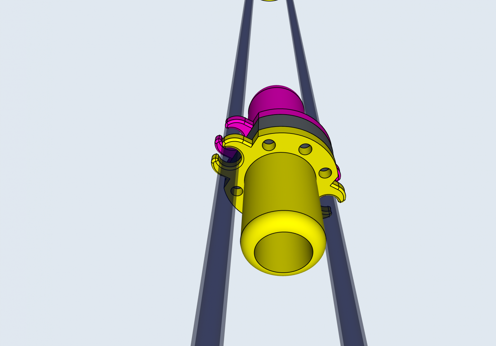

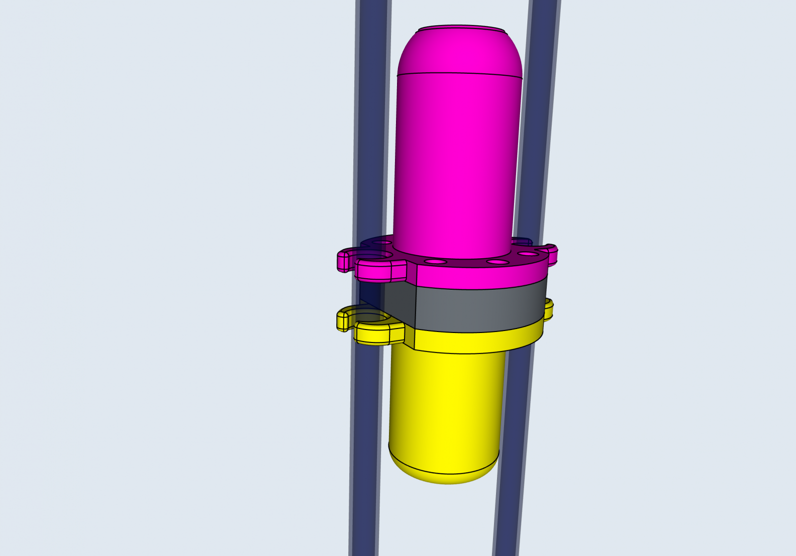

    SFU Nut to Carbon Shaft Adapter (Pink) and bumpstop (Yellow) -
    These elements have been redesigned again and again but in short the bump stop means the SFU nut doesn't jump off the ball screw (learnt this the hard way!) they also allow the main carbon shaft to be fixed (epoxy glue) to the 3d printed part without having to glue to the SFU nut itself.
    Hopefully that all makes sense but if anyone wants any more detail on the elements or the actual 3d parts just let me know!

  5. SeatTime
    2,573
    I would not be using a steel ball linear bearing with a carbon shaft as the steel balls will wear into the soft shaft. They also make allot more noise.
  6. SeatTime
    2,573
    Have you purchased all the parts for the other actuators, as a 1610 screw would have been a better choice.

  8. SeatTime
    2,573
    A few (including myself) have moved to the faster 10mm pitch, as it stops long actuators motors from running out of speed, also. they are quieter as they are running slower. Igus poly bushings is what you want for this design, not steel ball linear bearings - see Peacemakers or silentchills build thread. I use linear bearings, but my actuator design is much different.

  11. lromaniuk
    lromaniuk bny
    Mar 23, 2018
    27
    Software Programmer
    Poland
    366Coins
    +20 / 0 / -0
    Hey
    I can't see any bearing block for the ballscrew (FK12 or simillar) to hold on. If it's true all the forces coming from the screw will land on motor bearings and they are not designed to take such axial load. Also that coupler probably will get damaged when transfering such load - it's main pupose is to deminish differences in axes of rotation of motor shaft and ballscrew. Really I think you should consider adding a bearing block there.
    Good luck with your project!
  12. CStretton
    CStretton New Member
    Jan 10, 2021
    9
    112Coins
    +16 / 0 / -0
    Well spotted I have just revisited Peacemakers build and hadn't noticed the bearing installed when I was designing the reception plate! Back to the drawing board and thanks for your help!

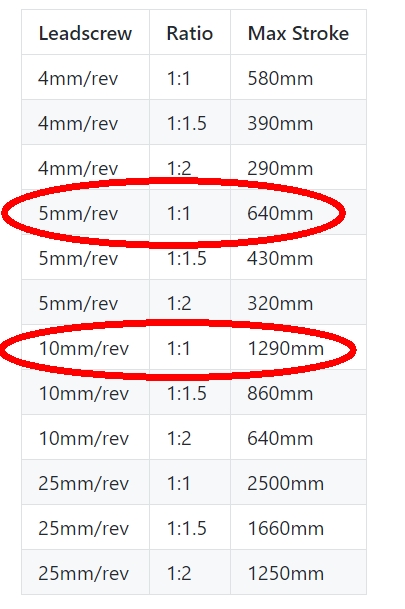

  13. Thanos
    Jul 6, 2017
    1,371
    Electronics Engineer
    United States
    2,854Coins
    +1,071 / 9 / -0
    Beware of the stroke limitations related to the leadscrew pitch...
  14. CStretton
    Jan 10, 2021
    9
    112Coins
    +16 / 0 / -0
    Thanks Thanos I fall well within these limits anyway. With the 600mm 1605 ballscrew I have just over 450mm stroke. The 650mm 1610 should add a maximum 50mm to the stroke.

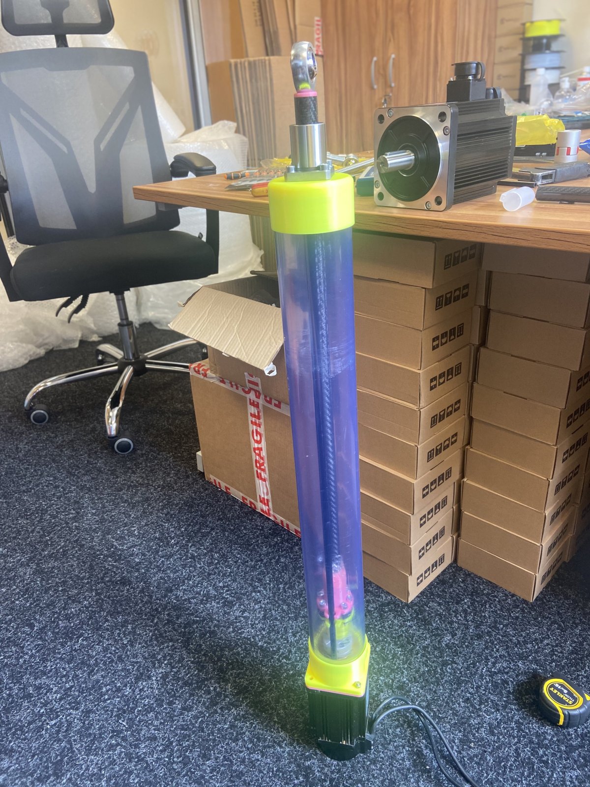

  15. CStretton
    Jan 10, 2021
    9
    112Coins
    +16 / 0 / -0

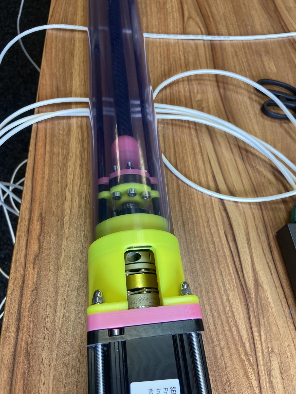

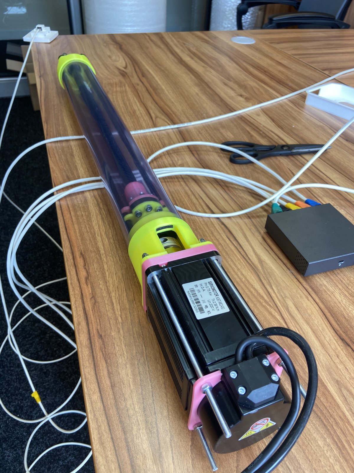

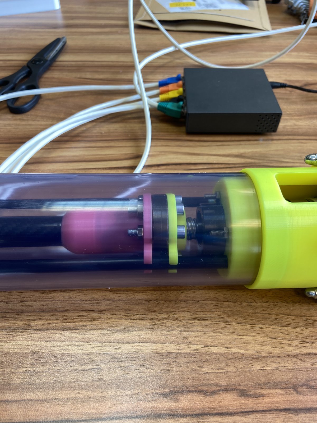

    Unfortunately I've been busy at work so this dropped to the wayside for a while but now newly engineered and tested. The new version includes a IGUS bearing in the top hat, FK12 bearing in the reception plate and I am also now using a 1610 ballscrew. It is noticeably quicker than the 1605 already.
    IMG_3633.jpg IMG_3632.jpg IMG_3631.jpg IMG_3630.jpg The base is temporary just so I could test and will get replaced shortly.
    Excuse the mass of work related wires in shot!

    A quick clip so you can see it in action! 5 more to go and the hexapod to design and build now :sos
