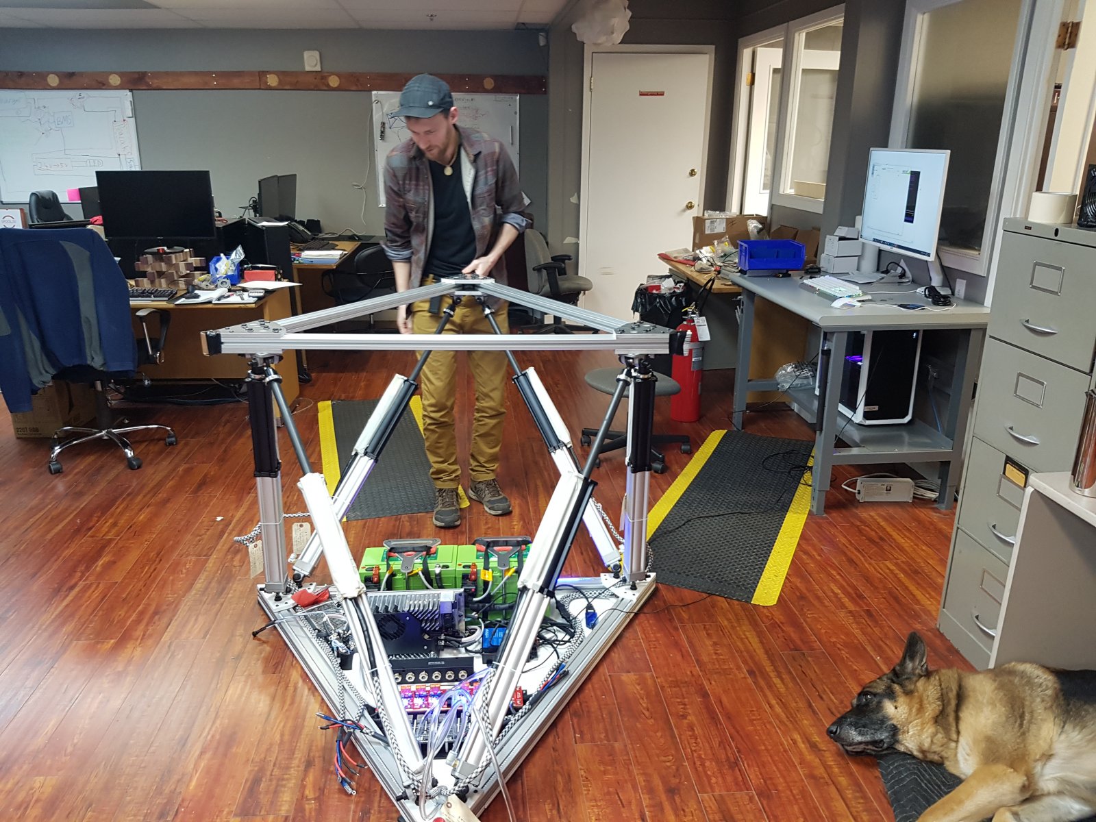

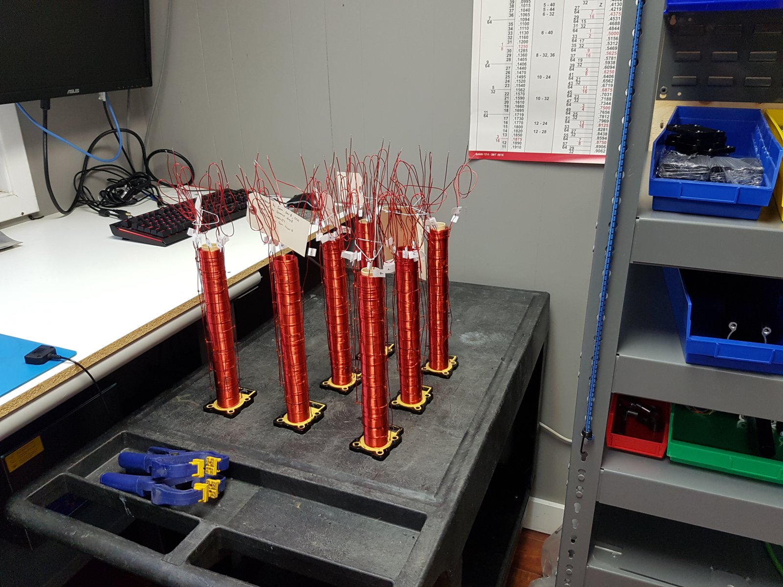

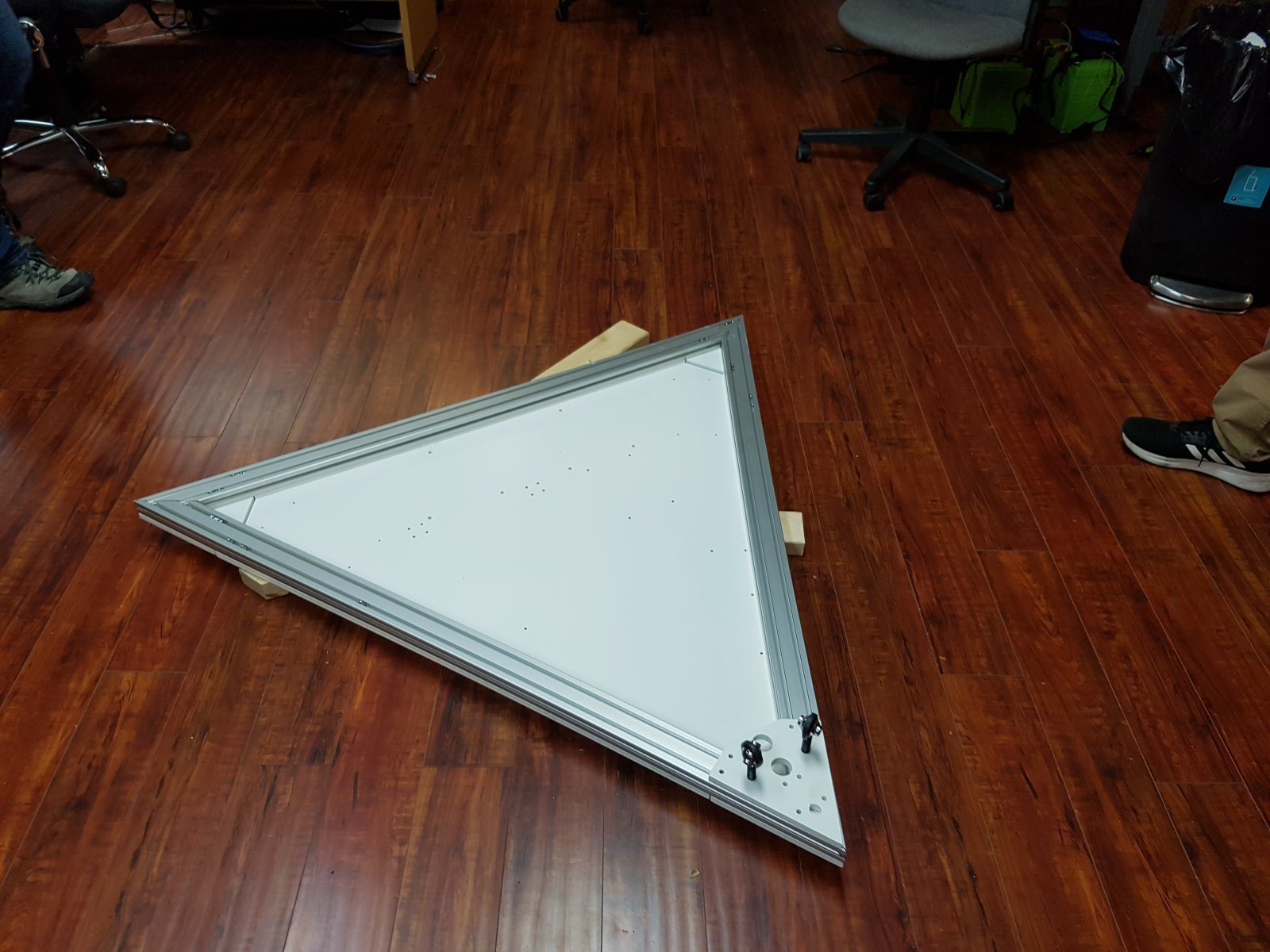

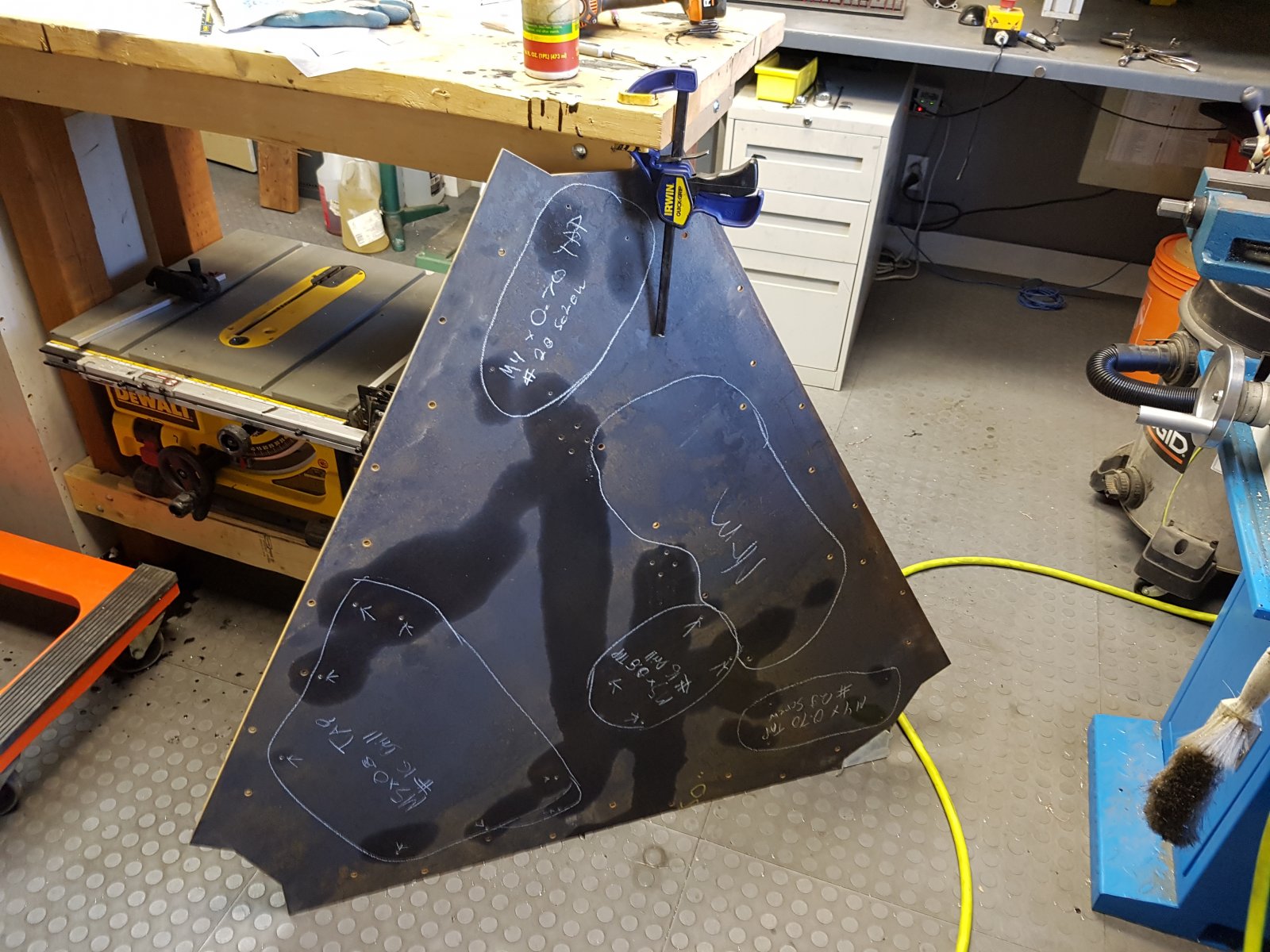

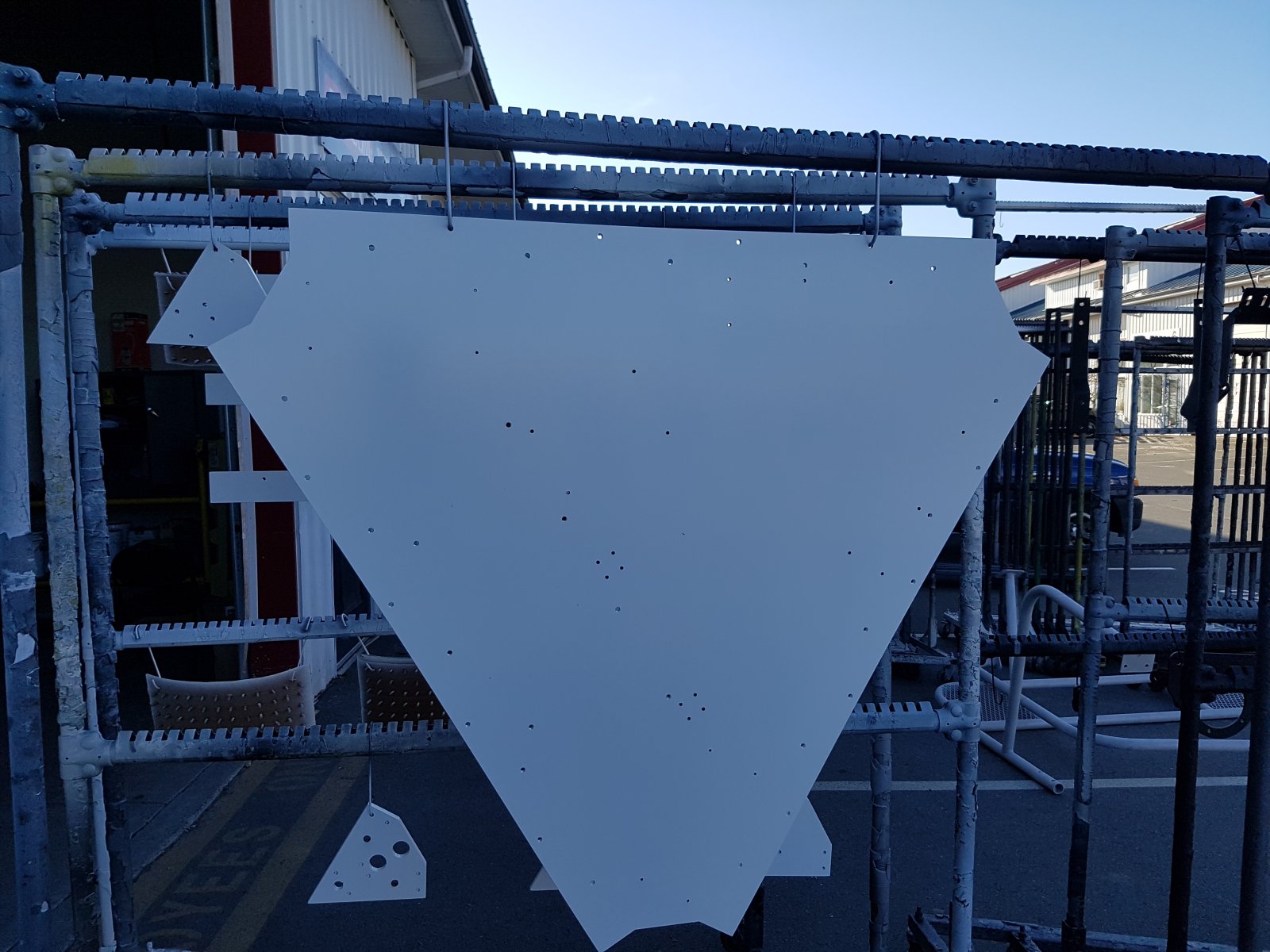

    Have had a new build in the "planning" stage for quite a while, the main structural parts got back from paint today so now starting the build.
    It's a bit of a different approach so it will be interesting to see how it all pans out.
    Disclosure: This is just a tech demonstrator for now, still quite a way's from a commercial product.
    Base plate after tapping
    Picked up from powder-coaters
    Motors ready for electronics
    Under construction.....

    Linear motors?
    Something I looked before making my rig.
    But going that way, I would still be in the actuator build fase making coils.
    Good luck with the project! Those are really fast. Are they strong enough?

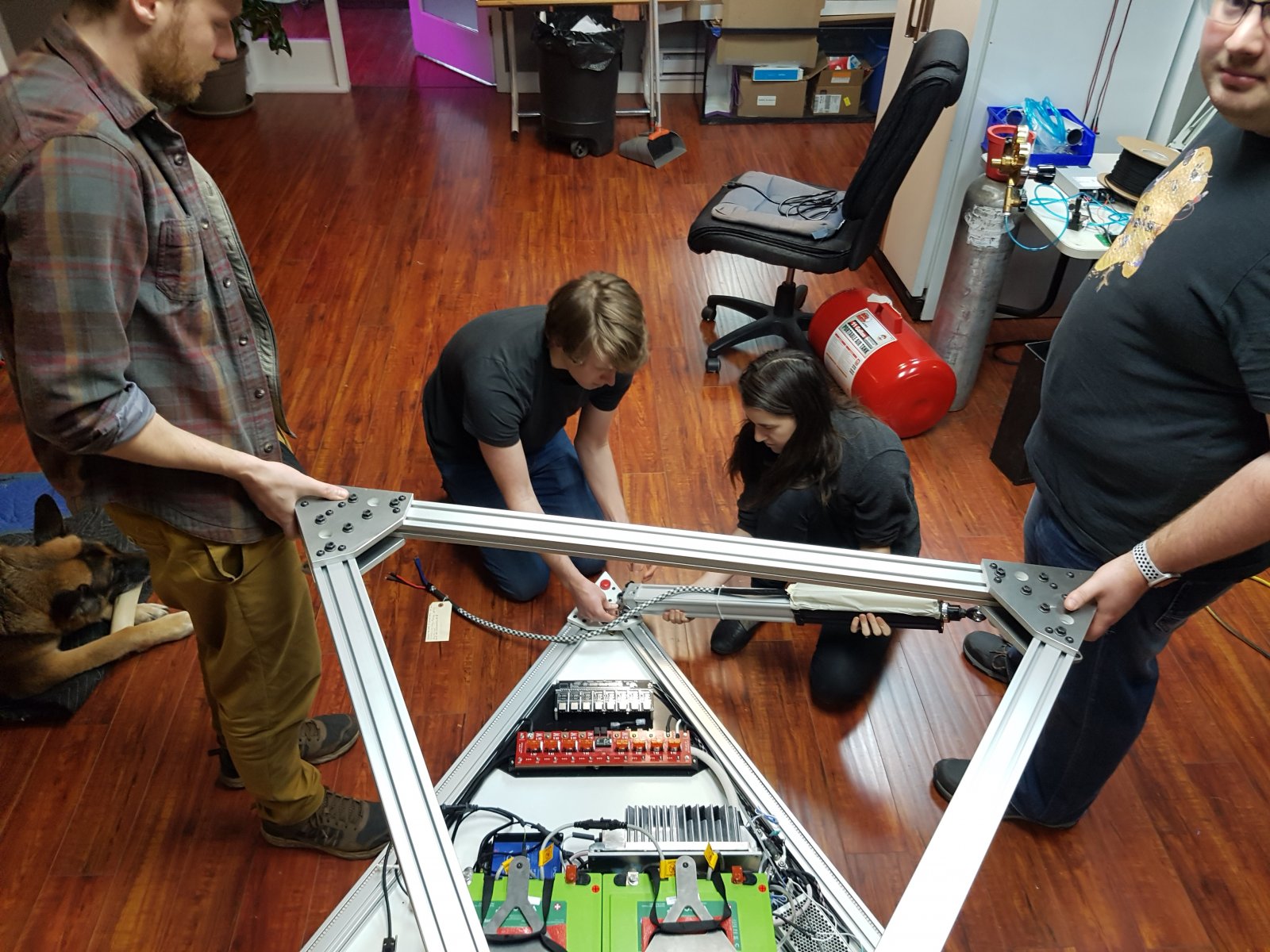

    Thanks! @pmvcda RE force output, that's the hope, We are hoping to be able to move a ~250lbs load for the demonstrator. It's using a combination of linear motors and pneumatics (to offset "empty" weight.) One of the drawbacks of linear motors is that they burn power holding a load at rest, so the concept is to use the pnumatics to offset the weight of the platform (and the rider) to a neutral point and then use the linear motors for actually moving things about.
    Now of course it remains to be seen just how well this will work!

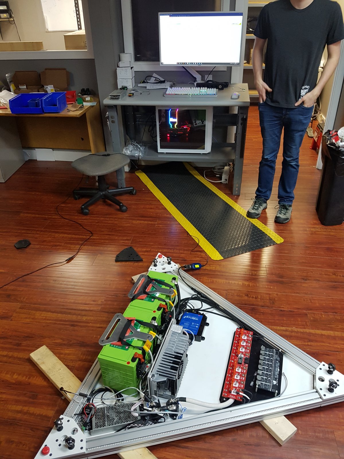

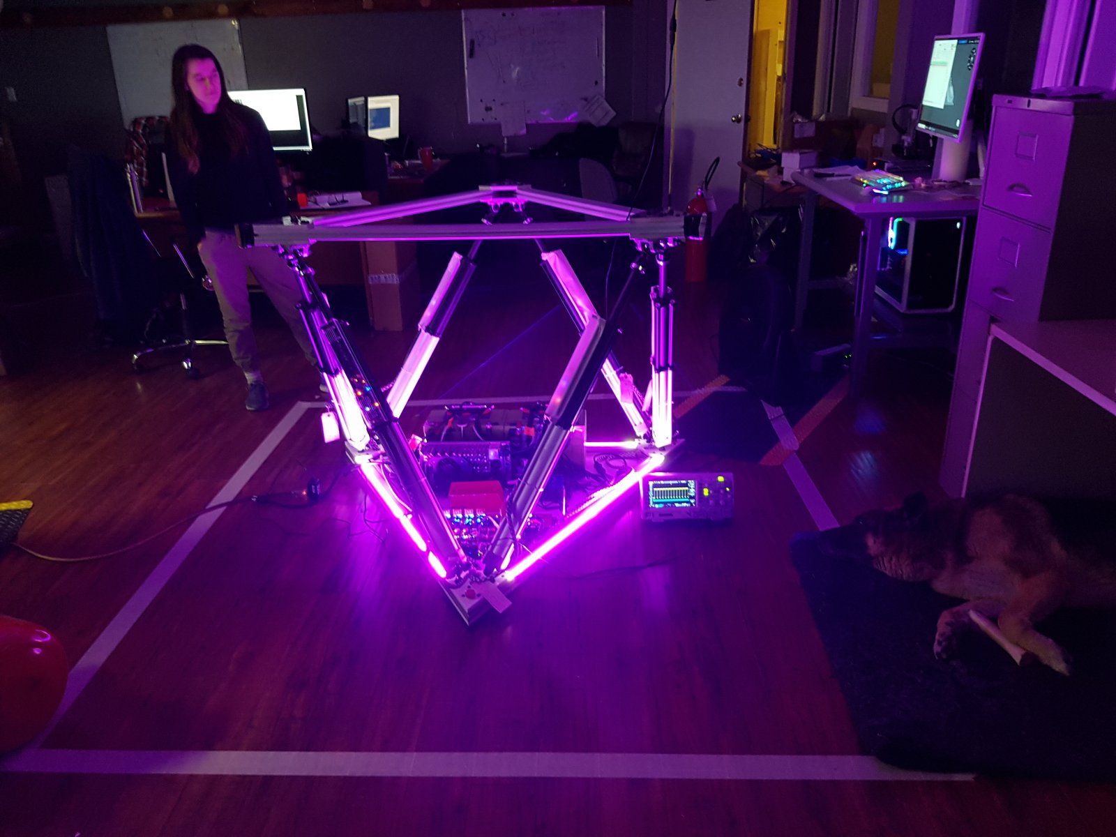

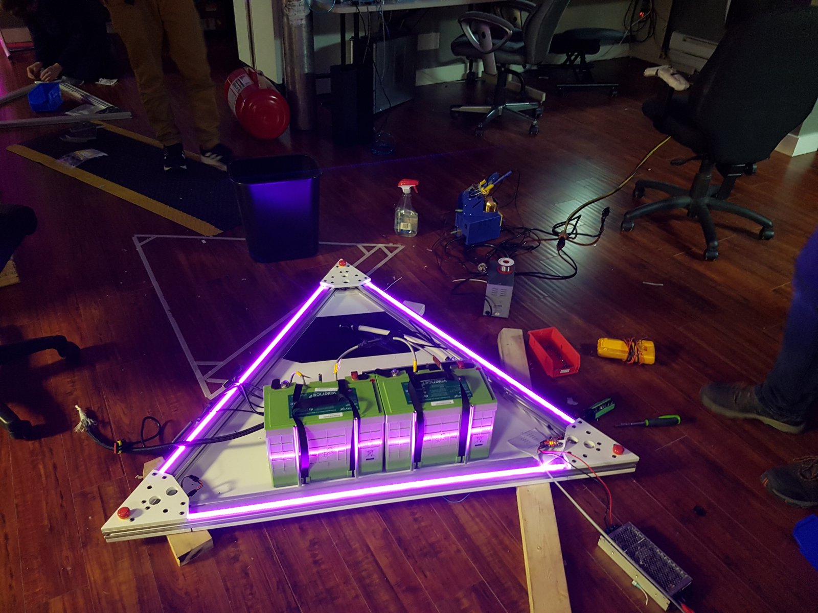

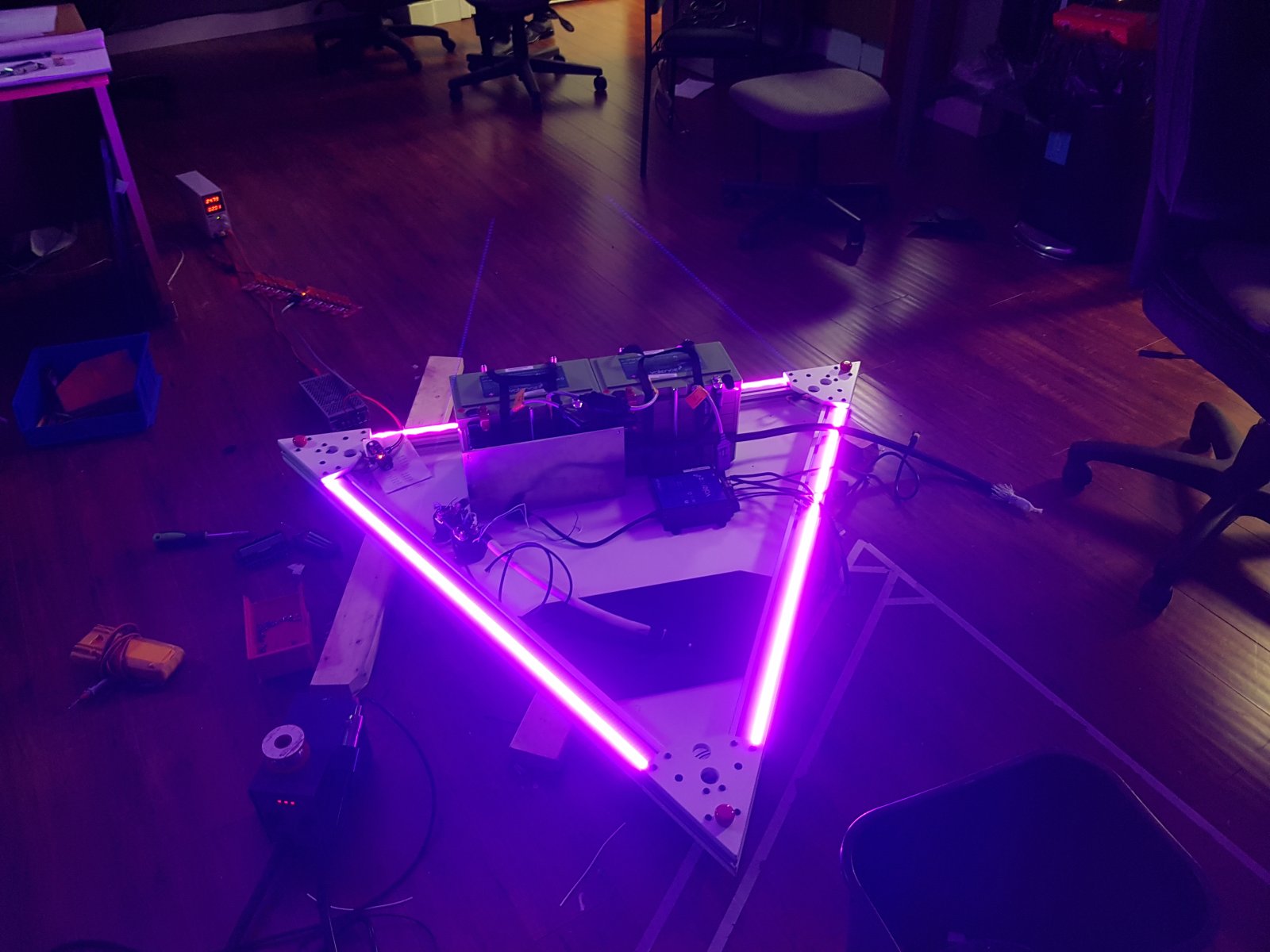

    A few more pics from this week:
    20191202_165426.jpg 20191202_165506.jpg Never build something without RGB.....
    20191205_114840.jpg Base assembled without legs.
    20191205_140650.jpg Legs going on
    20191205_141333.jpg We built a thing...
    Now.... Does it work.....?
    • Like Like x 5

    As mentioned the motors are ours, they are a "sized up" version of a sort of standard design we have, however in the long run I suspect something a bit larger would be ideal. Our motors are designed with fully integrated drivers (they live on the motors themselves), so there are no external/3rd party motor controllers being used here. The motors are running over RS485 back to our controller.
    The motors are 24V and are powered directly off of a LiFePO4 power pack. In this case we are actually running each individual motor through a pretty high accuracy bi-directional current shunt/power distribution rail. In theory we should be able to do some power recapture during certain braking movements, so we wanted to be able to have a way to capture some data on just how much juice we may be able to put back into the battery bank.
    The mechanicals are all pretty simple COTS parts from McMaster and a bunch of waterjet plate. Not quite as elegant as some other designs, but again at this point its just a development platform/tech demonstrator.

    Those neon strips look cool! Good job.

    Sorry for the delay in response. There are a few differences:
    -They are very fast both with respects to max speed but also with respects to latency. A lot of that speed comes from these being our own motor drivers, and our own controllers, but loosing all the mechanical problems of gears/screws etc speeds things up tremendously. Our current "motion to photon" time "would be" in the 200µs range if there was a headset that was fast enough. So currently we can command a movement, send it to the FPGA, have the FPGA calculate the IKM, send commands to the actuators, have the actuators interpret those commands, power the coils, have the coils come up to full field strength and start moving, + resolve the new platform position and pass it back to the game environment at >5Khz. Most of where this is useful is in providing very smooth motion, IE no bucking/shaking/etc (unless you want there to be!)
    -Having very little mechanical tomfoolery means no backlash issues and "in theory" fewer mechanical issues over the service life.
    -The motors can generate some pretty aggressive vibrations that you would have a hard time doing safely with more traditional motors.
    -Not necessarily unique to us, but being low voltage DC means you can offload surge power draws to a battery bank, meaning you can run this thing on a standard wall outlet. Also we can regenerate some spent power and send it back to the batteries depending on what movements are going on.
    -They are pretty quiet
    -Being force controlled motors means we can detect user weight and user weight distribution, so for a bespoke application shifting the users weight side to side can be interpreted as a user input. IE say you have an experience were you are flying a dragon or riding a dolphin or something, the guest doesn't need a joystick, just their butt in a saddle/etc.
