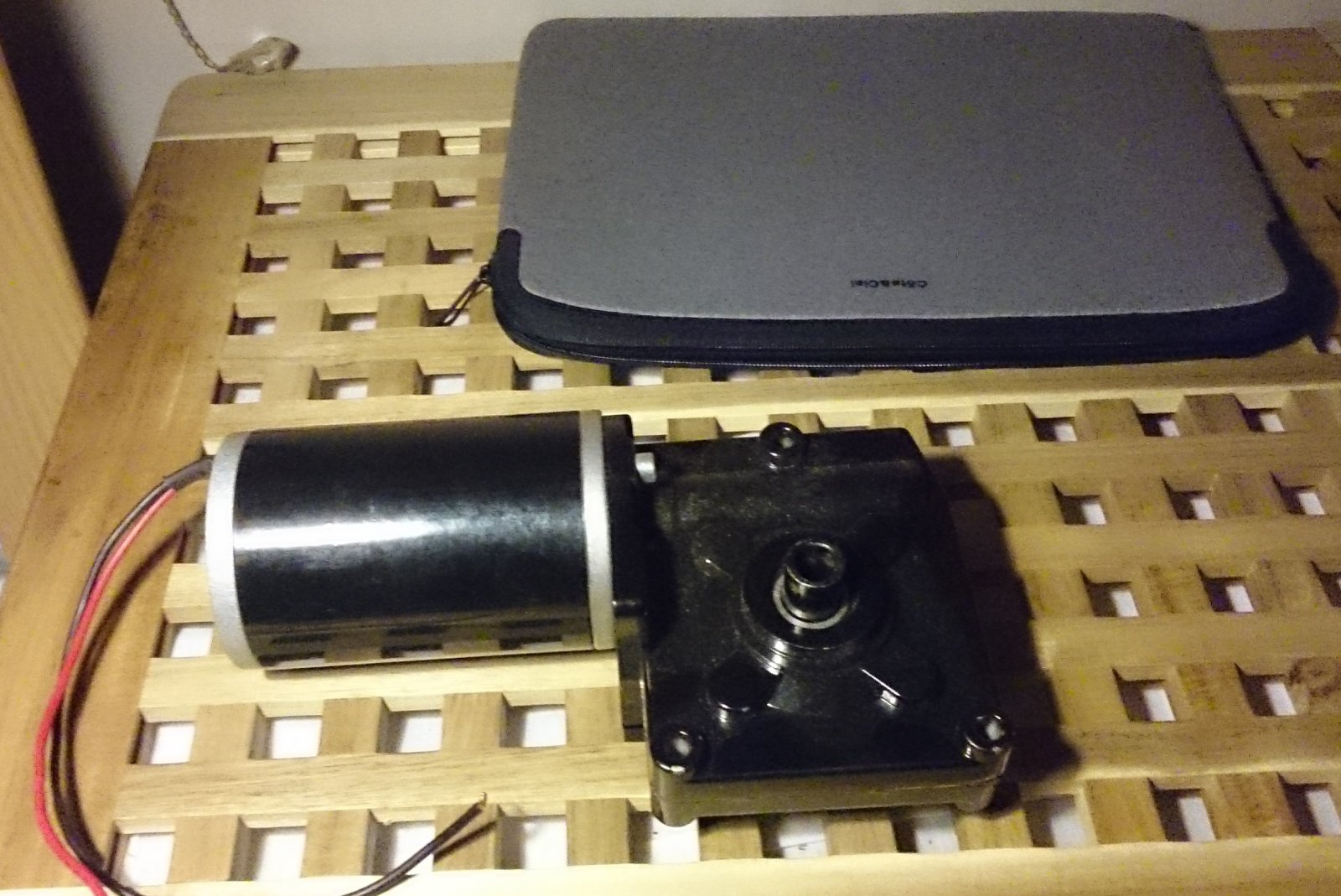

    Hi all,
    Just a quick update, I have received my motors and pololu controllers should be arriving today :) motor.jpg
    However, after all the insults I've received from @bsft I will no longer update my thread on xsimulator.net and you can watch the progress of my build on Thanos forum.
    I wish you all the best with your simulators.
