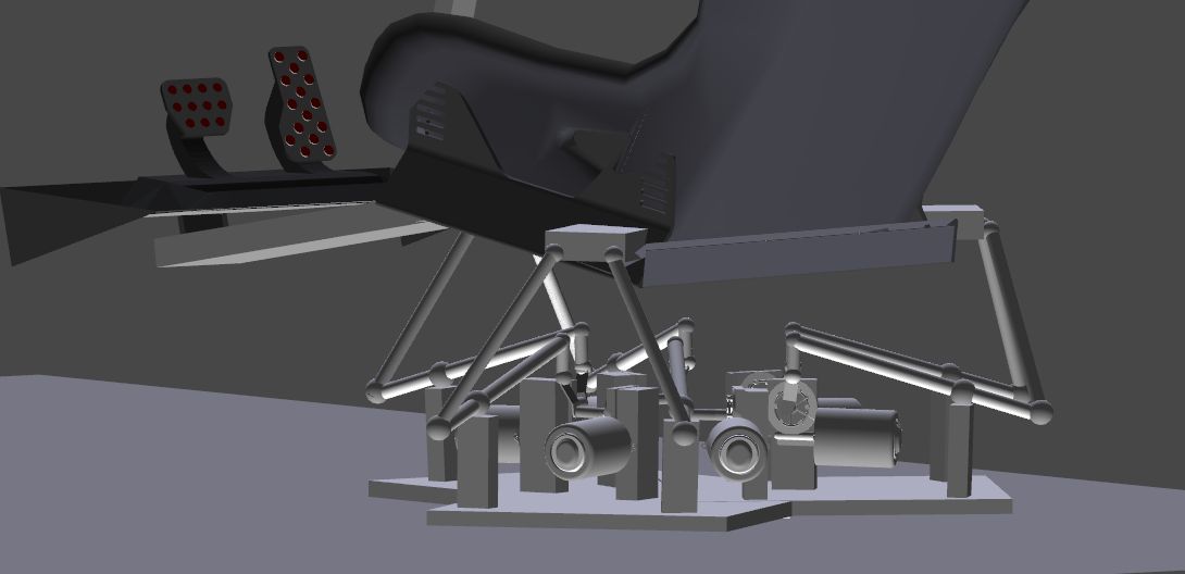

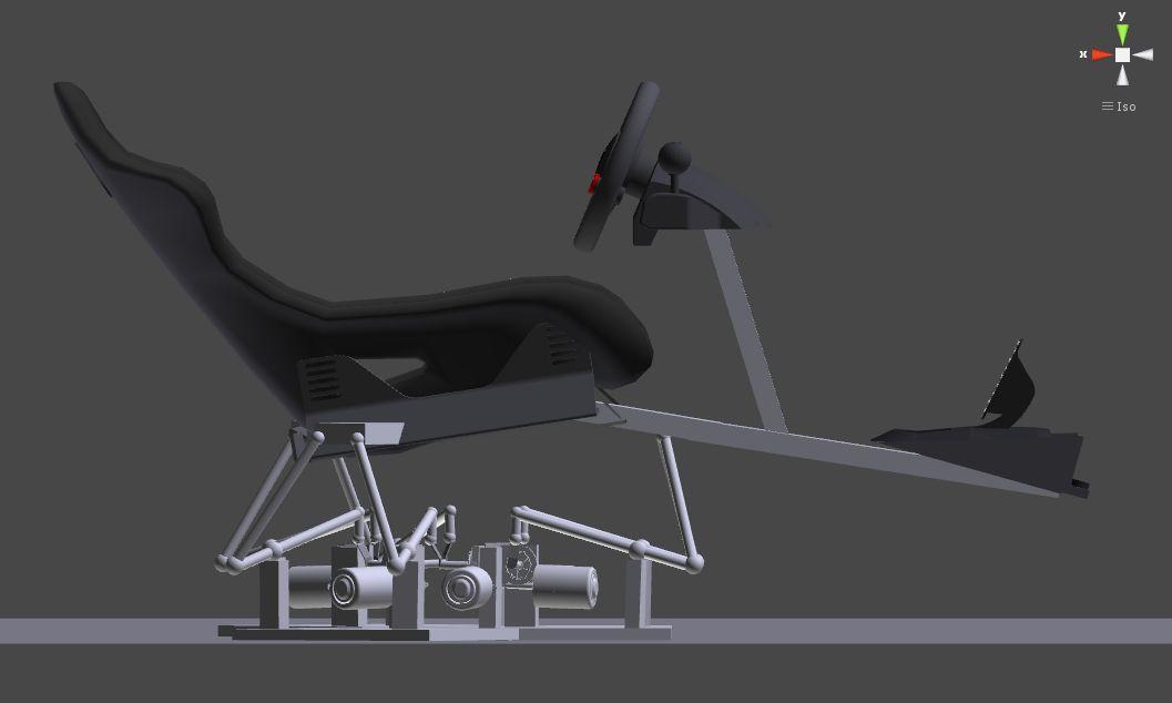

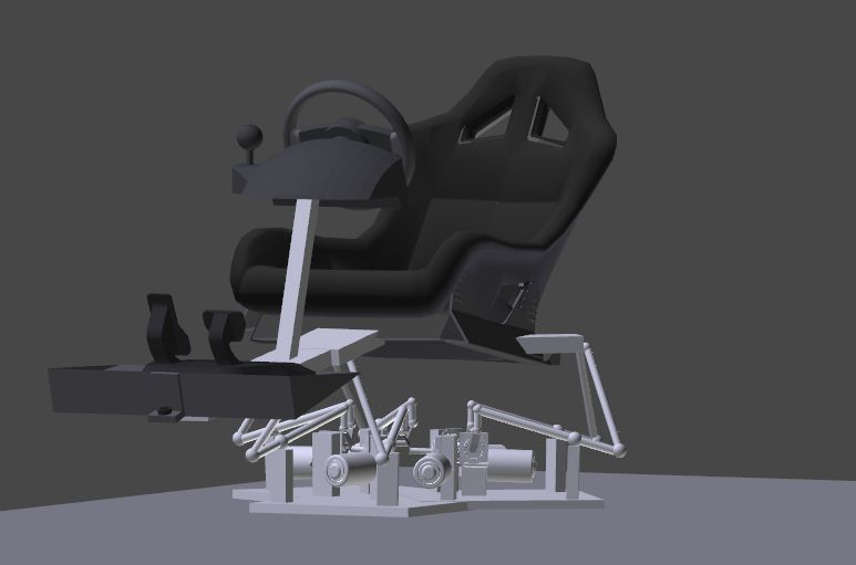

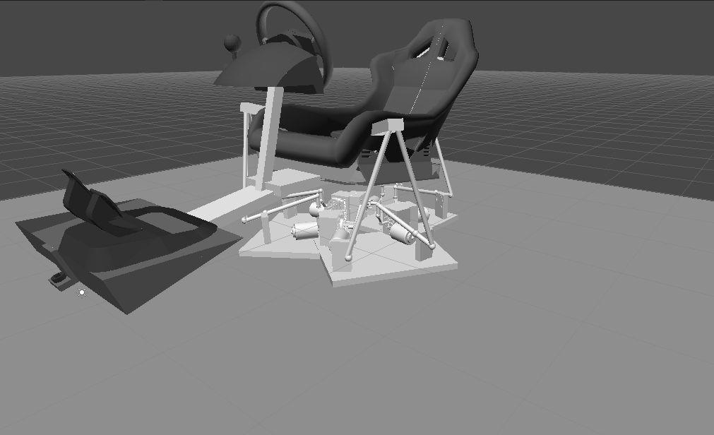

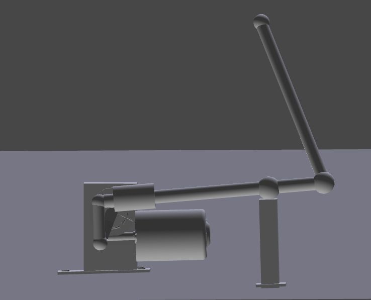

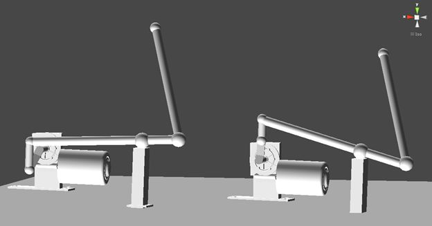

    I am looking into building a 6dof motion platform for use with VR headset (D2 on the way) for racing and flying simulations, (and hopefully Star Citizen), and would like to hear your thoughts on 6dof simulator with levers.
    The simulator needs to be able to lift about 100Kg of weight, and I’d like to have 7-10 cm of movement.
    I have been looking for existing 6dof concepts, and so far merchan-e concept with 6 wipers seems like the most cost effective way to go
    http://www.xsimulator.net/community/threads/prototype-6dof.5045/

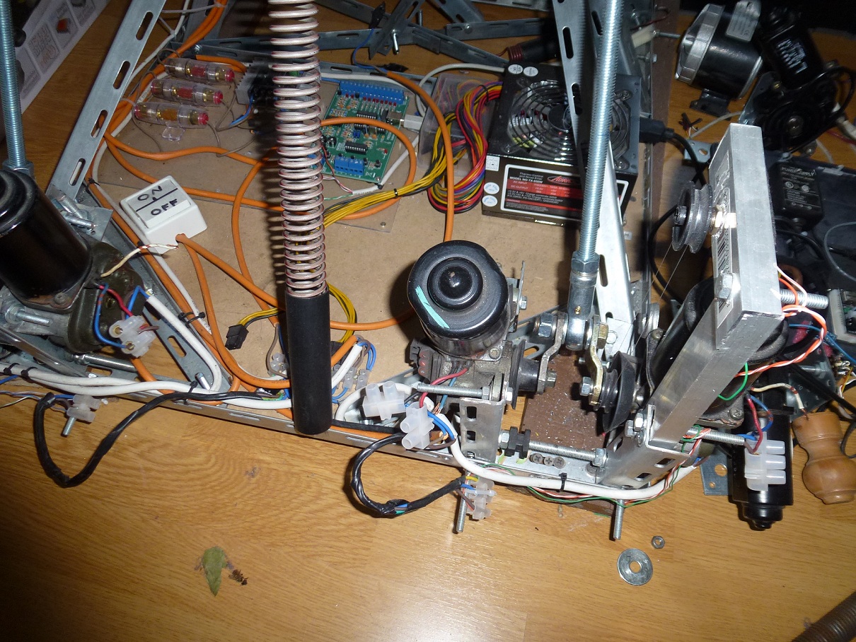

    I have seen a lot of simulators with motor arm connected directly to the push rods and the platform.
    According to ebay:
    “it is NOT recommended to put weight directly on a gear motor's shaft! An excessive radial bearing load may damage a motor's gear box quickly! It is always safe to isolate the load by introducing a pulley or sprocket system."
    http://www.ebay.com/gds/How-to-Buy-the- ... 002/g.html
    What do you guys make of it?
    The way I see it,
    Wiper motor without lever:
    Wiper motor with lever:)

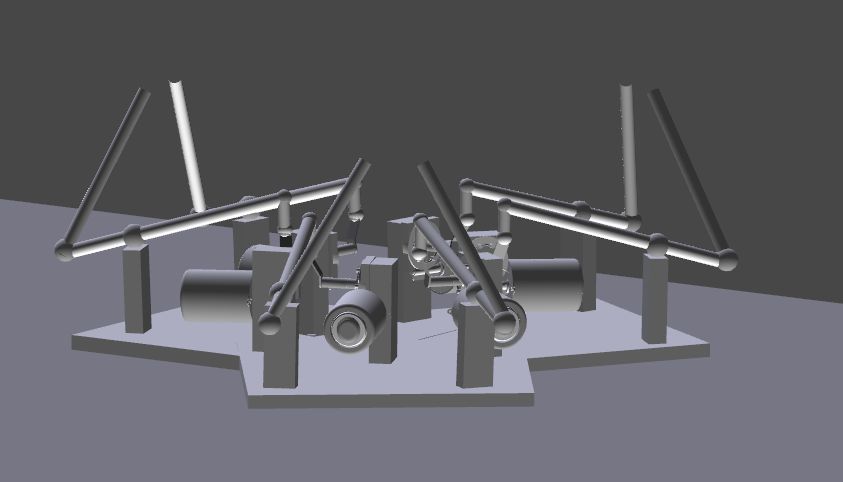

    Similar concept has been used a lot with 2dof wiper simulators (seat balancing on a pivot point).
    I plan to add 6 levers (seesaws), one for each motor, with 1 to 3 ratio so motors only have to lift one third of the platform weight.
    This is what the levers and wipers might look like;
    Would it be better for motors if the weight of the platform is balanced by a counterweight on the longer side of the seesaw?
    How would the change of momentum affect motors?

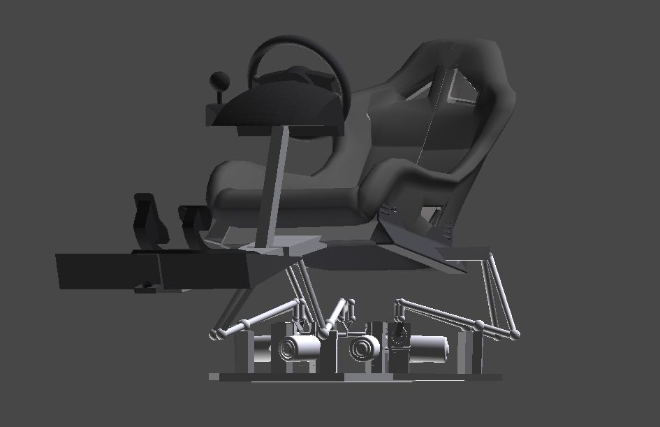

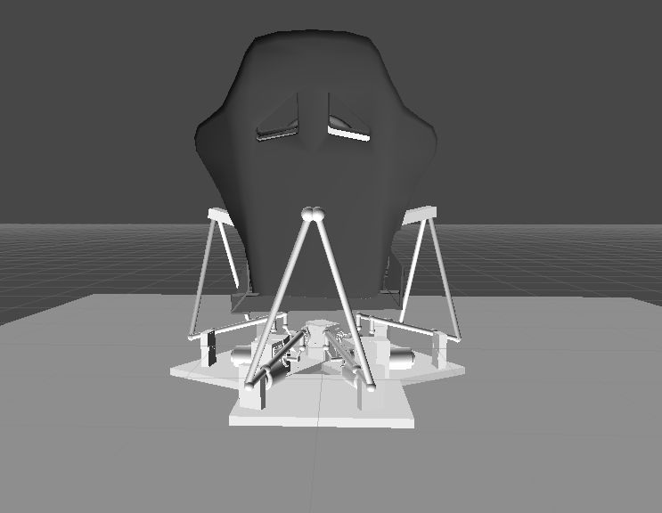

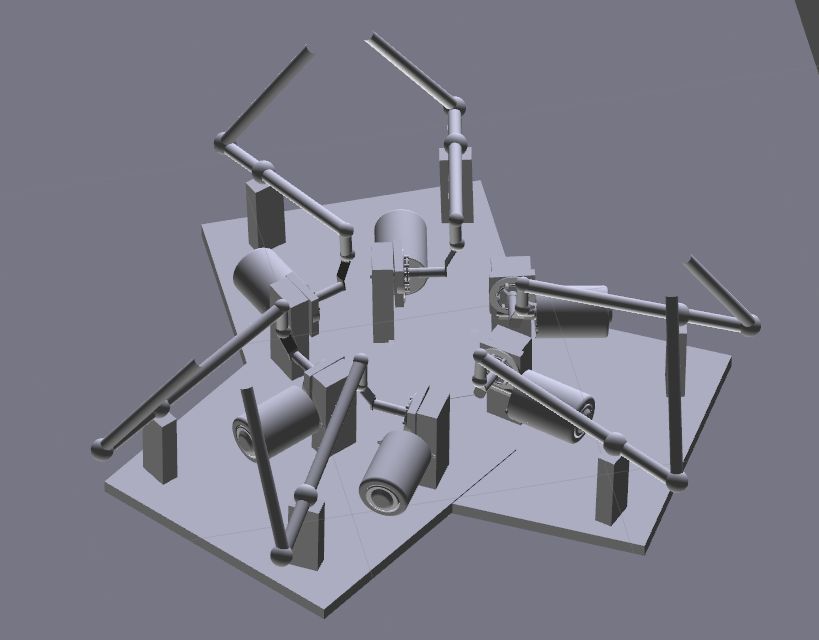

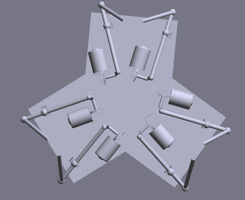

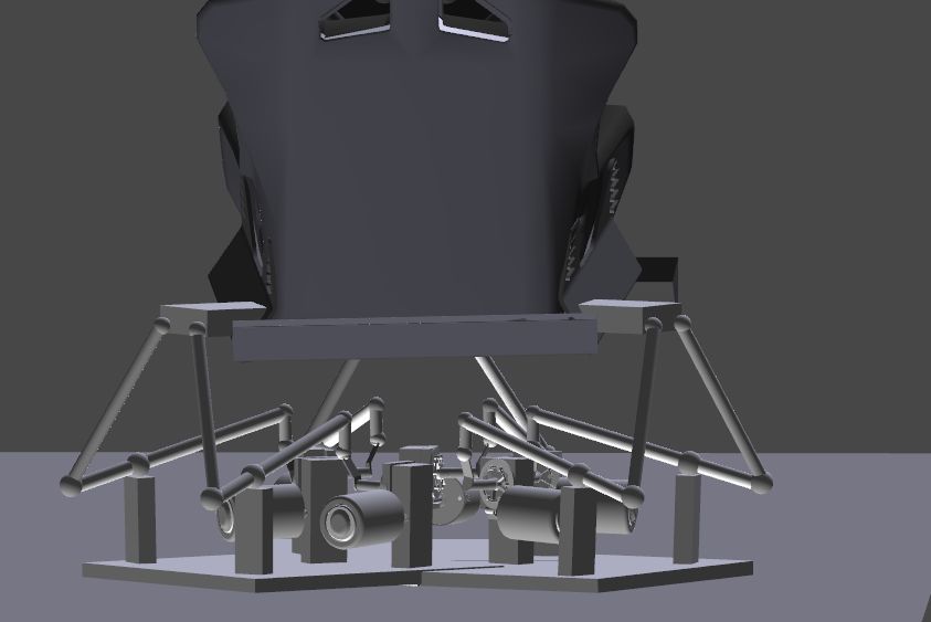

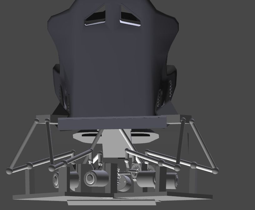

    Here is a rough model of the entire simulator:
    (Dimensions and scales are not accurate)
    I am thinking about symmetrical design, and positioning wipers and levers in line with pushrod angle.
    however I am not sure how great would be the benefit.
    Levers and pushrods should be symmetrical (I'm not so worried about motor positions)

  2. SeatTime
    2,573
    These low powered DC 6DOFs are all new territory at the moment, so there is not allot of real data to go on - apart from it may not work:(. I'm soon to load test the same motors but with steel geared 60:1 gearboxes (allot stronger than the stock nylon gears) which will basically give me the same output torque as your levers, but likely more movement. I'm hoping this will be able to lift with six motors myself (I'm not that heavy) and a lightweight frame (myself/frame should come in well under 100Kg). The counterweights should work, but will add mass which could slow down the response of the sim. I'm currently running these motors around 13VDC and have not had a problem (The full specs for the motors are on the motion dynamics site)

    Hi SeatTime,
    Sounds great! I'd love to hear how these motors perform.
    I also though about replacing gearboxes, but that is additional cost.
    I like levers because they don't add much friction (much less than gearboxes), and they are cheap to make.
    Reduced motion is downside of levers, but this motor does 180 rpm, so even if it slows down to one third, 180/3 is 60 rpm which should be pretty good.

    @Tino , the idea of see saw is a good idea and certainly worth a try. Give it a run and show us something new.
    As for ebay saying its wrong to put the load directly on a motor shaft, well, obviously they are reading from a textbook or have simply no idea. I have to disagree.
    Frame design is crucial and you could use the most powerful motors around, but if the setup is poor, its a waste.
    Apart from yourself looking at the idea, a zillion DIY sim builders have not done this. Probably because a lever on a motor shaft just works.
    Using a seesaw effect to increase load carrying but at the cost of a overall speed, well you might as well just use a higher ratio gearbox on it. Say a 50:1 or 60:1 , giving you about 70-90 rpm or so. Still good speed with a lever on it still works out near 200mm per second or more. Then you have more actual lifting torque.
    With the motors , where are you in the world? There may be an equivalent somewhere nearby you. Motioncontrol in the UK has these motors , ebay has a crabpot motor on ebay from a supplier in the US , I think.
    And if you plan to use 24 v, use 24v motors, dont overdrive a 12v with 24v, and also the opposite, dont use a 24v motor on 12v.

    @bsft Thanks, I'm glad you like the idea.
    I live in London, UK and it would be very helpful if you or someone recommend worm drive motors around 150-200w and 20 Nm torque available here.

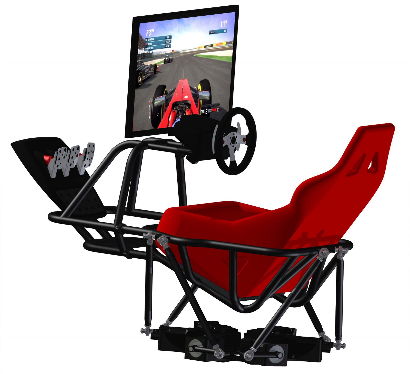

    I agree that good frame design is crucial. I quite like the frame design from Full Motion Dynamics, I'm thinking of building something similar.
    I'm hoping that adding 6 pivot points will increase the stability and safety of the platform. It won't cost much and will make me happy :)
    To me using seesaw in 6dof makes sense just like using pivot point in 2dof simulators.
    In theory you could make 2dof by mounting seat directly to a motor shaft and 2 motors would do the job, but pivot point makes it possible to use much smaller engines, adding levers seems like a logical step to make 6dof with smaller motors.
    If my math is correct on the other side of the lever I'll have 6 200w 20Nm motors to move about 33Kg of weight.
    Motors will have to cover greater distance, so I'll have to see what will be the final length of the motor lever.
    I like the idea of connecting motors to the seat above center of gravity .
    Do you see any problems with rotating the motors 180 deg so back of the seat is connected one tip of the 'triangle' like in FMD design?
    If this is OK then for final design I could have pushrods connected to the seat a bit higher, like:

    you already found the design I was looking for
    I havent built a 6DOF, so @Historiker and @merchan-e are best to advise on that.

    Great! I call it 'standing on shoulders of giants' :) there is a lot of knowledge out there and these forums are a great place to bring best designs.
    With lever of 1 to 3 ratio, the weight on the wiper side of lever should be one third, if my understanding of Archimedes is correct :), so 100 Kg weight would be reduced to 33Kg and six wipers should easily move that.
    I think of levers as less complicated and cheaper version of liner actuators
    Levers should work with both faster and less powerful motors (reducing the weight and speed) and with more powerful slower motors, for those you would reverse the lever (motors on the shorter side) workload and speed would be increased but hopefully pivot point on the lever would take a lot of weight.

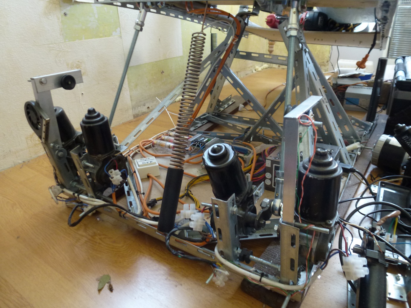

    tino...
    just for the record this are the pics and the treat about linking two wiper... the thing about wipers is that you can get them almost for free in a car junk yard, the only thing about using two motor per axis insted of one is that you need extra power supply... but again... i had some tests using a nice cheap personal computer power supply that worked nice... so just consider it... check this pics (that are comming from this nice forum, where the fresh ideas are really wellcommed) :D
    you can see the beauty of the two motors been linked using a nice cheap trick.... this guy says that he has not a single problem with his wipers...
    and again... used wipers are far cheaper than other options.... but again this is just a sugestion, i have not a real idea about how this works....
    you can see the treat here
    http://www.xsimulator.net/community/threads/one-motor-or-two.5390/#post-55053
