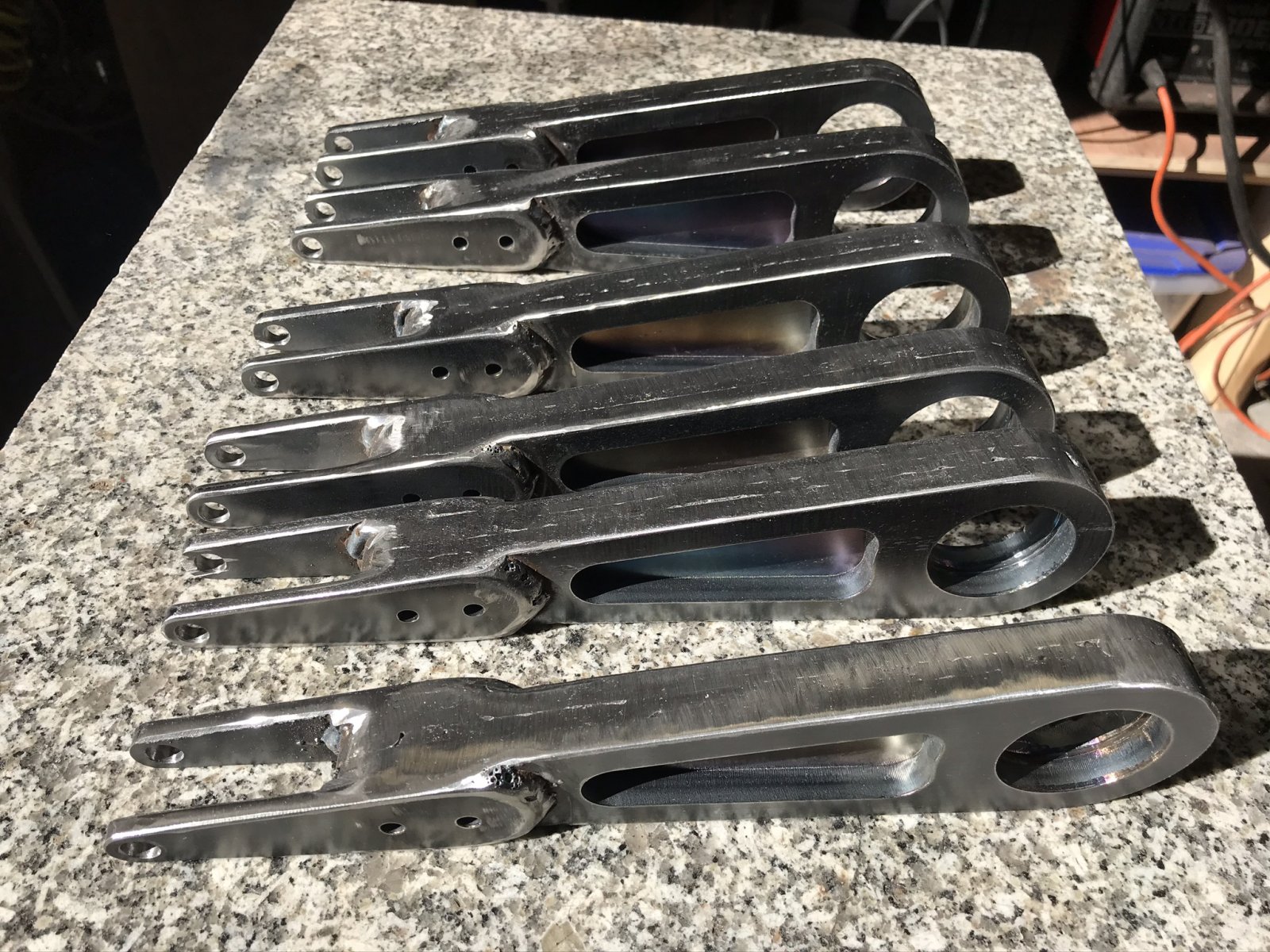

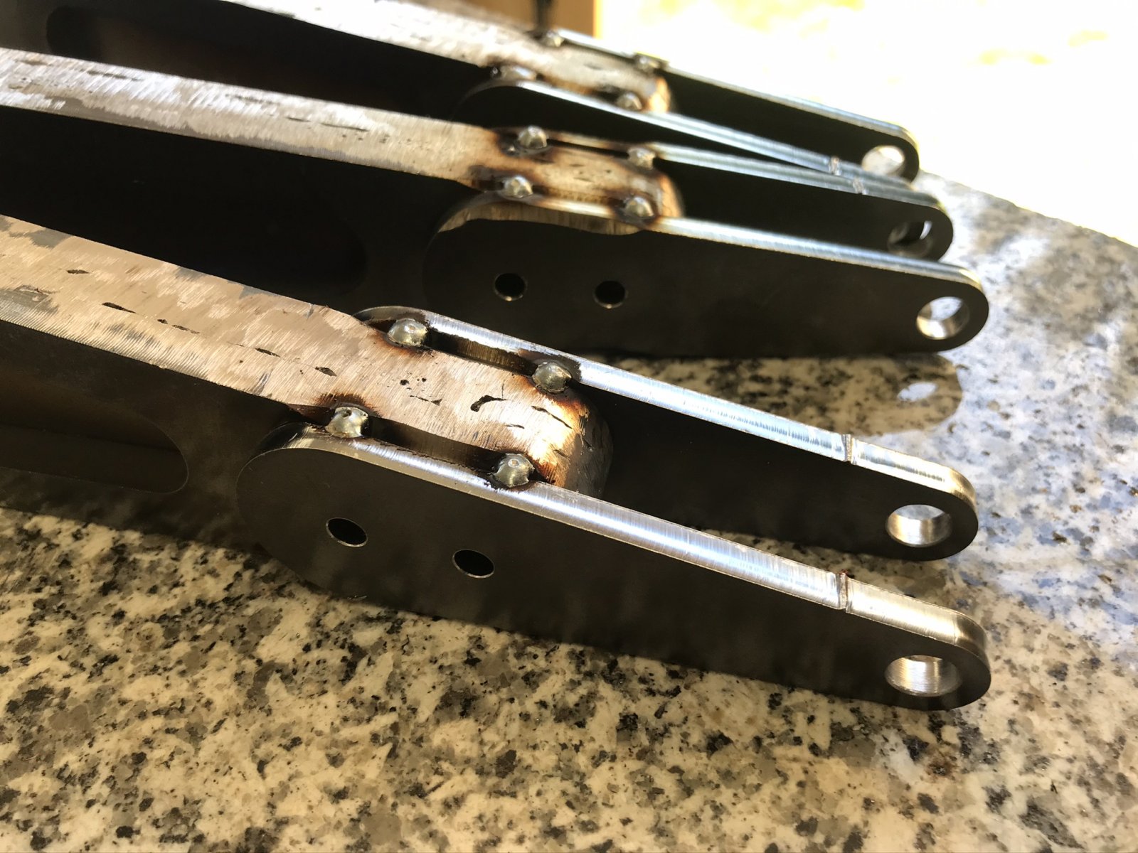

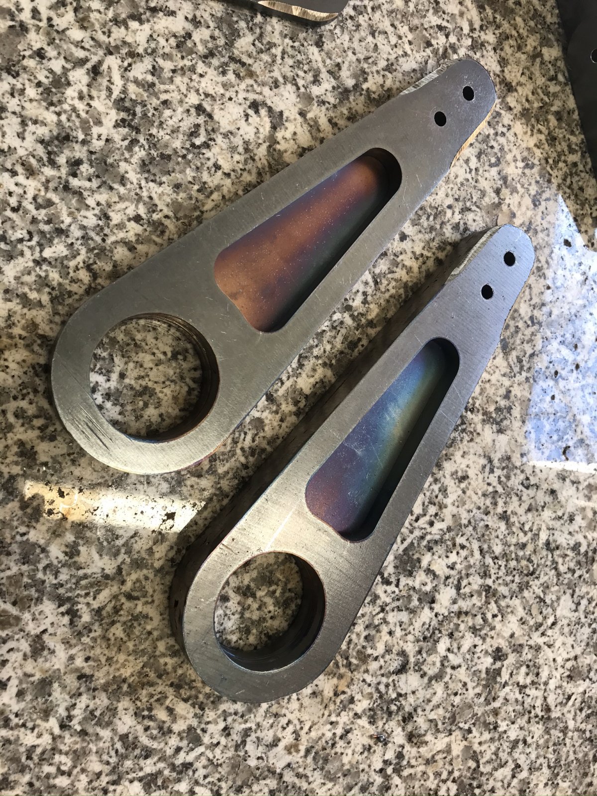

    Arms were made by layering 10,2,10mm laser cut sheets - this gives the 22mm width for the locking bush and maintains accuracy of the cut. It also meant I could put pockets in it:
    0142f693421486f9b33c71b683faa7d4a4577b5f55.jpg 01a3495d8a548c445242bd950da161a6f26422aa1c_00001.jpg

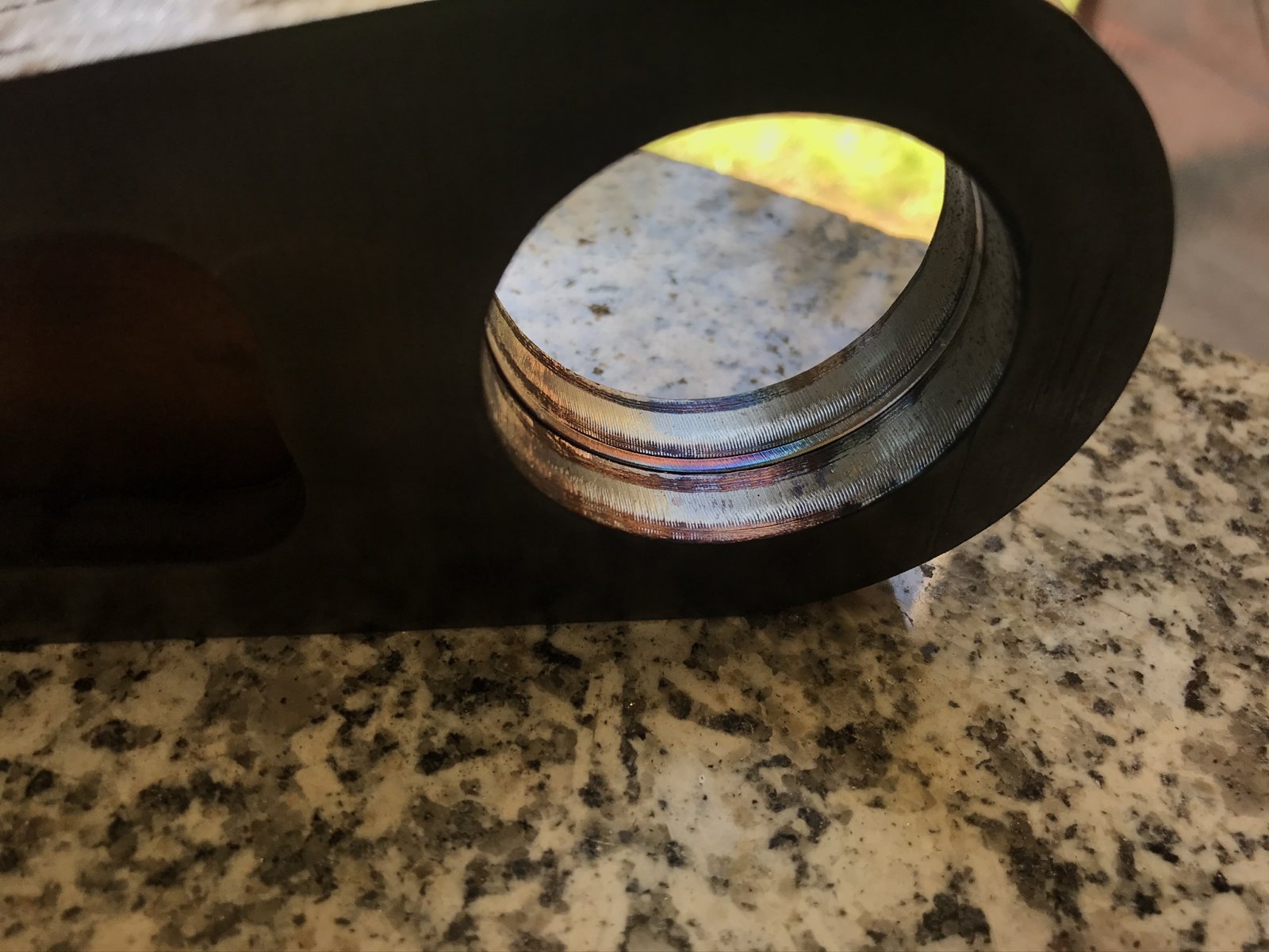

    The Ø45mm hole was aligned during welding with a locking bush. I also pre-heated the parts in the oven to 250°C to try an minimise warping.

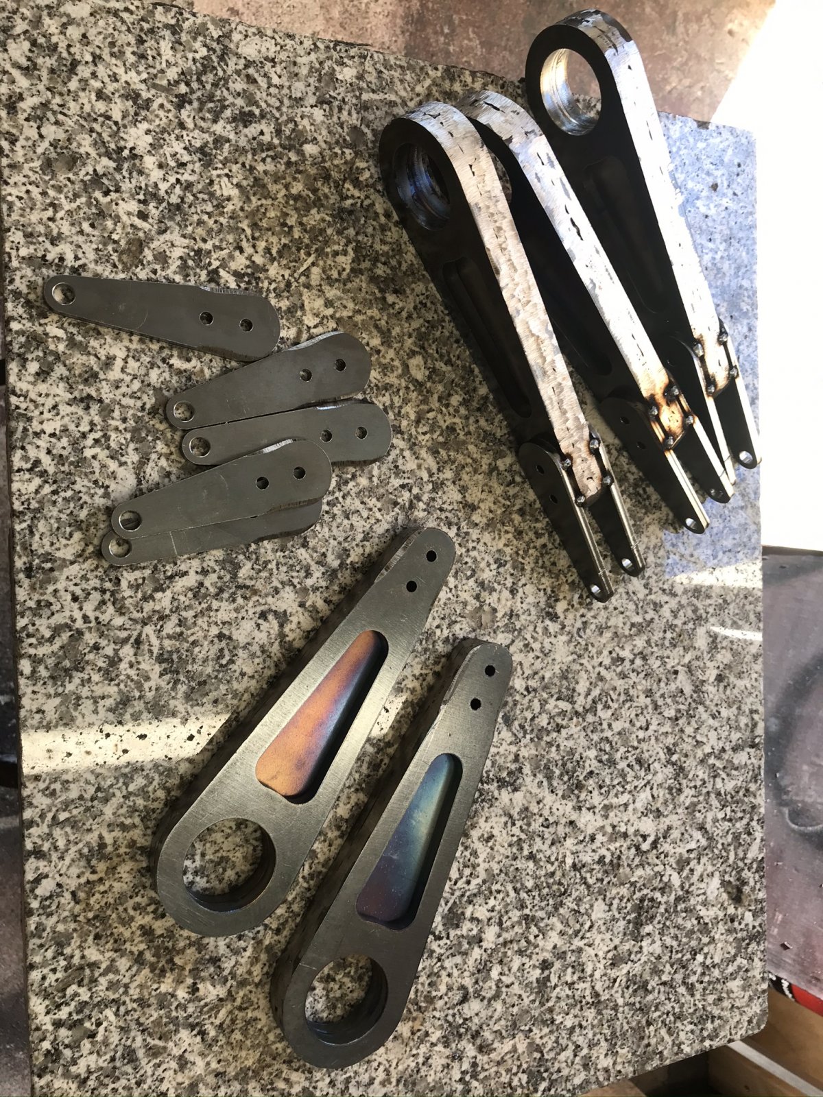

    Separate parts for the clevis were welded on:
    014da24edfd71bfba528250b822eba1e9f7e69bfd8.jpg 01f98d2f865433753fef1aaa269ded0fdebfe45c4b.jpg
    Then they were welded up and ground smooth:

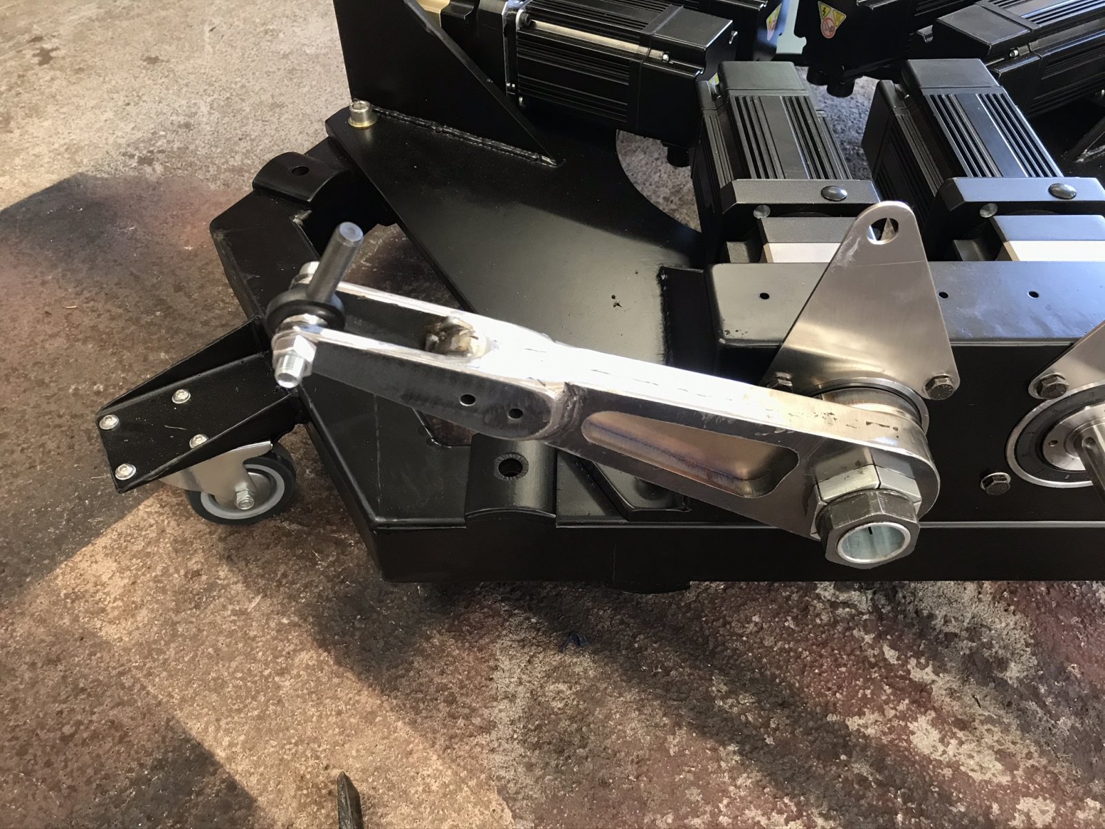

    Finally, I carried out a trial fit before painting them:
    The locking bushes are rated at 315Nm, which is well balanced with the final drive torque. Also, the keys sit slightly proud of the shaft surface, which gives the bush something to grip.

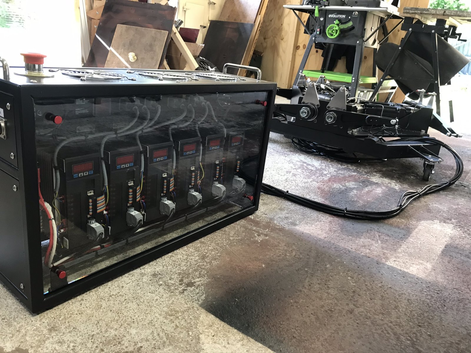

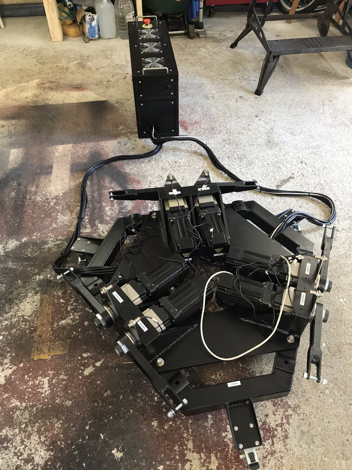

    Getting very close to the final stage of putting it all together now!
    All of the electronics work, emergency stops function, startup and home routine works.
    01dc839cc4ec2e26cfa948013f64deea0430d572ce_00001.jpg 014003d8af0e9e2e11bb996b36c1bcbc3bae588b3c_00001.jpg
    Wiring has been tidied up:
