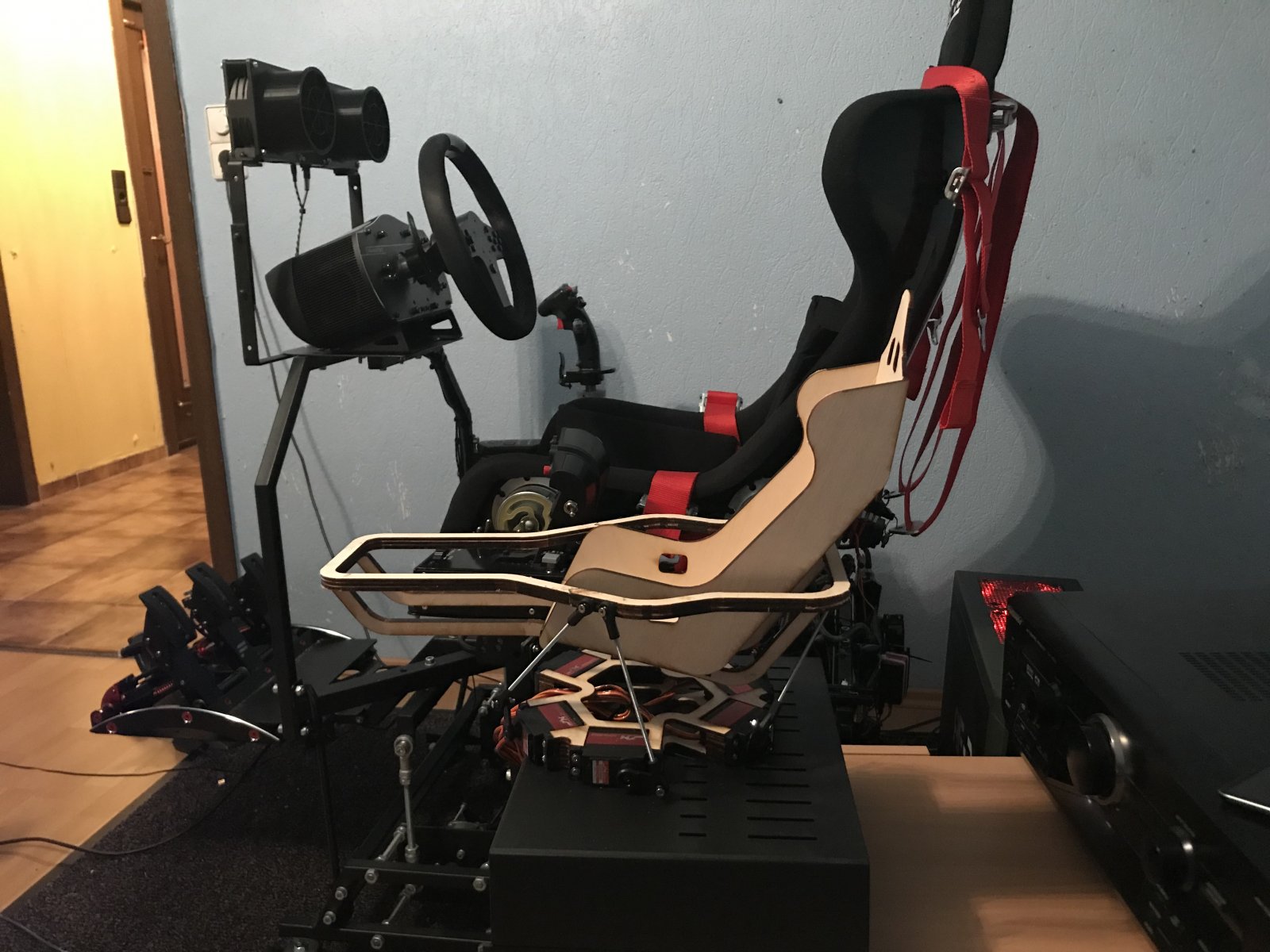

    A small test with own 6DOF model
    driven by Arduino Uno and SimTools
  2. Gadget999
    1,977
    12,066Coins
    +488 / 10 / -0

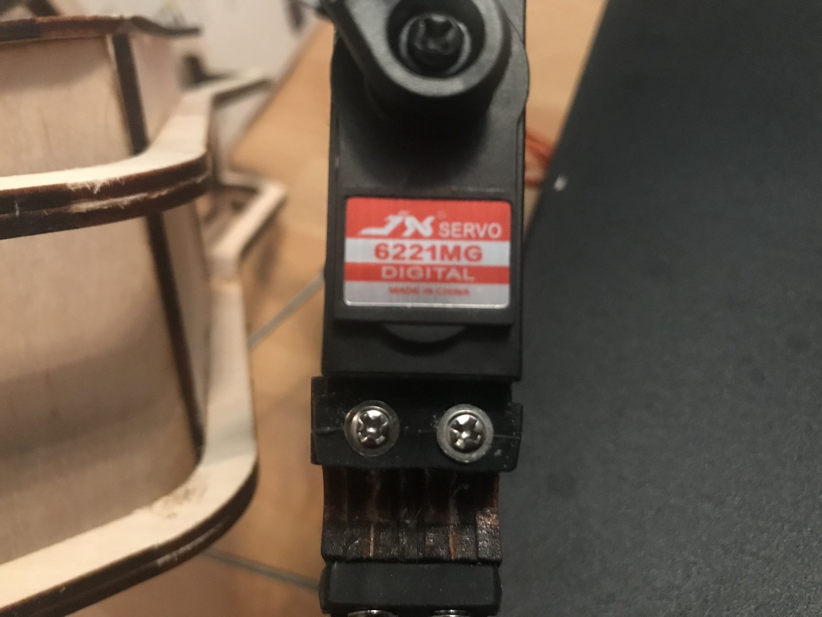

    Looking good. What spec are the gearmotors ?

    This is just a small model with about 40cm. The motors are only RC servos. I only built the model to test the control via SimTools.
    I'm planning a big version with these engines
    "https://www.ebay.de/itm/Schneckenge...var=462497333564&_trksid=p2060353.m2749.l2649 "
    "https://www.ebay.de/itm/Schaltnetzt...var=631661607841&_trksid=p2060353.m2749.l2649 "
    "https://www.ebay.de/itm/Double-BTS7960B-DC-43A-Stepper-Motor-Driver-H-Bridge-PWM-For-Arduino-Smart-Car/200950936475?ssPageName=STRK:MEBIDX:IT&_trksid=p2060353.m2749.l2649 "
    and the rest of metal
