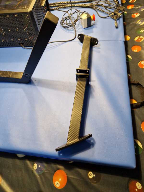

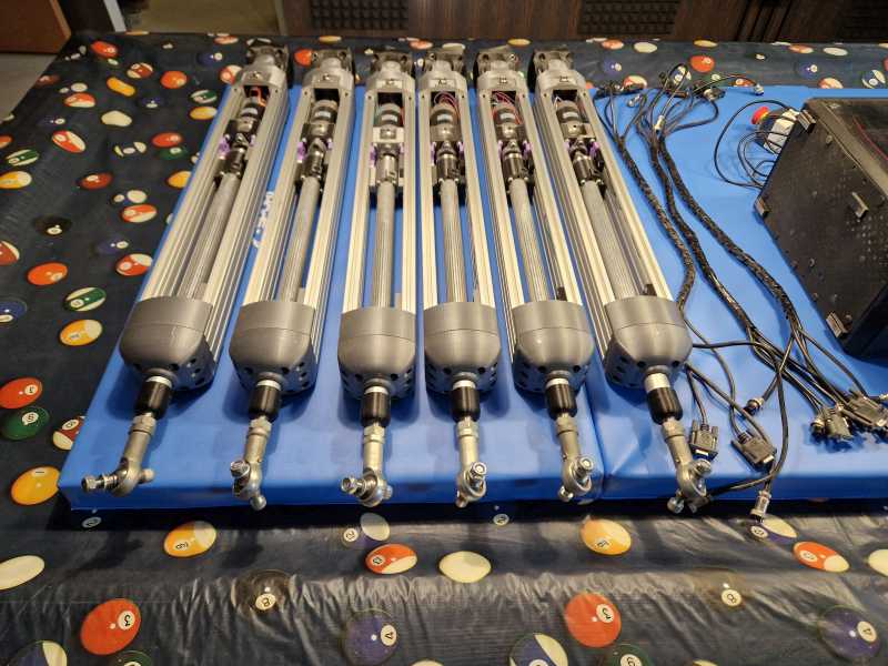

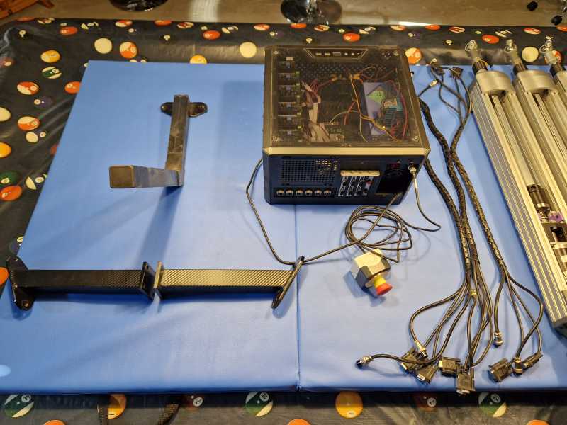

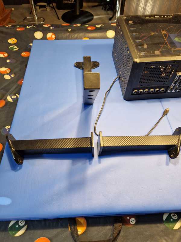

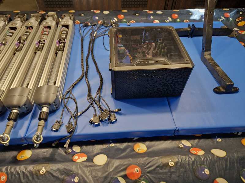

    The base and the moving platform are not inkluded sorry.
    These are some pictures about items.
    20240929_152608.jpg 20240929_152615.jpg 20240929_152635.jpg 20240929_152700.jpg 20240929_152705.jpg 20240929_152711.jpg 20240929_152717.jpg 20240929_152724.jpg 20240929_152730.jpg 20240929_152734.jpg

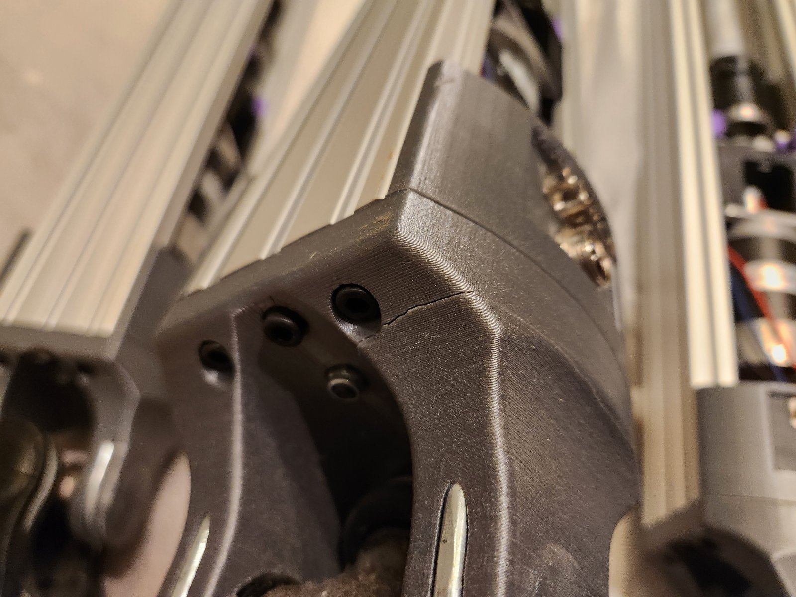

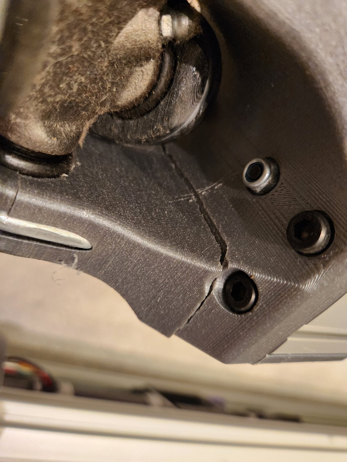

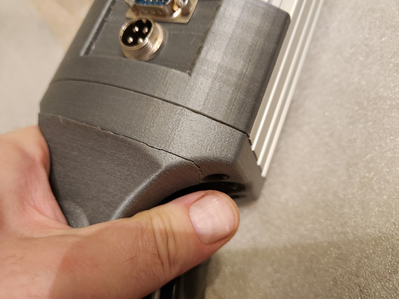

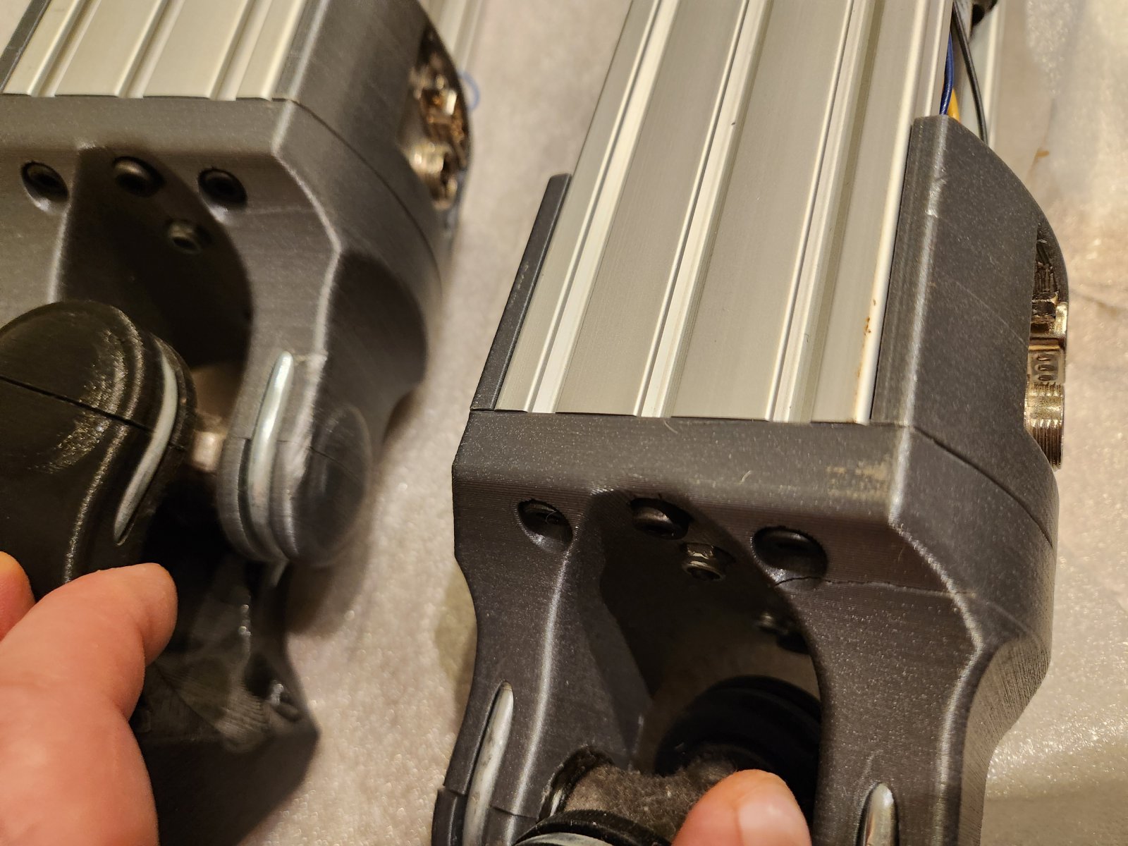

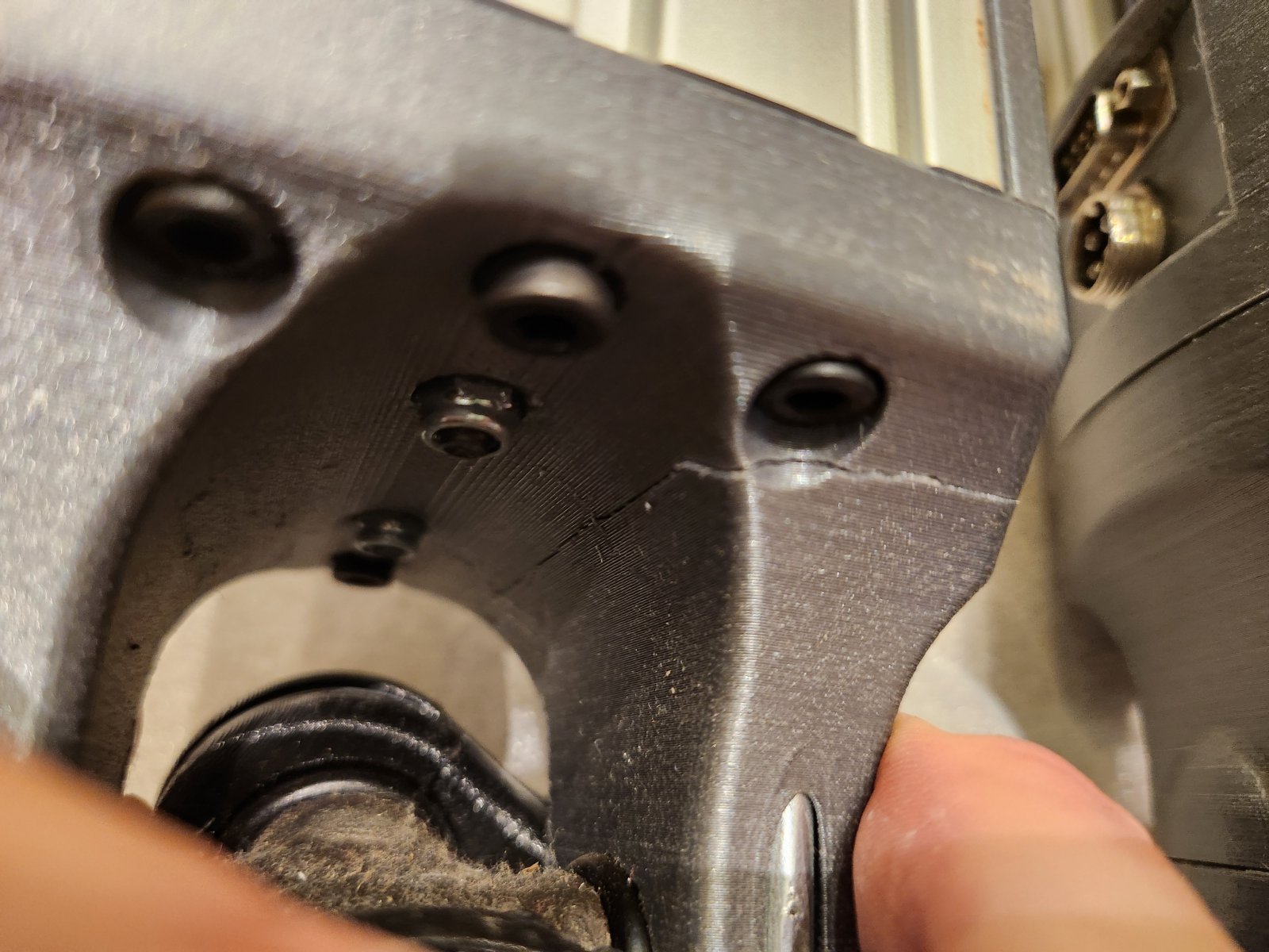

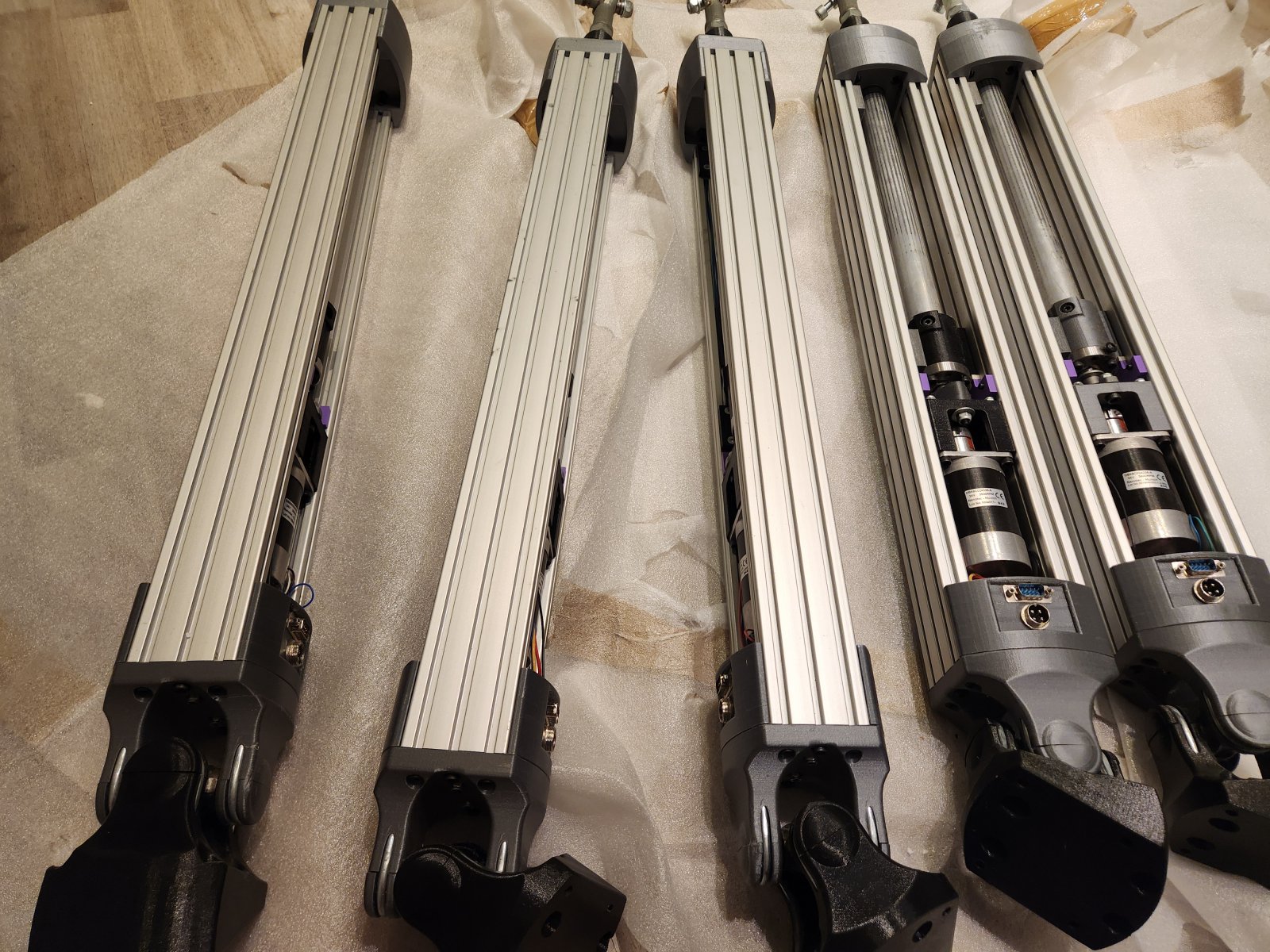

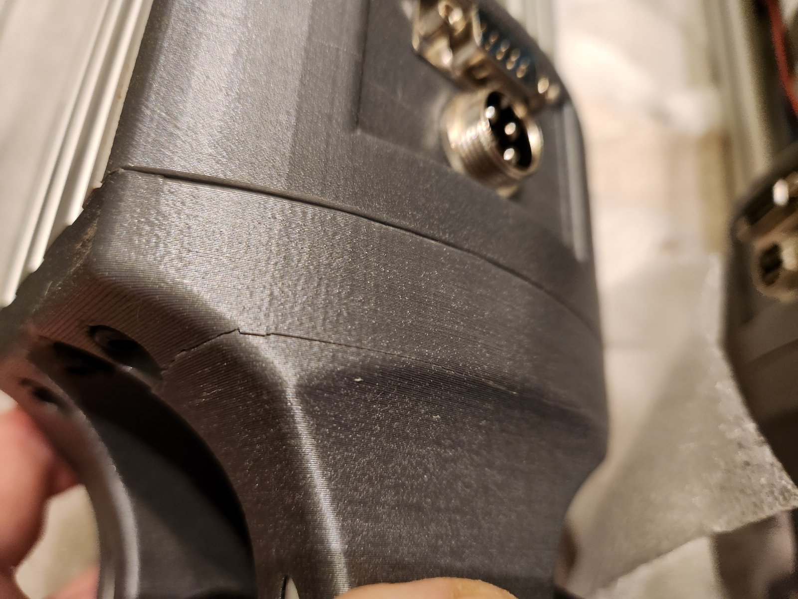

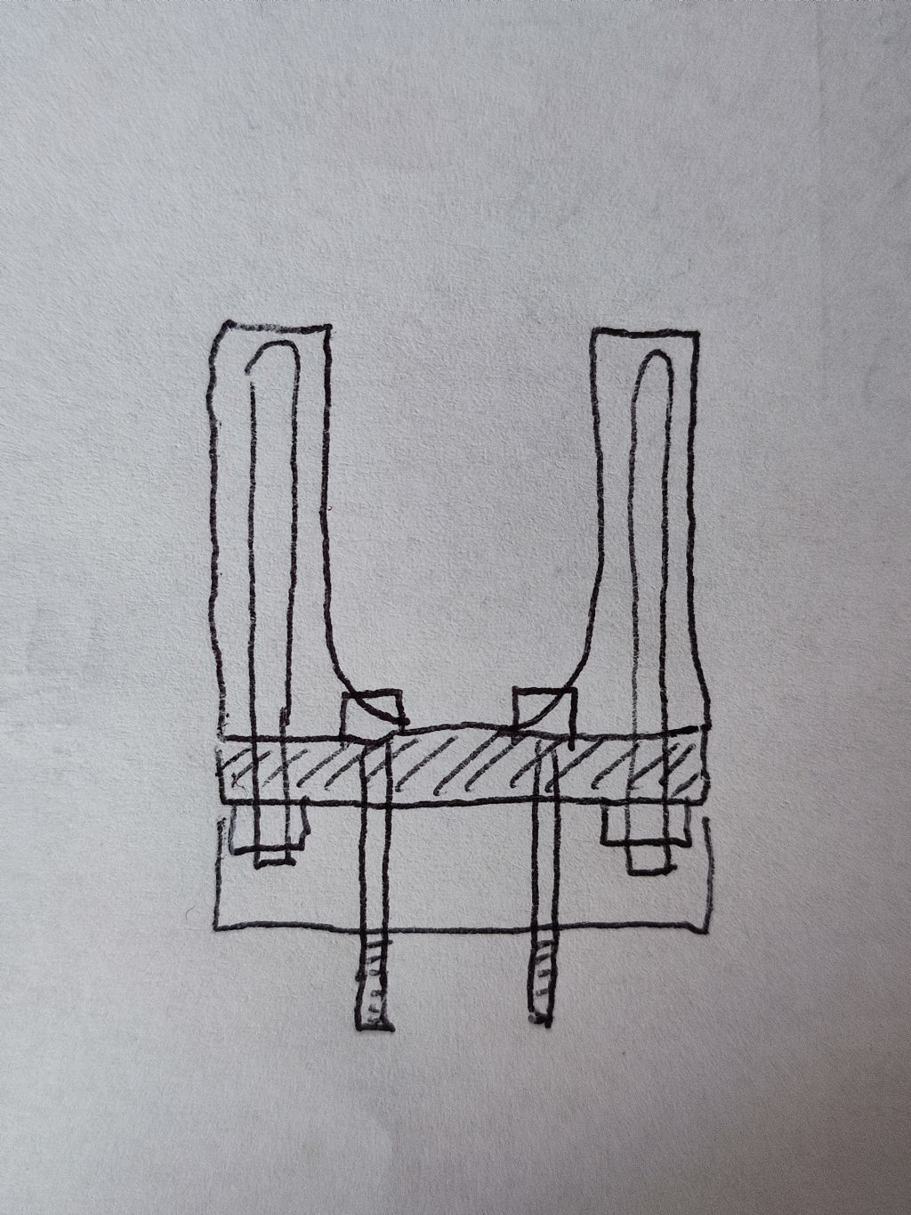

    Today I received the package from the seller. Well... even when buying from such sites, you have to be very careful!!!
    4 out of 6 actuators are broken at the base. It’s impossible not to notice this before shipping.
    Apparently, that’s the main reason why they were sold — the bases can’t handle the load and keep breaking. The 3D-printed actuator bases just crack apart.
    This is a very dangerous thing, and if I hadn’t checked it first, who knows what could have happened if someone tried to use it…
    The seller clearly knew about this issue. I’ll try to attach some photos here if possible.
    But I’m really disappointed — it feels like money thrown away.
    Even if I reprint these parts and replace them, the same problem will happen again soon, since the bases are already cracked in the same places on two more actuators — it’s only a matter of time before they break as well.
    In short — don’t trust anyone! I’m sure the seller won’t want to refund me, because there’s no way he didn’t know about this defect from the start and just hid it.
    Now I’m going to write to him…
  11. Mech1
    Mech1 Member
    Sep 28, 2025
    31
    178Coins
    More photos
  12. Gabor Pittner
    Gabor Pittner Active Member
    Oct 25, 2018
    203
    Szekesfehervar Hungary
    1,396Coins
    +89 / 0 / -0
    Oh my God, I can’t believe this! I packed perfectly intact, undamaged actuators. They must have been damaged during shipping.
    The 3D-printed parts can easily withstand that level of stress. It would never be my intention to deceive or mislead anyone.
    I’m offering to reprint those parts.

  13. tadeusz
    tadeusz New Member
    Nov 4, 2025
    34Coins
    I think it would be best to make these supports out of metal.
    Best regards,
    Tadek

  15. Aerosmith
    Aerosmith Active Member
    May 30, 2024
    490
    self employed
    2,887Coins
    +292 / 1 / -0
    3DOF, AC motor
    The design of the actuators look actually quite good and solid. The location where the U-joint brackets cracked seems to be the only weak spot. I'd try to re-print them 90° rotated. That will require support material since the upper half of the fork will be floating. But it means the printing layers will be aligned to the direction of the pull force instead of a right angle which caused de-lamination.
    If that still doesn't help you could divide the part into two errr... three pieces and insert a metal plate in the middle. This would easily withstand a lot more force.

  17. Gabor Pittner
    Oct 25, 2018
    203
    1,396Coins
    +89 / 0 / -0
    Yes I have, but now I try to find someone who can make it from alu with CNC.
    And we have different idea too. The buyer is thinking about alternate ball joint solution. I will pay for it of cource

    Now I can see what happened but I have never checked those parts with make force, ... so Honestly I have not known about it. :(
