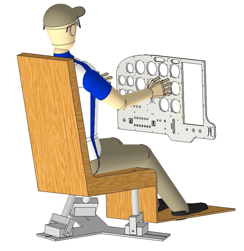

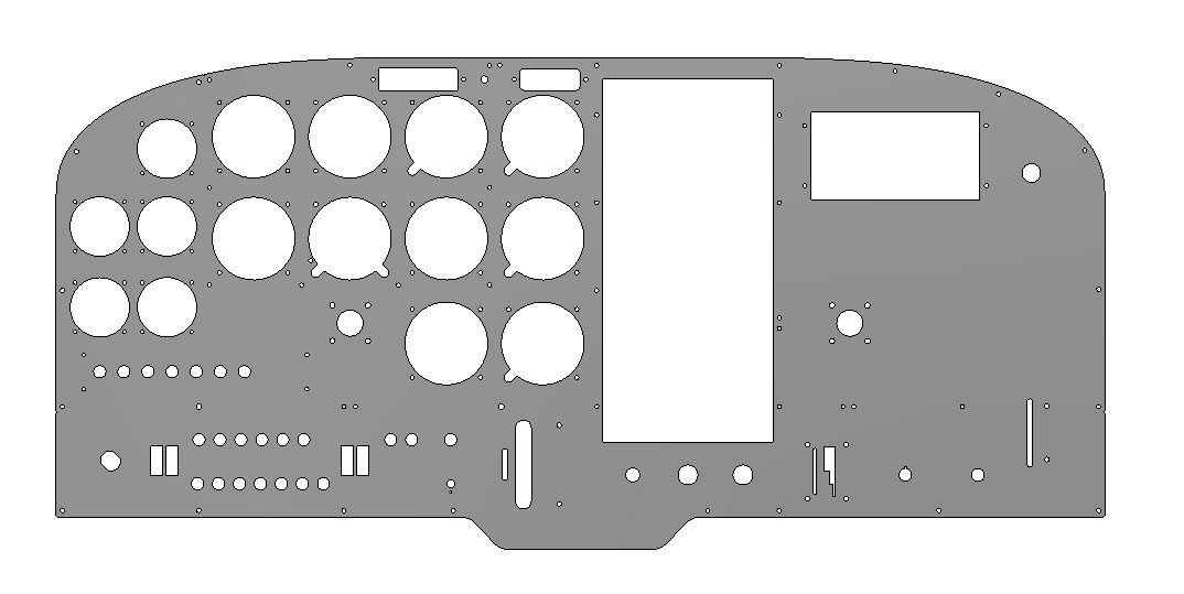

    The Idea is to build a 3DOF Platform with Cessna 172 Hardware Cockpit for MSFS 2020.
    First I downloaded the Instrument Panel
    Then I draw the dimensions

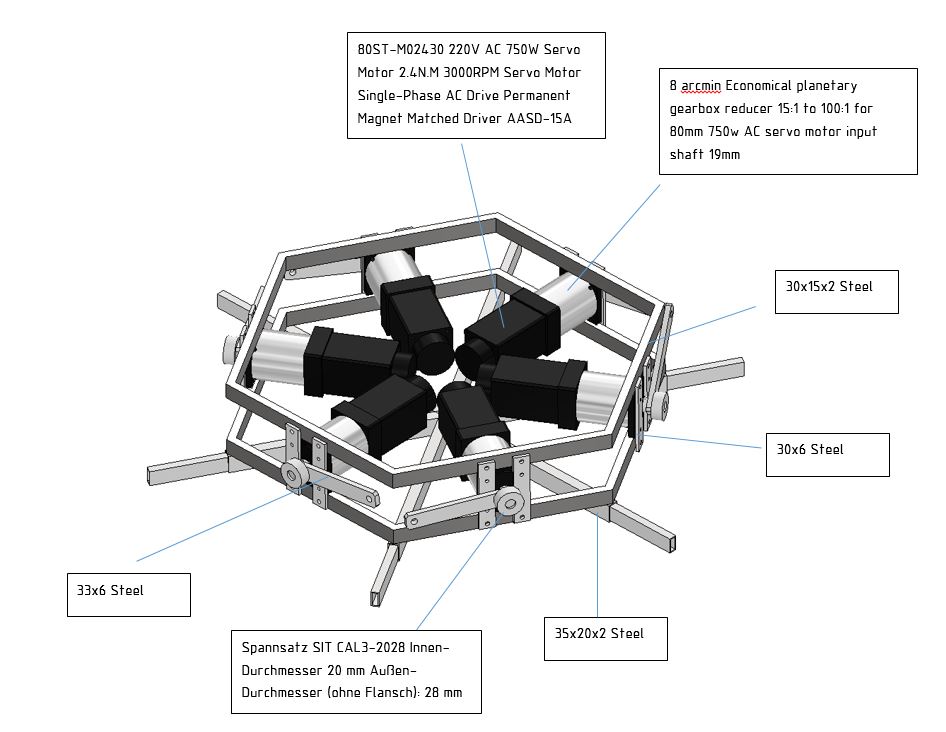

    Things are getting shape.
    Cheap looks different, but it should work and last long.
    Now it´s time to detail my CAD Model of all getting together.
    Did I forget any important component in my scheme?

    You got the basics covered :thumbs
    You also need to add db25 straight male-male cables for interfacing the AMC-AASD15A with AASD-15A servos. And perhaps get some RFI line filters for the power entry of the servos to filter noise back to the mains line. And if the power cable of the servos is not shielded, you could replace it with shielded cable to avoid EMI noise to your rest of the system. There are videos documenting all these, if you have trouble locating them on my YouTube channel, let me know to help.
    Good luck! Cockpit looks good!

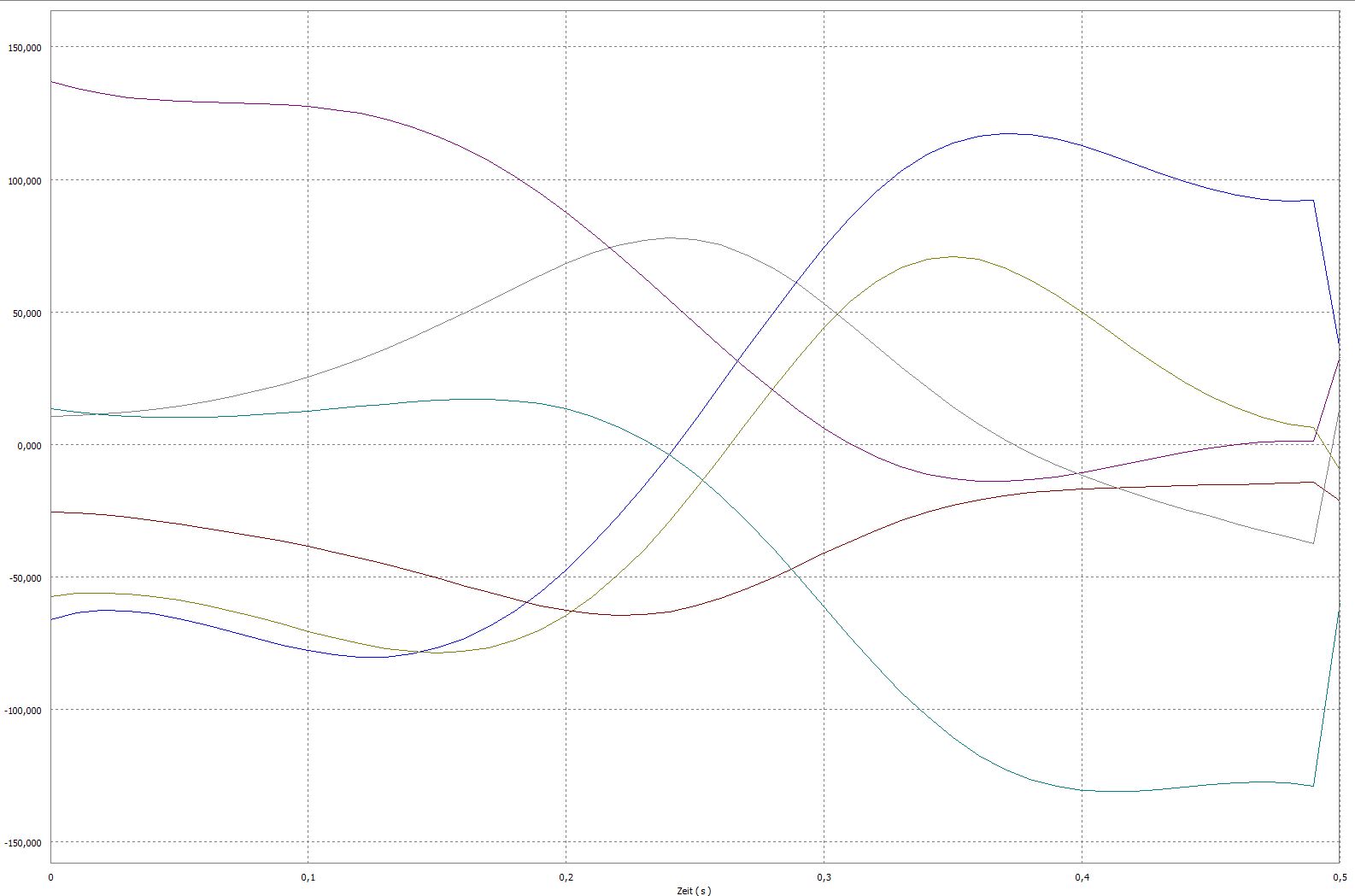

    I did in time my first mechanical calculation concerning the forces. The waves is a result of still free rotating Motors, I have to fix them later on.
    First calculated Z travel 100mm in 1 second.

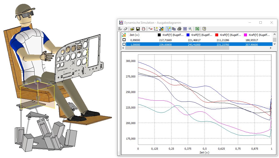

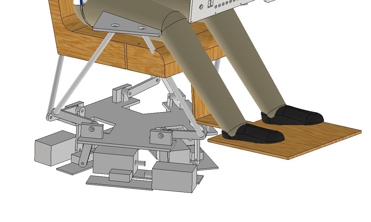

    From step to step I approach the typical design with single levers attached to a gear :/
    In the picture I made a design with 90° levers actuated by linear stages under connected with rods to the levers (not shown)
    But The price is the same when I take worm gears or planetary gears.
    So perhaps I do it like all other and make a Platform with Levers.

    Beware the worm gearboxes have naturally more backlash than planetary gearboxes...

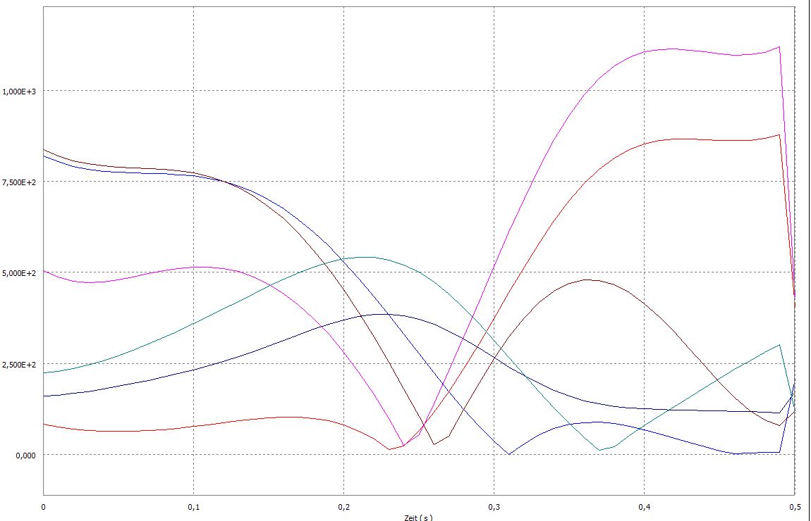

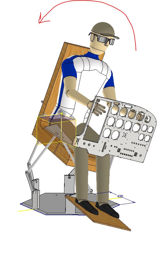

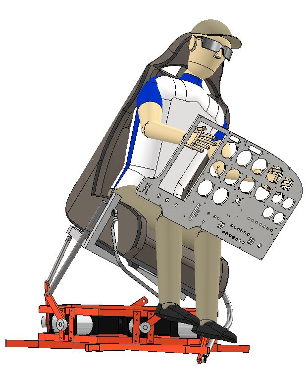

    My newest calculation show the moment of levers over 0,5s from Pitch/Roll +20°...-20°
    The motors should have 3Nm at 2000 rpm minimum (using 50:1 planet gear). Ui....
    I think I can begin order the Motors which most of you simmers use ;) (AC 750W Servomotors)

    If I take:
    80ST-M02430 220V 750W AC Servo motor 2,39 N.M. 3000RPM 0,75 KW servomotor Single-Phase
    There is an Option with "Modbus" do I need that?
    What I have to check that it is compatible with Thanos AMC-AASD15A?
    I will not waste 1000 Euro to buy the wrong stuff.
  10. Thanos
    Jul 6, 2017
    1,371
    Electronics Engineer
    United States
    2,854Coins
    +1,072 / 10 / -0
    There is no need to get the modbus version... all control is done via the DB25 connector. Make sure the drive is AASD-15A and the motors have shielded power cables (to avoid EMI woes).

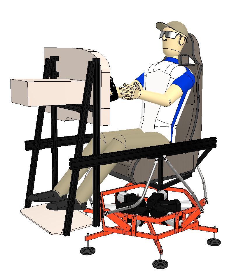

    Ok, time runs. But now I have my first Motor with Driver on the table.

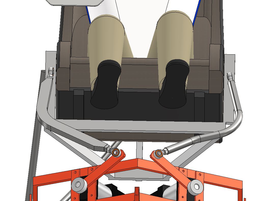

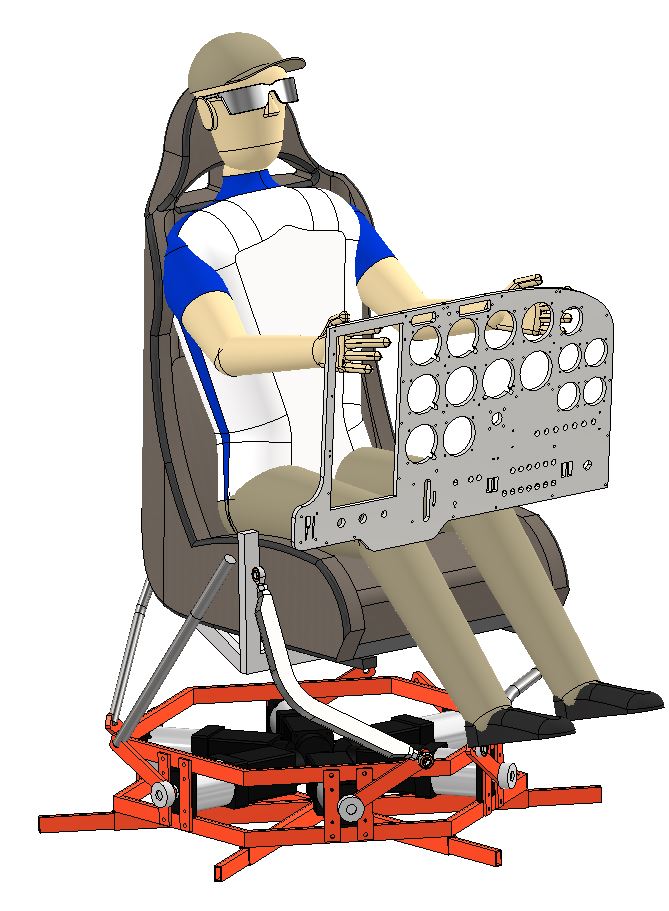

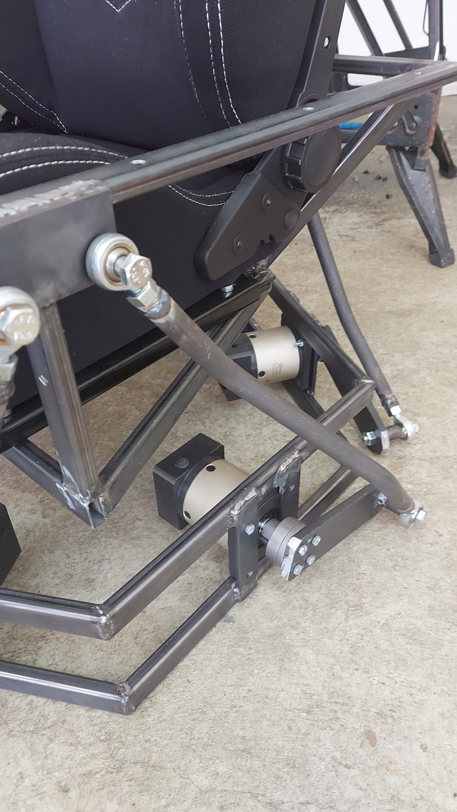

    Now it´s time to start designing the upper plattform. For this I calculated the forces of the joints Motion-rod to Plattform. All with double worst case scenario. 0,5s for the whole +-20° Roll-Pitch travel.
    Aditional thinking what type of bended Rod is better, rectangulat Tube welded or round rod bended...
    The goal is still to stay with 20° Pitch, Roll, Yaw and ultra compact in hight. see..

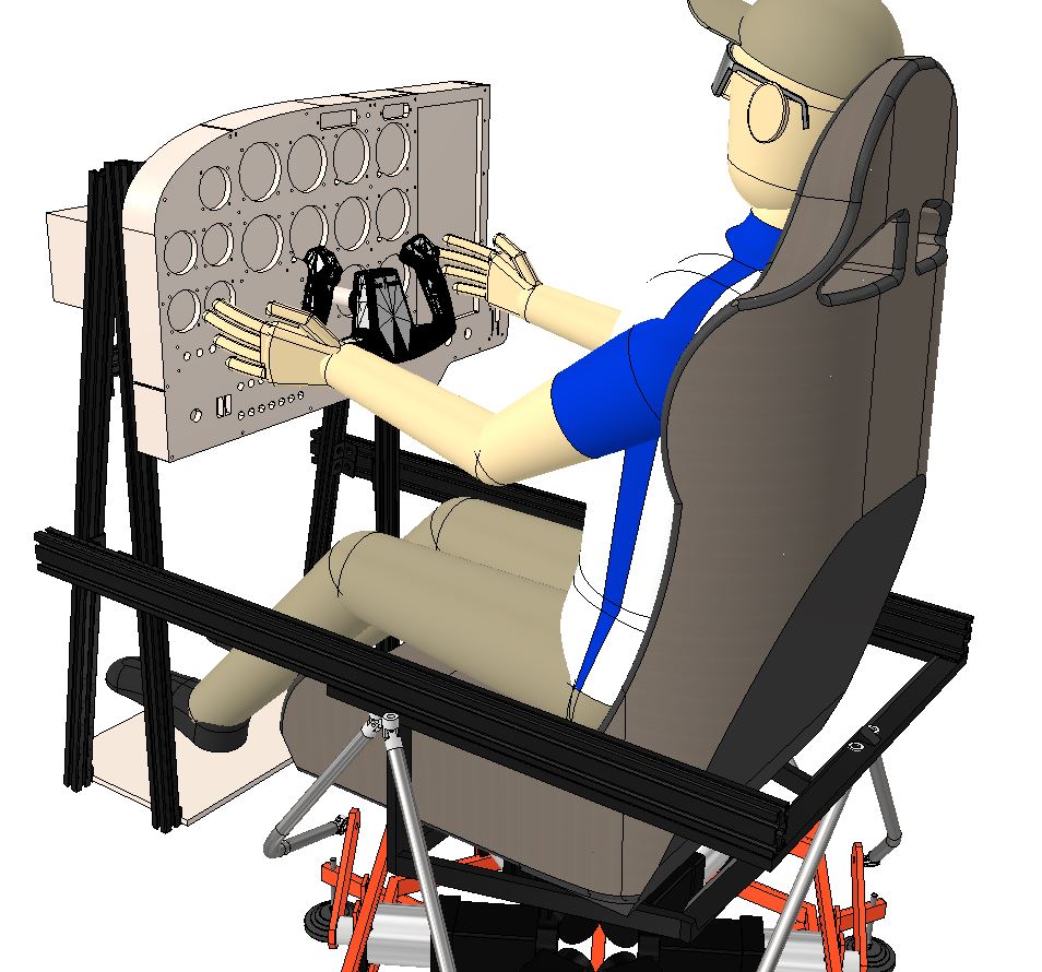

    In Progress with detail of Platform.

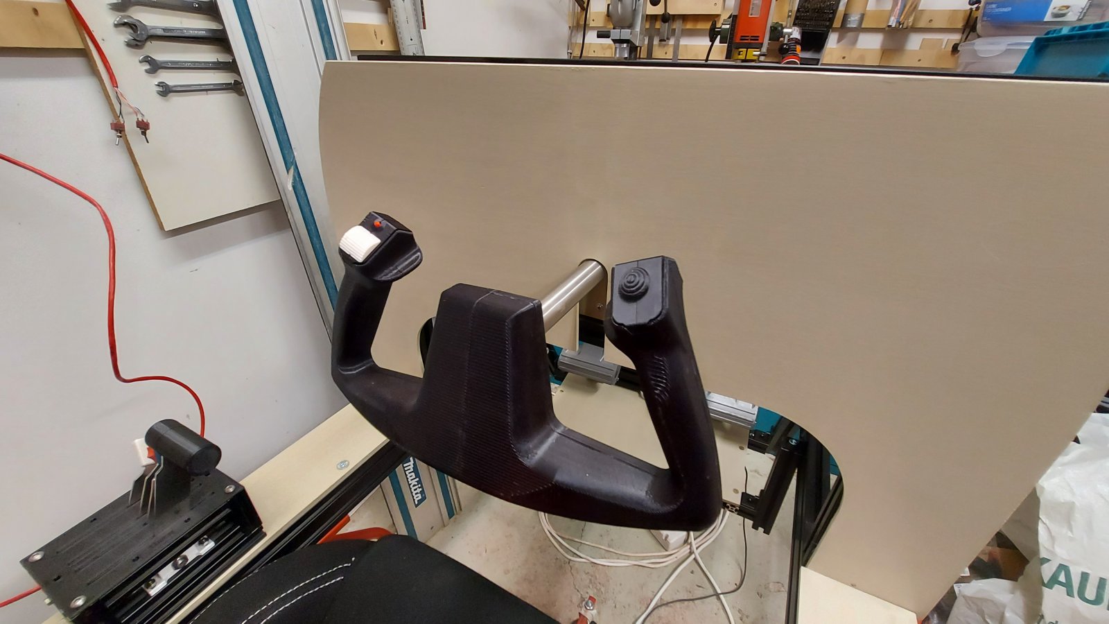

    Idea is to use Bosch profile to be maximum flexible when I change to Car or other Simulations.
    In last time I build my Forc Feedback Yoke from Jay.
    And did some Button and Slider work.
    Next days I will order a 6DOF controller Box from motion4sim.

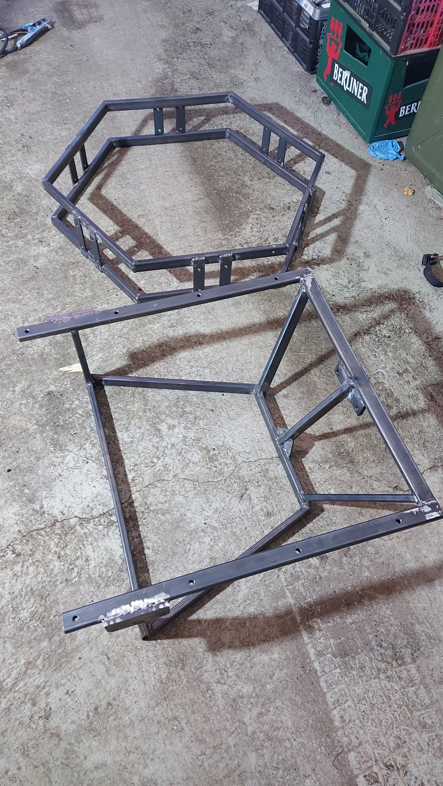

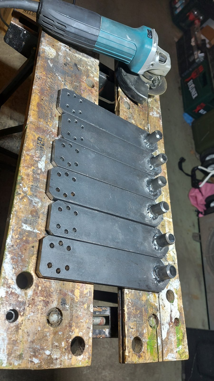

    Work in progress. Framework

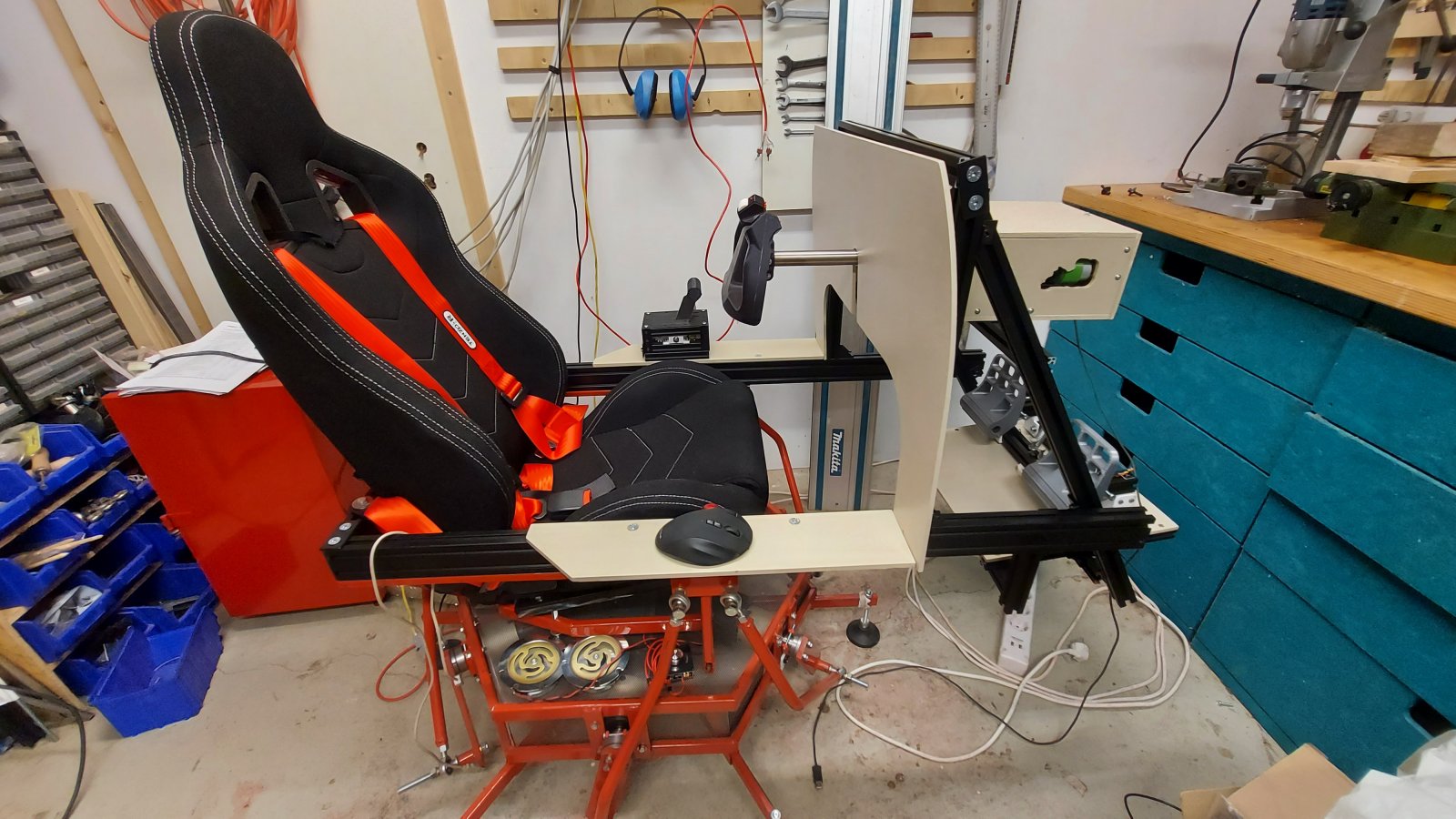

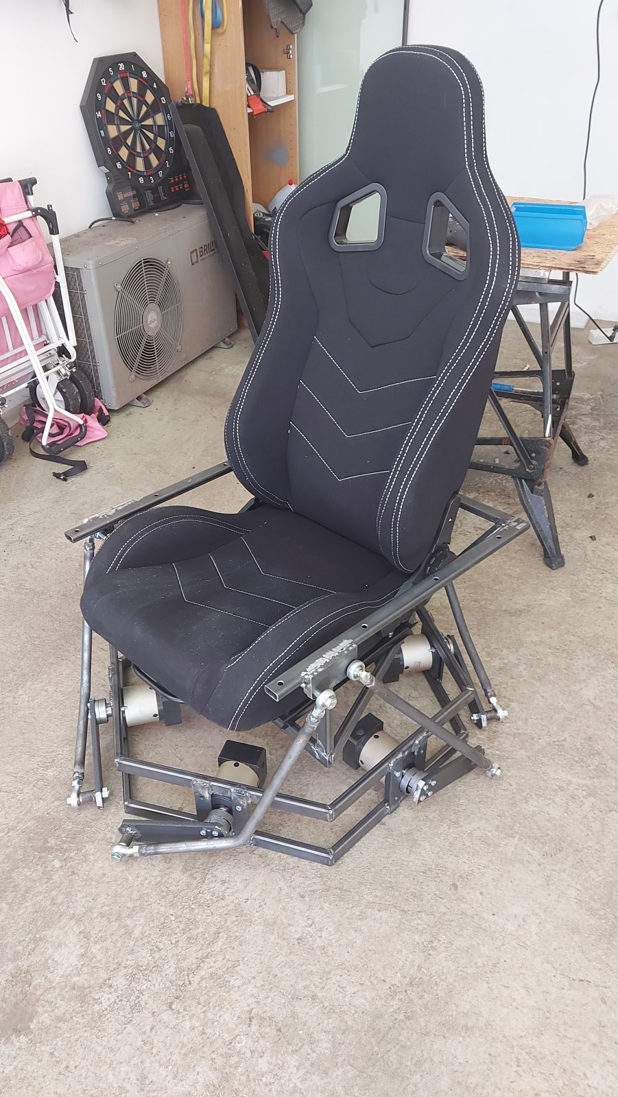

    Pre assembly.
    The support feet still missing. And the arms are hanging down. Default is 20° up.
    The main idea of my design is to have a compact design. More simpler designs are easyer to build, but are too hight for my little space.
    I ordered RAL 1303 red. :)
  17. RacingMat
    2,237
    21,050Coins
    Good work and thanks for sharing your build!
    IMO,
    - levers are too thin. While static, it could look strong but under acceleration, the stress will be great.
    - the bent lever will be prone to buckling...
  18. gaco

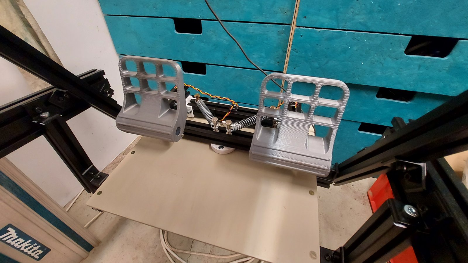

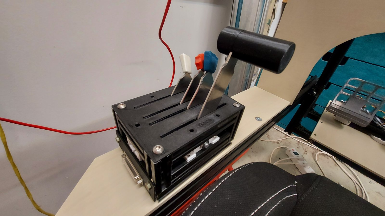

    Hi, time is running. I started to make it moving. Now comes the buttons and switches. Pedals and throttle quadrant I made myself.
    But! A total Cessna 172 is canceled. I make an universal thing with attachable G1000, Knobs and Switches attachable with dual lock valcro.Comming soon
    Achso, Butt Kicker will have too. theese cheep ones...
    The hole in the Yoke box is an accident... this will be replaced, or a sticker attached...
    @ Racing Mat: Its 20x4 Steel tubes, bended with hydraulic tube bender.
    Anyone an idea how to make speed dependent wind with a venting thing? i use FlyPT
    • Like Like x 5

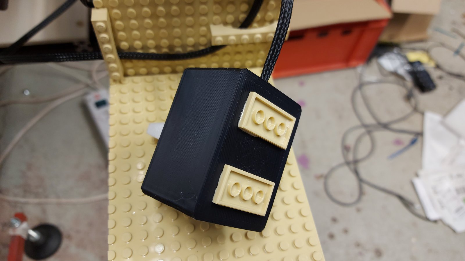

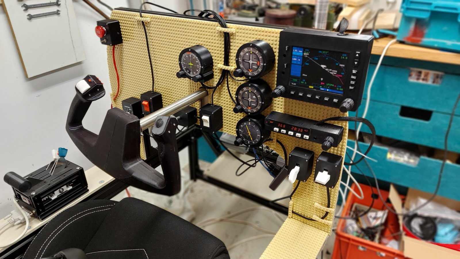

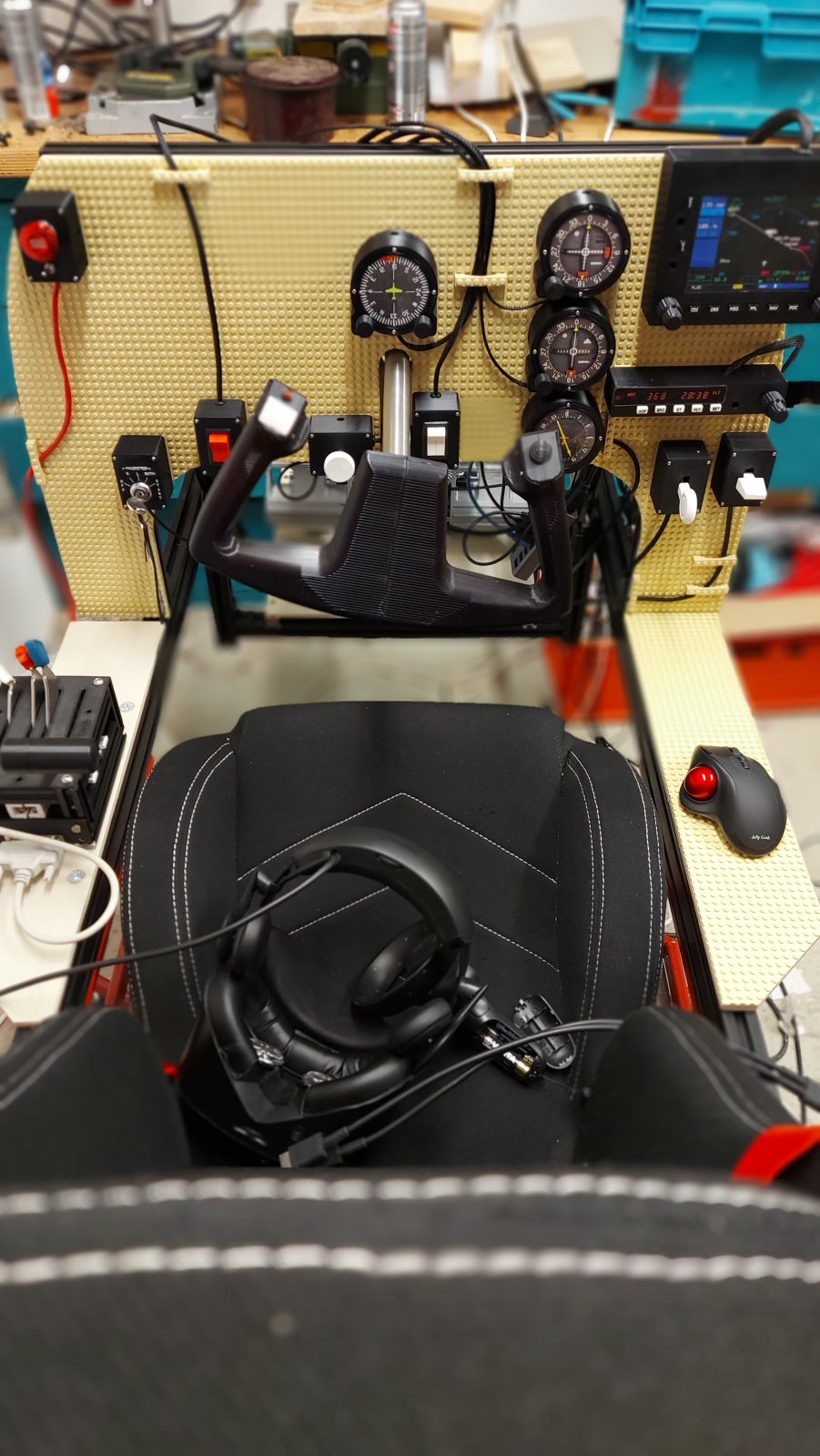

    An other update on my Cockpit. I wanted to use valcro but ended with Lego :)
    G1000, G430 and AP is following.
    What Aircraft I use, I can change position of devices.
    With SPAD Next all buttons working.
    Selfbuild Buttkicker.
    Wind simulator comming next.
