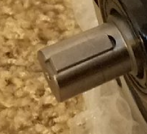

    There are no threads on this motors shaft. It is 5/8" keyway by 3/4" shaft. Unless I'm missing something in your explanation.

    @bruce stephen you are correct. We're you able to hand turn your motors?

    That little hole

    Ah ok it's not threaded but could be tapped.. It's about m3.
    @BondeX yes with leverage. Once I put the levers on it isn't too difficult to turn the motors

    Are you going to weld a lever on the side of the coupler then? My thinking in the above post was to weld a piece of flat bar steel for a lever on the end of the coupler. Then you could do as I said previously using a 5/8” drill bit put thru the coupler to find the center point thru the lever, then finish drilling the size you need to attach a bolt to clamp one end of the pot coupler to.
    I think you will find the motors shaft does not have a hole on the end but just an indentation at the center where it was attached to a lathe when turned. If so you will have to drill it deeper, tap it, and then the rod you thread in could still turn unless you thread lock it into place.

    the hole is 4mm deep on my test motor. it will need to be drilled deeper and tapped.

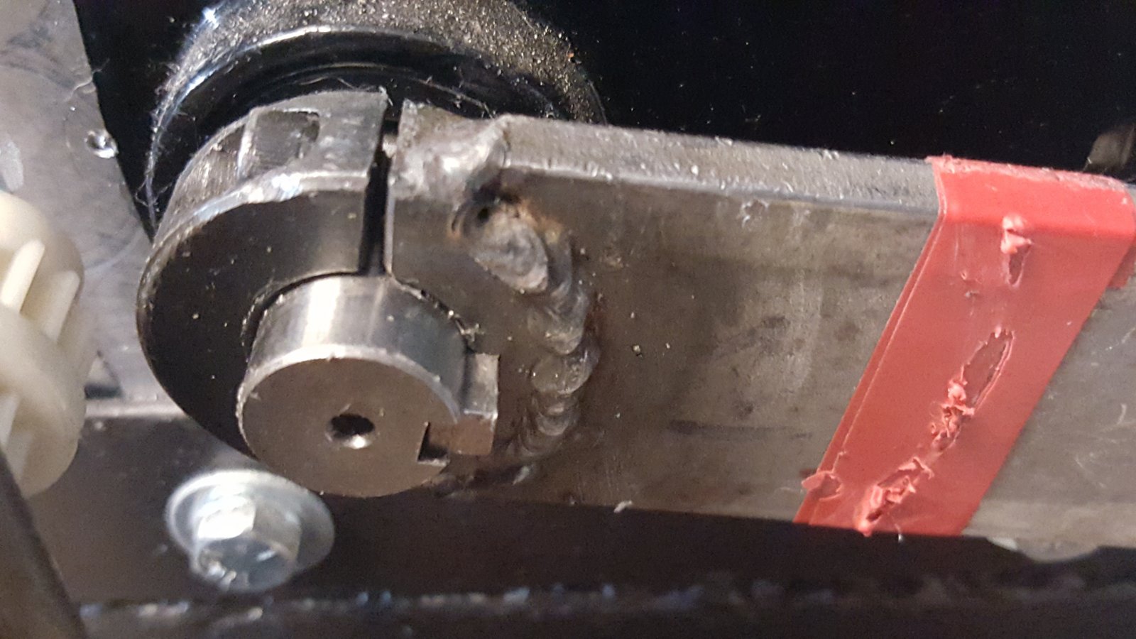

    this is a coupler with a piece of flat bar welded to one half
    EDIT: this is a collar not a coupler as @BlazinH points out below. :think

    I see you are using a locking collar @bruce stephen so you wouldn’t be able to weld a piece of flat bar to the end and still lock it down. BondeX stated he ordered couplers and they just use setscrews. I think the use of a locking collar may be a better way of doing it vs. a coupler though. Due the fact that we are constantly reversing our motors setscrews have a tendency to work themselves loose. If they get a little loose it will start wearing the corners of the key out when the coupler starts moving around too causing more play to develop. I suppose it will depend if the stresses in BondeXs case are enough to start working the setscrews loose or not. Or maybe some thread lock here too.

    @BlazinH I was thinking the same thing and am also worried about the coupler getting loose and falling out.
    So I was thinking of drilling a hole through the coupler and the motor shaft and securing it with a clevis pin. I think this would work, wouldn't it?

    Been there, done that! I used a bolt instead of a clevis pin though. In my case I had two holes and two 5/16" bolts but the stress I put on them even sheered the bolts. I even tried grade 8 bolts. But I was heaving 300lbs so you won't be putting anything close to that amount of stress on yours.
    What would work best though is if you cut your couplers length shorter than your motors shaft by about 3/4". Then weld a piece of 1/4 flat bar on the end of the coupler. Use a 5/8" drill bit and drill all the way thru your lever thru the coupler. Now you can slide the whole assembly on the motors shaft with 3/8" of the shaft left sticking out the end and with 1/8" clearance on the other end so the coupler doesn't drag on the gearbox. Weld the lever to the motor shaft and your done.

    If the shafts are hardened steel then it not the best idea to weld them. I doubt they are though on such a low power motor.
    Whoops! Didn't check that.
    Best to just weld the lever on and omit the coupler altogether then (assuming it doesn't have plastic or nylon gearing).
