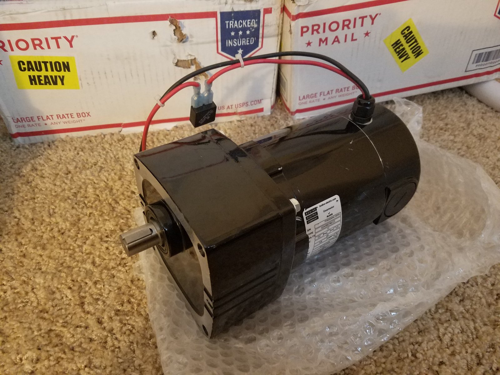

    Motors arrived :) There are very heavy duty motors, almost twice as large as wiper motors.
    Now, it says on them that they are gearmotors (60:1) so I could not turn them by hand so not sure how I will setup hall sensor.

    No stop pots so hook it up then adjust the pots to center with smc3ulitilies and 12 volt off. Once they are lined up you slowly add power to see if they chase or run from target. That's how I did it anyway.

    You should use that threaded end on the shaft. You can place a threaded rod through here and then have a coupler that connects the threaded rod to the hall sensor
