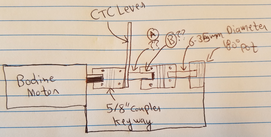

    the Fancy 180 hall effect Pot output shafts are 6.35mm in diameter. The other end of the Coupler will depend on the motor/Configuration your running.
    Click on "Datasheet" when looking at technical components as such and it will give you Everything.

    I agree 1/4" pot shaft and then direct to your motor or you will have to fashion a connection on the motor side. I recommend you drop the FS (flat shaft) spec on the end of your hall pots and just use a round shaft instead.

    A/B which are the same can be what ever the heck you want it to be, Couplers come in all shapes and sizes.

    First get a 1/4" on both ends pot coupler. Then if you have a 5/8" drill bit weld your lever on the motor coupler first. Then stick the 5/8" bit thru the coupler and drill in enough that you have a good indentation in the center. Then use a 1/4" bit and drill the rest of the way thru the lever. Now put a 1/4" bolt in thru the coupler and lever and use a nut on the outside of the lever to secure it. Now you can attach your motor and pot to your lever. If you don't have a 5/8" bit you may want to drill the 1/4" hole in your lever first and then make sure its centered somehow before you weld it to the coupler.

    Thanks @BlazinH, took me a good minute to absorb what you suggested :) It will work. Thanks a lot
    Not finding the round shaft 180 pot. Thats what I originally wanted.

    While it shouldn't matter, if you don't want to cinch your pot coupler down on bolt threads, you could instead use a smooth shank 1/4 bolt, cut the threads it does have off, and weld it to the lever instead of using a nut.
