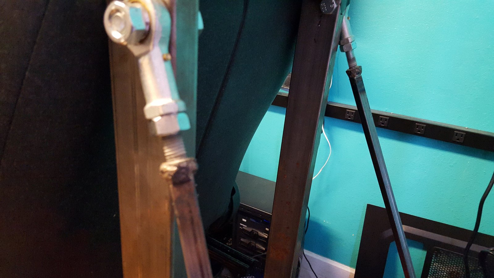

    Also I notice the threaded rod, I started with it and bent it. ended up going with small square tubing with proper sized bolts welded to the ends. less expensive, stronger and lighter as the tubing is hollow. Although the weight difference is so small it really doesnt matter.

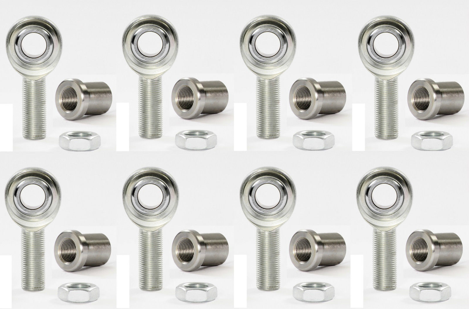

    OK will order MMs, Ards and ball joints today.
    @bruce stephen, what size threaded rods were you using that got bent?

    m12, but now i have hardened bolts as ends not soft steel.
