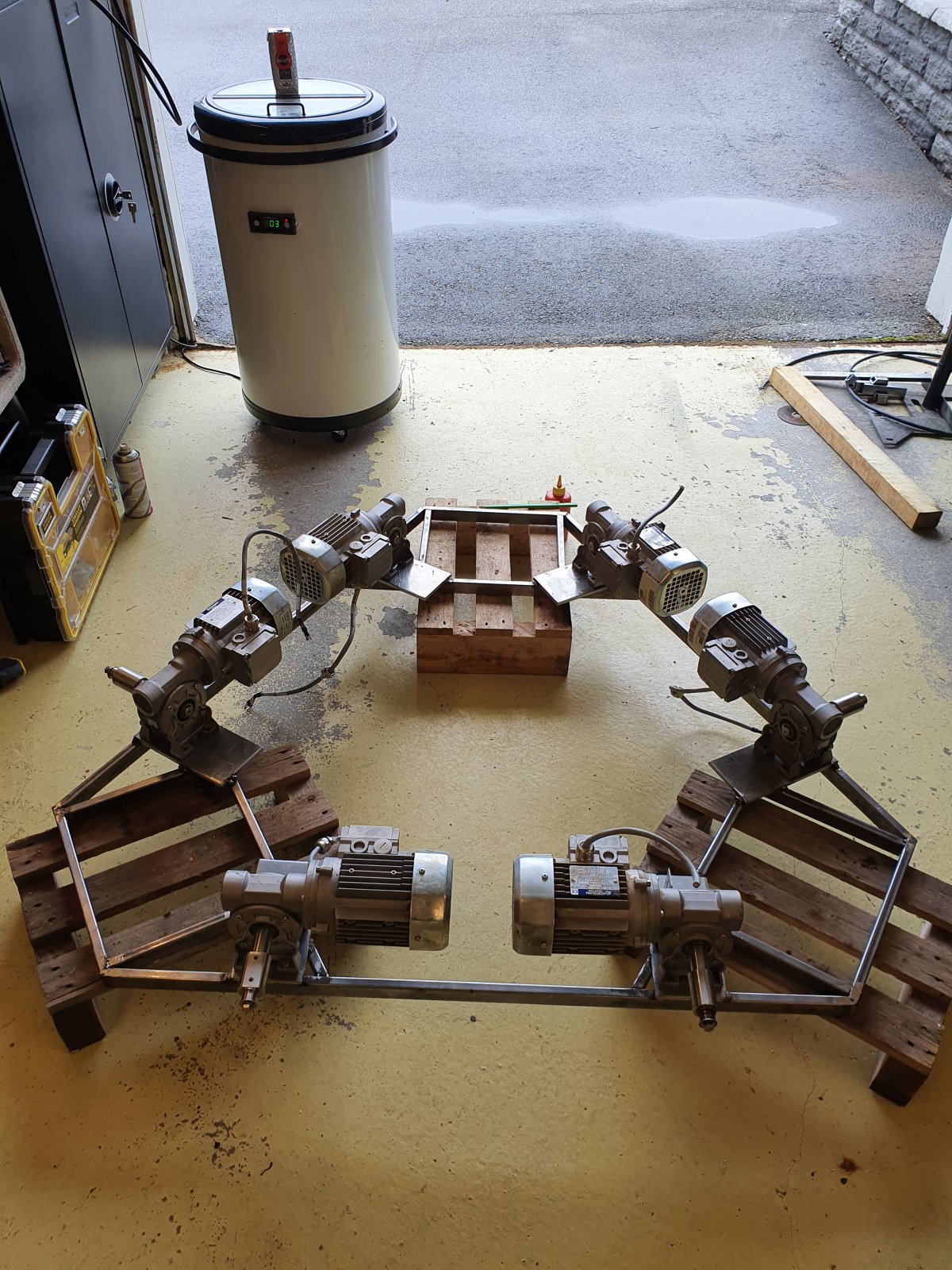

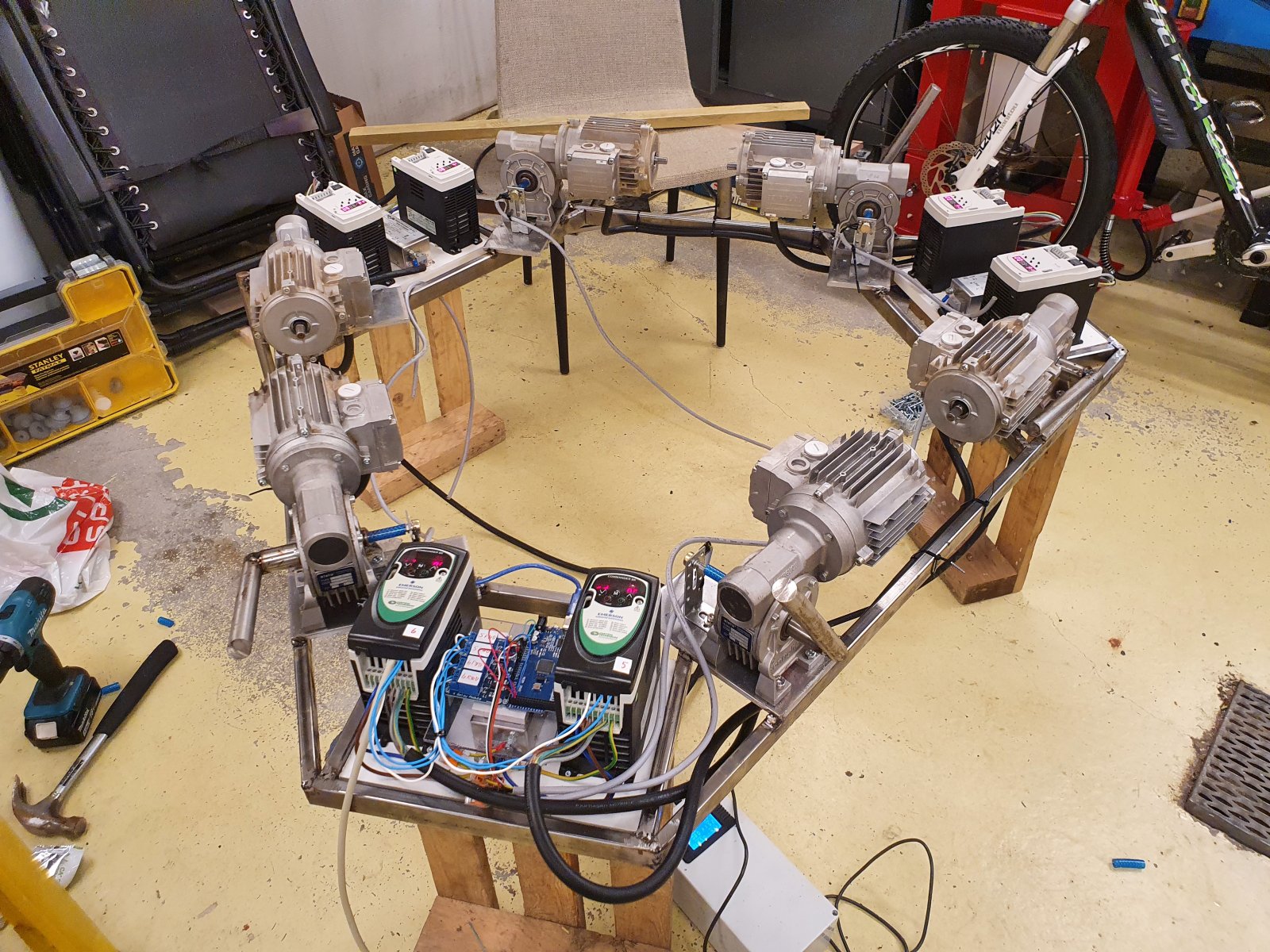

    Got my hand on 6 powerful motors with worm gear, so I went for a 6dof this time :) the motors are 1500rpm to 32rpm with the gears. Im trying to get this to work without the pwm to 0-10v converter. Im using a servo to turn the built-in speed potmeter on the vfd's. I just powered up the arduino with the code to check direction and calibrate potmeters. A bit worried for the testing with the top platform attached because the motors will rip it apart if they are not synched :grin

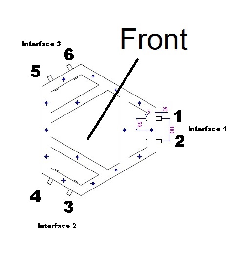

    I have calibrated all pots and directions now. Got three interfaces with two motors each. And a 2DOF setup on each interface like the picture shows. What should i write in "Startup Output" "Interface Output" and "Shutdown Output" on the seperate interface settings in Game Engine? After that I just enter all the different axes, and test with % and Direction ?
    21,581
    151,100Coins
    Startup and Shutdown can be configured later once you know everything is working: https://www.xsimulator.net/community/faq/startup-and-shutdown-positional-controls.234/
    Grab a copy of the SimTools Manual and keep it handy for reference: https://www.xsimulator.net/community/faq/rtfm-start-with-the-official-simtools-documentation.117/
    How you configure Interface Settings depends on the Hardware/Code you are using.

    Thanks noorbeast! Ive read the Manual and the other projects, but I dont get the axis part. If Axis1a and Axis1b is Motor 1, then A and B are positive and negative movement from center position ? Then should i have Axis1a, Axis1b, Axis2a and Axis2b on the interface for Motor 1 and 2 ? And Axis3a, Axis3b, Axis4a and Axis4b on the interface for motor 3 and 4 ?
    how does the game engine know whats front and back on my rig? :think
    21,581
    151,100Coins
    A and B just designates each individual Axis, the DIR box being checked orange or not in Axis Assignments determines which way each moves for any designated axis allocation.

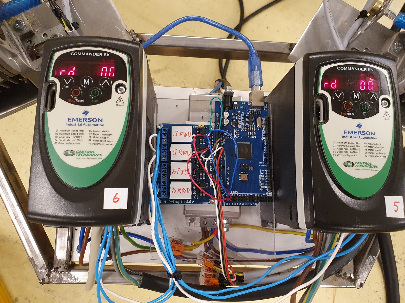

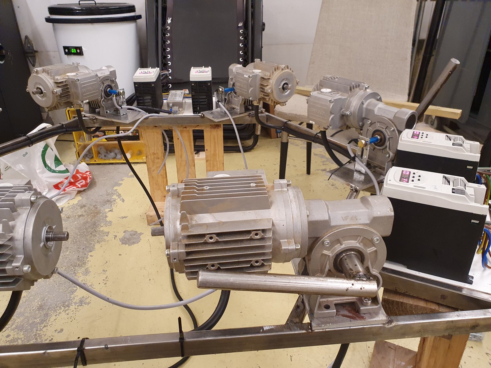

    Update; I now got a working setup with six 3phase 230V AC motors without any pwm to 0-10V converter. I got a Arduino and a relay-module with 4 relays on each motor. Two relays for direction, and two relays to change between 4 preset speeds. Got size of the gaps, motor speed and ramp time on the motor to adjust so it goes smooth.
    So, (sorry noorbeast, i did not get any further with reading the manual or checking the other 6dof projects) I got 6 interfaces, one motor and one Arduino each. Should I have "<Axis1a><Axis2a><Axis3a><Axis4a><Axis5a><Axis6a> on all of the 6 interfaces, or just <Axis1a> on interface1 and <Axis2a> on interface2 and so on?
    And on the Axis Assignment; I guess i should have like "sway" on all DOFs on one axis, And "surge" on all DOFs on the next axis ?

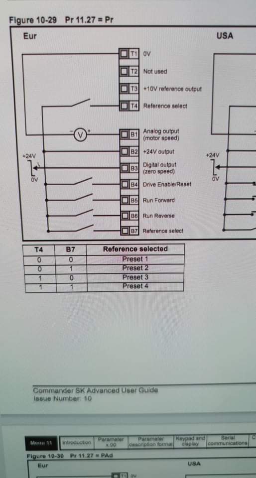

    No pid control :) yeah, I have some bad experience with converters like that from work, so I wanted to try without. Most vfd's has a program with preset speeds. Its just two digital inputs. 0-0 is one speed, 0-1, 1-0 and 1-1. You program witch speed you want on the different programs in the parameters. Can upload a video tomorrow if you want :)

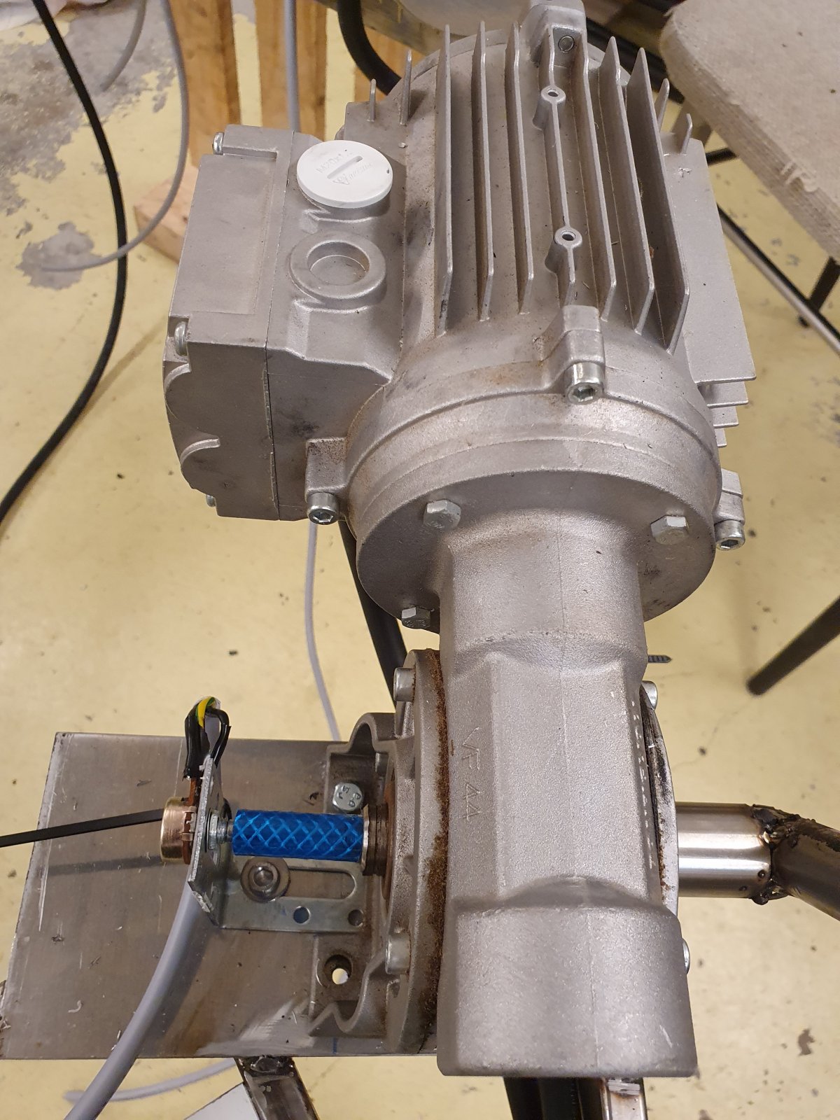

    Yeah.. pots for feedback. Almost all original code from racingMat. I just changed the "if gap > 50" to 50, 75, 100 and 150 to trigger the two relays instead of pwm. Ill attach a schematic of the selected program om the vfd. Do you have a idea of my question of the interface and axes?
