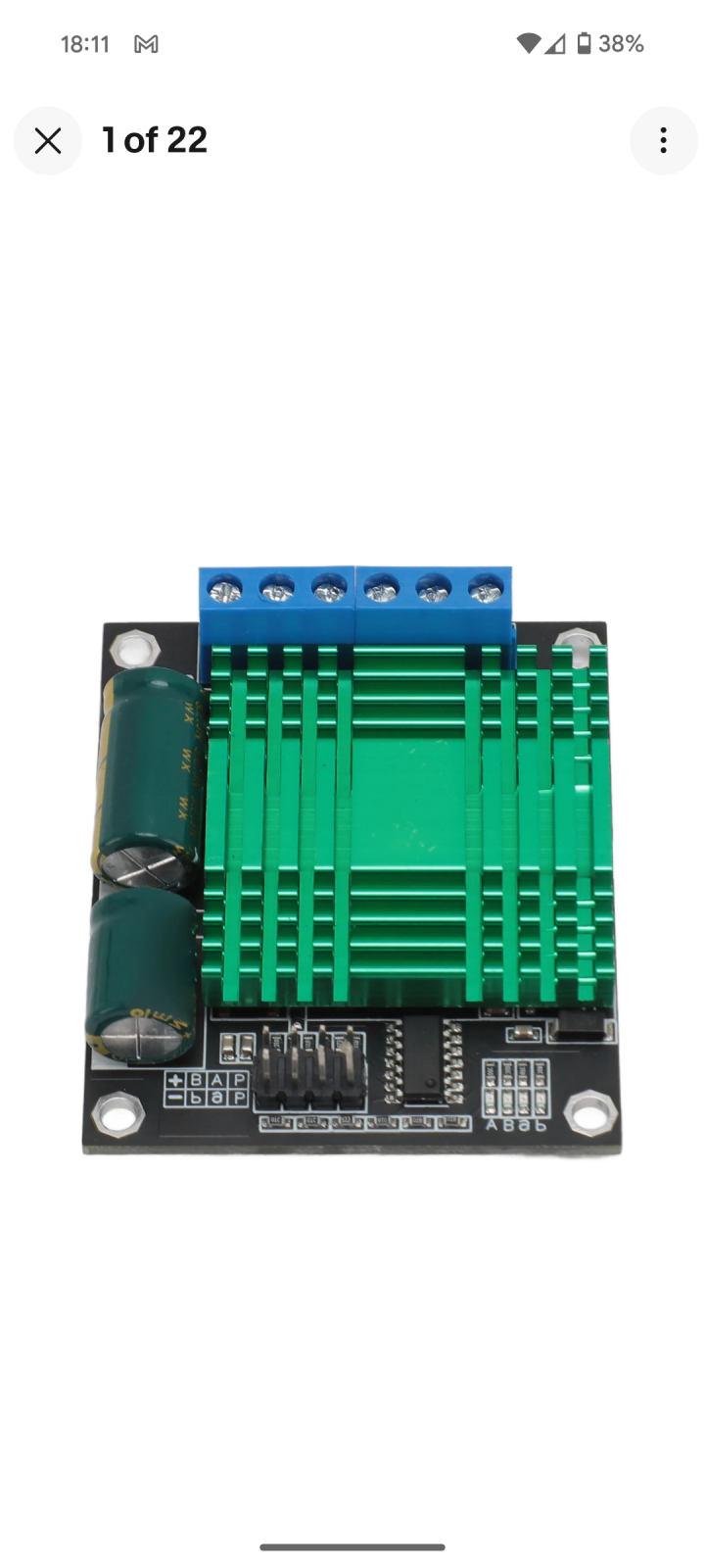

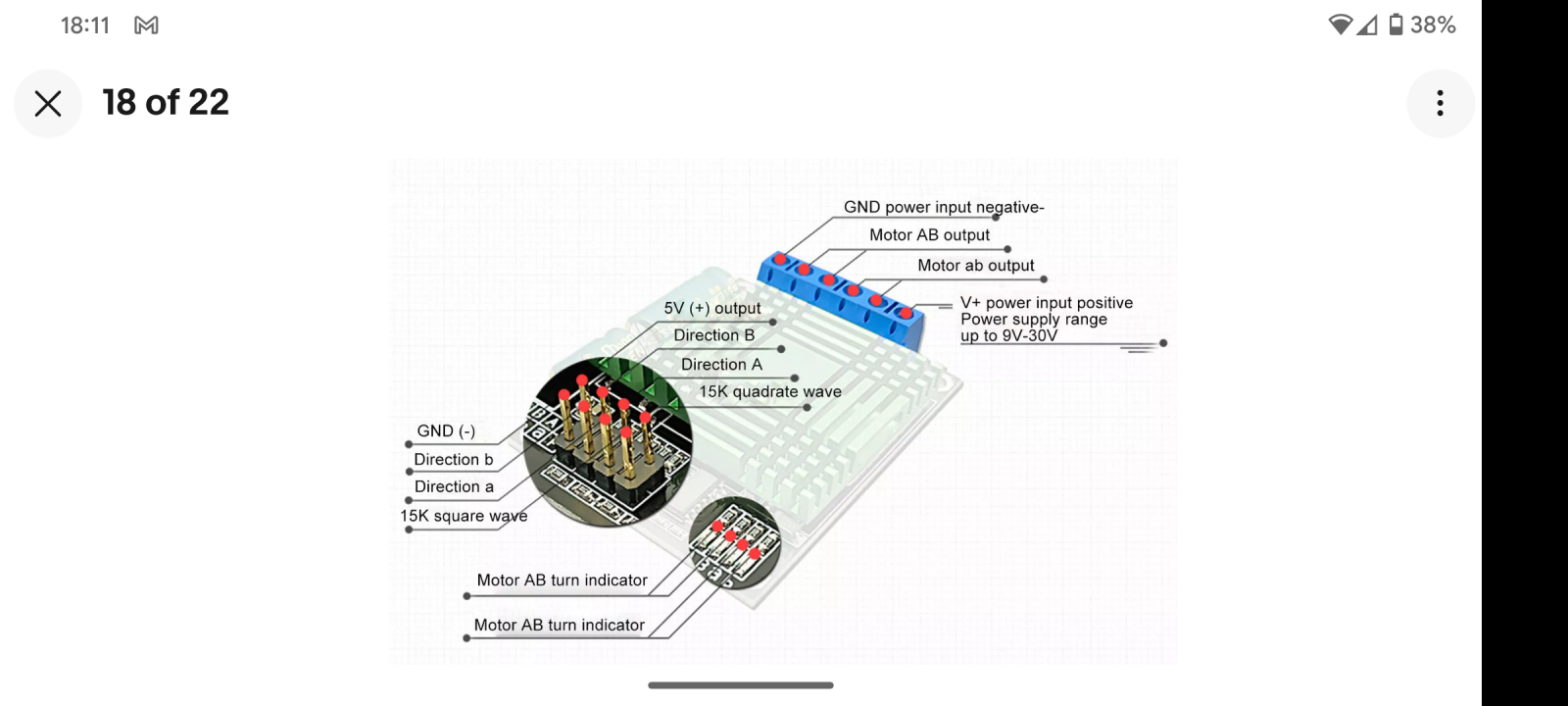

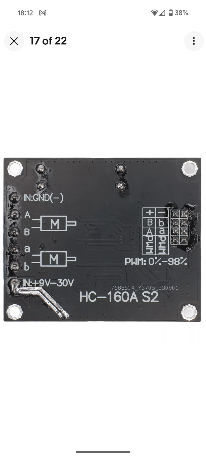

    Hi, I have purchased 2 x 60Amp H-Bridge boards to power each individual motor, however I'm not getting any output on the motor's, I'm assuming the wiring is different to the IBT bridges, does anyone have any information on what needs to connect where, pictured attached.
    Richard
