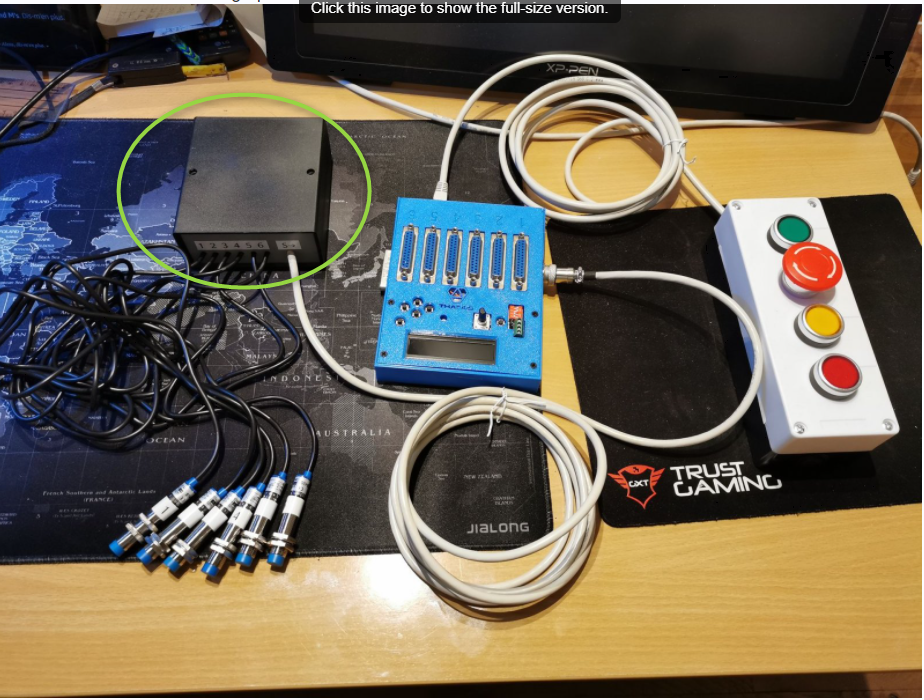

    Hall sensors? Where? These servos have encoders not hall effect sensors.
    If you mean the controller box where all the DB25 cables end up its this one on the link.

    Are you talking about this ?

    Right, with plugs for the limit/home switches wiring...

    Exactly and it works fine. :grin

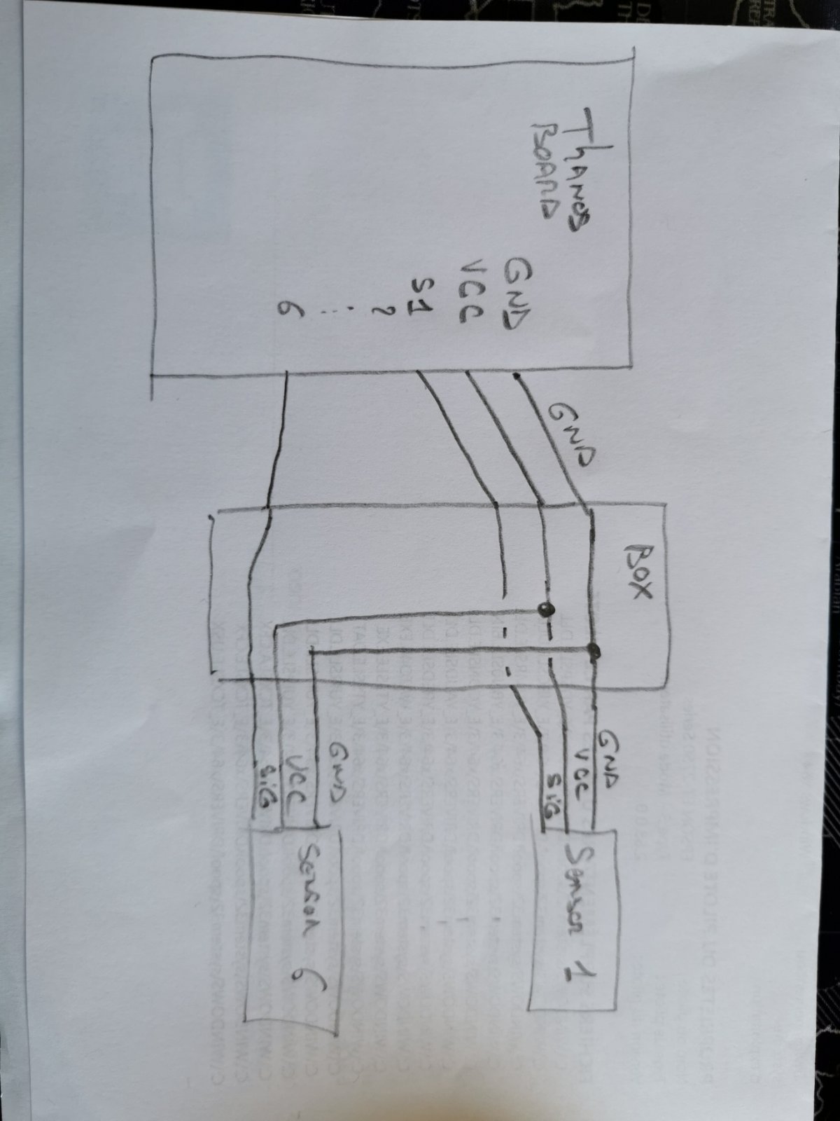

    Yes. can you show how they are there inside the connection?
  6. coyote
    coyote Member
    Nov 20, 2014
    58
    France - Yonne
    679Coins
    +72 / 1 / -0
  7. man05ru
    man05ru New Member
    May 12, 2021
    16
    53Coins
    2DOF, 6DOF
    [QUOTE = "coyote, post: 217609, member: 13922"] Очень быстро; -) [ATTACH = full] 84889 [/ ATTACH] [/ QUOTE]
    Thank you
