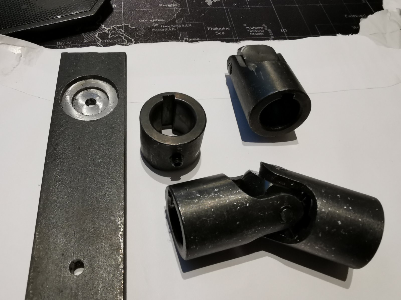

    50 days after the order, receipt of the Output Shaft Coupler Connector. Use of the grinder, to obtain two solder connectors.

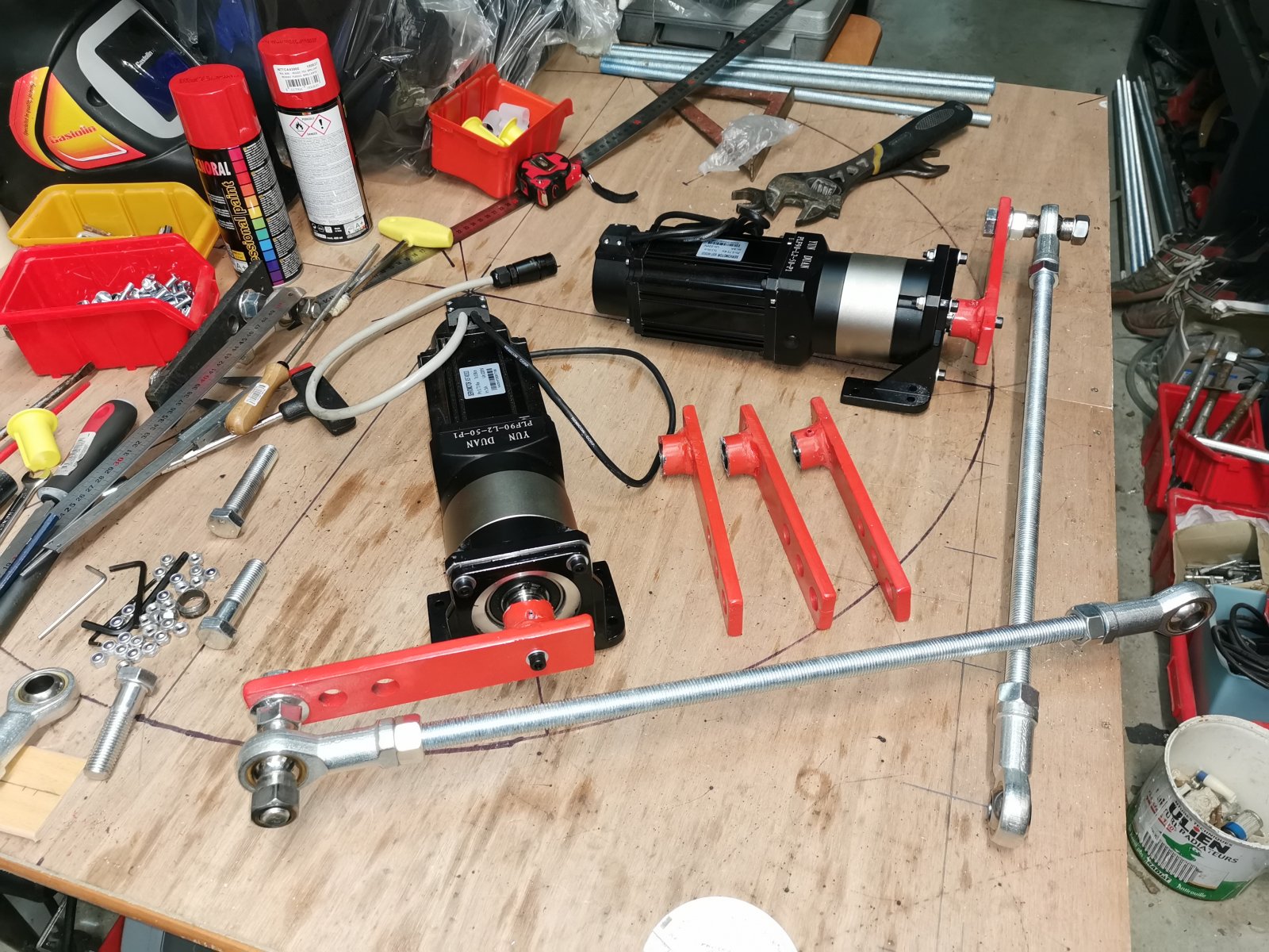

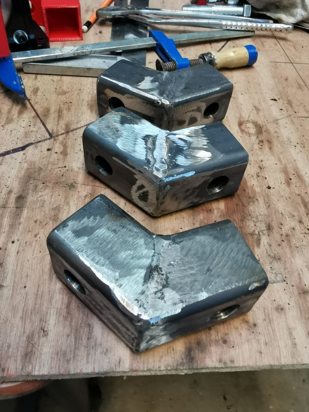

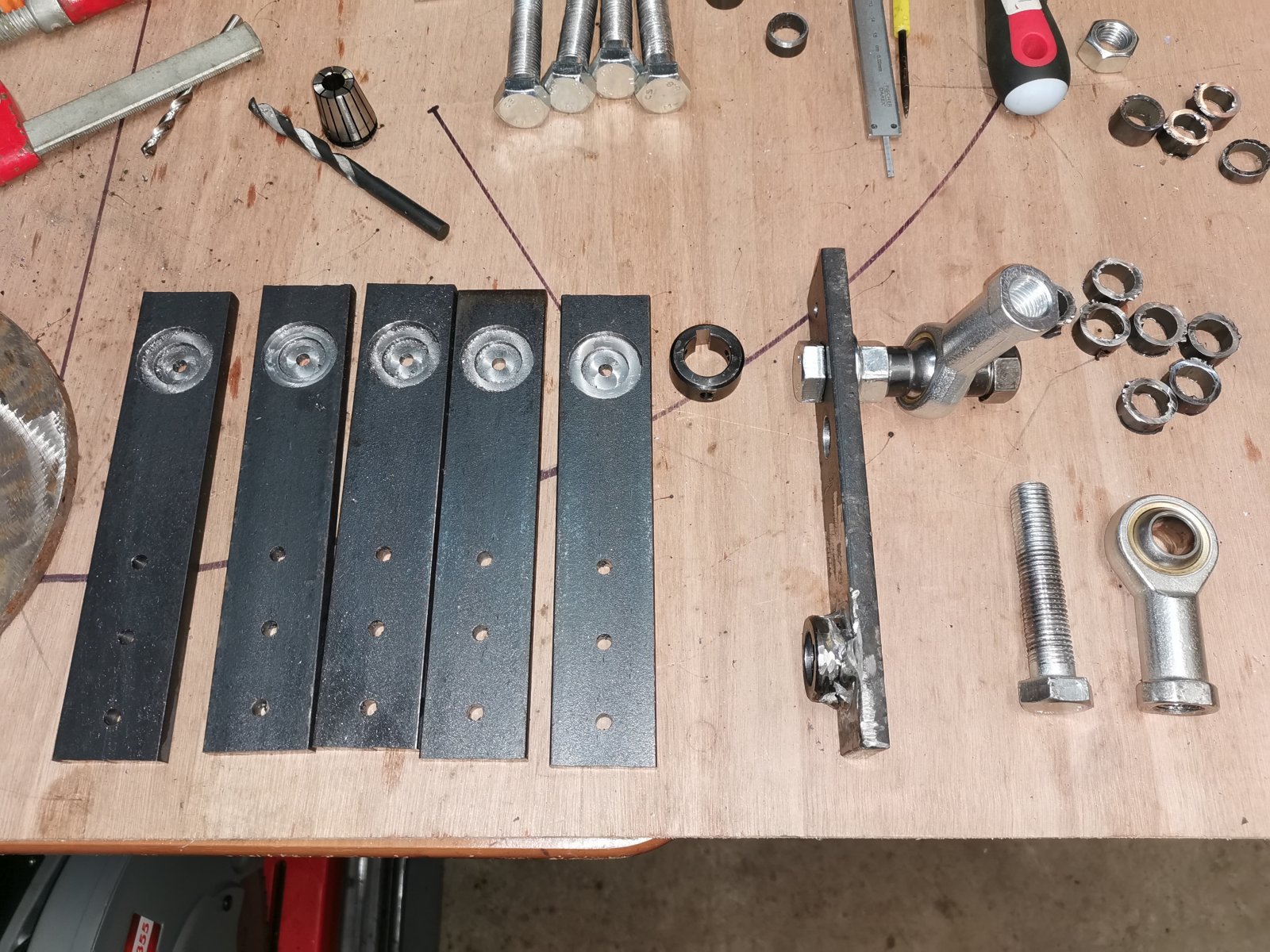

  7. coyote
    coyote Member
    Nov 20, 2014
    58
    France - Yonne
    679Coins
    +72 / 1 / -0

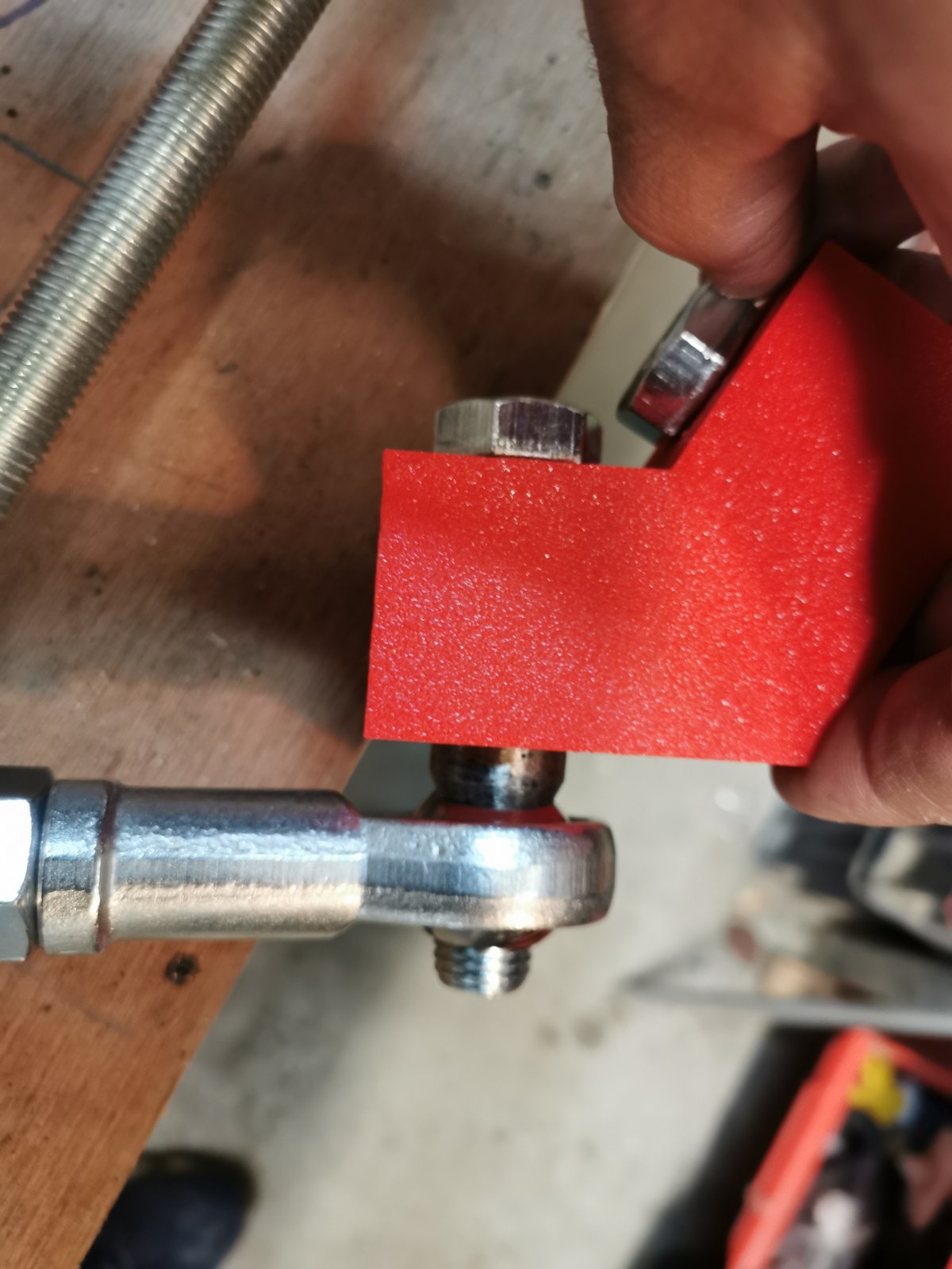

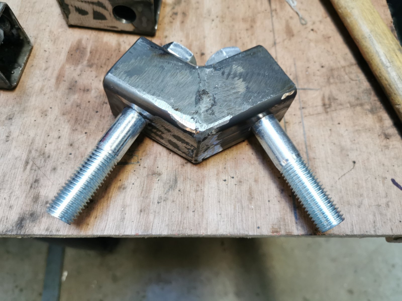

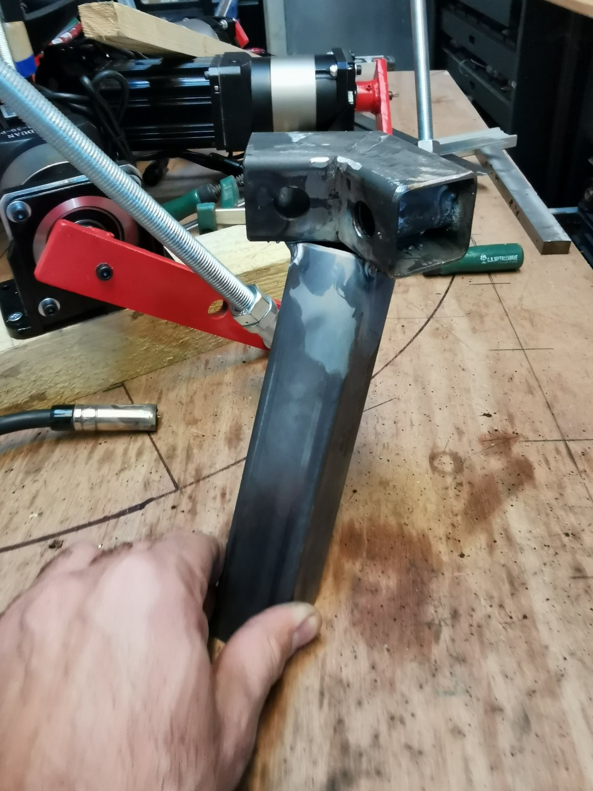

    3D printing for high ball joint fixation test. IMG_20210105_205635.jpg IMG_20210105_205844.jpg
  8. coyote
    coyote Member
    Nov 20, 2014
    58
    France - Yonne
    679Coins
    +72 / 1 / -0

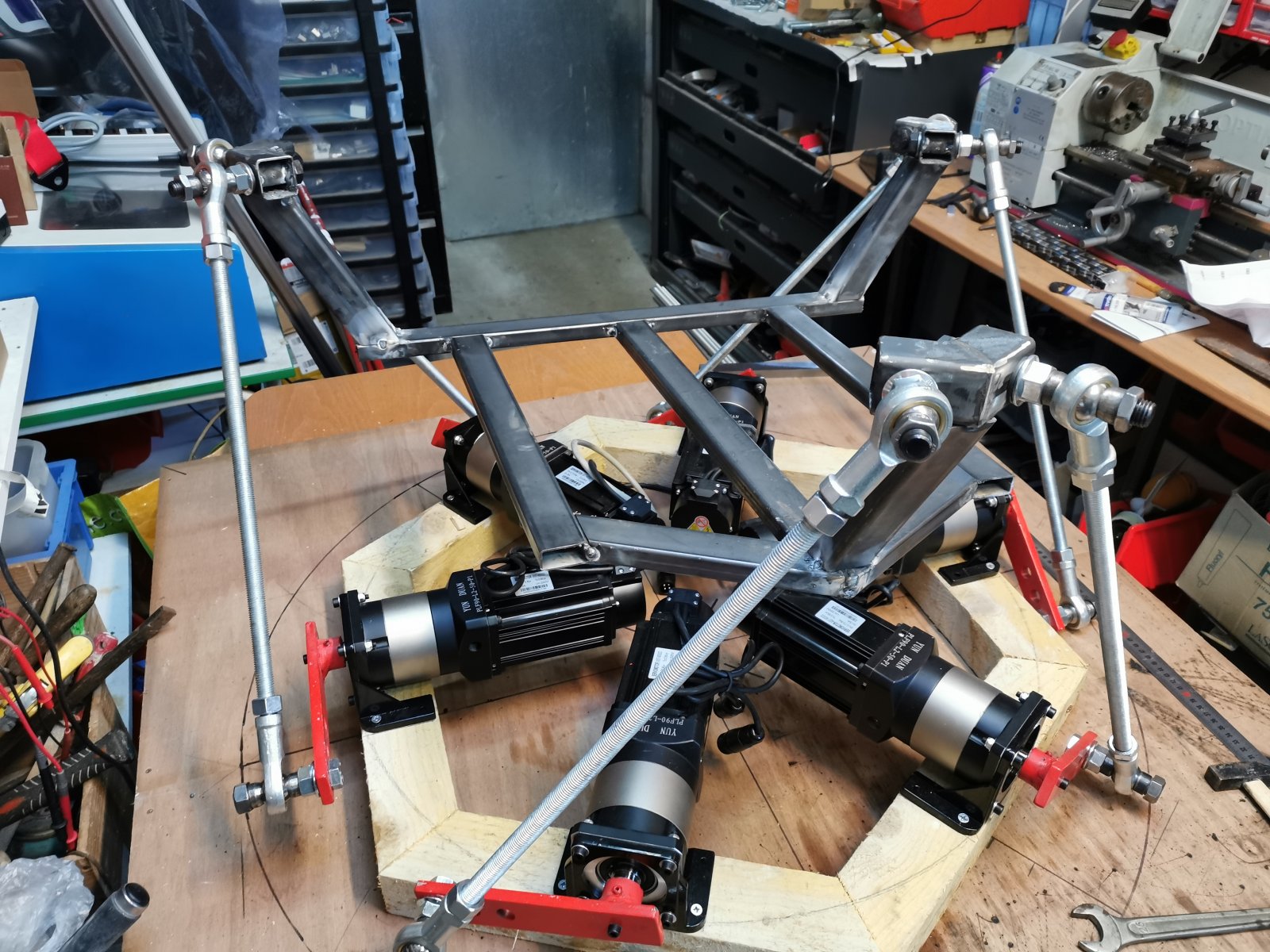

  9. coyote
    coyote Member
    Nov 20, 2014
    58
    France - Yonne
    679Coins

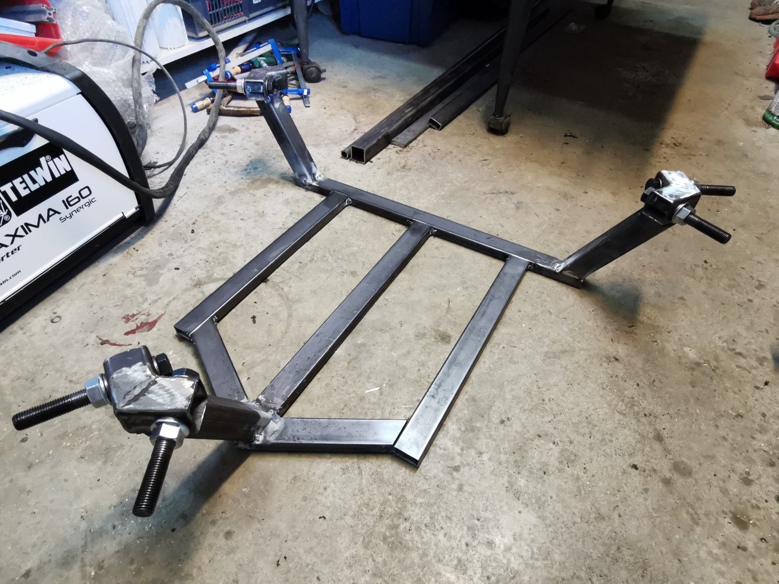

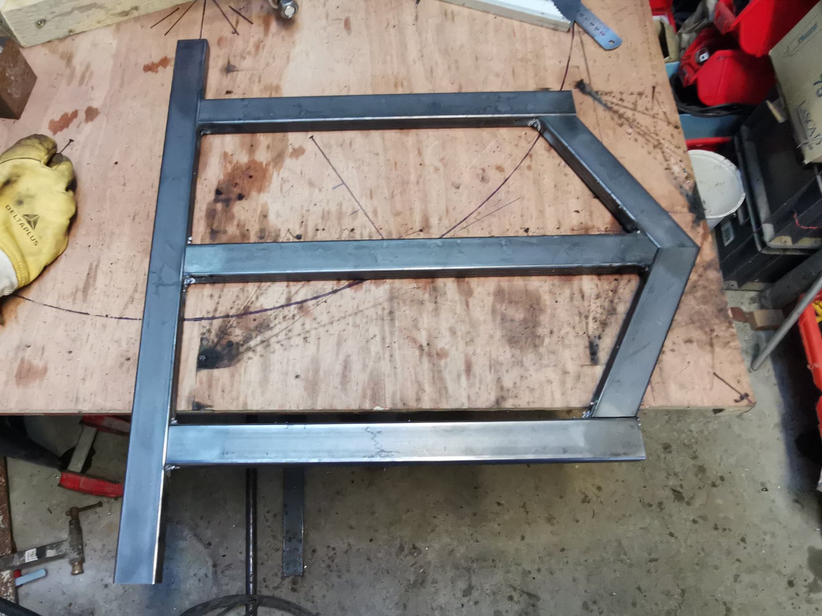

    +72 / 1 / -0
    Have a good day today.

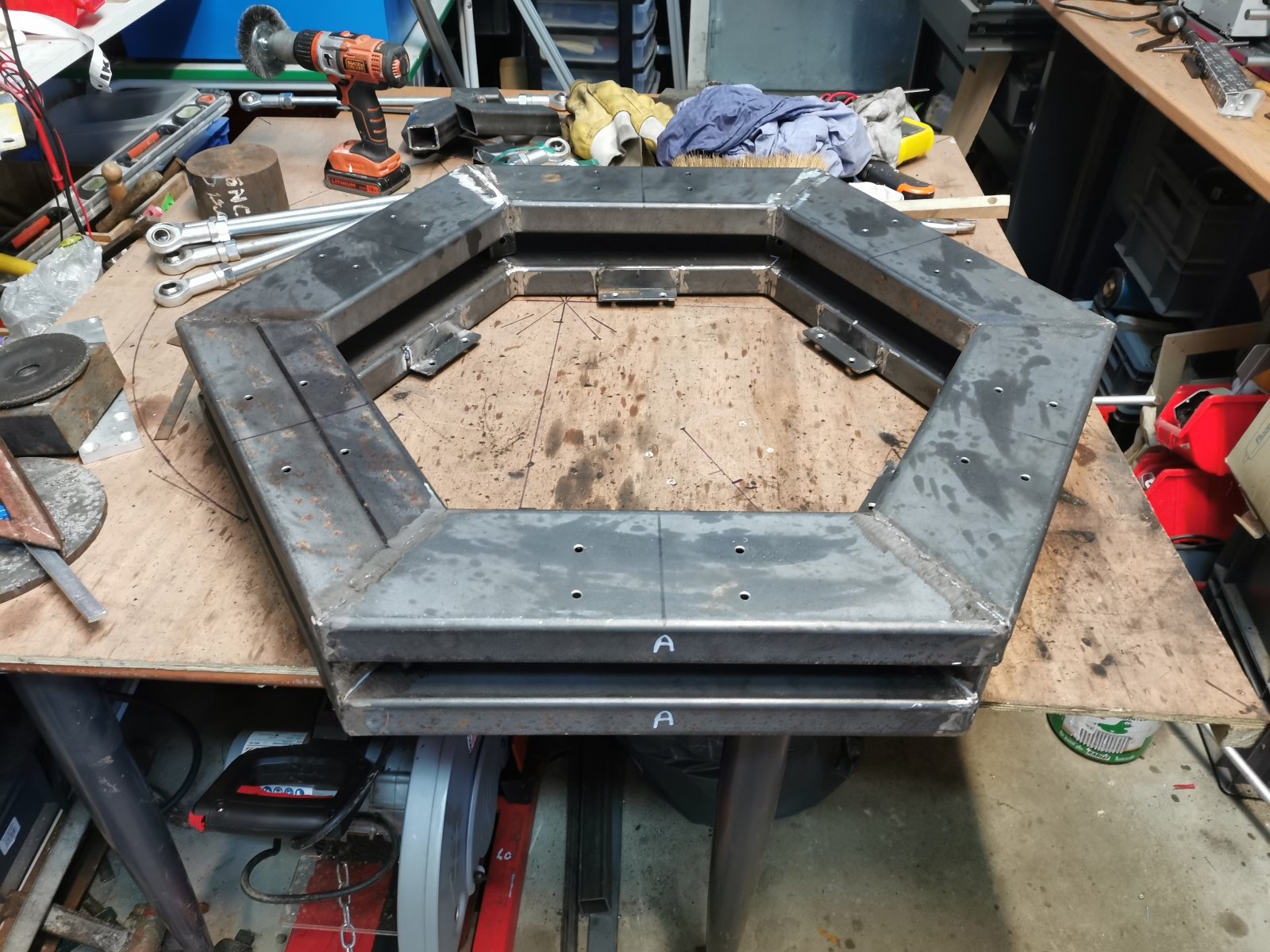

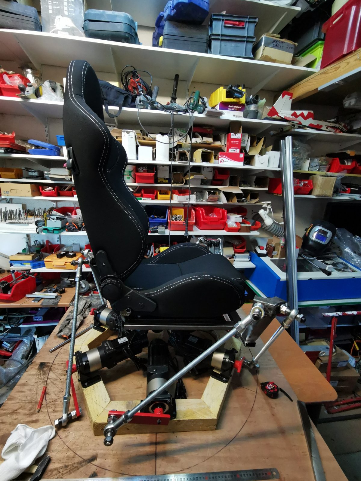

    Cutting and welding for blank assembly of the platform.

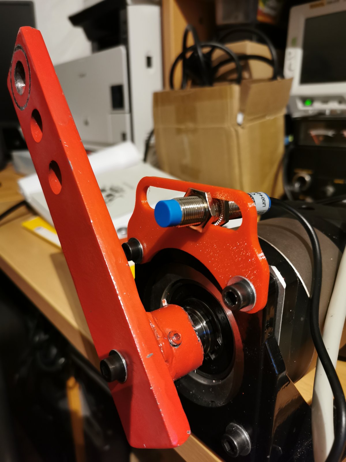

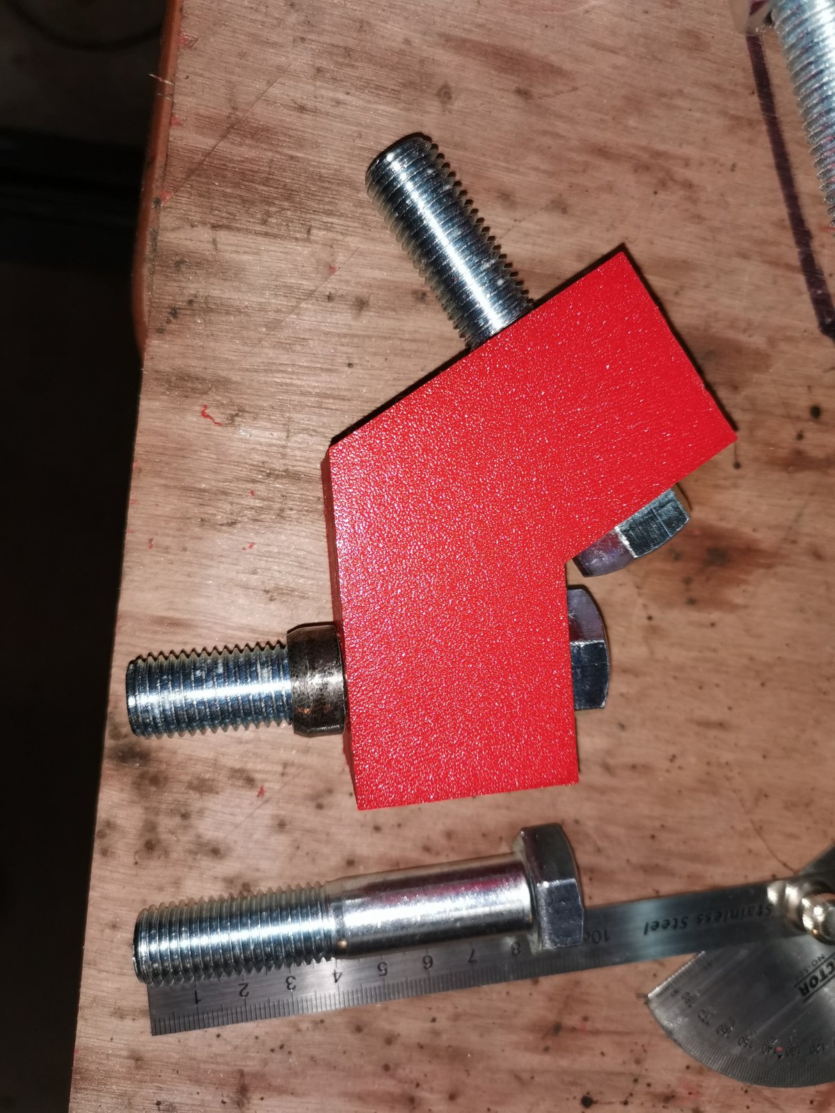

    Support design for the positioning sensor.
  11. Gadget999
    1,971
    12,035Coins
    +488 / 10 / -0
    It is used to index the motors ?
  12. coyote
    coyote Member
    Nov 20, 2014
    58
    France - Yonne
    679Coins
    +72 / 1 / -0
    No, just to detect the end stop for use with the Thanos board.

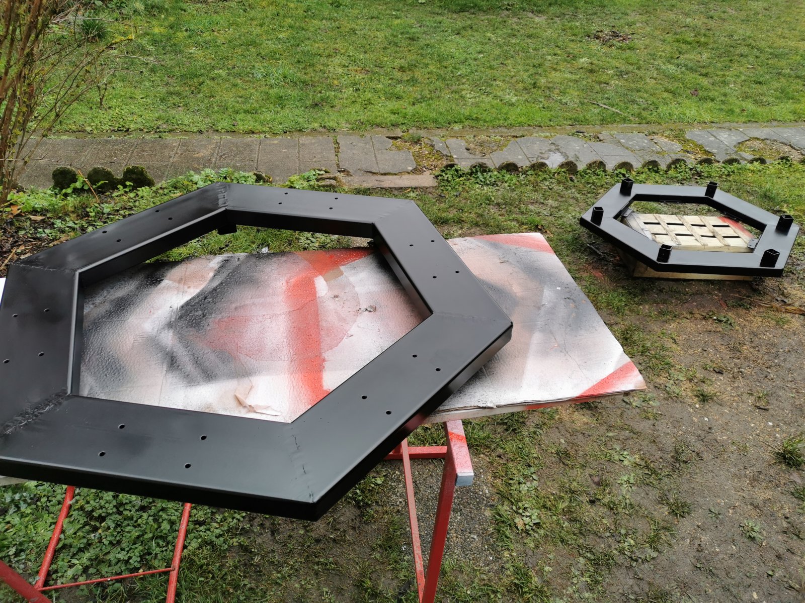

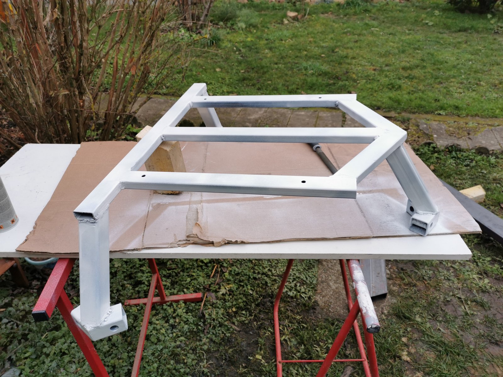

  13. coyote
    coyote Member
    Nov 20, 2014
    58
    France - Yonne
    679Coins
    +72 / 1 / -0

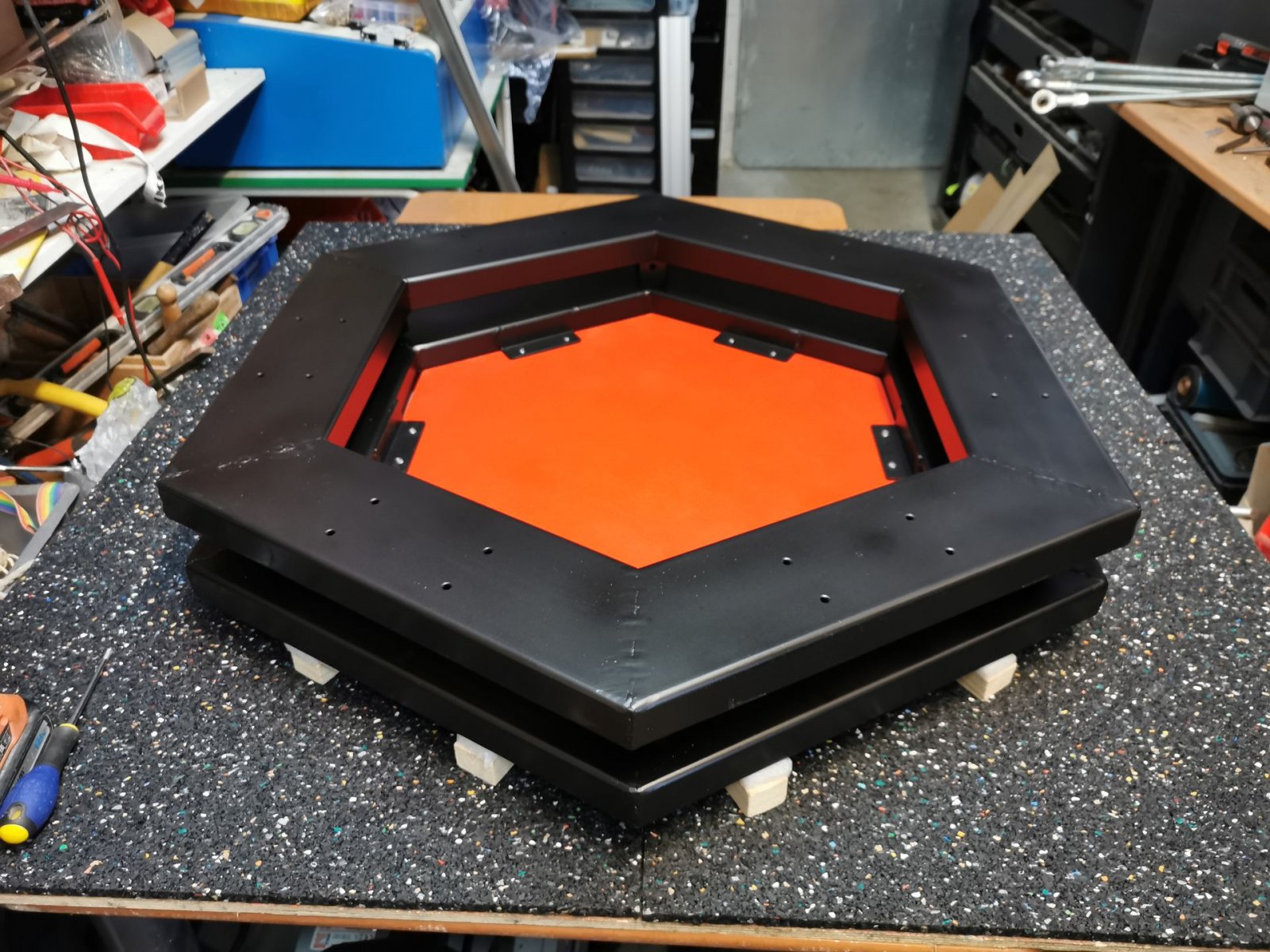

    The weekend advances.
    The base and high platform painting.

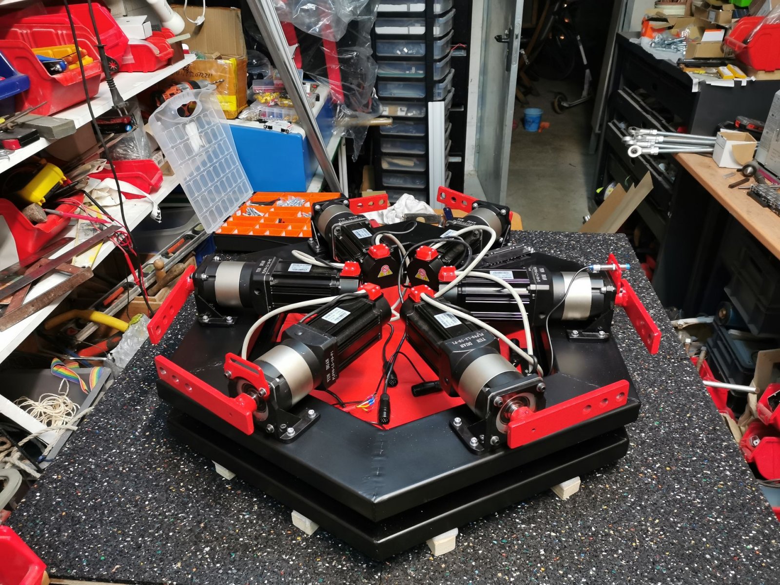

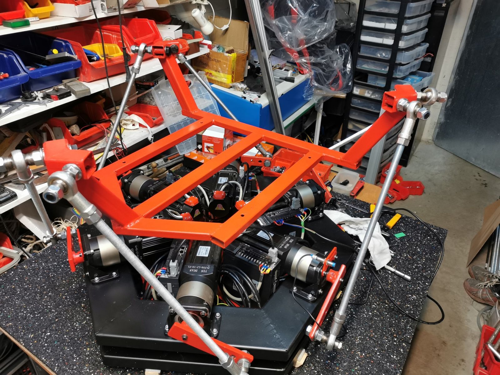

    Progress of the day :
    IMG_20210123_132815.jpg IMG_20210123_151050-r.jpg IMG_20210123_203246_1-r.jpg

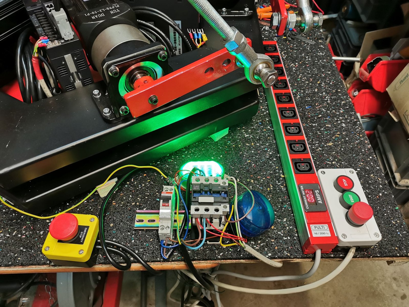

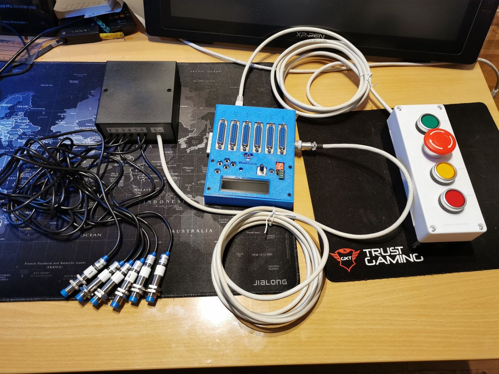

    We advance on the low voltage part and Thanos board.
  17. coyote
    coyote Member
    Nov 20, 2014
    58
    France - Yonne
    679Coins
    +72 / 1 / -0
    So, after the low voltage; the 220V part is planned to supply the motors.

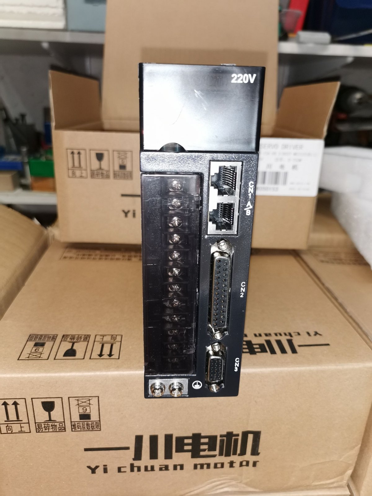

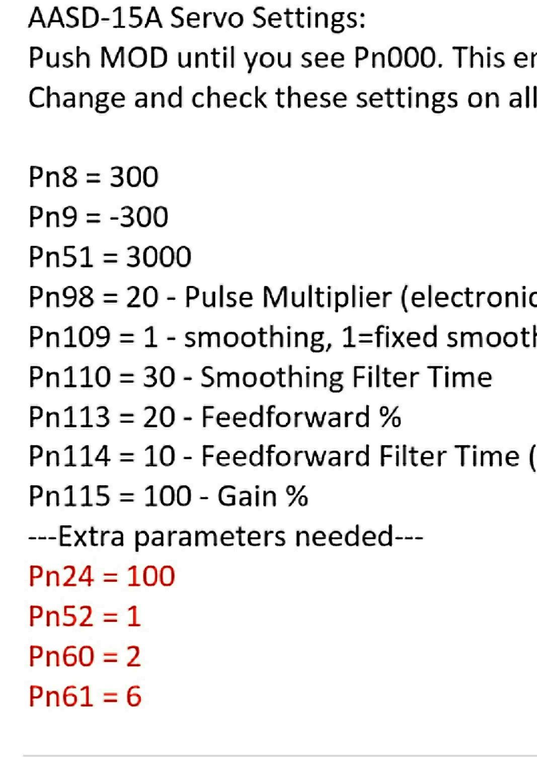

    Does anyone use this type of driver? I'm looking to use the RS232 connection for the setup.
    I am looking for the configuration of the serial port; speed, baud etc ...
    I am also looking for the cable to use.
  19. Thanos
    Jul 6, 2017
    1,372
    Electronics Engineer
    United States
    2,862Coins
    +1,074 / 10 / -0
    These servos don't have serial interface. They have modbus for networking under industrial use...
    Use their panel to set their parameters...
    Thanos
  20. coyote
    coyote Member
    Nov 20, 2014
    58
    France - Yonne
    679Coins
    +72 / 1 / -0
    Mine are equipped with RS232 and Modbus. Indeed it is necessary to modify the parameters Pn064 to Pn067.
    Just need the cable now.
